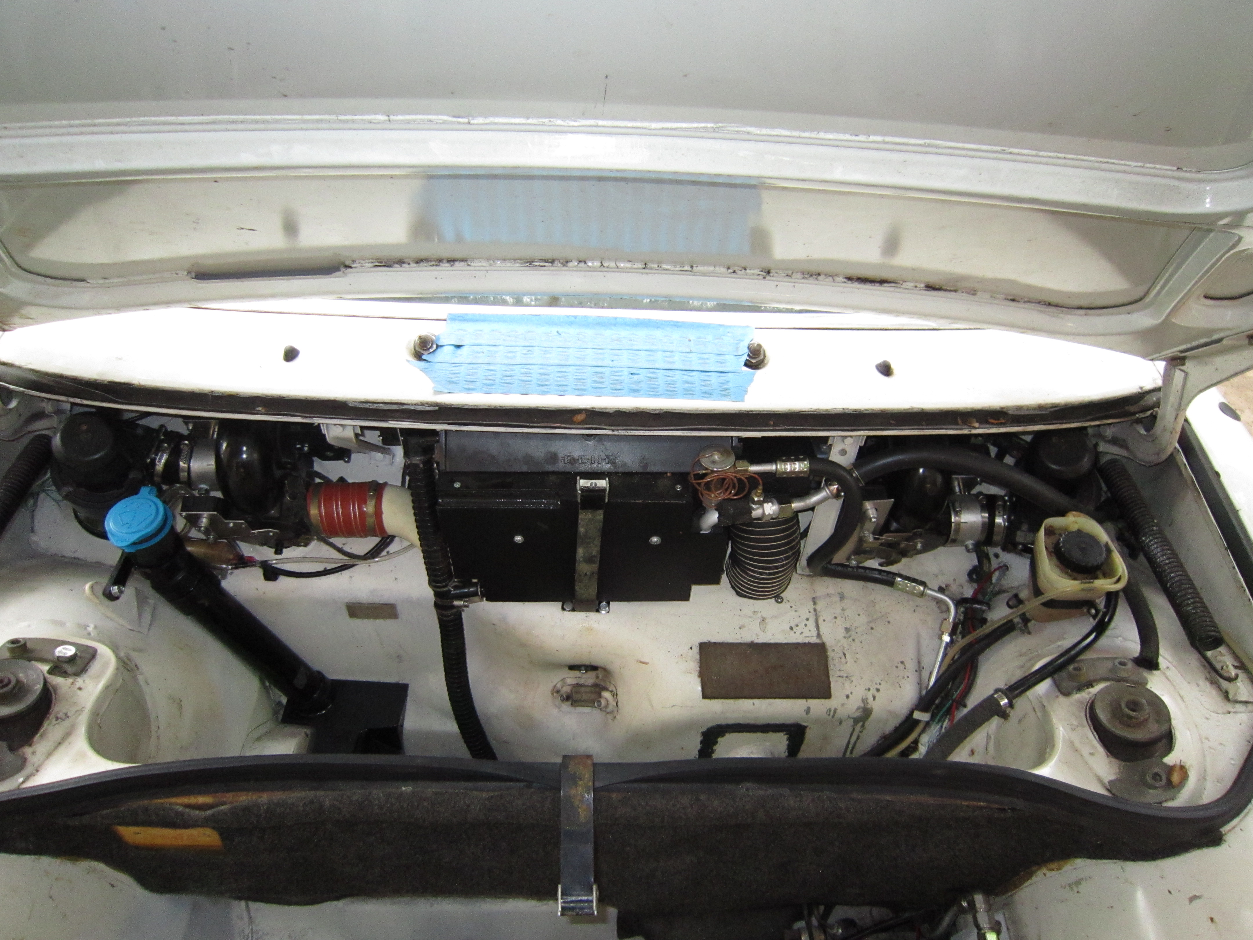

Larry.Hubby
post Sep 19 2018, 08:53 PM
Member who doesn't post much, but has a long time in 914s
Posts: 191
Joined: 24-November 04
From: Palo Alto, CA
Member No.: 3,172
There is a recirculation duct on the evaporator I built. You can see it in this photo of the evaporator module installed in the car, but before the gas tank is re-installed:
The duct is the 3" black hose wound with white reinforcing cord to the right of the evaporator box itself. It draws air from above the driver's feet and is always open as a source for the air blown through the evaporator coil, unlike the outside air vent, which has a damper that can be closed. There is room to add a similar duct on the passenger's side as well, which is something I've been considering doing in order to get a bit more air flow.
