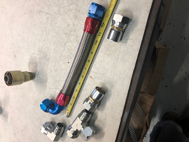

I have after market oil lines with AN fittings. The line from the tank to the cooler has a leak. Apparently at the cooler end. As I think about replacing the line, I’ve been thinking about putting in a fitting at the tank end with a valve or a threaded hole for a drain plug. Something to make draining the oil easier than disconnecting the hose. Anyone here ever done such a thing?
post Jan 27 2019, 05:23 PM
914-6 GT in waiting
Posts: 20,587
Joined: 19-September 09
Member No.: 10,825
Sorry, pic is turned sideways. An next time I drain the oil, I plan to safety wire the cap. Even though it points down, this pic is without the heat exchangers installed. They sit at least a couple inches lower than the T.

Hose taken to hose maker. It was leaking at the cooler end, the straight end. Making a new hose with aluminum fittings. This steel stuff is too heavy. Will drill and safety wire the cap. That's the plan anyway.
