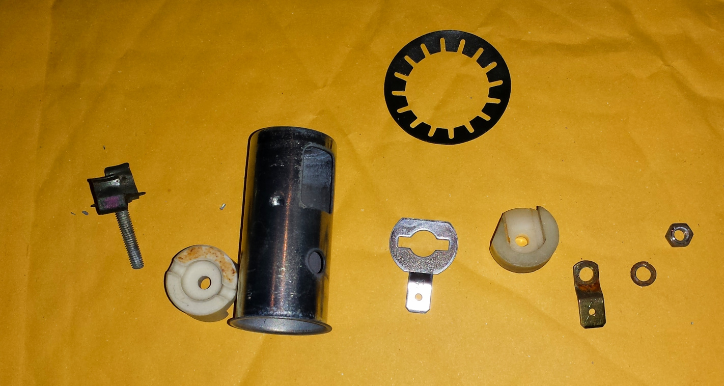

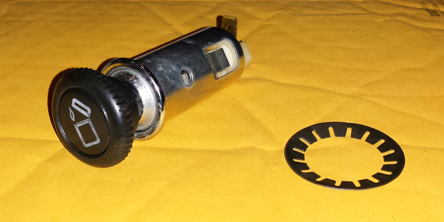

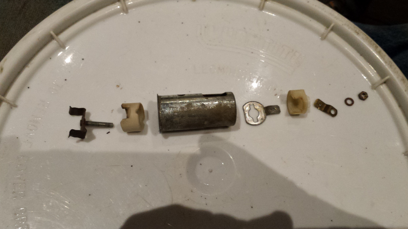

Below are the disassembled parts from when I rebuilt mine. The button should stay in until the element gets hot and then pop out automatically. The 2-pronged spring on the left clamps onto the coil attached to the button when the button is pushed in and the coil is cold. As the clamp heats up, it spreads apart until it lets loose and the button pops out. That should let you know what to look for when you take it apart. it's an easy job. Just keep track of how it goes together.
And here are the components cleaned and replated, then reassembled (IMG:style_emoticons/default/shades.gif)

IIRC, I had to do some gentle bending of the 2-prong piece until it grabbed the coil tight enough to hold it when cold. Then I connected the assembled unit to a DC power source to test to make sure it popped out when the element got red hot.

Update: It was as simple as two things - giving the coil element a good wire brushing and then a nice firm bending of the "goal post" prongs as shown in the first pic above from @bbrock . I did those things, shoved the lighter in - where it stayed - and then I actually jumped when it popped out. And it was hot.
