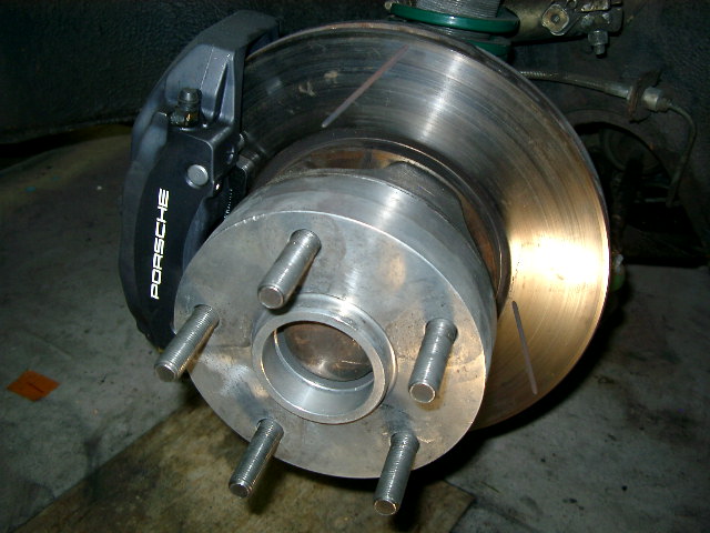

We put Boxster brakes on a lot of our project cars that get used hard and don’t need originality. Most are 911’s with 3.6 engines. Stompski makes 914 adaptors for the front but not the rear. At least that’s what Stephen told me last year. I believe Rebel racing and rich Johnson have rear adapters. We use a 23 MC but most of our cars get a 911 brake booster. It’s not absolutely necessary but makes the pedal easier in traffic on a road car. Boxster calipers will work with 15” Fuchs and cookies.

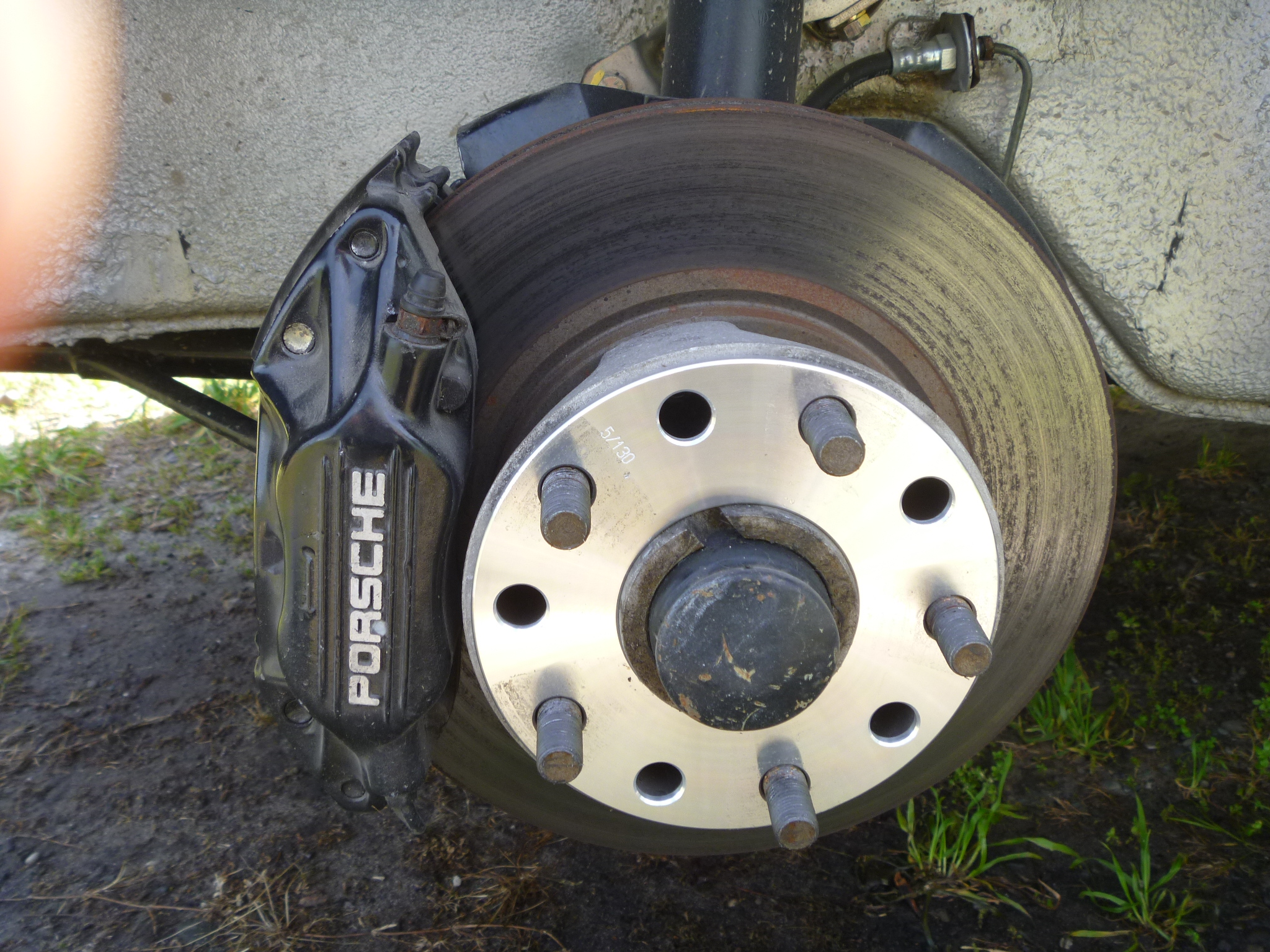

I had 944 turbo brakes on the front and you have to oblong the holes to work with 3.5” struts. I then bought a set of Boxster brakes front and rear using Rich Johnson’s Kit. I’m using a T in the rear instead of the proportioning valve. I am also using a 19mm master cylinder. Braking is awesome and well balanced. I have only autocrossed the car and am quite happy with the setup. I also have a 911 parking brake. I have slammed on the brakes on corners and on straights and the front always locks up first. I started off with 16” 993 rims and now 17” fixse. I have not tried 15”

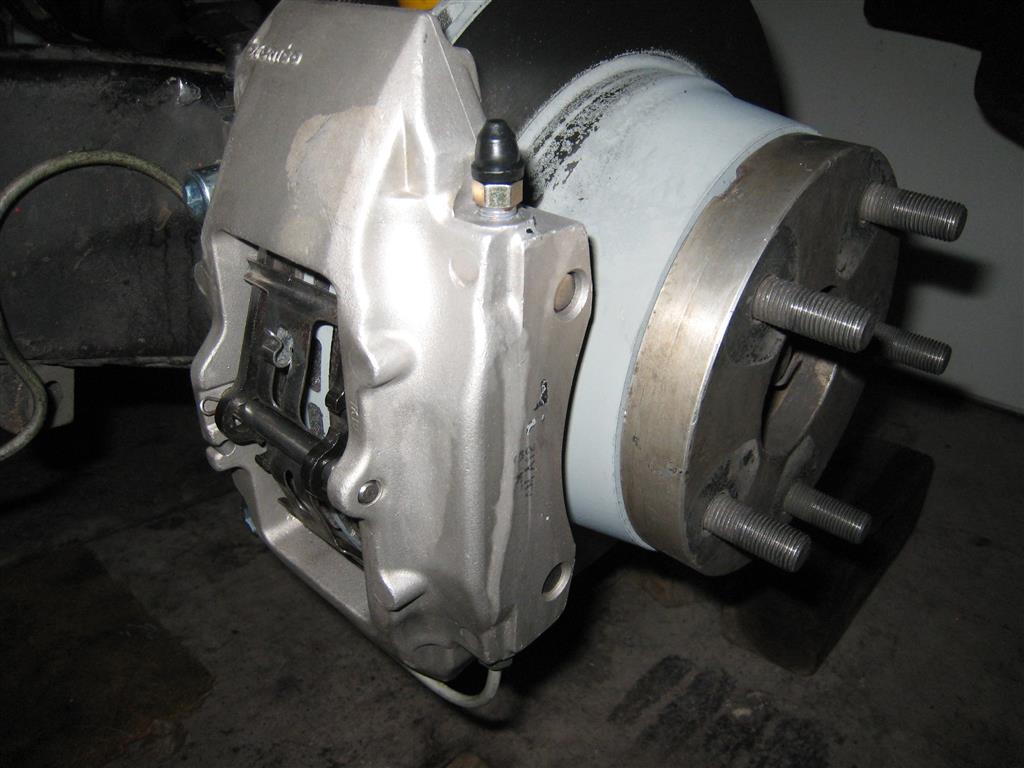

I am currently running the Alfa Romeo Brembos on the front and 914/6 vented on the rear. I do several track events a year in hot weather. They work fantastic! Not too much wear and I am running hawk brake pads. My car has a built 3.0L. The funny thing is I used to have stock Carrera calipers and rotors (yes different struts with 3.5" spacing) so I down sized and saved about 20lbs! The steel Carrera rotors are thicker and heavier. The steel calipers are boat anchors. My car stops very well. I run pretty good lap times. PMB sells the Brembos new and it sounds like the m calipers for the rear are the way to go since your doing the 911 set up. Get frozen rotors for your front.

Boxster front and rear on my car. 23mm M/C. Works great for track and street. No parking brake, though.

I'm another one running the alfa brembos on the front 914/6 struts and PMB 914/4 V-caliper with vented rears. Using a stock 17mm master cylinder, 108mm hubs and stubs, G50 CV's and SAW axles.

Rich Johnson adapters that is. I have a thread somewhere with pictures. I modified the adapters to run vented rotors front and rear.
