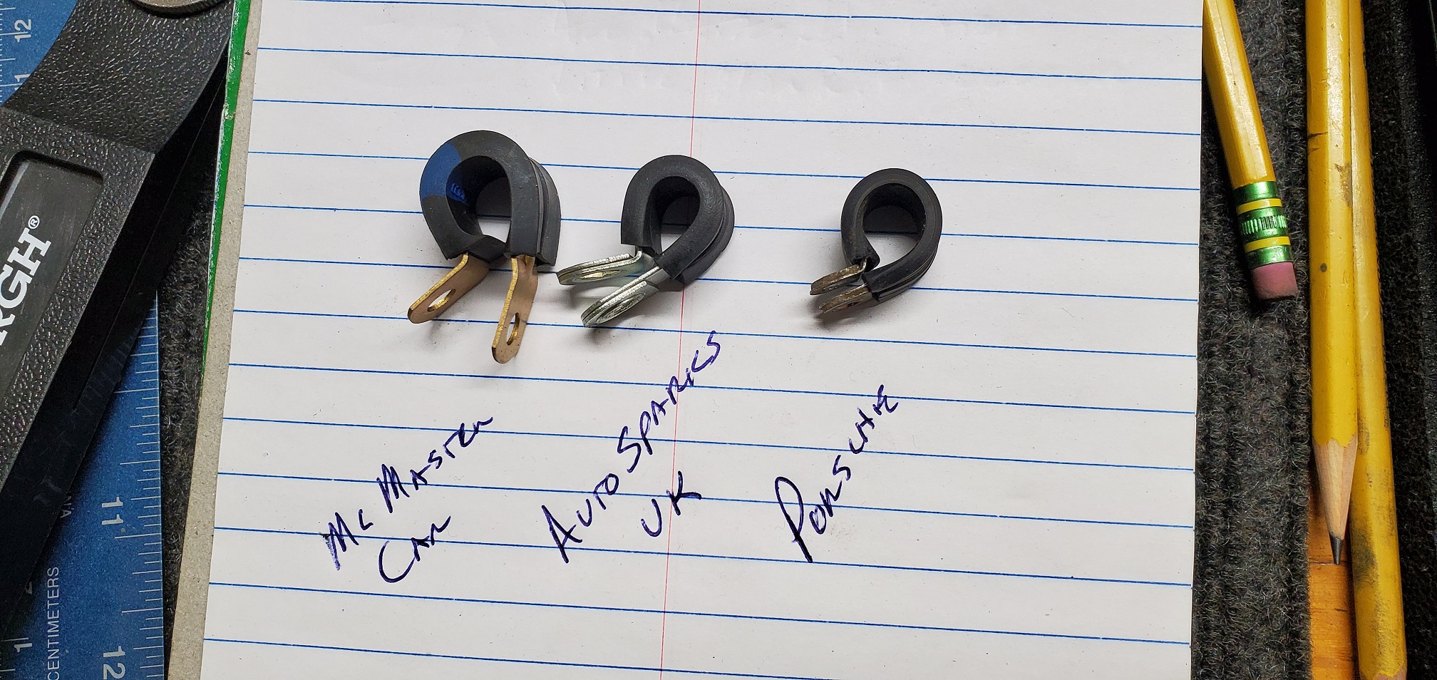

Sorry been busy. Then took a 70+ mile solo backpack trip into Hells Canyon.
I thought I had a side shot too.

@ Cary: bummer that they don't match. Thanks for posting this.

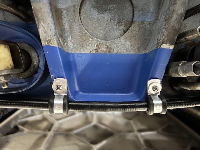

FWIW - I bought both the 10 and 8 mm ID offerings from Belmetric. The 10 mm was a better fit (CM10BAND12).
Forgive the extra washers. The hole in the clamp is too large compared to the heads on the factory specified screws.
