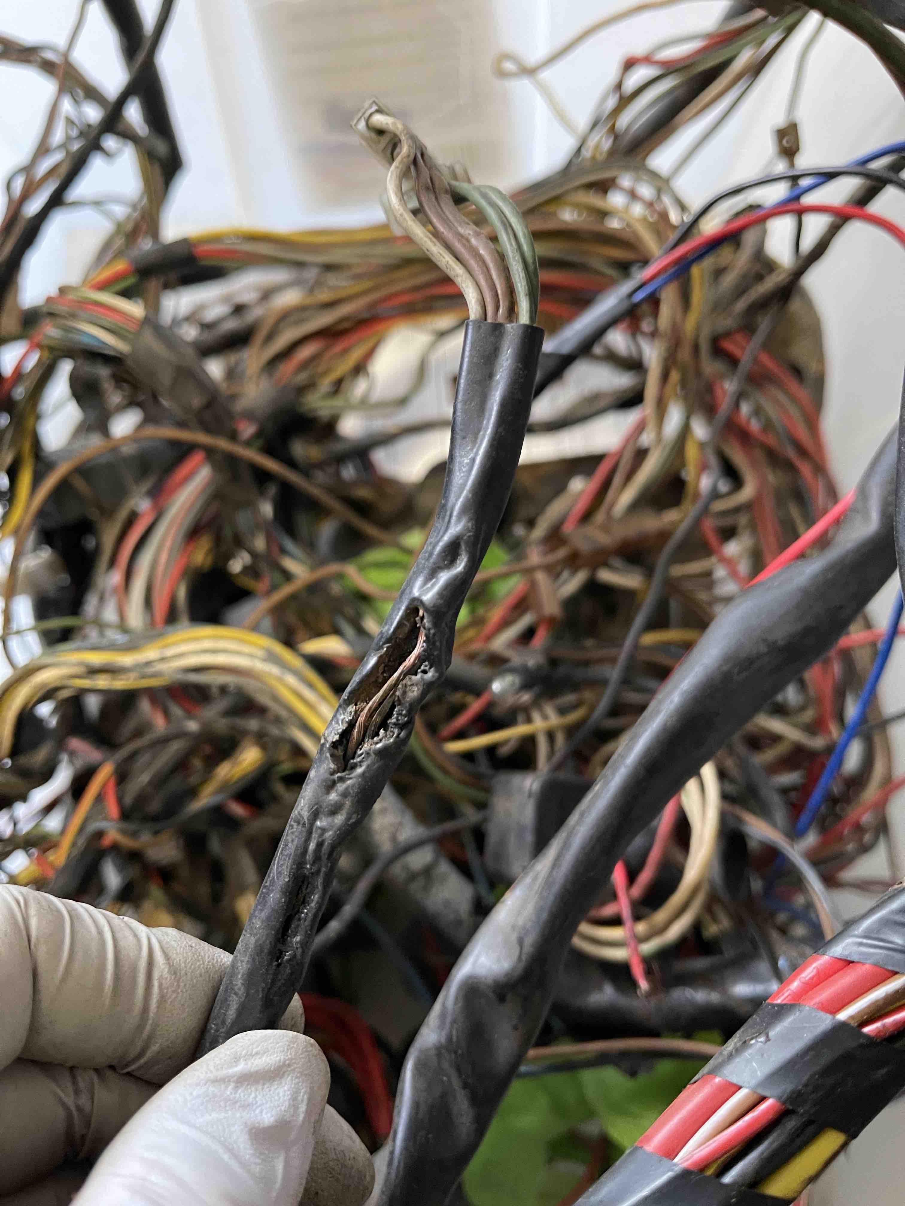

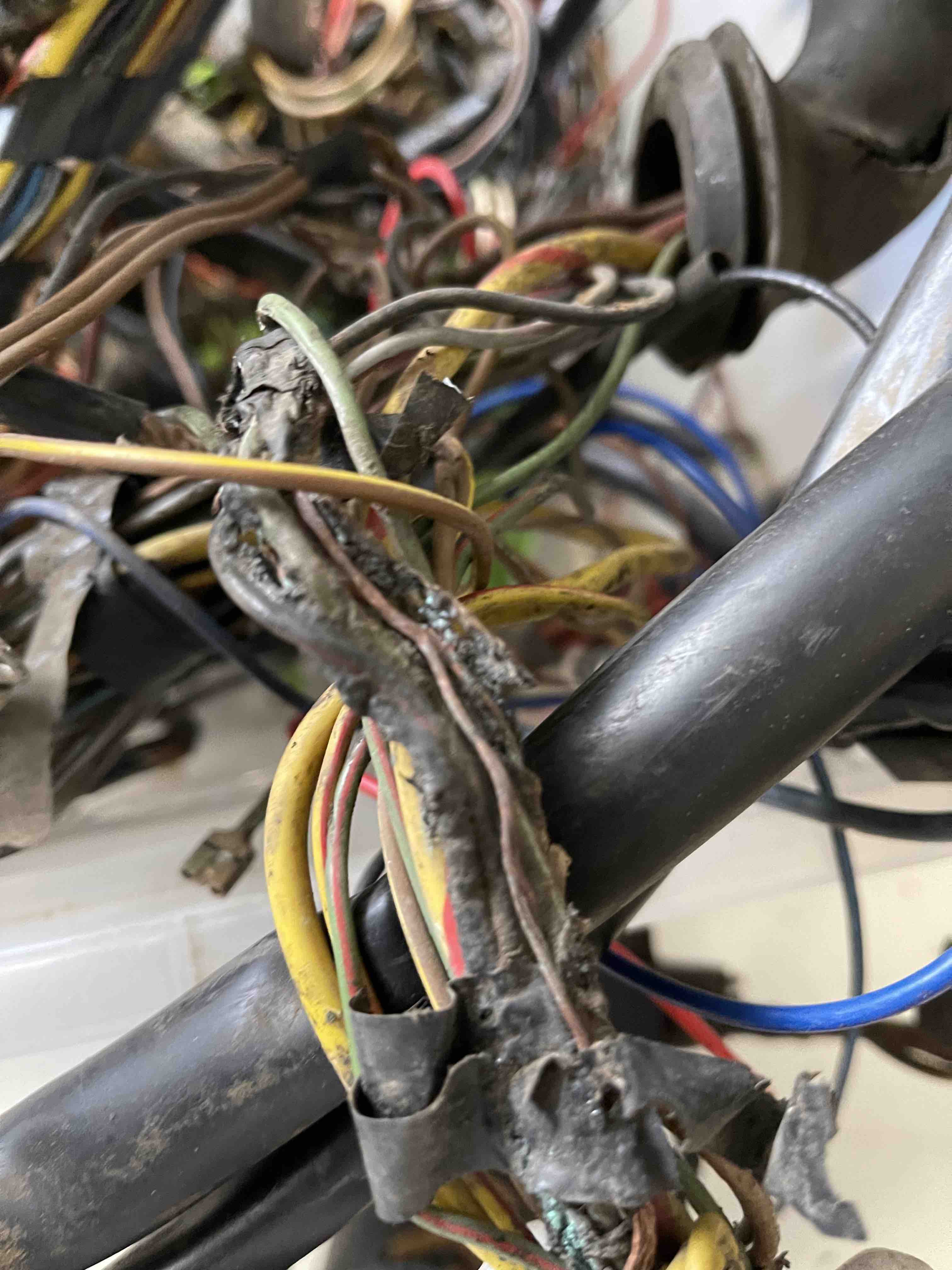

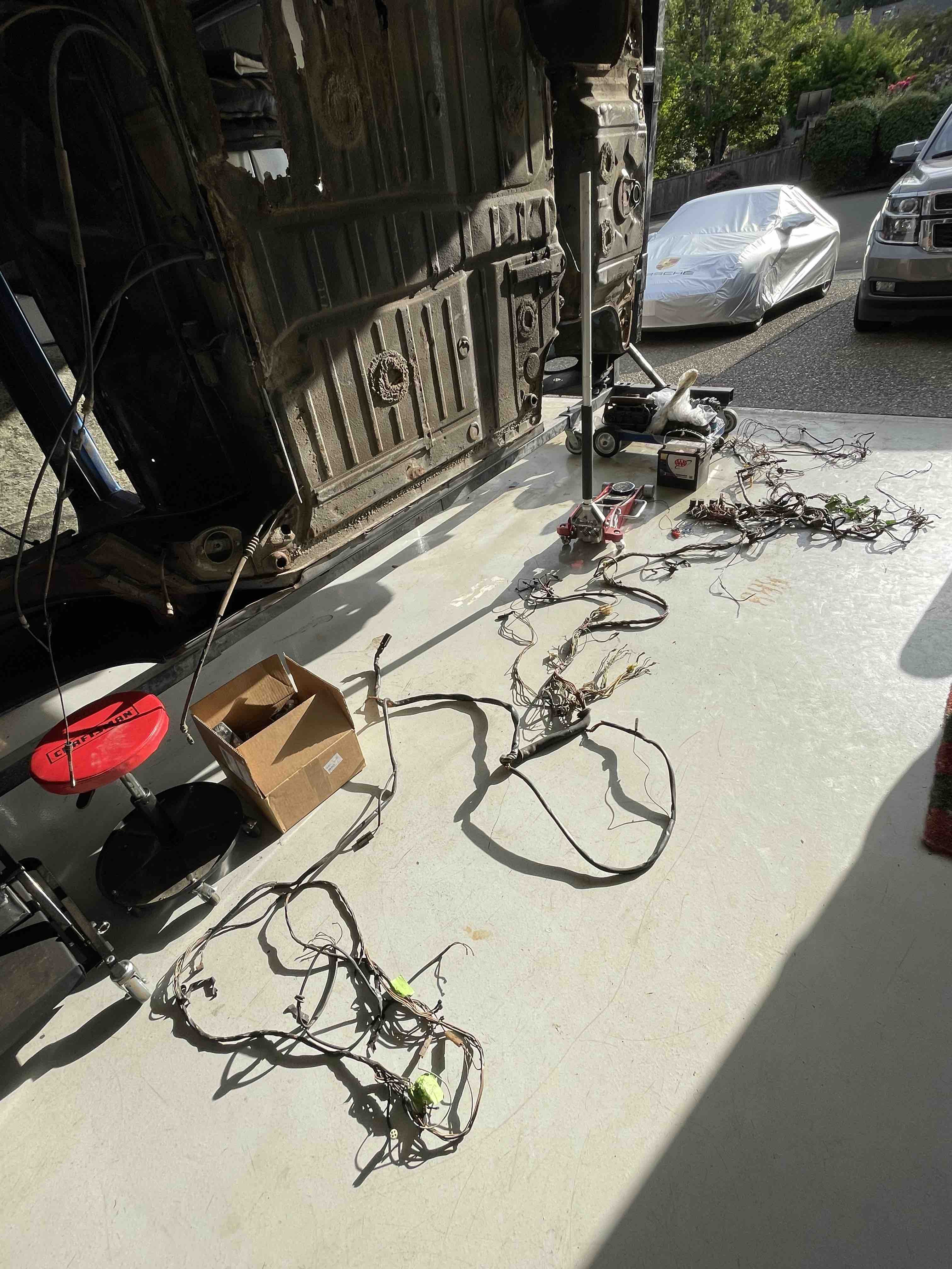

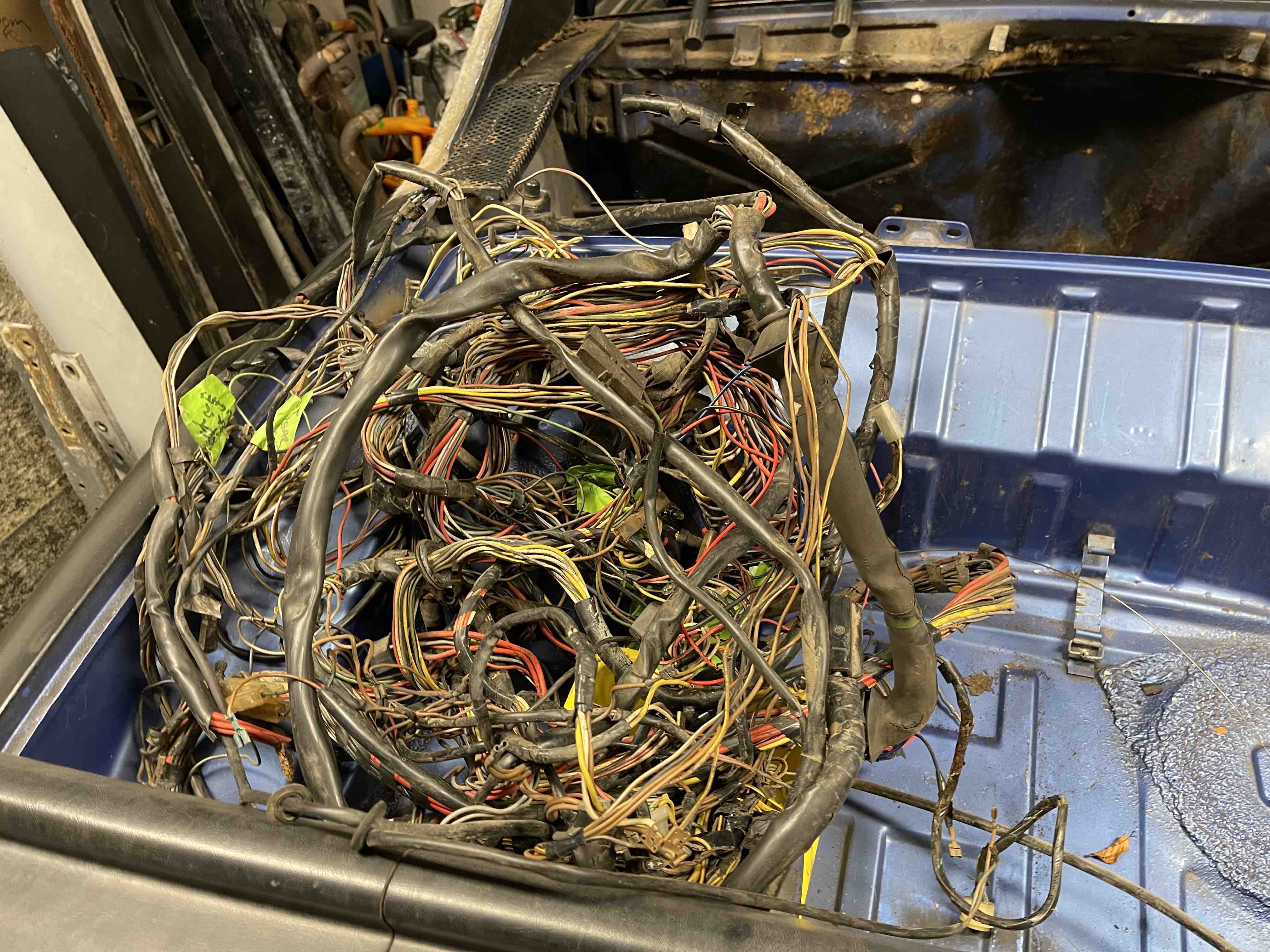

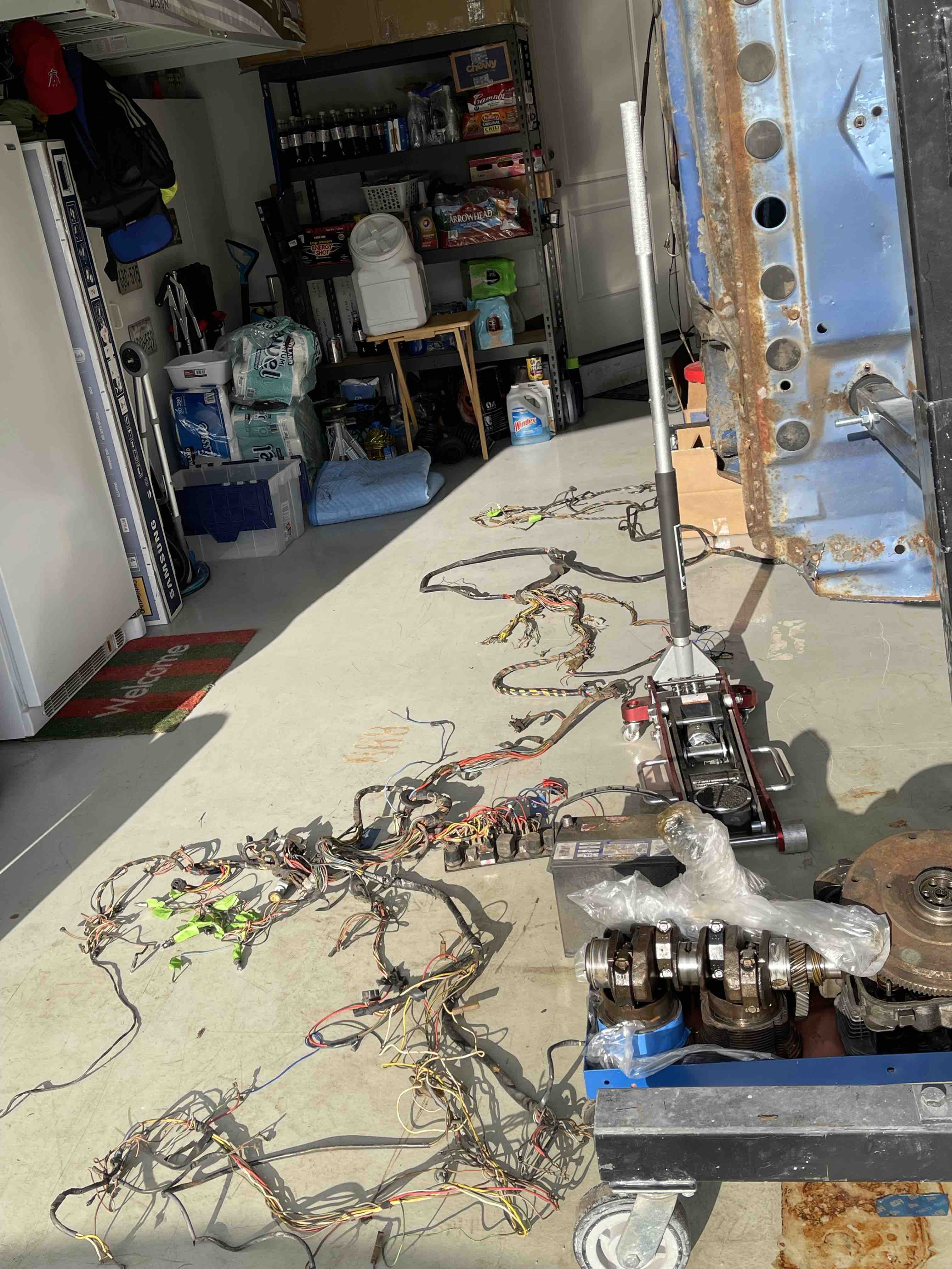

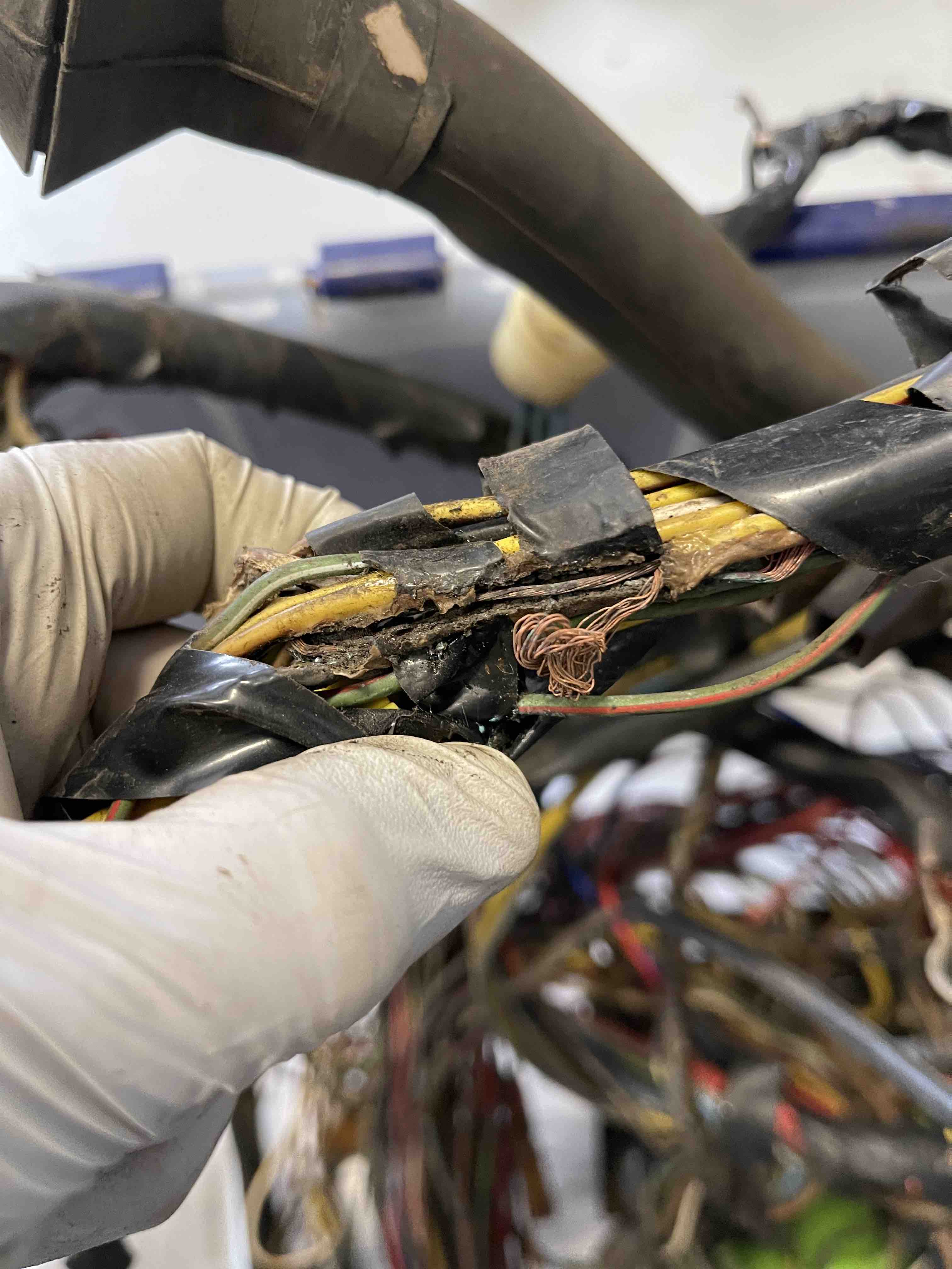

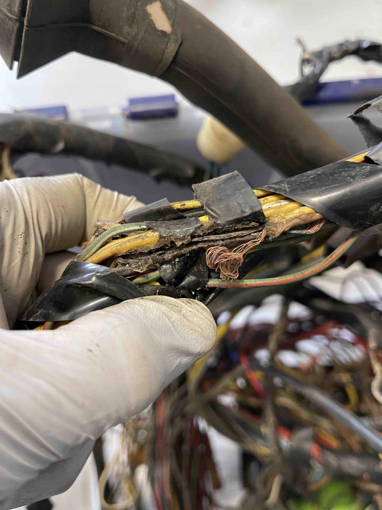

I just removed the wiring harness from my '75. I am not sure what the PO did or what happened but there are a lot of shorts with melted and exposed wiring. The seat wiring is melted into a large uniform mess.
I hate any form of lock out with seat belts. Can I remove the wiring and sensors or is there any reason I should restore the wiring under the seats and then make the modification to delete the lock out and fasten seat belt signals? I can't imagine a future owner thinking they would want to have the wiring available to connect a starter lock out to the seat belts.

Delete the whole harness. Buy a "new" harness. God only knows what else is going on in that thing.

I love being a contrarian (IMG:style_emoticons/default/happy11.gif) If you have more money than time, buy the RD harness. If you have more time than money, repair what you have. My harness didn't look any better than yours when I started. I couldn't find a good used one and wouldn't have been able to afford the RD harness even if they were available then. I fixed it myself and it looked like new when I was done.
(IMG:http://www.914world.com/bbs2/uploads/post-20845-1535086384_thumb.jpg)

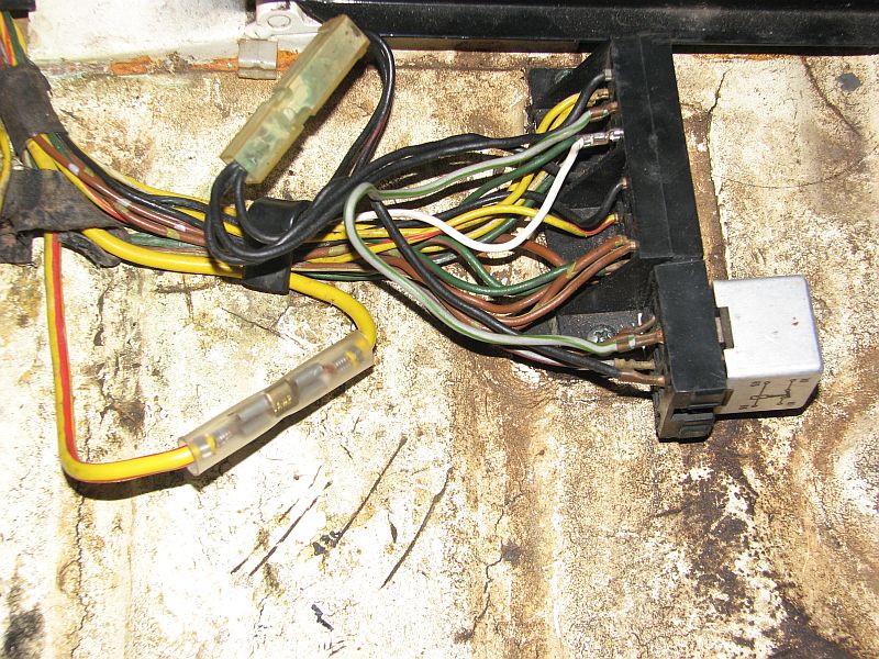

And to answer your question, there are threads on bypassing the lockout. A quick search turned up this one: http://www.914world.com/bbs2/index.php?showtopic=51375

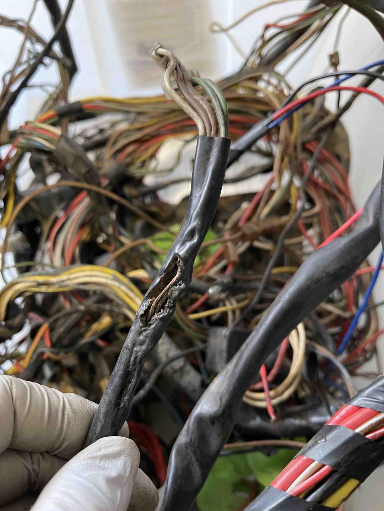

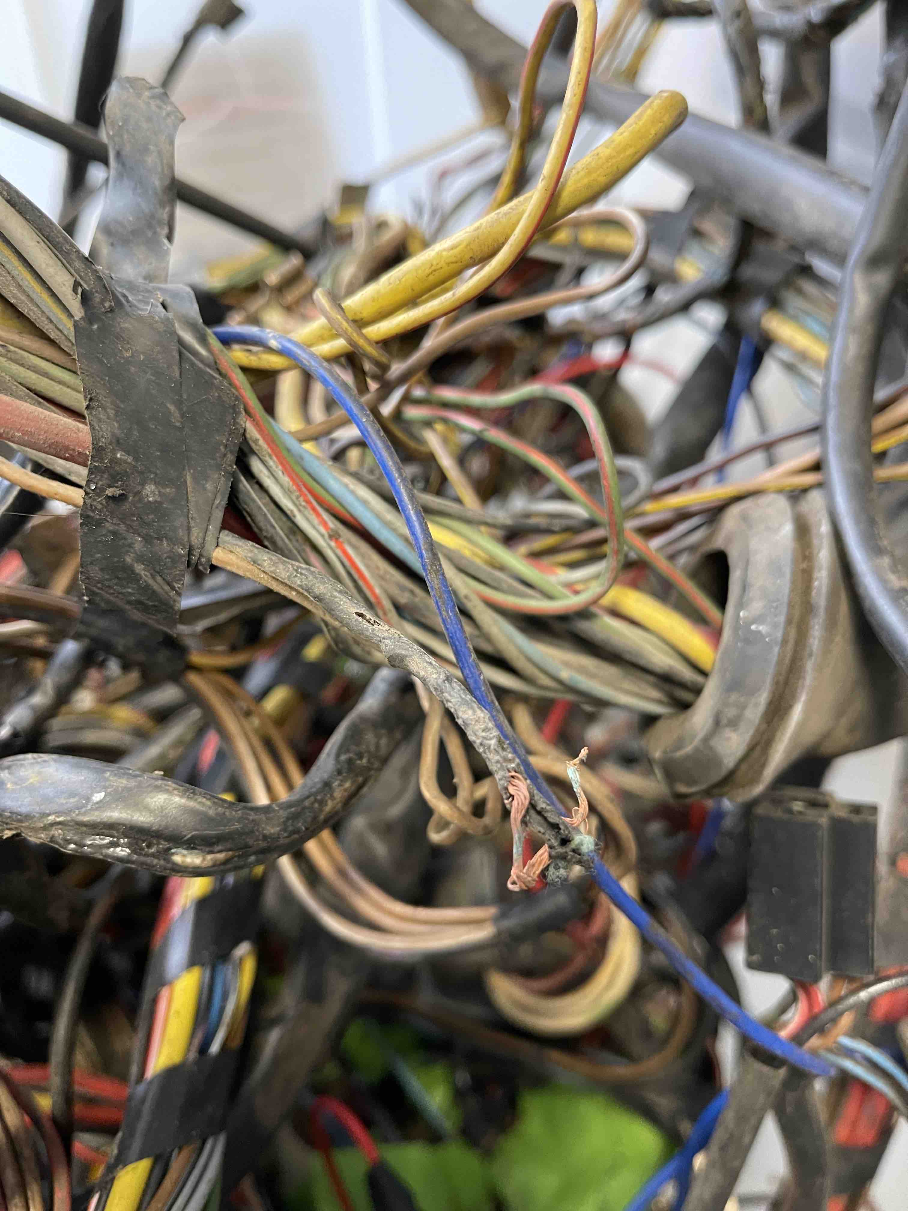

I could buy a harness but I'd like to learn how to repair this. I would have liked something that didn't make me say WTF every few minutes.
Oh it gets better.

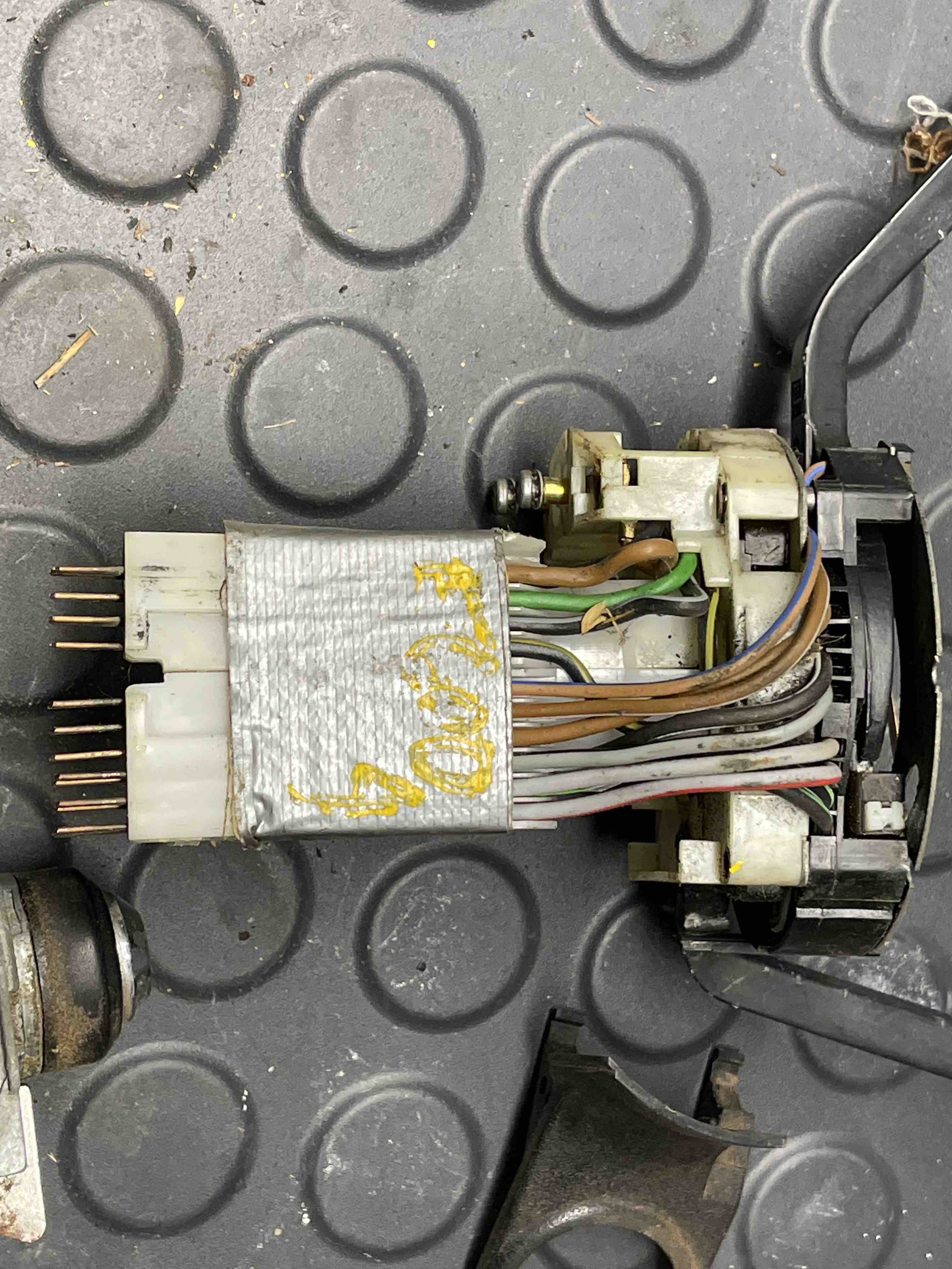

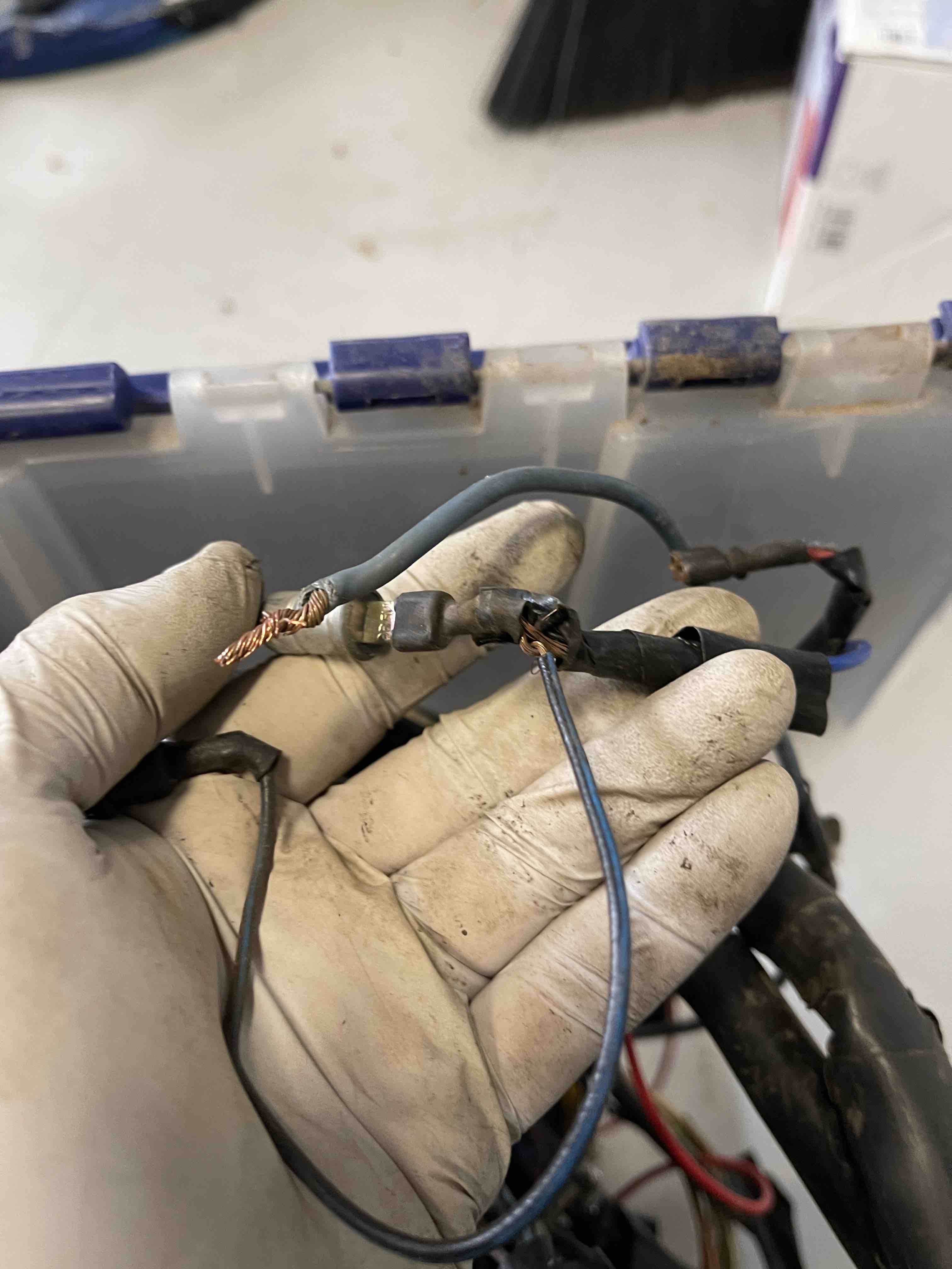

I need to get a video on how to attach wires like this:

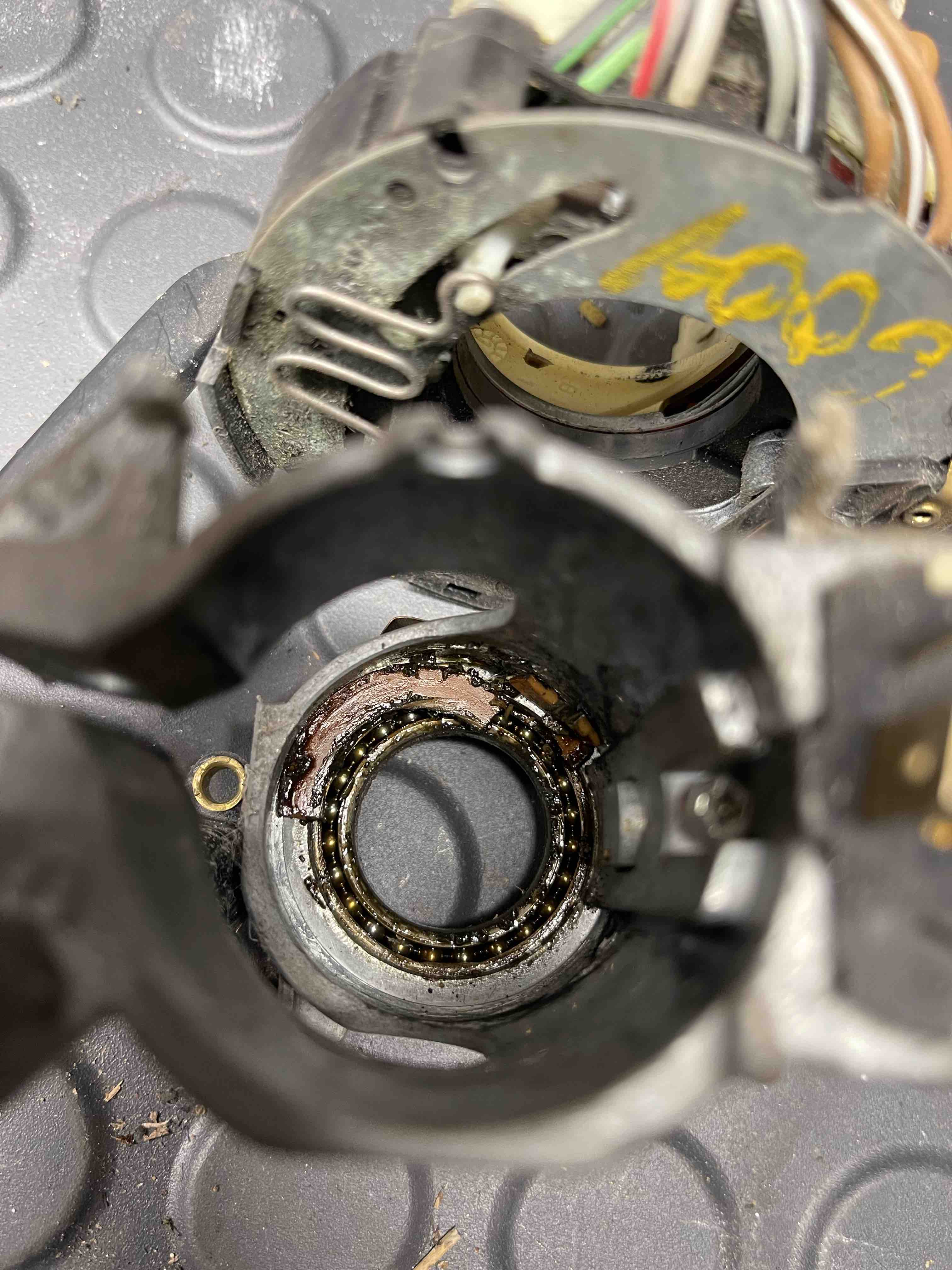

Here is the steering column washer/signal switches with the custom silver Porsche electrical wrap:
and looking down at the bearing for the steering wheel - it looks like the plastic disintegrated and explains why the steering wheel was flopping around.

As Bbrock stated you can salvage it. I you have the money, I'd just find another good used harness and/or start with the new RD 914/6 harness.
New 914/6 from RD gets the nod if only because so many of these cars have old brittle and battle scarred wiring with only slightly less DAPO stuff done to them. Starting fresh would be wonderful.
If you do decide to repair, take a good look at what Tygaboy is doing for wiring as the role model. No matter what you do stay away from hardware store butt splices, low melting temp solder butt splices, electrical tape, and solder.
Proper crimps and tools can be had for less than $100.

I removed pretty much out of my harness that wasn't being used including the seatbelt stuff under the seat. Cleans things up

I think your PO worked on my 914 cause it looks (the wiring that is) a lot like the wiring in my car. My suggestion would b "delete" not only the seat sensor wiring (which i did many many years ago to my first 914 with no issues). But i would also scrap the whole harness. Which is what i did to my current 914 wiring harness. I bought an aftermarket harness from summit racing. Most teeners will scoff at my suggestion cause I am ruining the "originality" of the vehicle. But iam both an iconoclast and my car is a true outlaw i.e. LS powered, Mendola transaxle, etc.

here's the seatbelt interlock fix if you haven't seen this already (the heavy gauge yellow wires). Trace all those other wires back far enough to cut out any shorts.

I'd recommend cleaning the entire harness and removing any non-original wires or repairs. Next, I'd string it out on a sheet of plywood like the pros do it - using nails to hold it down. Take it one section at a time and simply make repairs and/or replace entire runs of wire at a time. Make sure you use the same gauge/color wire when possible.

I don't need a new complete harness. I'm adding a different ECU, so I have the engine area covered. Sounds like I can delete the seat wiring. So my focus is understanding what I have in the cockpit wiring and rebuilding it. Even though I've got a lot of issues with the wiring, it is complete. I have some time before I can start welding on the car, so I don't mind figuring out and repairing this harness. We've all been there before - we get a great deal on a car and then spend 5x more what a good driver would cost fixing it ourselves.
