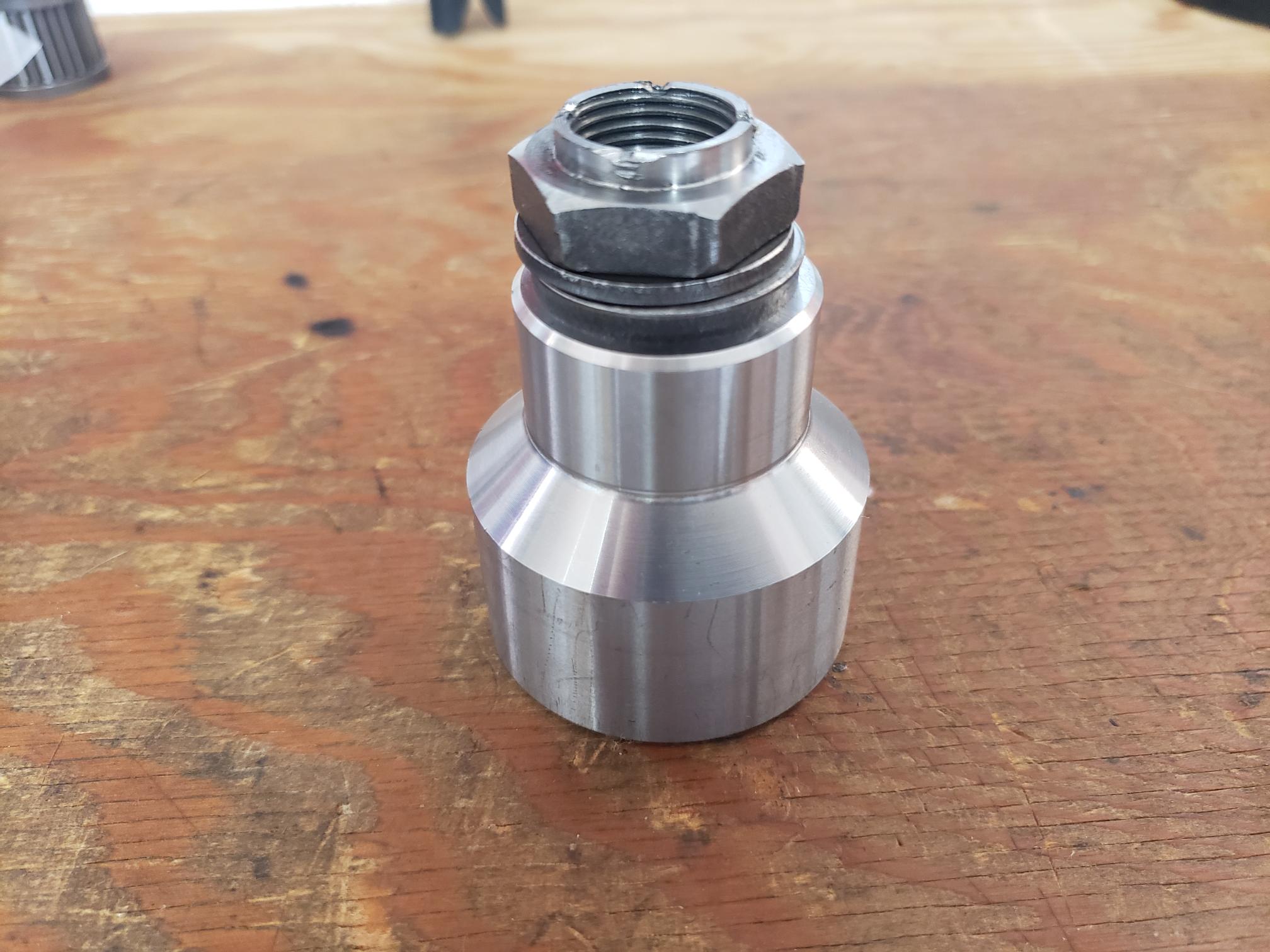

Small update here.

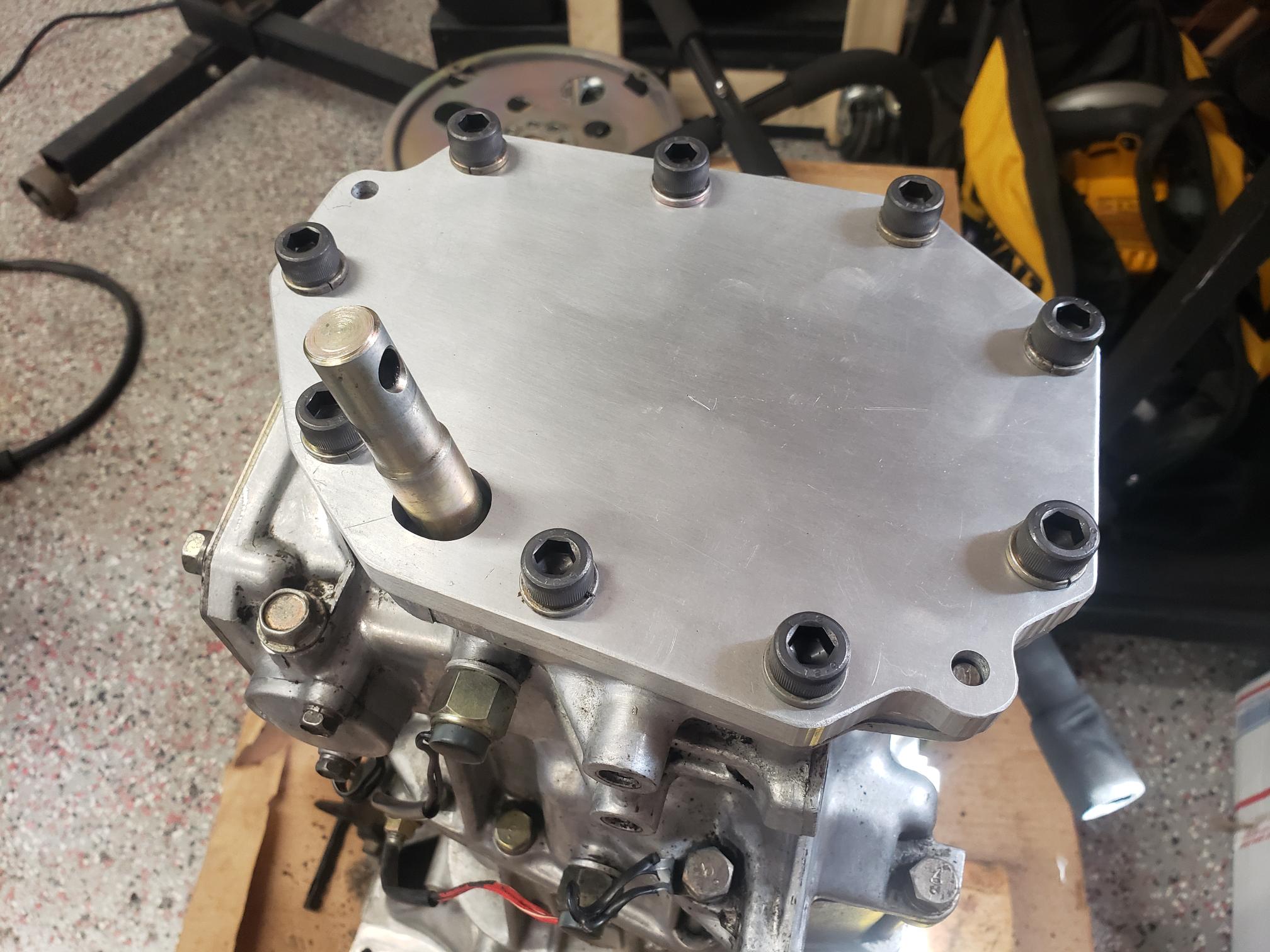

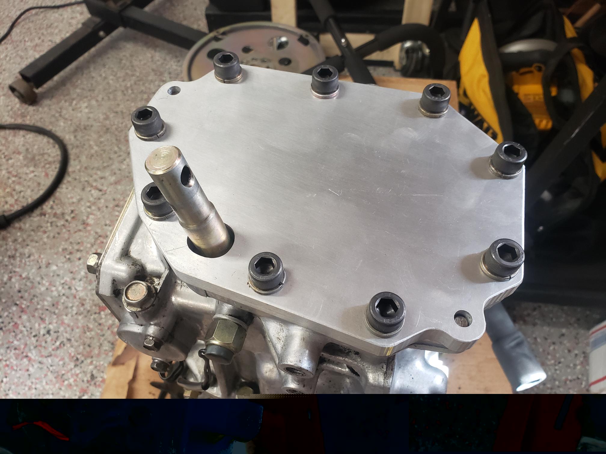

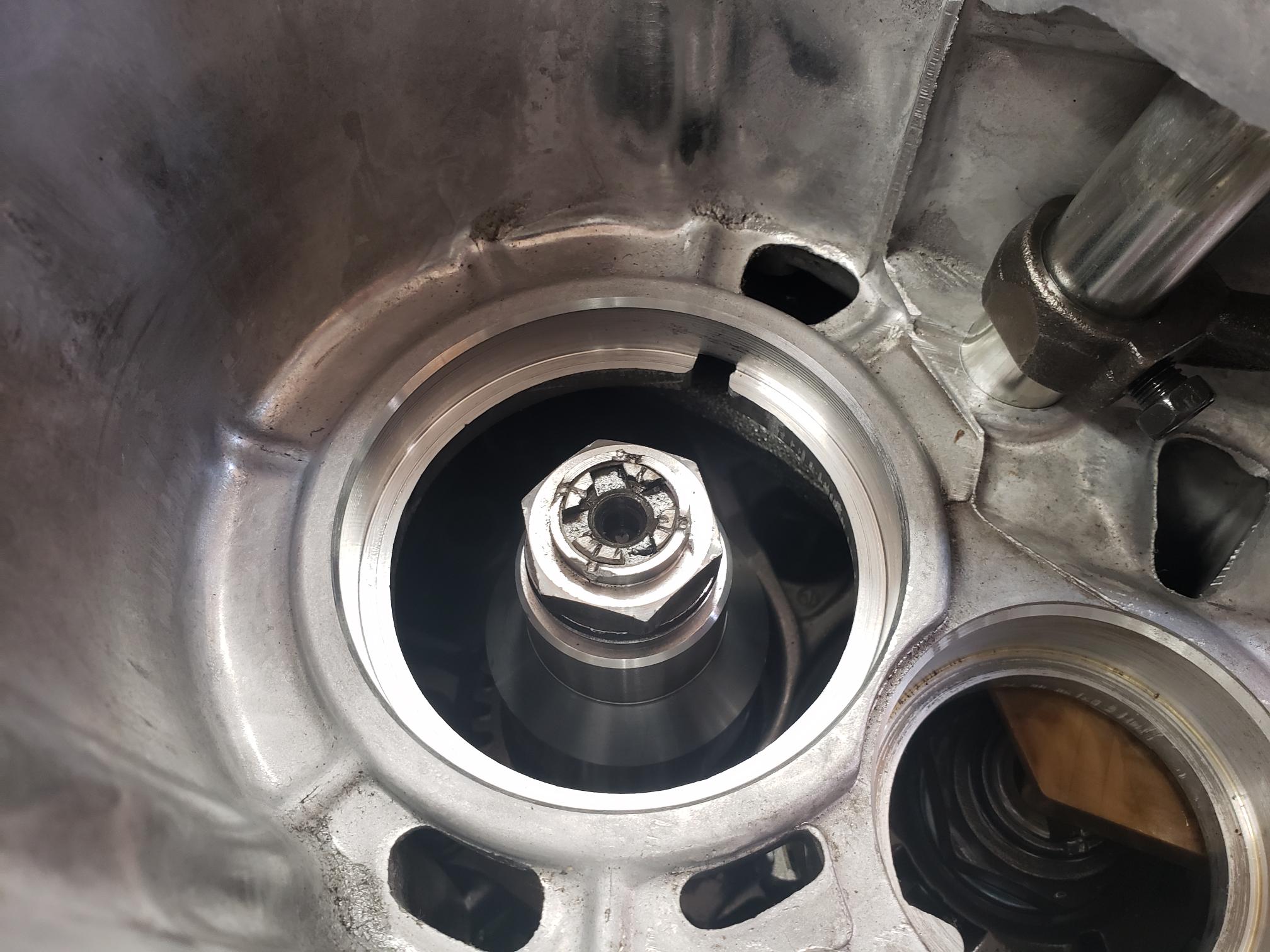

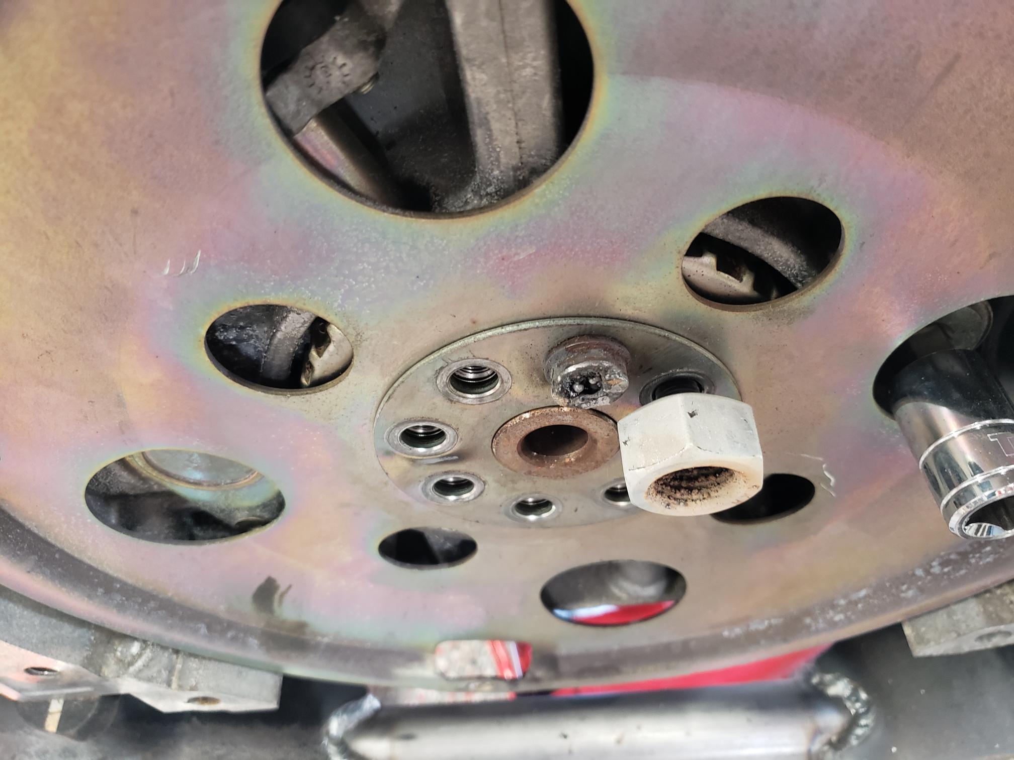

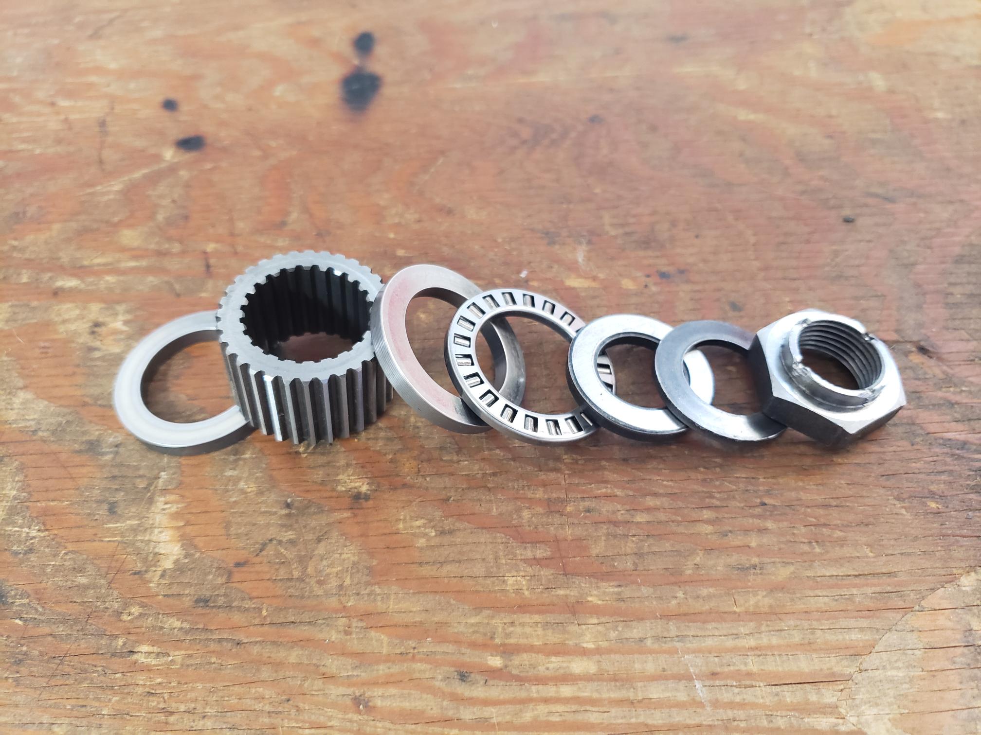

I had to remove the nut from the splined shaft in the transmission to put the spline lock in place. This is necessary to be sure all torque from the rear differential shaft goes to the front drive outputs. These are the bearings and washers.
Only need the washers and the nut to connect the lock:

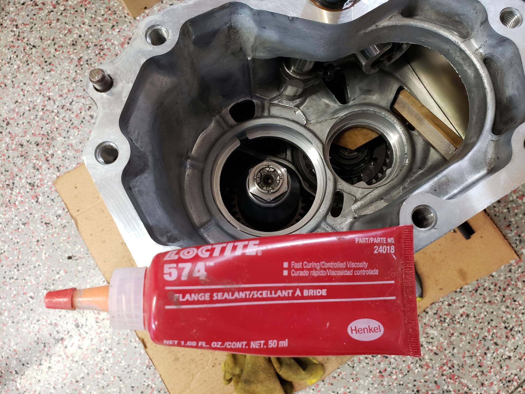

I had some flange sealant left over from resealing the balance shaft covers on my 944 Turbo, so I thought I'd try some here for the cover.

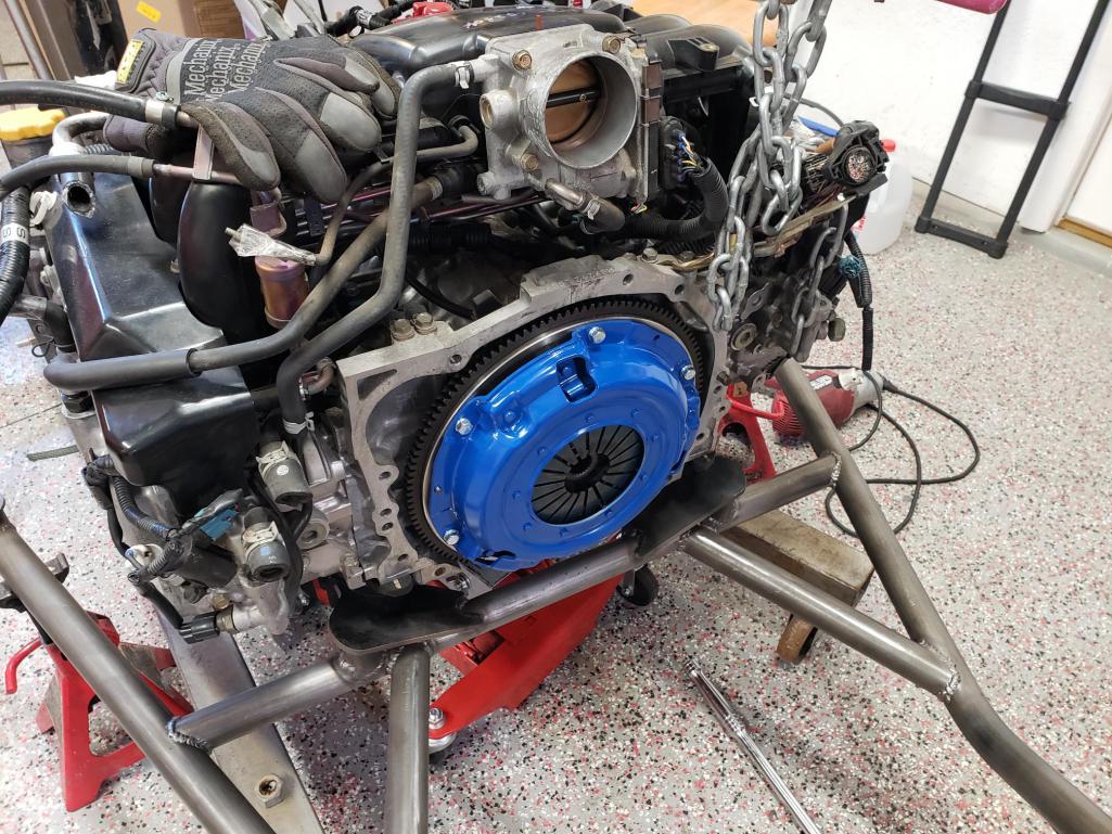

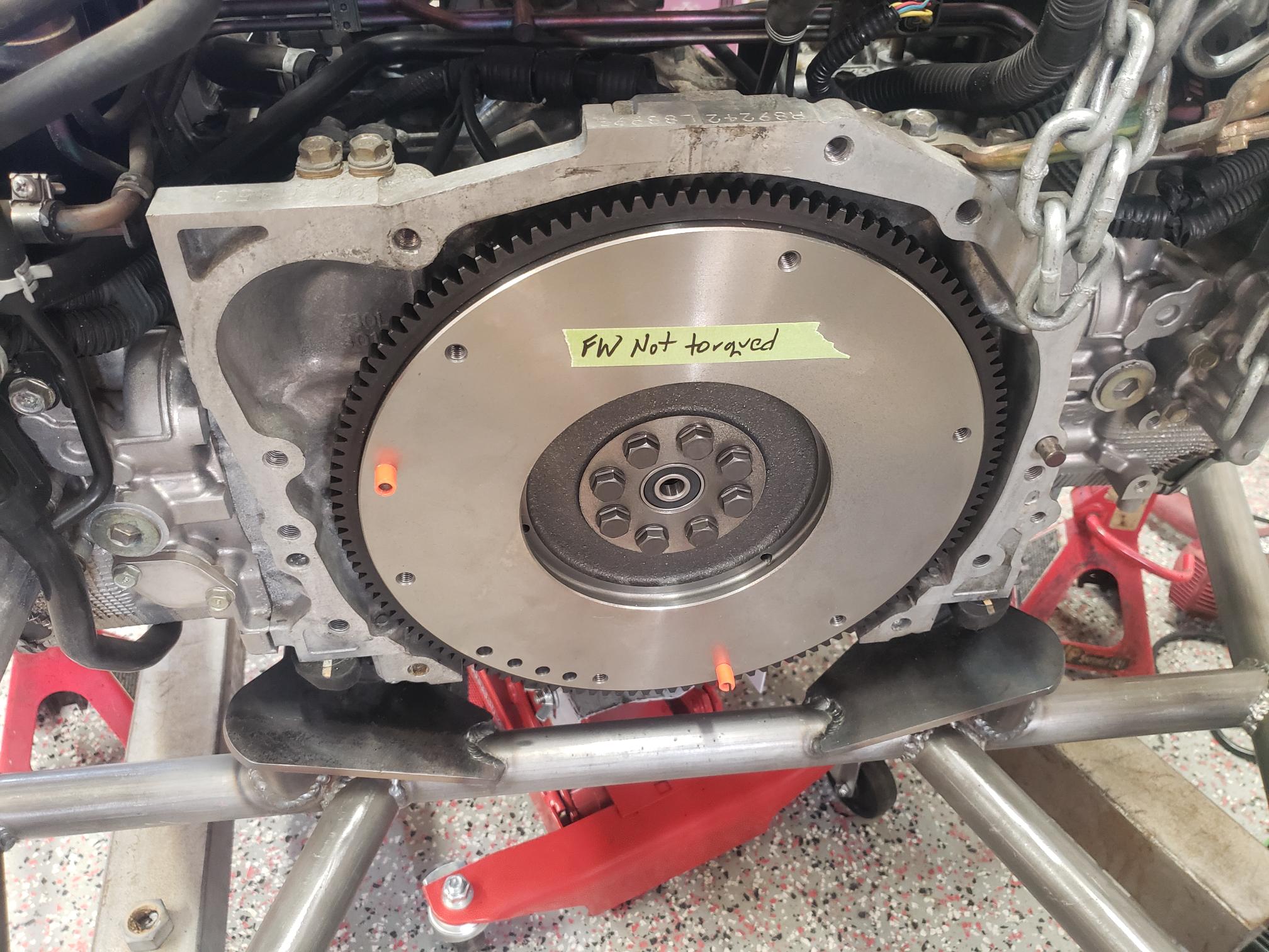

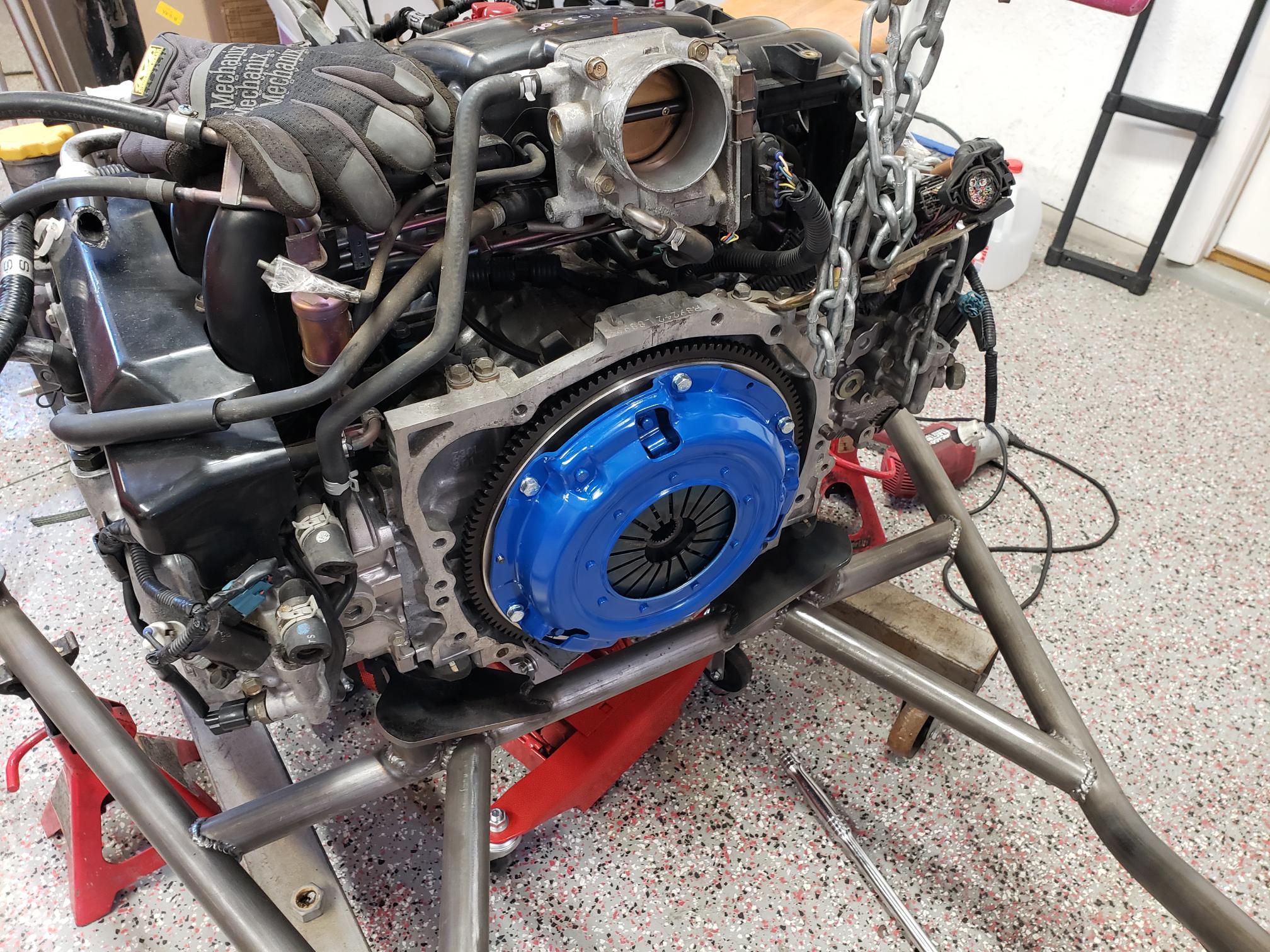

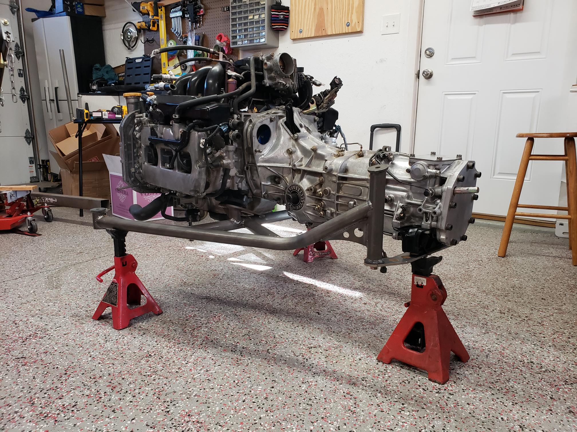

Anyway, time to remove the auto transmission plate to make way for the flywheel. I had heard the bolts were difficult to remove without damaging, and indeed I only got three of eight out. Thanks to a recommendation by rmarx here on the forum, I was able to weld large nuts on to the bolts and use a socket.
I had to order new flywheel bolts obviously, but even if I hadn't destroyed them, they are too short to make it through the flywheel thickness. No more torx bolts!
Run-of-the mill HD clutch in place.

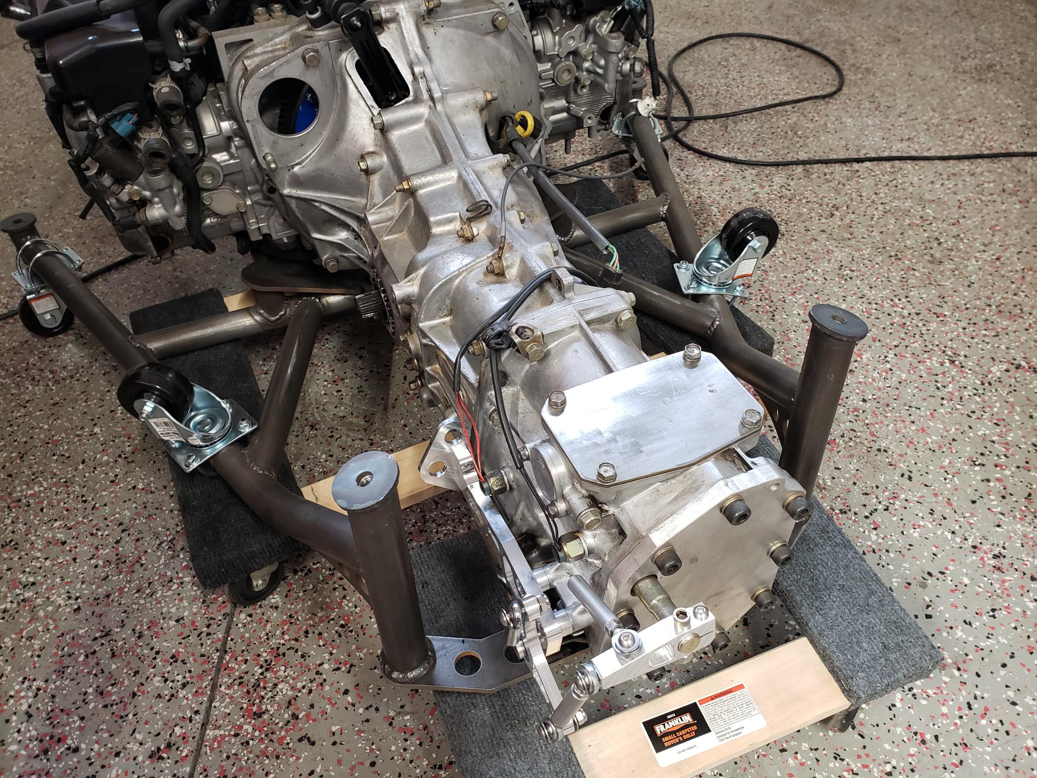

Big moment, engine mated to transmission and on the cradle. This is just in preparation for test fitting to measure out coolant lines and shift cables, but it feels great to see it at this point.

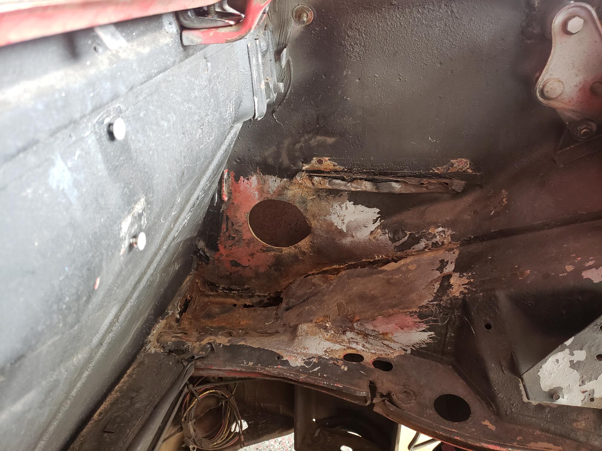

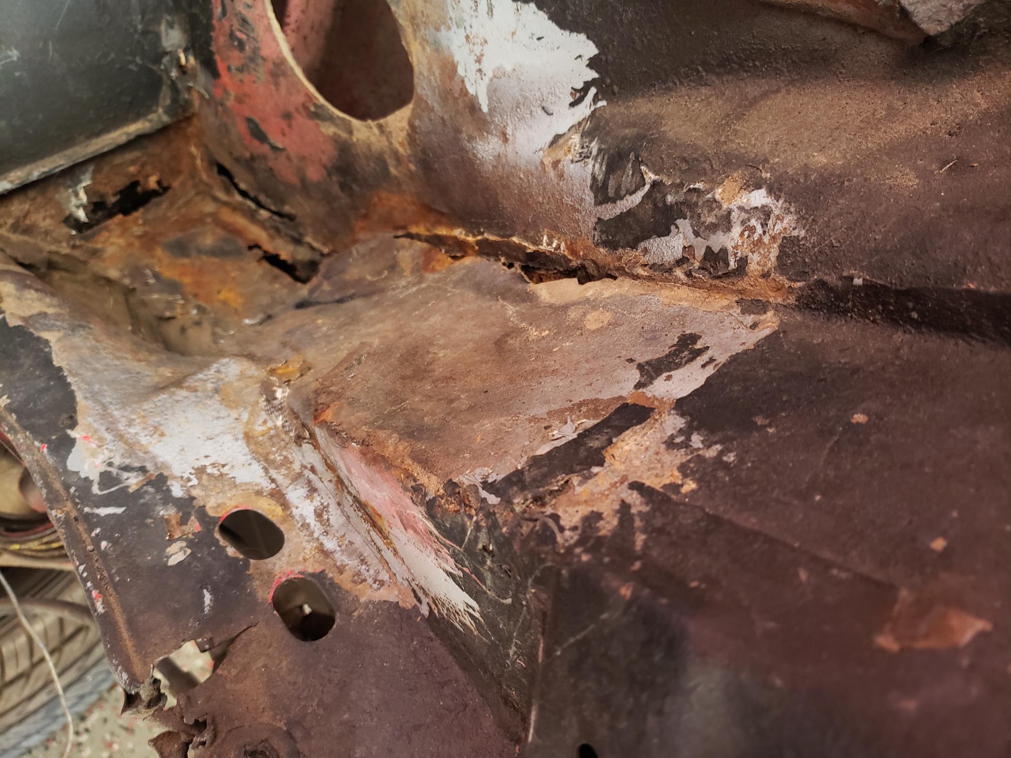

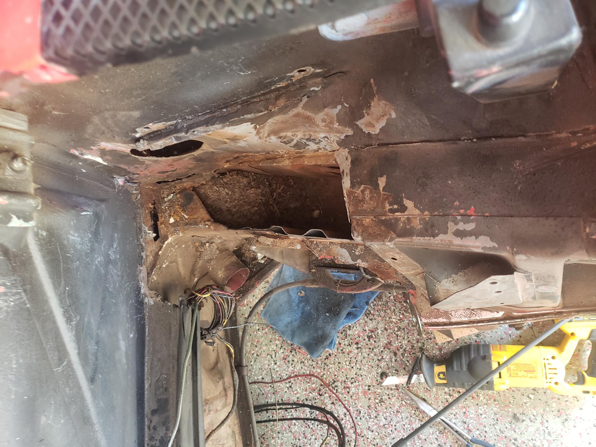

After removing fiberglass installed by a PO:
First cuts reveal more mouse nests. I would say a rodent infestation is a lot like rust; worse than you think:
More trimming and cleanup work. Not pictured is a small metal patch I did on the bottom of the rocker, and then rust treated and POR-15 coated the inside of the long:

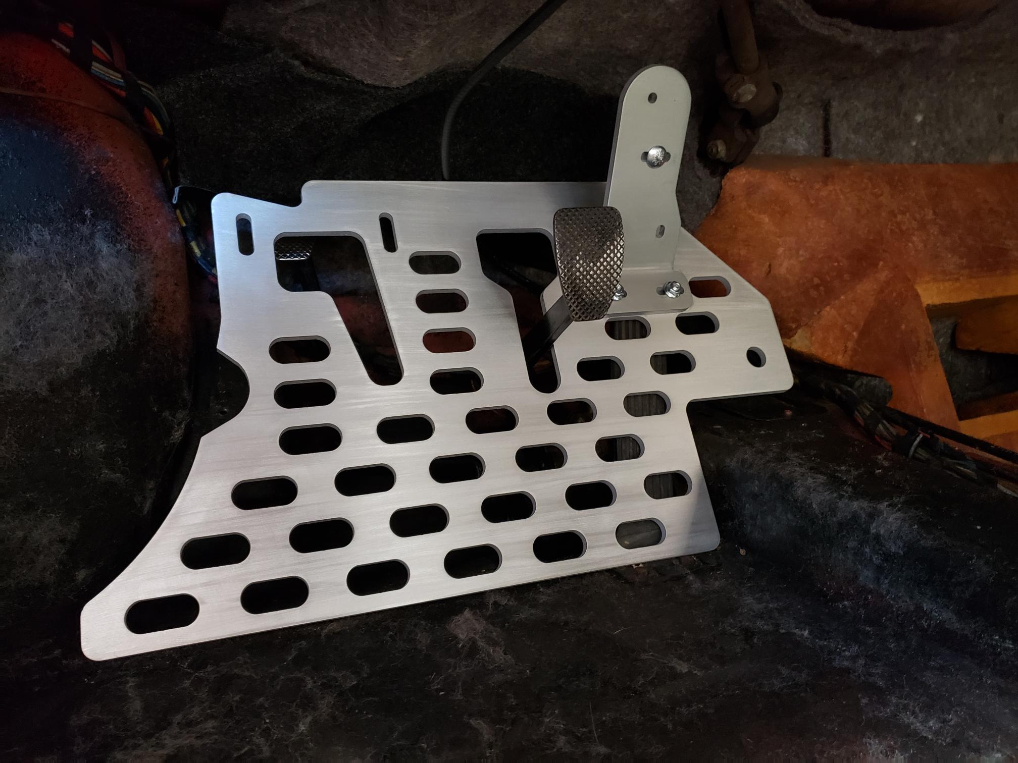

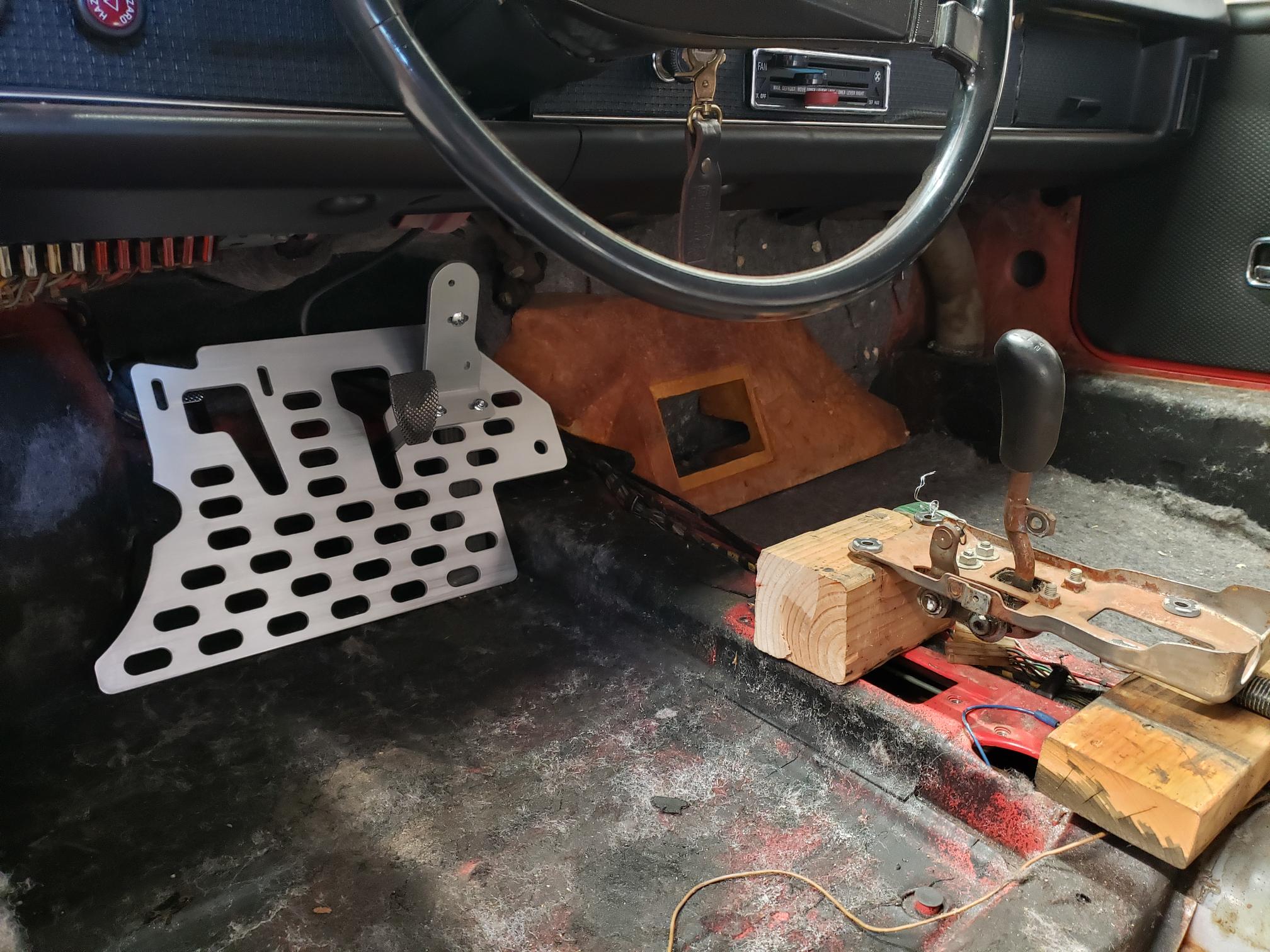

Also got my DBW pedal board from JWK Engineering:

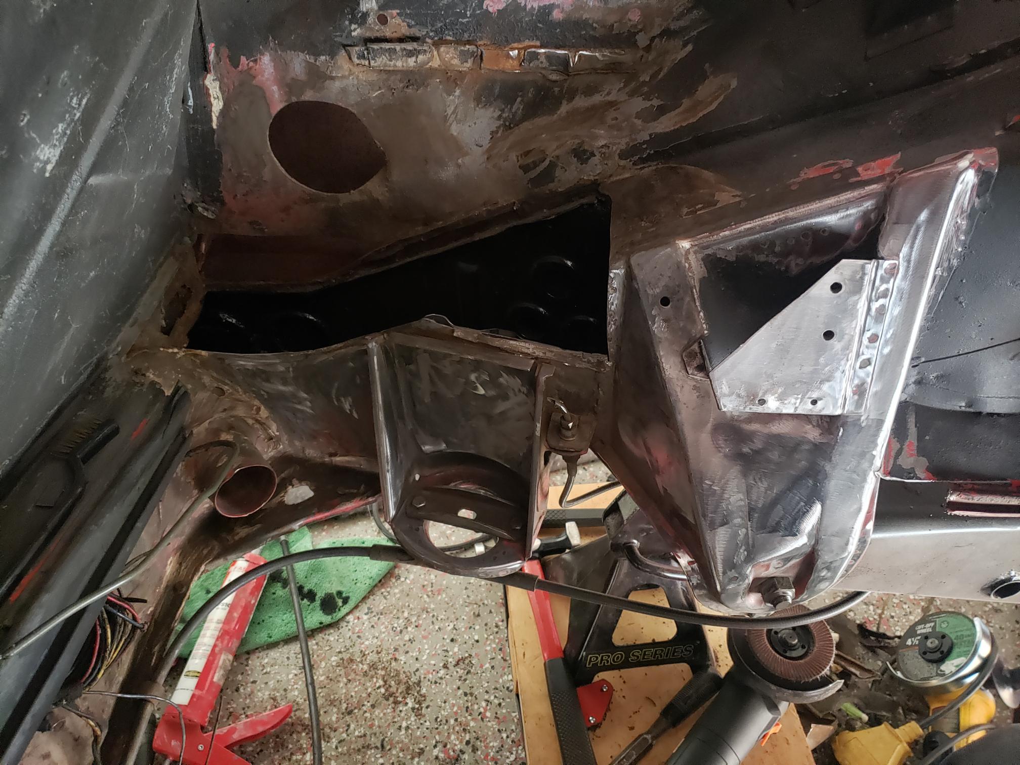

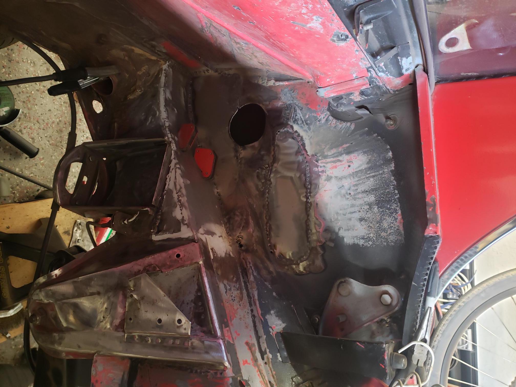

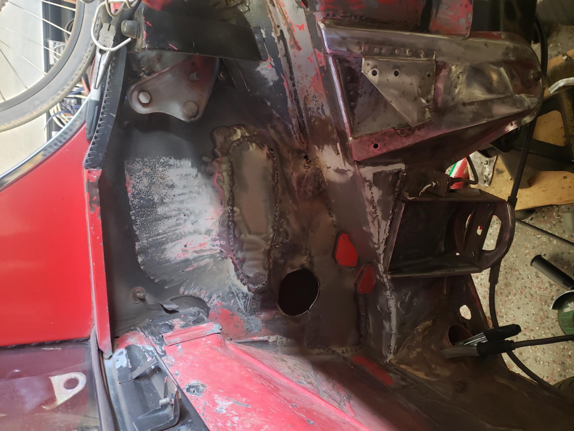

Latest update is that the engine bay rust repair and general preparation for primer is taking quite a bit of time. But I'm determined to get it prepped pretty well and primered before I put the engine in for the first time.
The rust repair in and around the hell hole has taken the most time, but ironically it's the undercoating that I sprayed into the engine bay shortly after getting the car that is slowing me down now. It has to be scraped off a bit at a time and it's just about taking forever. People complain about what the PO (previous owner) has done, but what about fixing the wrongs of the CO (current owner)? Anyway, a few pics:

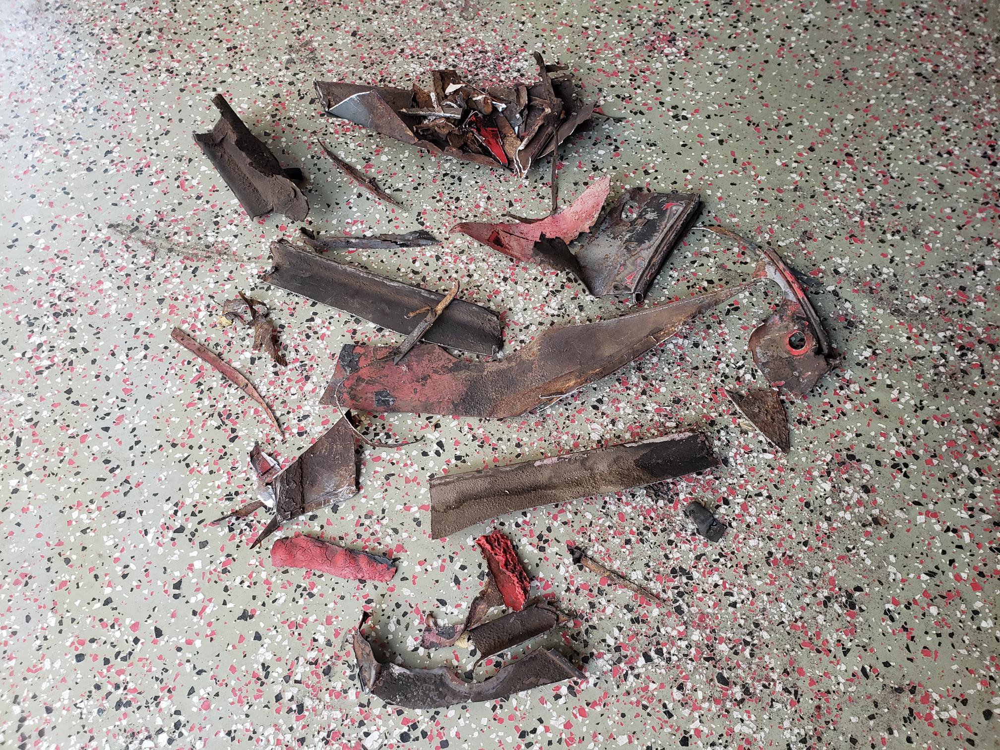

Most of what I cut out:
Where it's currently at. Still more welding to go, then POR-15 the welds, then seam sealer, then primer:

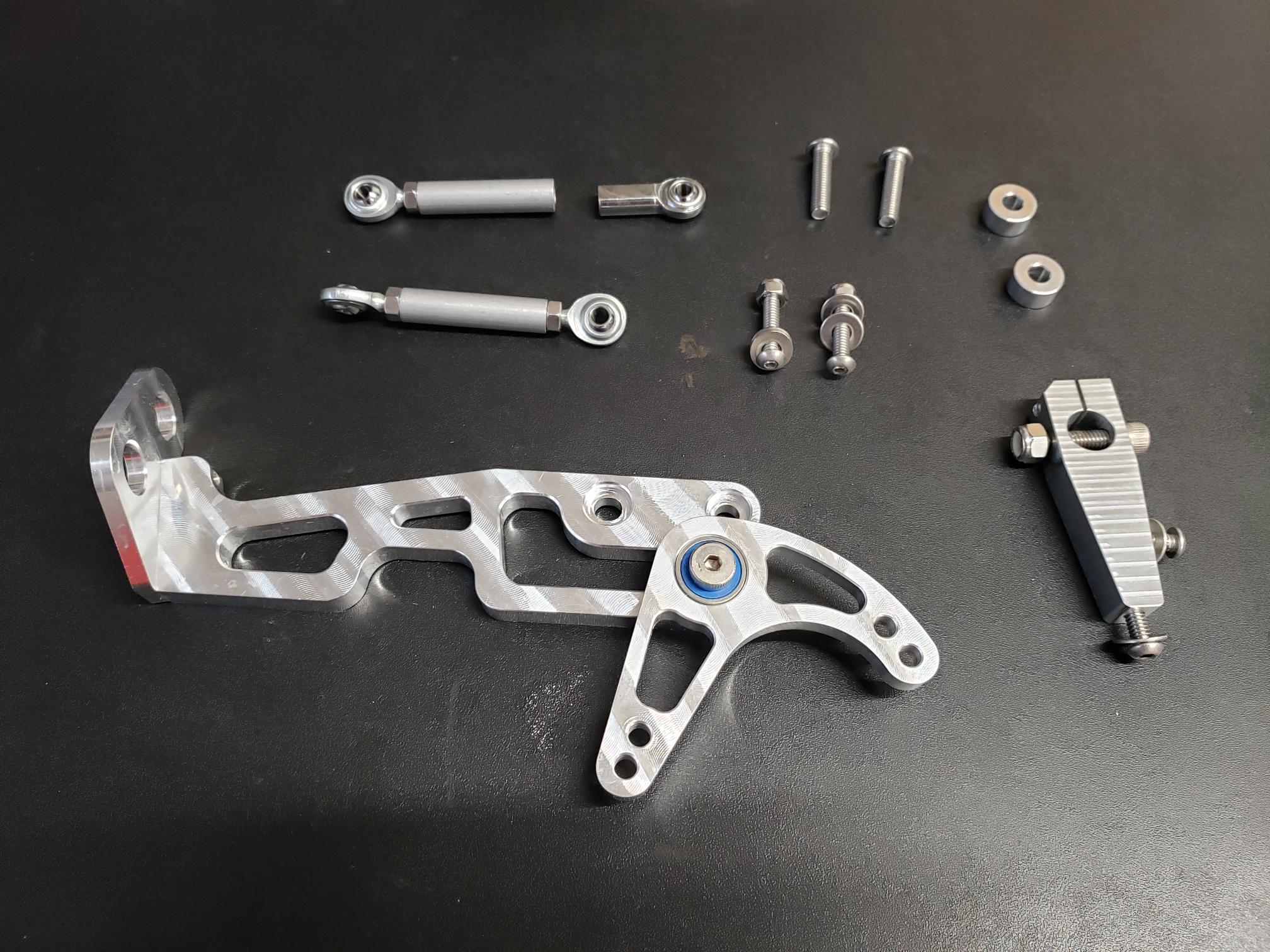

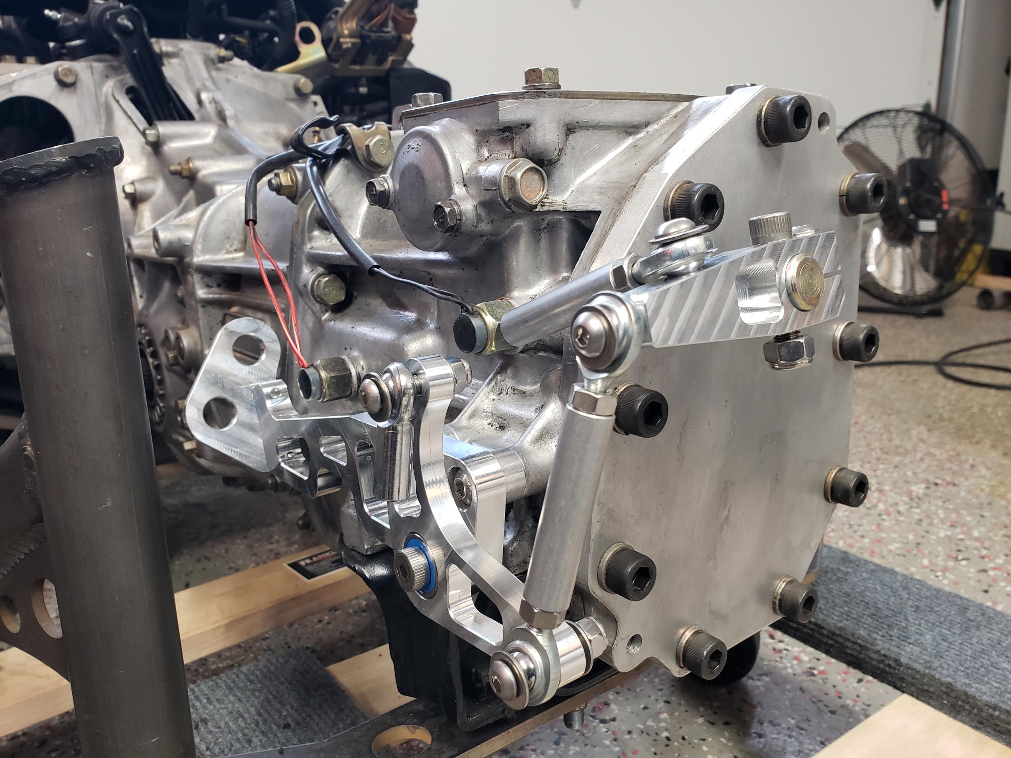

The latest part to arrive is my Zero Decibel Motorsports bell crank for the cable shift to the Subaru transmission. Very nice looking piece:
