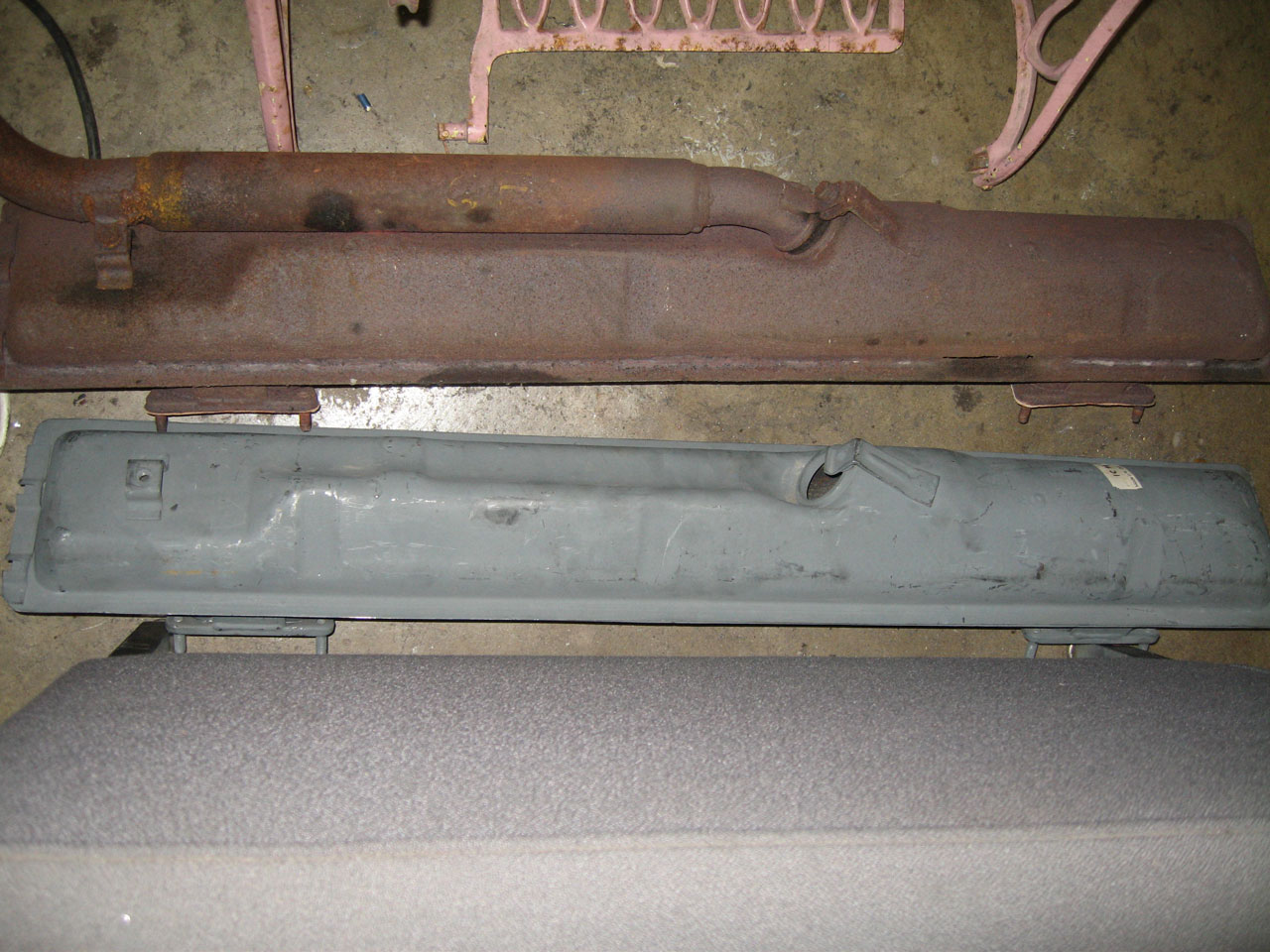

here is the original factory 914 muffler that was once on my car.
its a 74 1.8

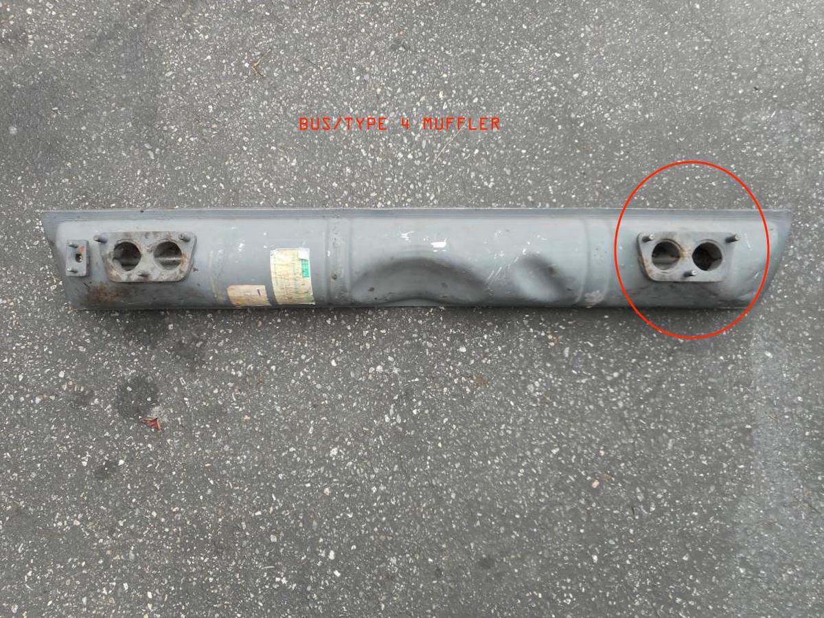

here is bus (or late 412) single piece german factory muffler.
notice how the VW application has the inlet flange plates welded at 180 degree rotation to a 914.
they used the same basic muffler but that was the difference.
this allowed the 914 to retain its lhs tailpipe location in these later single piece mufflers.
the bus and the type 4 exited on the rhs.

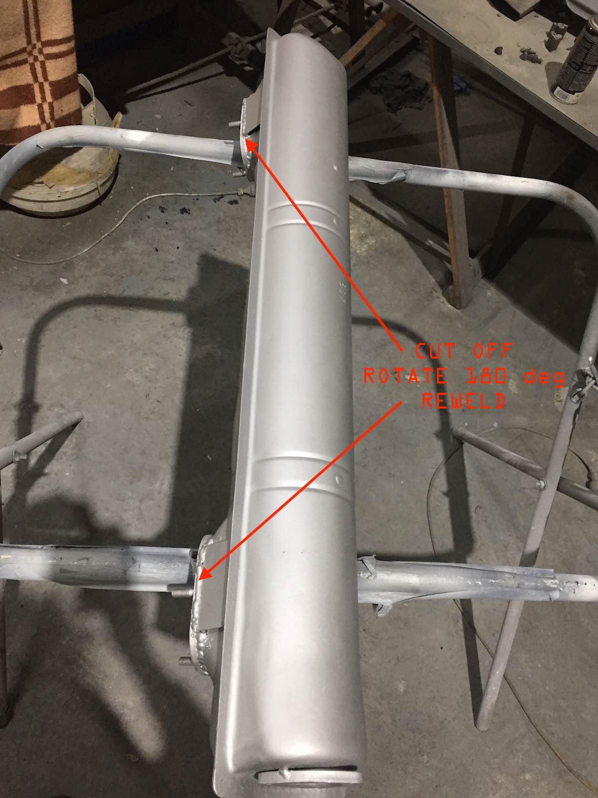

or you can do what i did which was modify the bus muffler and cut the inlet flanges off
and reweld them back on 180 degree rotated.

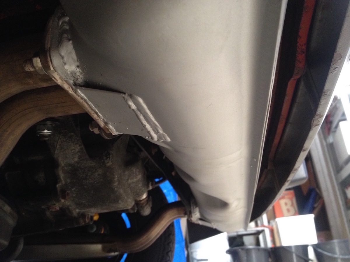

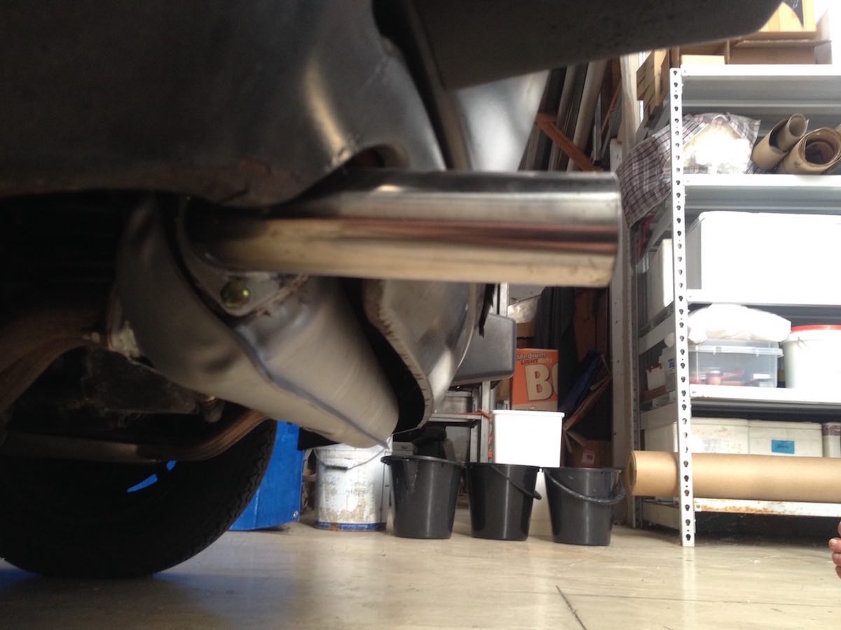

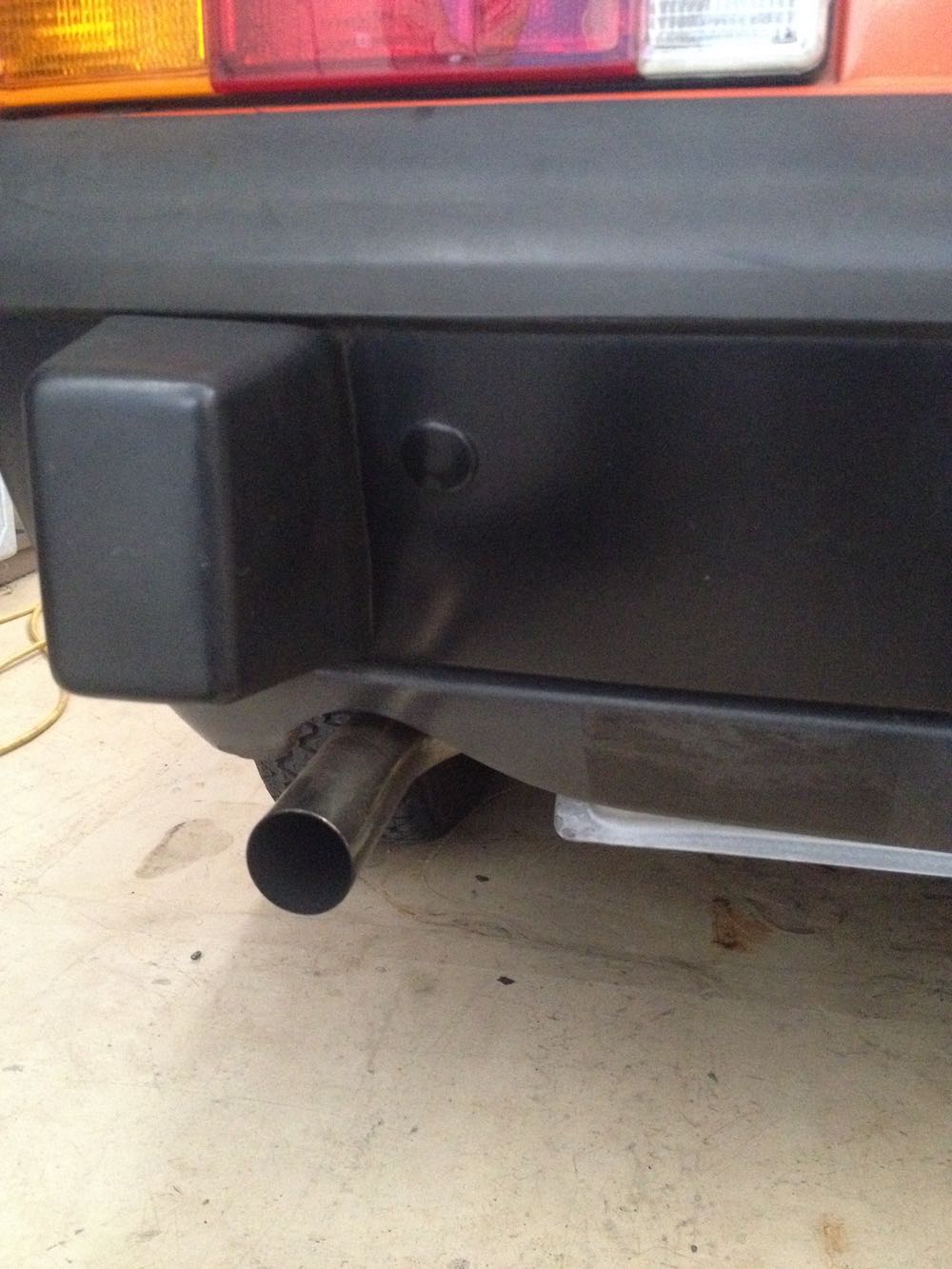

here are some photos of back when i modded the bus muffler.
about 4 years ago.
i did run it unmodified for a while before that with a modded tailpipe out the rhs just for convenience when i first had to change the muffler. (that was when the penny dropped about the rotated flanges. when we first looked at the muffler both my mechanic and i thought, aha its just a bus muffler. but then after getting hold of one and going to tfit it we both said, oh no its not quite a bus muffler. (IMG:style_emoticons/default/smile.gif) )then i took it off and did it properly a bit later on.
the photos have reminded me we did a bit of reinforcing to kind of duplicate how the 914 mufflers have reinforcing plates from the flange back to the muffler body.
we did "sturdy" plates but given the muffler pretty much hangs of those flanges even though the flanges are suspended from the hanger off the gearbox i figured i'd make sure it did not vibrate so much it would crack the flange welds down the track.
it all works really well except the exhaust does sound very "tinny" until it warms up.
i put that down to the SS heat exchangers in addition to this SS muffler.
doesn't have that deeper tone that the mild steel exhaust systems have.

QUOTE(wonkipop @ Dec 20 2022, 04:14 PM) *
a bus muffler is different.
I see what you're saying. I can definitely see how the first pic you posted that wouldn't work on a bus since the indents for the engine tin by the fan and the dipstick indent are below instead of above.
But are you sure the bus muffler won't bolt up and work on a 914?
I know the 1.7L muffler was the same muffler for both - almost sure anyway.
The rusty one here came off my 72 914 which has a snowplow valence. Both of these are the same. The tailpipe lined up with the hole.

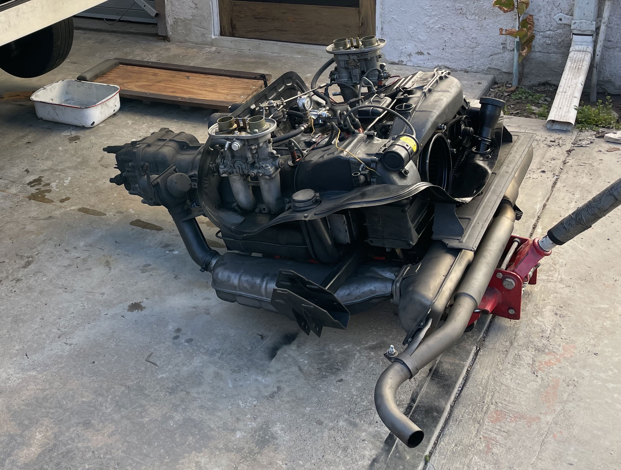

Here is the nos muffler above on the engine of my 72 bus.
(IMG:http://www.914world.com/bbs2/uploads_offsite/www.thesamba.com-21899-1671587553.1.jpg)
I'm thinking maybe the tailpipe of the side exit 1.8 bus muffler can't be made to work with the 914 valence? I know it's triangular/3 bolt, and could go 3 ways(?) I've run the Ernst before but I don't have one currently to check..

@nathanxnathan .
yes the bus muffler will bolt straight up.
take a close read of my post.
but the result will be a right hand side exit.
thats how it exits on the bus. and on the 412. after they went to the single piece muffler in either 73 or 74. definitely 74 but could have also been earlier in 73. that single piece muffler is a different ball game to the earlier style with the hot dog tailpipe you have posted. (note also your rusty 914 muffler does a real tight turn out before the left hand end of muffler to make the hole in the early valence).
it will do your head in in a dyslexic way but you will see that i am correct about the later single part mufflers if you look very closely at my photos. i should know i have held both items in my hot little hands and worked it out.
it is actually fine and if you did not care about originality - the smart move would be to make a modded valence with a right hand side dent and forever after be able to bolt a bus muffler straight up.
your photo is also correct. the earlier 411 muffler that the early 914s had is pretty much identical. the difference is that hot dog section is shorter on the 914s and turns out sooner. 411s seemed to have two different tail pipes - one that shot out more or less straight towards outside of car on left hand side and one that turned out under the back over towards left. i think one sort went of variants because they had a tailgate. this might have been the extreme left side exit. and the other type went on the fastbacks and sedans. at that time 914s, 411s all had left hand exit tail pipes. then VW went to right hand side exit on their 412s and buses. but the 914 stayed left hand side.
the key to understanding this is remembering that the flanges at the end of the heat exchangers on all the cars, 914s, 411/412s and buses is all in the same orientation.
2 bolts down. i bolt up tapering upwards. thats why the late 914 muffler had to be made with the flanges 180 degrees to the others, so it could still do the lhs exit.

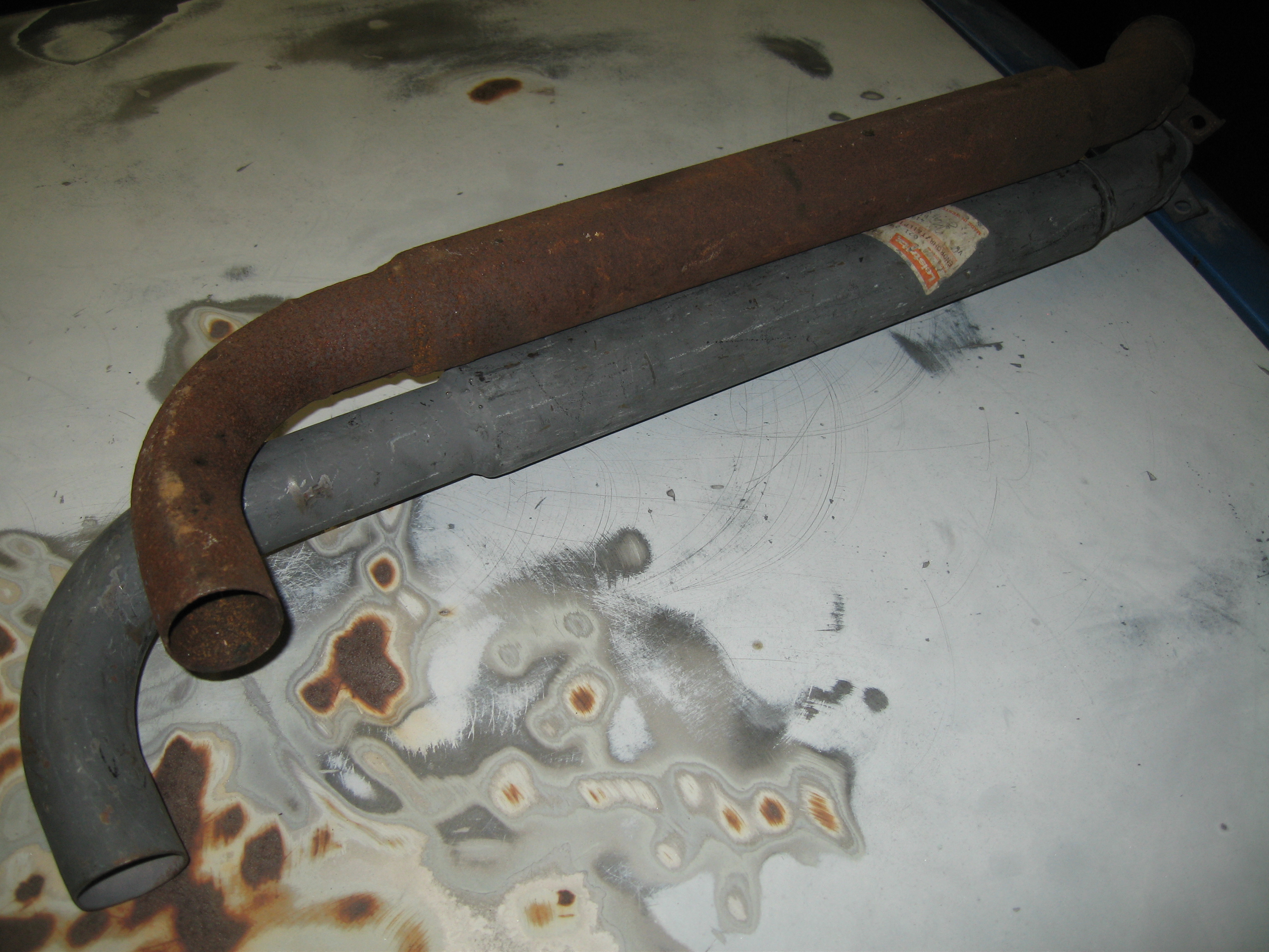

Here's a pic of the original 914 1.7 L center exit tailpipe (rusty one) vs the longer (411?) tailpipe.
The proper early type 4 bus tailpipe is actually like this, since I'm all showing off my early tailpipe collection. (IMG:style_emoticons/default/biggrin.gif)
