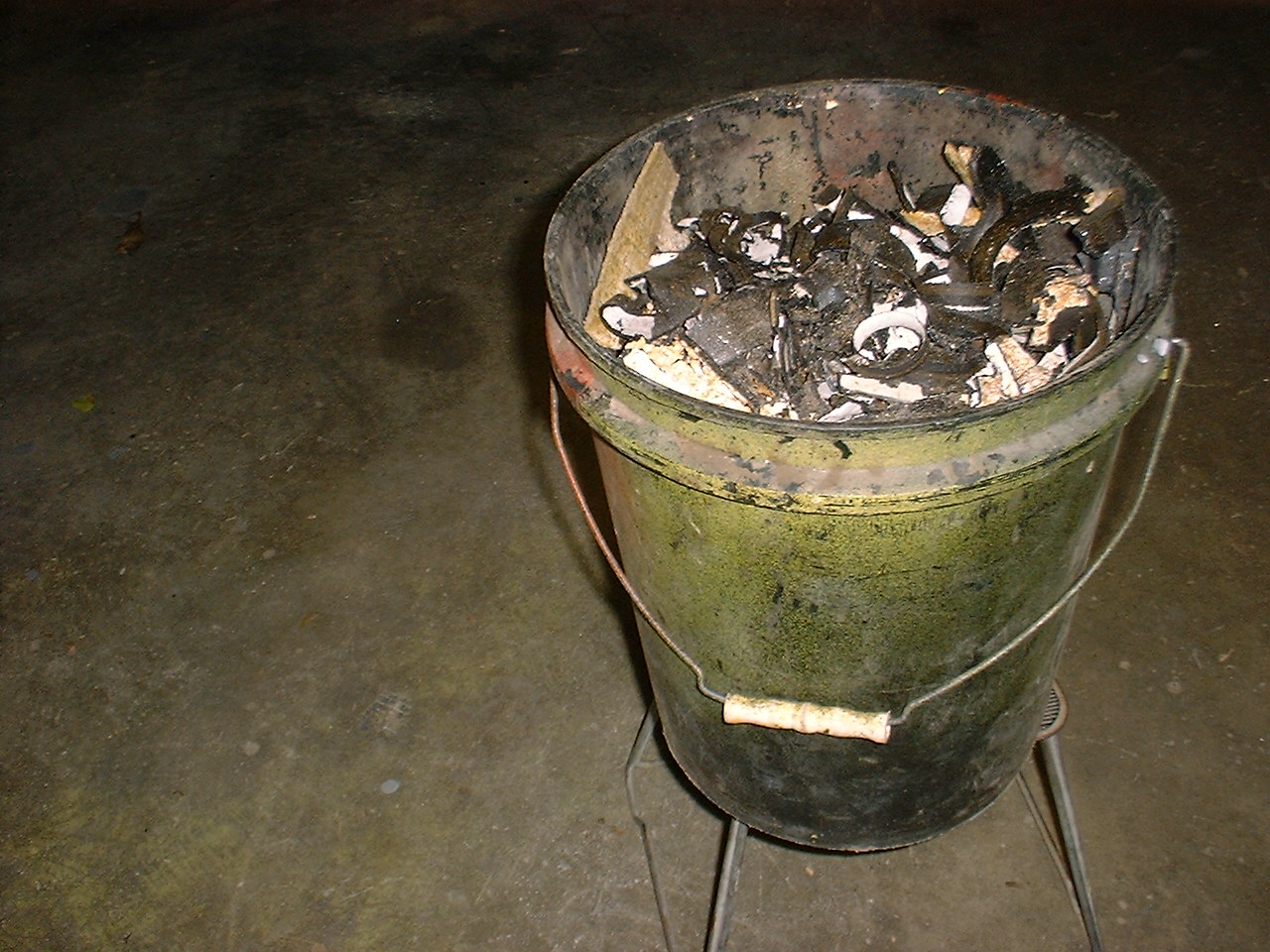

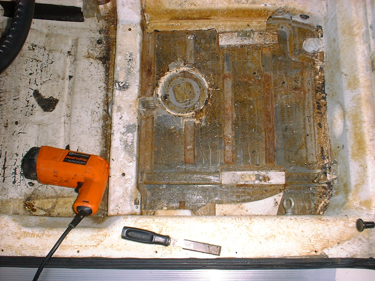

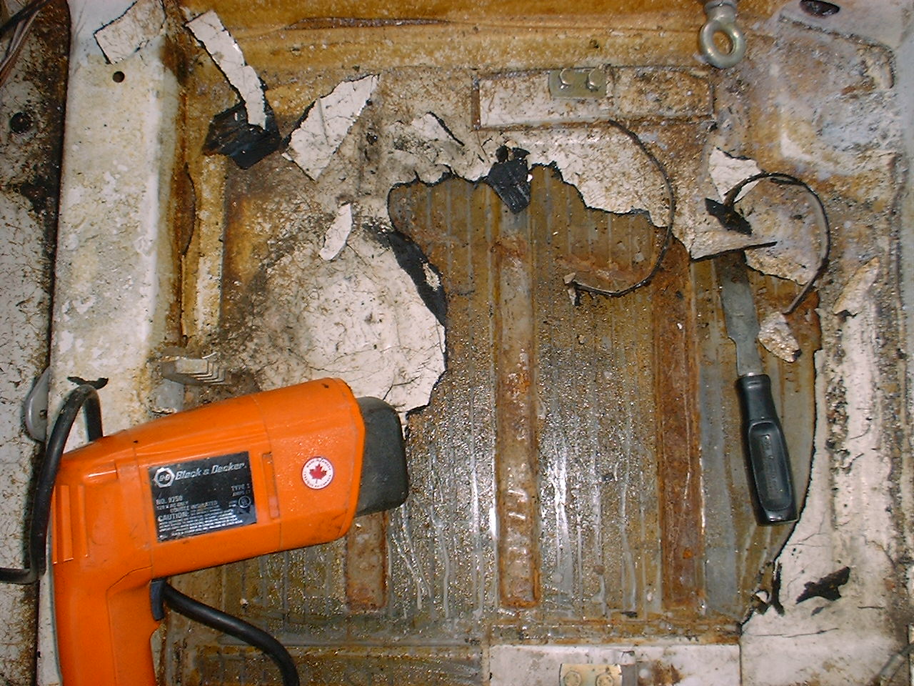

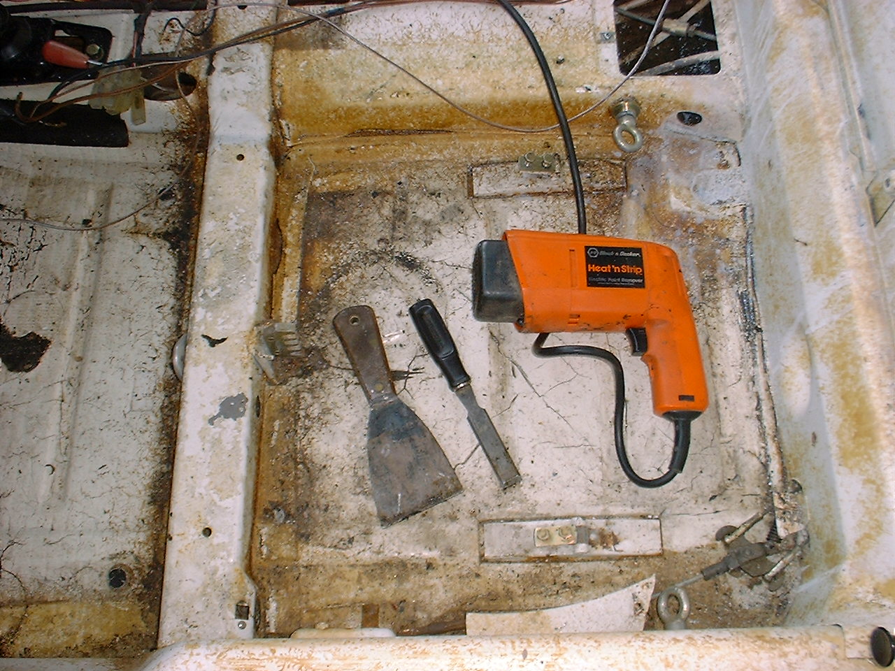

here are some pics from one I did long time ago via regular heat gun and chisel method...worked fine just takes a little time a patience...a little heat and comes right up...also it's an inexpensive method
it was also a study in weight saving for tracked 914s...see the 5 gal bucket...have the weight somewhere

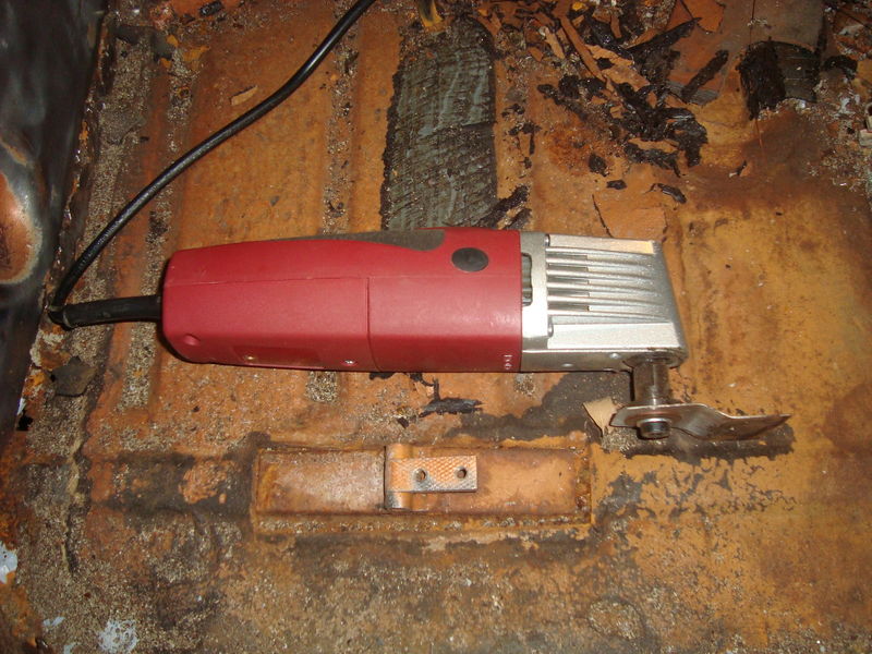

Incase it was overlooked, multi-tool! I will add a photo this time.
Read this post they said it worked very well.
http://forums.pelicanparts.com/porsche-911...method-yet.html
