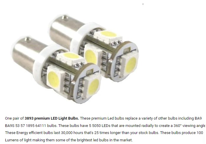

Not terribly difficult, this or similar.
(IMG:http://www.914world.com/bbs2/uploads_offsite/i.imgur.com-14731-1690998342.1.jpg)

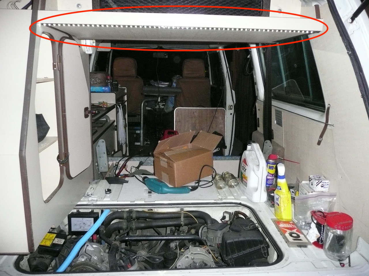

Have you thought about running a strip of self-adhesive LEDs somewhere across the inside of the trunk lid? ... (and tie the wires into the stock trunk light's wiring?)
I did this in my Vanagon so I'd have plenty of light if I needed to work in the engine bay at night ...

Replaced mine with one of these, bonus is low draw and low heat generation--pick the spectrum of color you want out of it and probably never have to replace it again.
https://www.superbrightleds.com/catalog/pro...lb-base-6959503
They have a bulb finder feature on that site and I had great luck with it (IMG:style_emoticons/default/beerchug.gif)

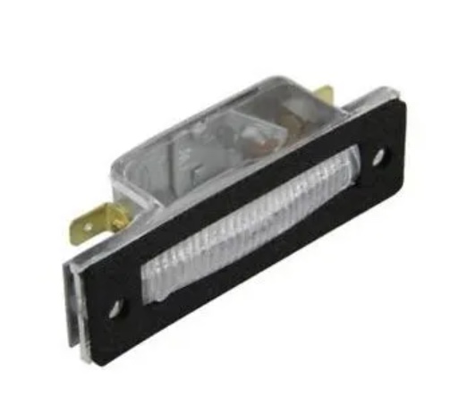

The BA9 bulbs won't fit the 914's OEM trunk light fixture:

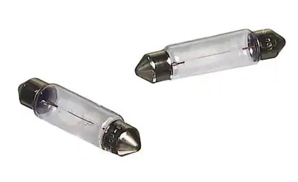

They take the Festoon type of bulb:

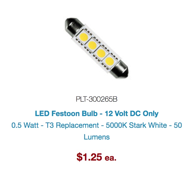

There IS an LED replacement for the festoon bulbs:
I have the LED Festoons in my Vanagon Westy and they're very bright. However, the 914's trunk light fixture has a really small lens, so even with the LED bulb, it won't illuminate the trunk very much (IMG:style_emoticons/default/shades.gif)
