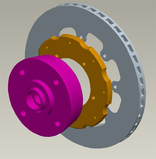

Looking for local early (3" caliper spacing)
I placed an order with Wilwood today for a pair of their 12.19" diameter vented rotors along with the aluminum mounting hats.....
The factory 911 rotors are one piece, with the rotor and the hat cast as one piece.
The reason I went with the 12 inch rotor was to make it easier to bolt on the 4-pot rx-7 calipers....another 914 owner here welded on new caliper brackets, but I didn't want to go that route (I might weld new brackets for the trailing arm, but I didn't want to play around too much with the front struts)
I'm hoping these new rotors will fit a 911 strut and allow the same rx-7 calipers to be used.....

Aaron Cox   do these use the super cool billet hubs?   Feb 17 2005, 04:07 PM
Mueller   <...   Feb 17 2005, 05:01 PM

Jeroen   Mike, how thich are those rotors?   Feb 17 2005, 05:14 PM
neo914-6   It's not going together anytime soon[QUOTE] Ho...   Feb 17 2005, 05:18 PM

TimT   Mike you will have to make some spacers, and space...   Feb 17 2005, 05:48 PM
Mueller     Feb 17 2005, 06:03 PM
TimT   its no biggie, but you will need a spacer. I have ...   Feb 17 2005, 06:11 PM
Mueller     Feb 17 2005, 06:16 PM
chunger   betcha could make it clear the A-arm if you scallo...   Feb 17 2005, 06:59 PM

Jeroen   Tim, what's the deal with the 944turbo rotors ...   Feb 18 2005, 05:58 AM
TimT   Jeroen, I have this brake set up on my 911. With ...   Feb 18 2005, 07:06 AM
