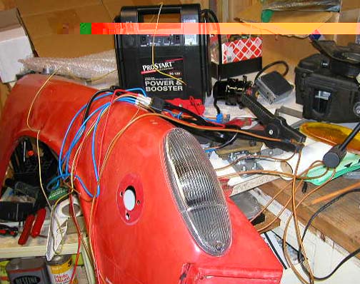

Here's my test set up, fully charged porta-battery, jack leg wiring, harness is actually virtually plug in play but I may have to extend some wires...

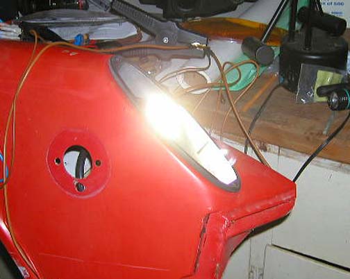

Houston, we have ignition. Ballasts have a whine at warm up but there also no engine sound right now...

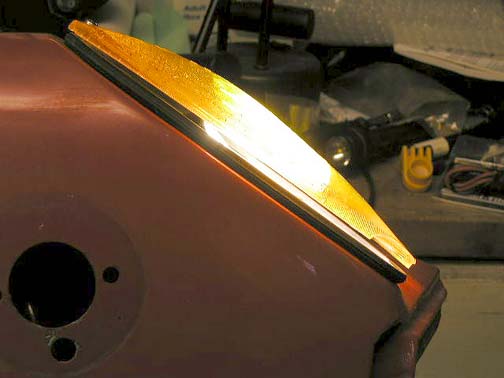

The experimental filled lense from Bruce. It won't lay flat because it's not concave anymore.

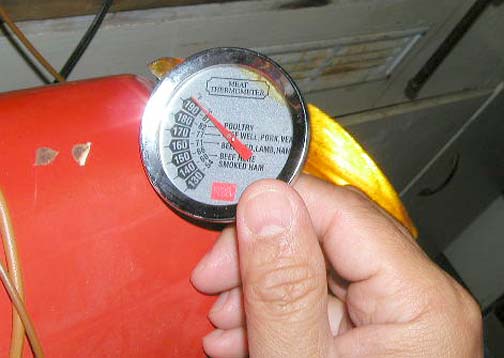

Temps were measured by a meat thermometer thanks to Andrews but it maxed at 190F so...
Filled resin was soft and warm to touch after minutes. I had the lense mounted and light on for 30 minutes and after removing it, I could dent the filled resin and it would return to flat. (IMG:http://www.914world.com/bbs2/html/emoticons/huh.gif)
I may need to leave it off for night use and install a clear lense for day time and shows...
Maybe design a retractible lense. (IMG:http://www.914world.com/bbs2/html/emoticons/laugh.gif)
