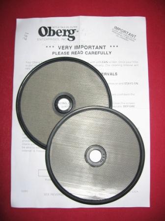

what are the differences between these and say a Fram. Can you clean them?

Yes I had an Oberg on my old racecar, currently I use Canton filters. The Oberg you can clean, and you can also buy differnent filter media ie 5 micron, 8 micron etc. |

Yes, it is a basicly a screen that you take out and clean. |

here is the filter screen

here is the housing
sorry small pic Attached image(s)

They run about $200.00.
