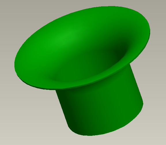

Slightly warmed up /4 motor applications...I'm thinking just about any design better than none at all....I'd like to metal spin these myself, however if I can get a good price on 8 from a fellow non-club member, I'll go that route (IMG:http://www.914world.com/bbs2/html/emoticons/smash.gif)

Thorshammer   The outer lip needs to be rounded. The edge is ver...   Apr 4 2006, 09:05 PM
retrotech   I tested air flow with vacume cleaner suction & sm...   Apr 4 2006, 09:48 PM
Twystd1   YUP... What everybody else said about the rounded ...   Apr 5 2006, 12:43 AM

fin   I believe the formula for a proper roll on the mou...   Apr 7 2006, 08:16 AM
