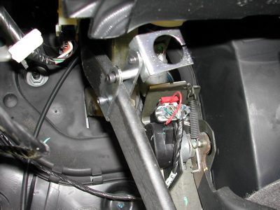

Today got done with my job, and got to work on a few items before they depart. My Truck is heading to Florida for 6 weeks with a trailer in tow. I decided it was time to upgrade my brake controller, I did some research and came up with this.Jordan Brake Controller.
Installed hope it works, will test with their trailer tomorrow. So here we go step one install the cable mount on the brake pedal, yep it uses a physical attachment to measure brake application. Big plus when pulling in the mountains. Attached image(s)

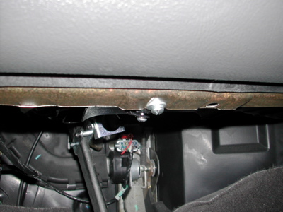

Next is the cable guide, thank you GM you gave me the perfect hole palcement predrilled.

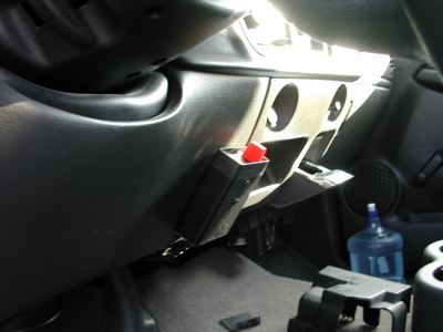

Next mount the controller - it has two screws, had to drill the dash (IMG:style_emoticons/default/mad.gif)
Tried to get it into one of the many pockets on the truck - could not because of cable routing. Attached image(s)

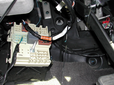

Route the cables and plug in the factory wiring harness, all done.
