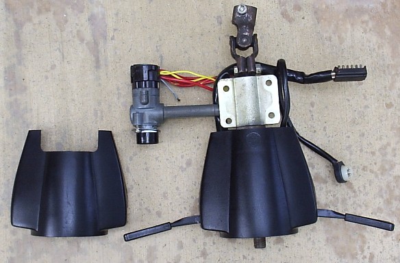

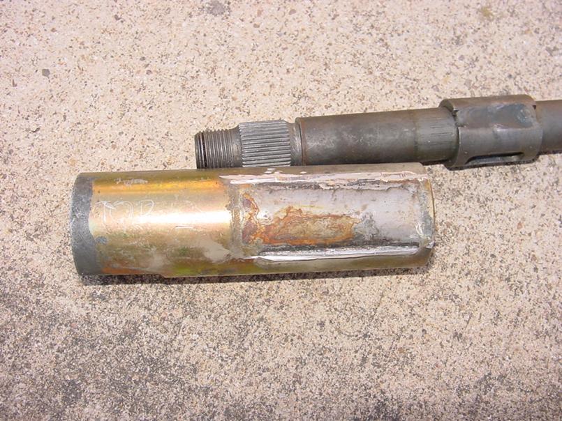

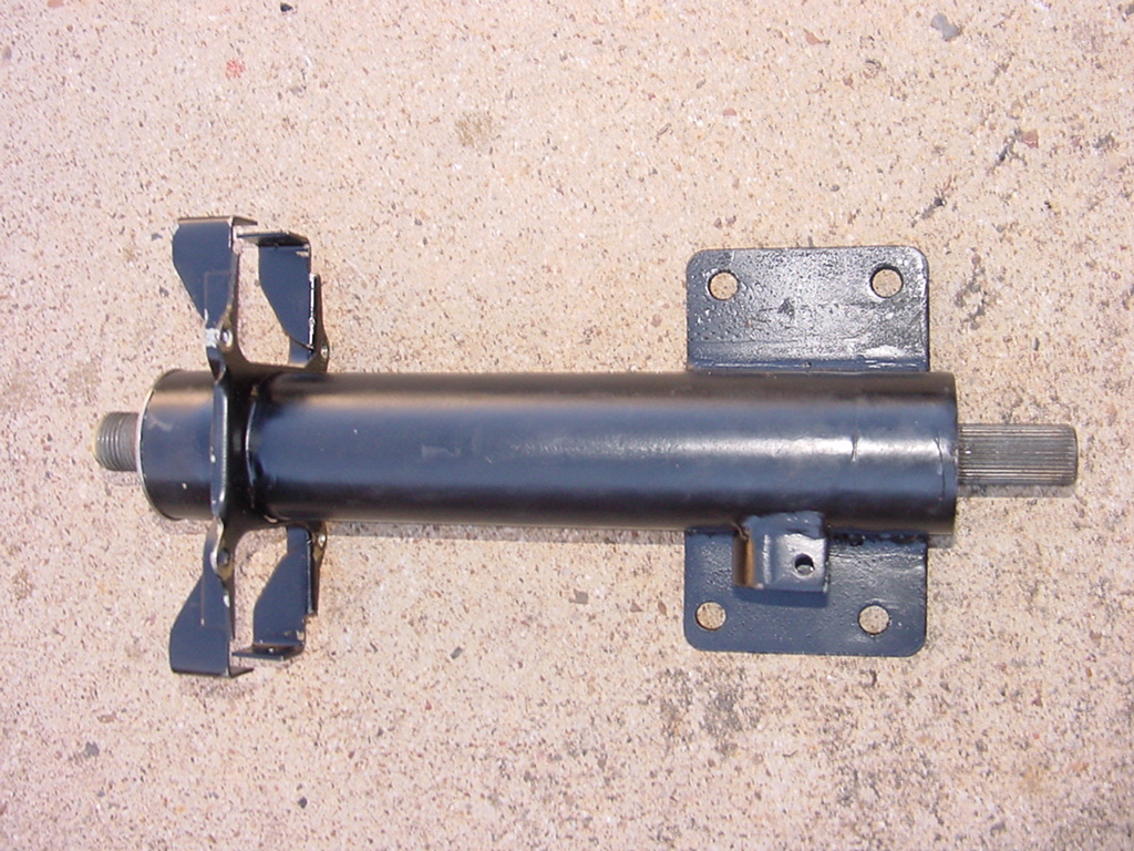

Start with a 4 cylinder column. Remove the mounting plate from it.
Pict is of the leftover column tube. (IMG:style_emoticons/default/sawzall-smiley.gif)
Now you have just the column mounting plate.

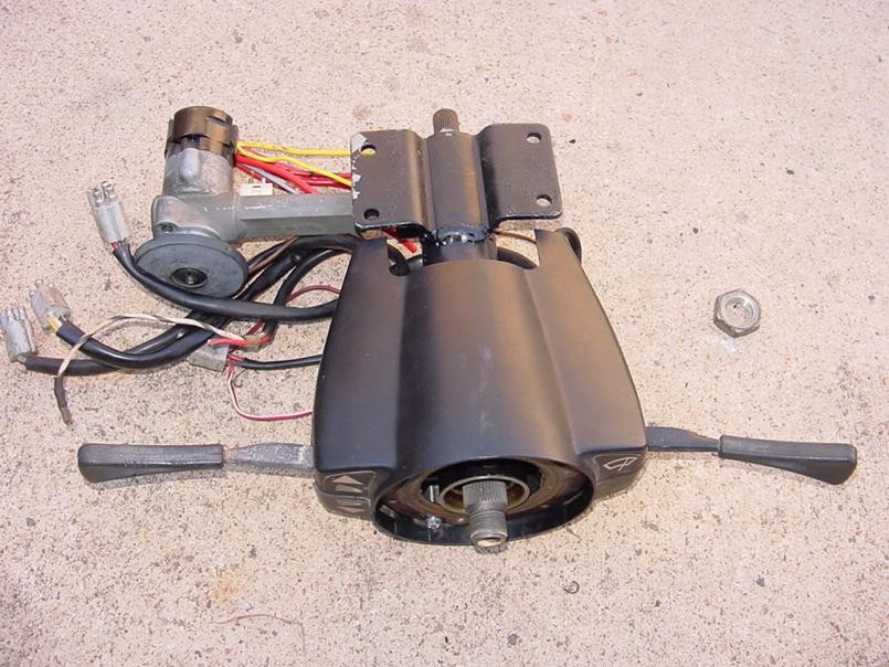

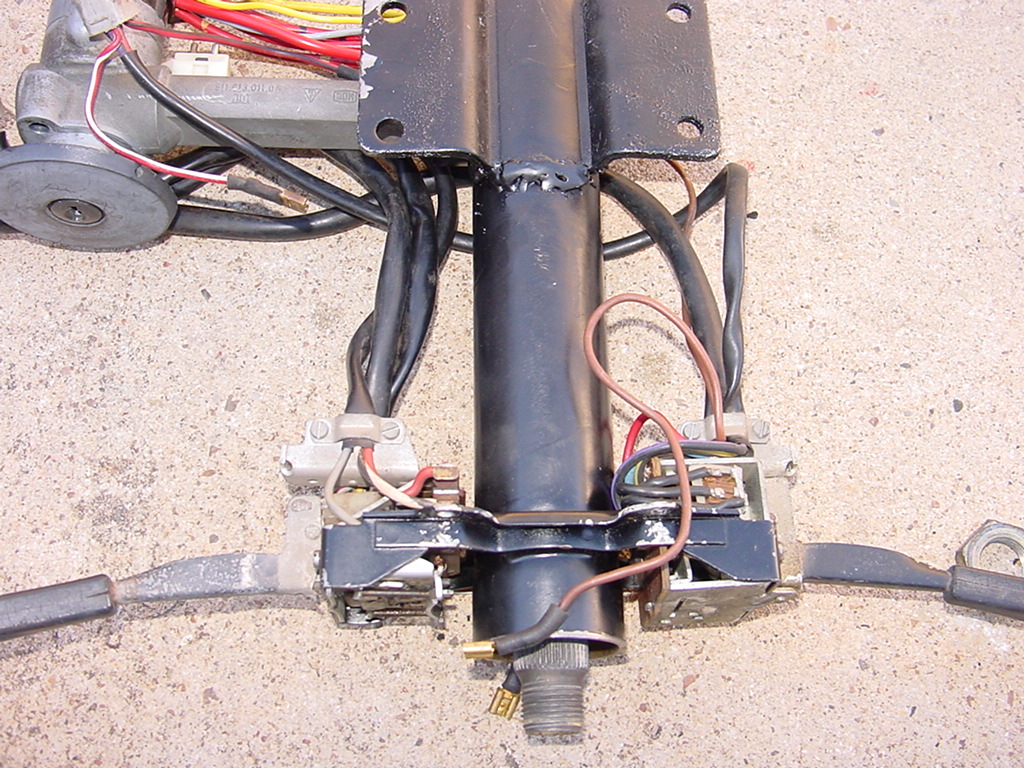

Remove the mounts from the 911 column, saving the tube. (IMG:style_emoticons/default/sawzall-smiley.gif)
Weld the 4 cylinder mount to the 911 column. (IMG:style_emoticons/default/welder.gif) You should end up with this.
Now you can put the column back together. I don't know about a car with a stock 3 gauge dash, but with the 911 style dash I had to trim the front edge of the top clamshell to get it to clear the gauge assembly.

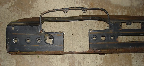

Now on to the dash frame.

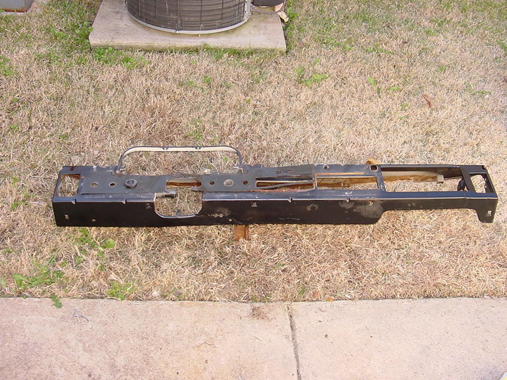

I got a rusted out six dash from a guy who totalled his six.

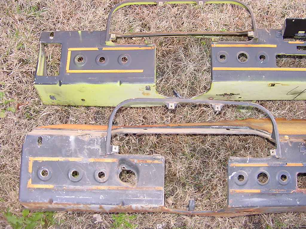

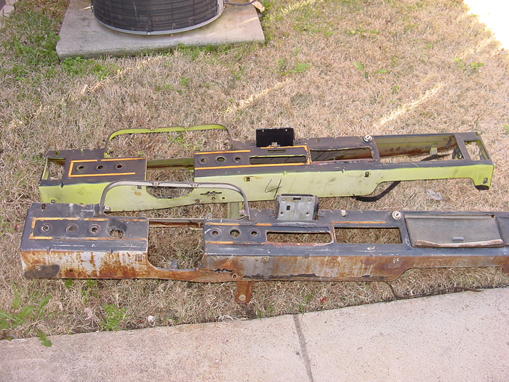

Here are both the 4 cylinder dash and the six dash together.
The four dash is from a 73. To use a six style column, you have to modify the dash to hold the ignition lock. I had the six dash, so I used it. The six dash doesn't have the holes for the air vents, and I have a future use for them (Air Conditioning) so I chose to keep them. This entailed cutting a hole in the left side of the dash for the vent.
I then took the dash frame and cut the glovebox end off because there is no hole for the vent on the right side. I spliced in the end from the 4 cylinder dash to add the hole. You have to remember that the early no vent glovebox is an inch wider than the 73 and later glovebox. I mounted the glovebox door from the 73 in the frame to hold it in place while I tack welded the frame parts together.

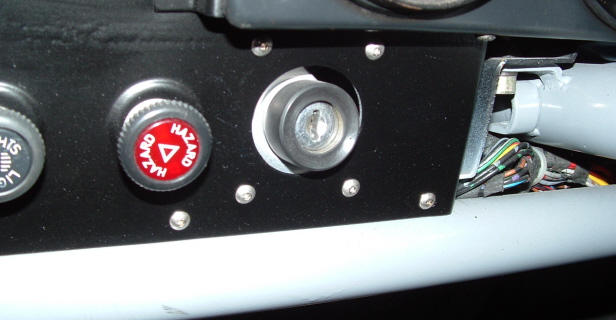

Finished dash....
The conversion also meant that I lost the location for one switch to the left of the column. So I moved the hazard switch to the right of the column.

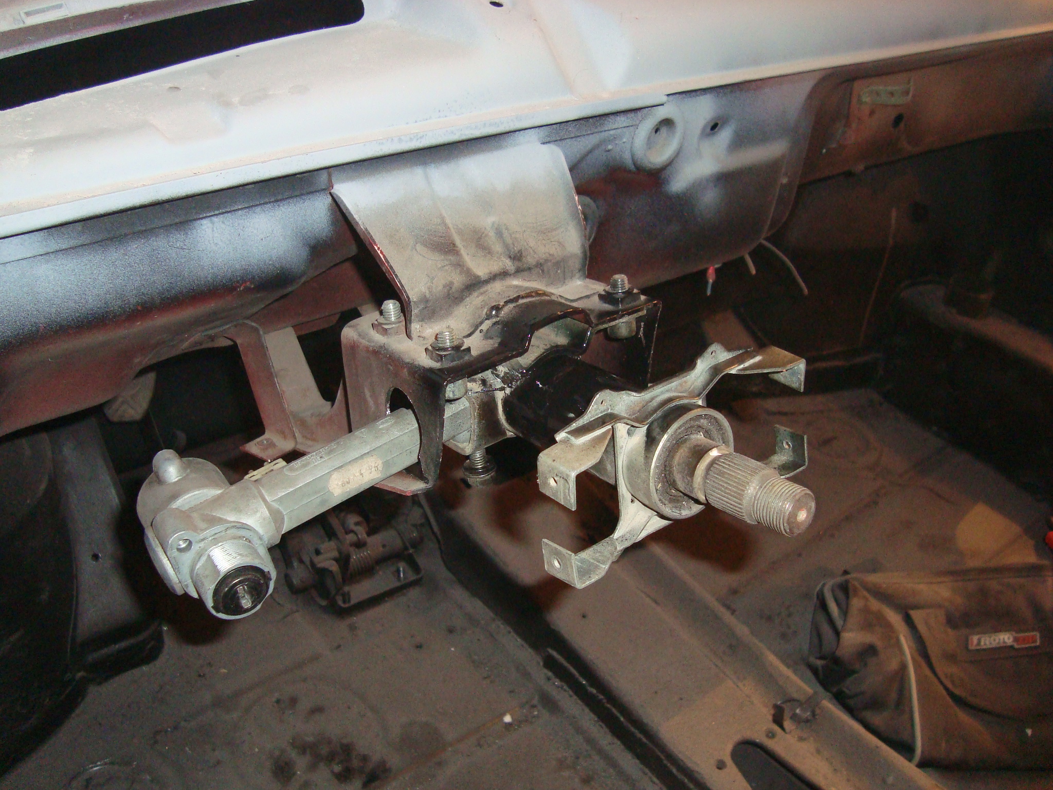

After scouring the archives I have found this one to be the easiest. I had the 911 column and was given a switch both out of a SC. No offense to anyone who has tackled this and thought there was was better. I basically read several and took bits and pieces of infor from many of them. The hardest part was cutting the old mount from the 4 cylinder column. (IMG:style_emoticons/default/sawzall-smiley.gif) Then a little (IMG:style_emoticons/default/welder.gif) and you got it!!
I love it that all you guys who have blazed the trails before me! (IMG:style_emoticons/default/first.gif) It makes it much easier for the rest of us!! (IMG:style_emoticons/default/pray.gif) One thing I would add is that before you weld everthing up align the notches in the steering shafts with the universal joint to make sure you have your mounting plate in the right location. I know it seems elementary but know this ahead may save you time and keep you from screwing it up :-) I know my car is already tore apart but it took little time to do this.
