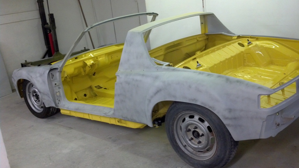

Post #521
Its got to be Yellow!!!
Posts: 2,432
Joined: 29-August 09
From: Orange
Member No.: 10,742

Madswede
post Dec 31 2012, 06:03 PM
Post #522
Flat Out Driver
Posts: 853
Joined: 13-September 06
From: Rio Rancho NM
Member No.: 6,831
Now THAT's what I'm talkin about! We kept the bottom of my car (and the tire wells and the engine bay) black, but it's interesting to see the other perspective with yours being painted yellow like that. (IMG:style_emoticons/default/shades.gif)

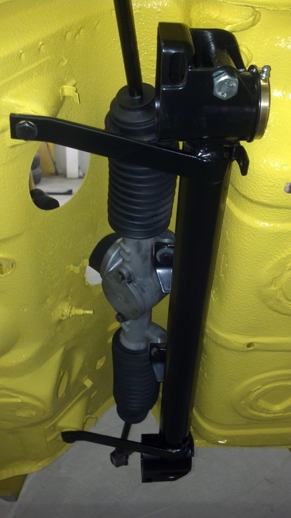

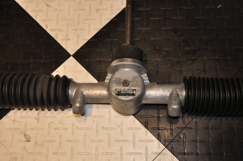

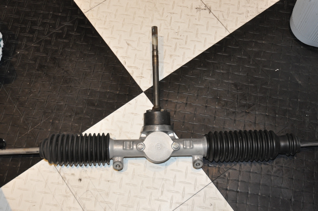

So I'm cleaning up the rack and would like to flush it out and and some fresh oil in but need some recommendations (IMG:style_emoticons/default/confused24.gif)
Thanks in advance!!

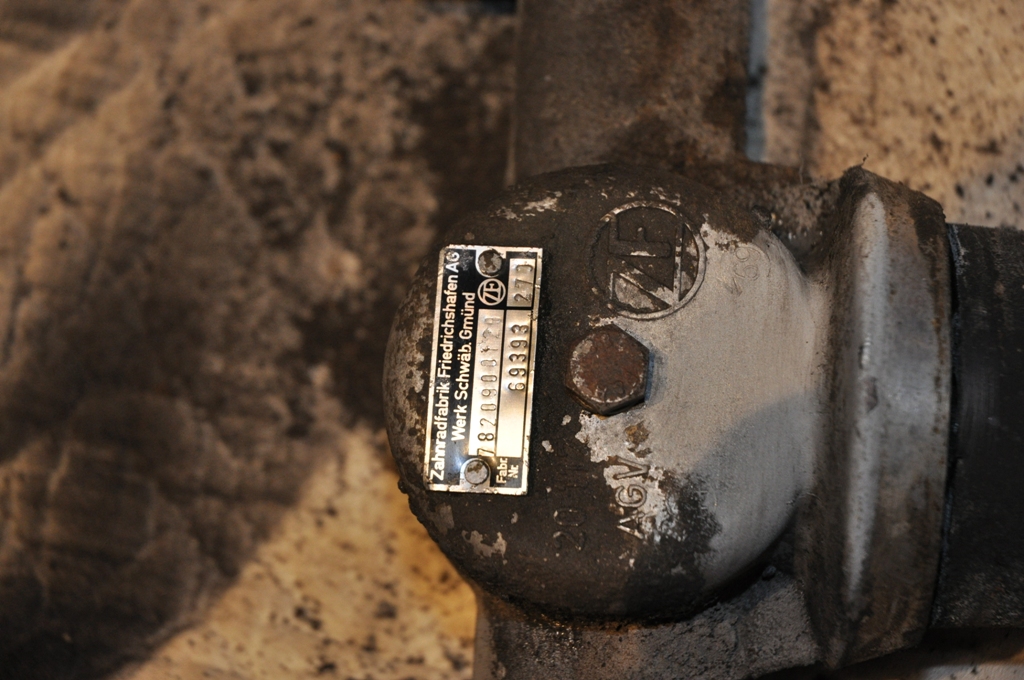

This if from a post in 2003 I found in a search. Whats inside the rack now is a light grease thats black in color. I think its just really dirty but the rack moves smooth with no slop/play
QUOTE(ArtechnikA @ Sep 16 2003, 10:43 AM) *
<!-- QuoteBegin-silver six+Sep 16 2003, 09:16 AM --><div class='quotetop'>QUOTE(silver six @ Sep 16 2003, 09:16 AM)</div><div class='quotemain'><!-- QuoteEBegin --> So I'm guessing it's lithium grease right? Any dissenters?
<!-- QuoteEnd --></div><!-- QuoteEEnd -->
no.
molybdenum disulphide "MoS2"
factory calls for a Dow-Corning product.
i'd probably just use one from Lubro-Moly or Swepco's moly grease.
in a pinch, moly-based CV grease from the FLAPS.
TJB/914

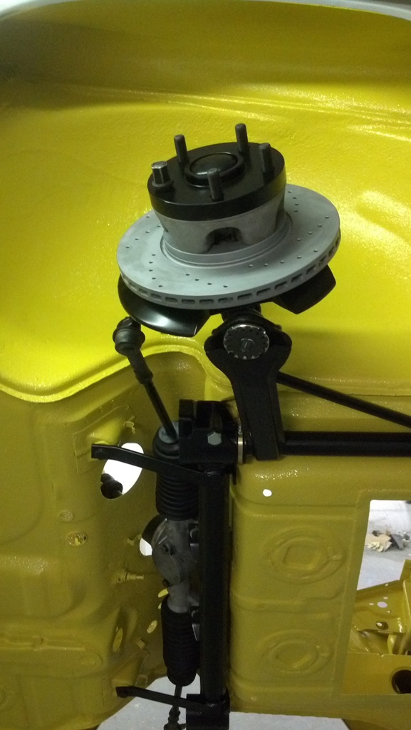

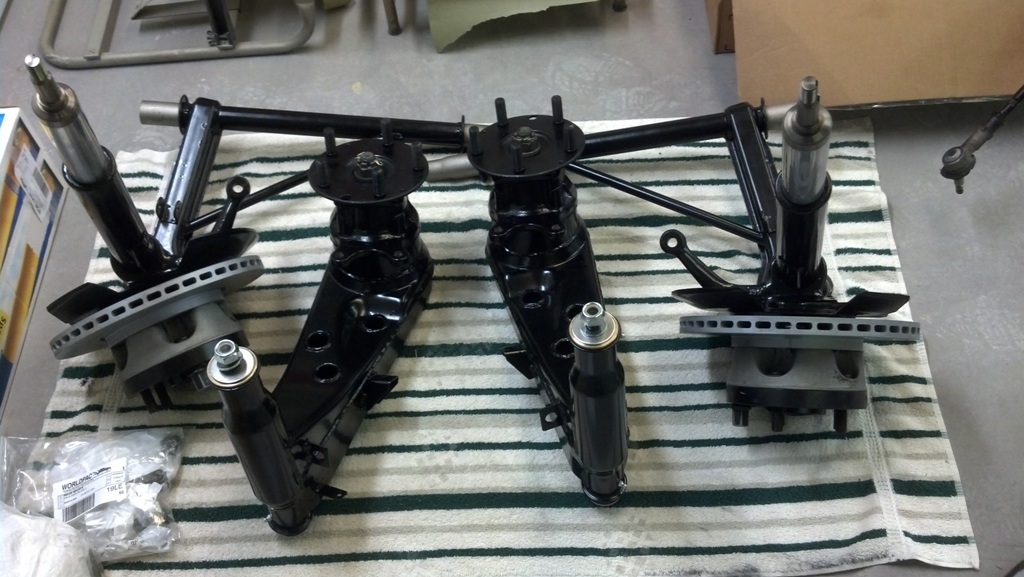

There's an Elephant in the house (IMG:style_emoticons/default/biggrin.gif) Bearings and ball joints are in and waiting to hear back from Rebel on correct P/N for Eibach 140lbs springs for their coil over kit. Should have it on the ground soon.

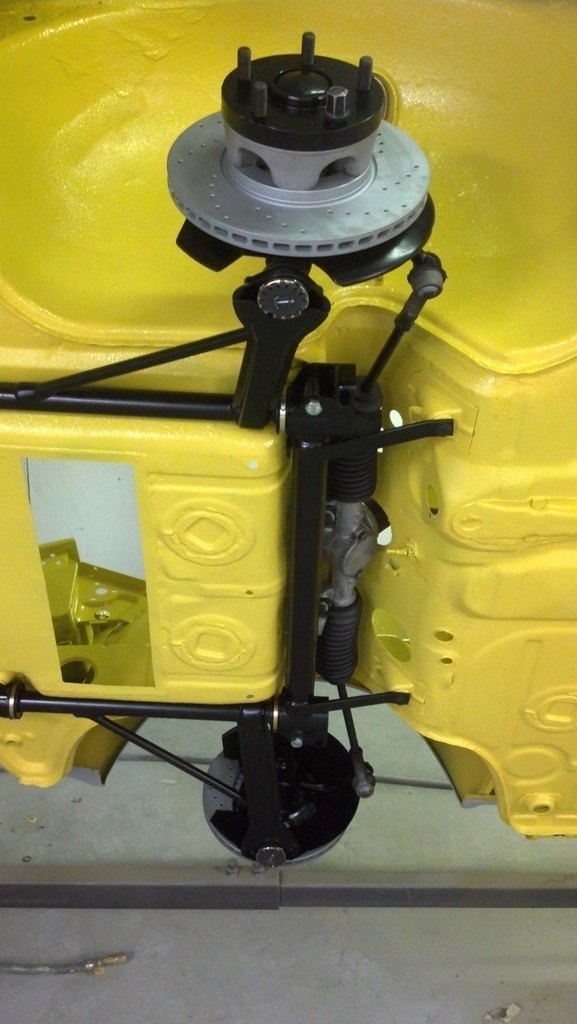

Socalandy
post Jan 10 2013, 10:19 AM
Post #532
Posts: 2,432
From: Orange
Member No.: 10,742

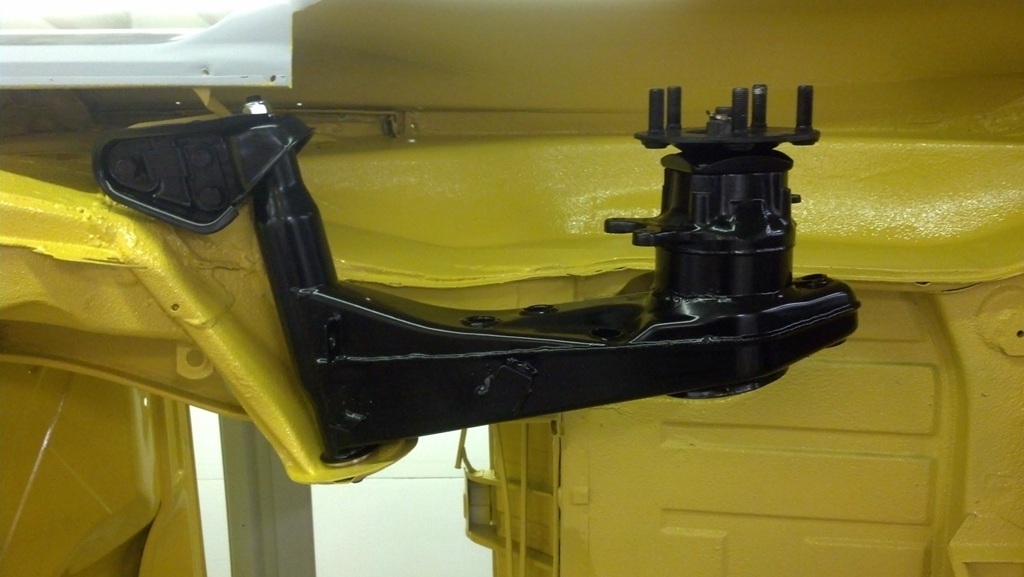

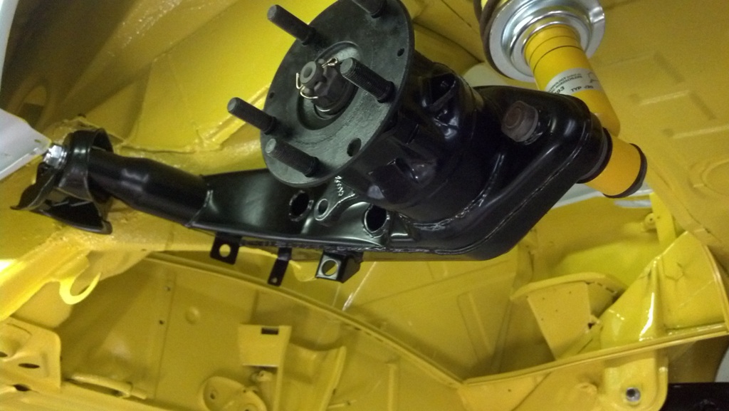

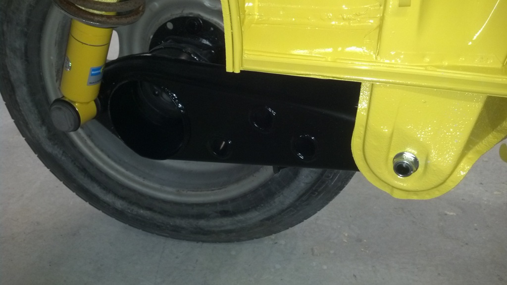

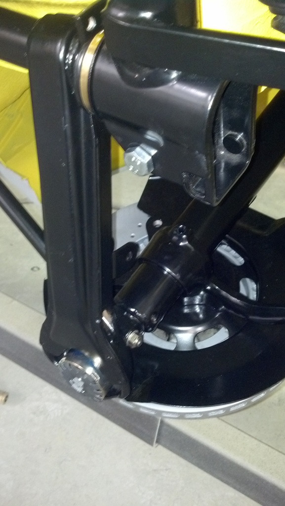

Time to get her on her wheels again (IMG:style_emoticons/default/biggrin.gif) Some of this is coming back off again for plated parts and the coil over kit. Mainly to get the rest of the paint finished (IMG:style_emoticons/default/piratenanner.gif)
