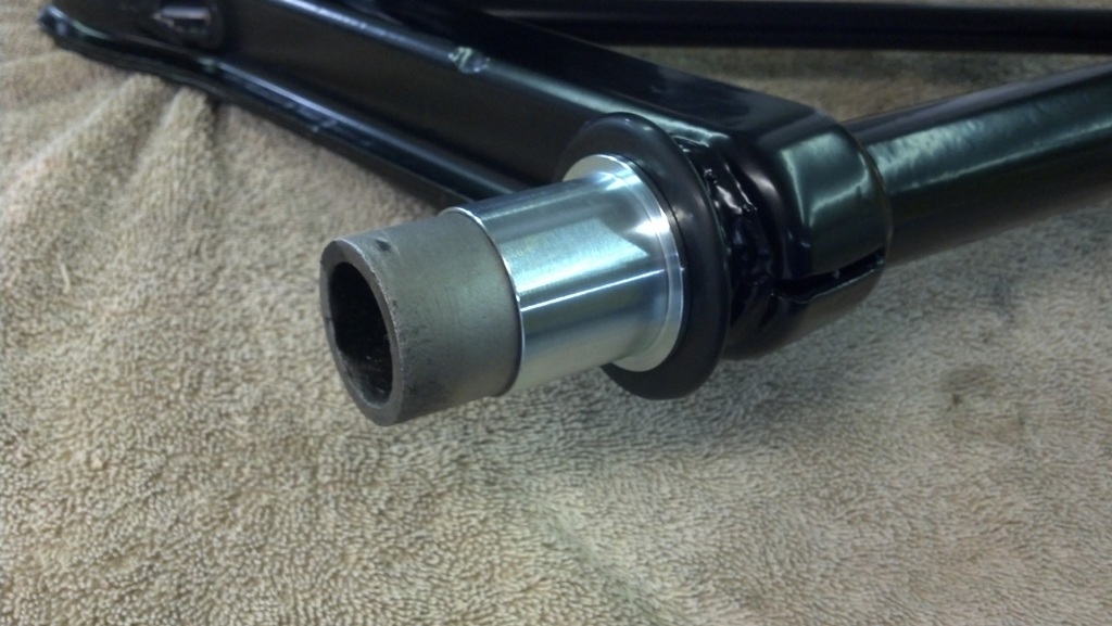

QUOTE(Eric_Shea @ Jan 10 2013, 03:58 PM) *
Suspension is looking awesome! (IMG:style_emoticons/default/smilie_pokal.gif)
Tip: (for the next guy reading this) (IMG:style_emoticons/default/biggrin.gif) Put these on with JB Weld before powdercoating and have the powder coater tape them off. The JB Weld will withstand the heat of the powder oven and the end will be finished...
(IMG:http://www.914world.com/bbs2/uploads/post-10742-1357834737.jpg)
Thanks Guy's!!!
That would have been nice!! These were a tight fit even before the JB weld and I didn't want to have to sand off powdercoat to fit them so it was all taped off. the front end will all come back off and I will brush on undercoat on the exposed areas before final assembly.

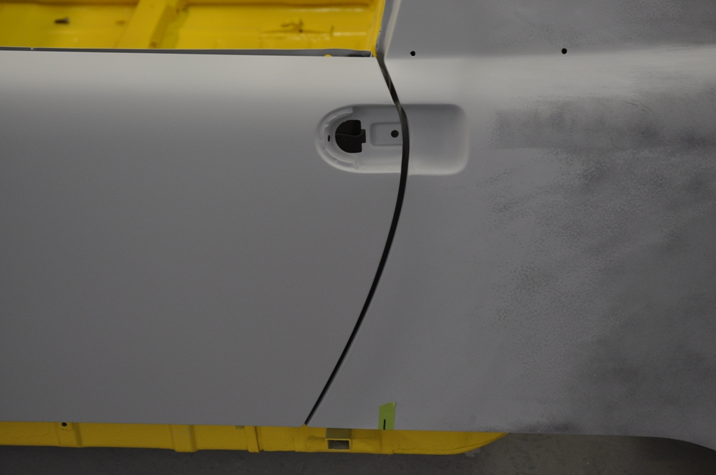

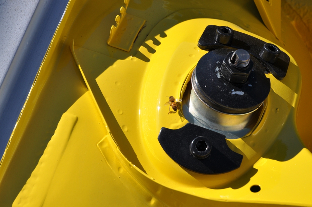

Doors back on and adjusting gaps. Push it outside in the sun for a look and it started attracting bee's (IMG:style_emoticons/default/biggrin.gif)

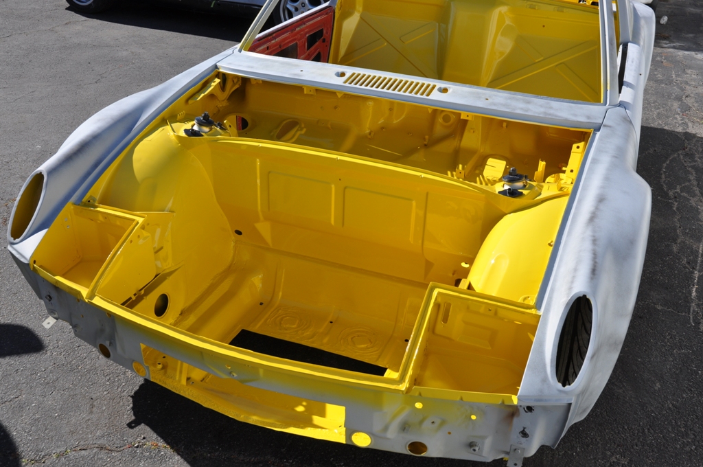

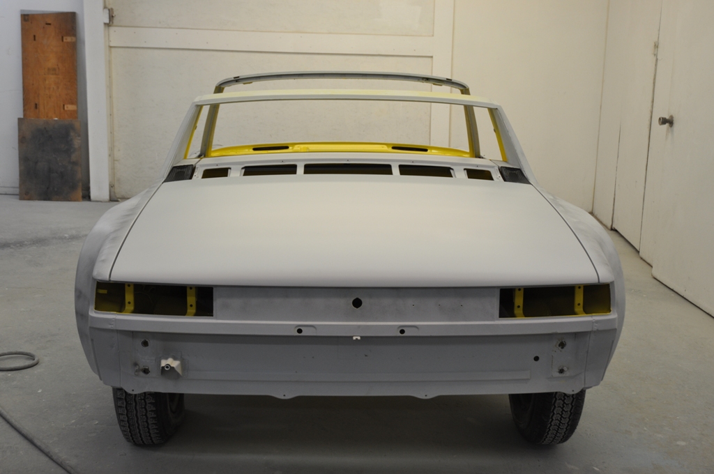

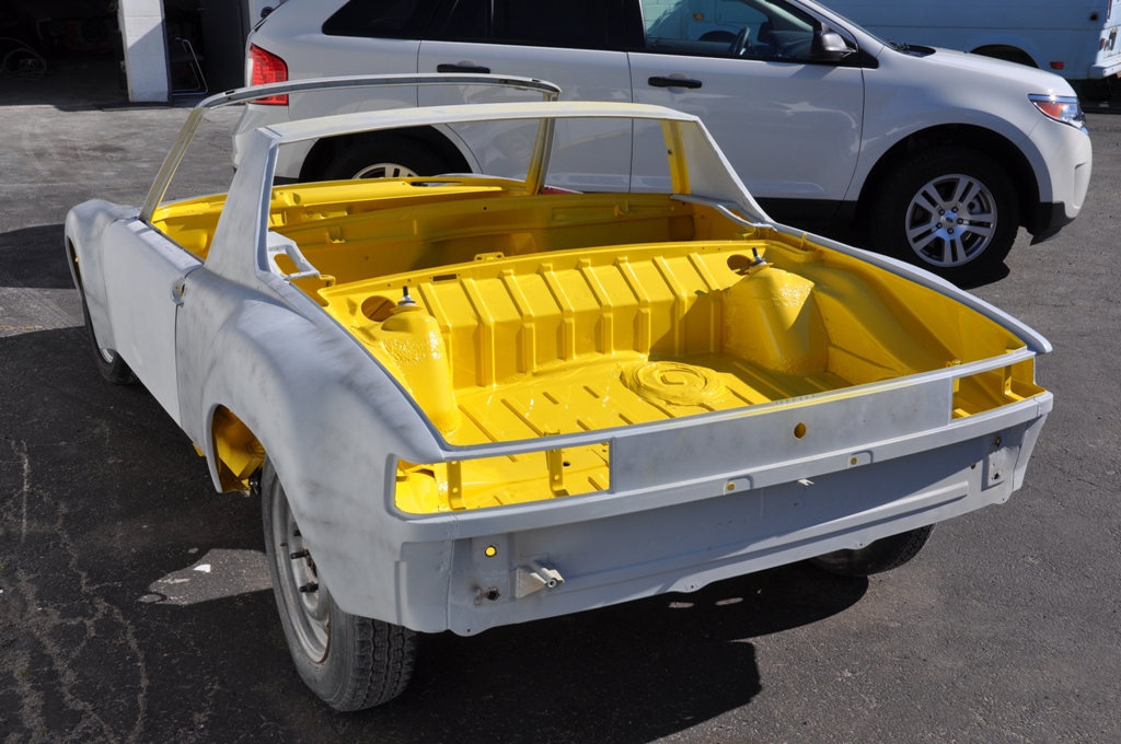

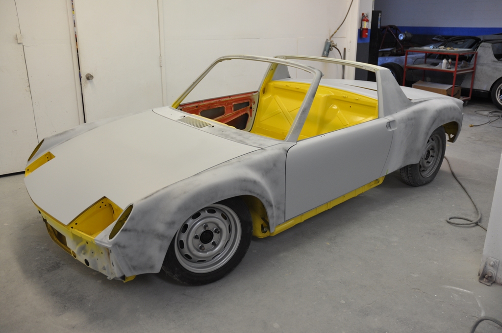

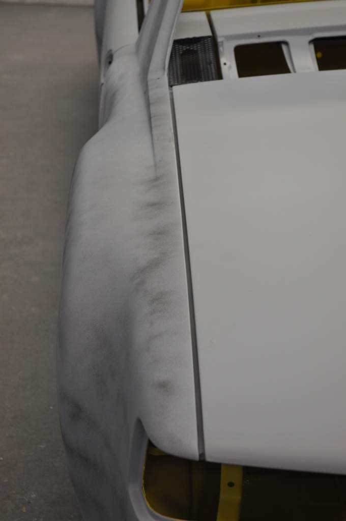

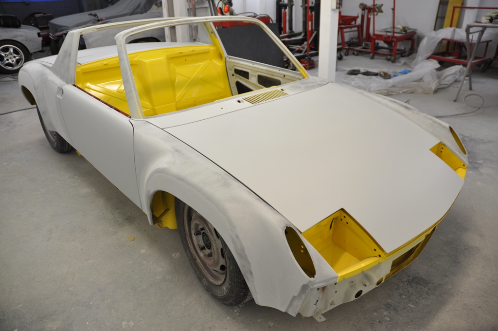

No Problem Rob!!! Back from being out of town. Doors and front and rear lids mounted and gapped and ready for final seal and paint. (IMG:style_emoticons/default/biggrin.gif)
cell pics replaced...

Member No.: 3,881
Finally more updates! I have been getting a little twitchy waiting for something new. (IMG:style_emoticons/default/biggrin.gif)

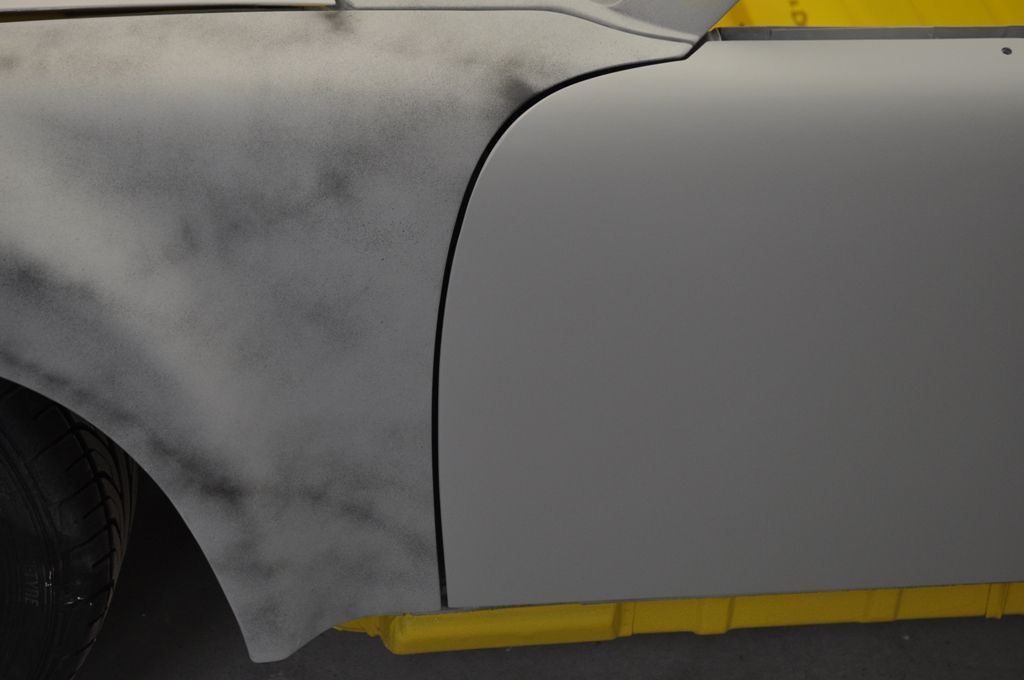

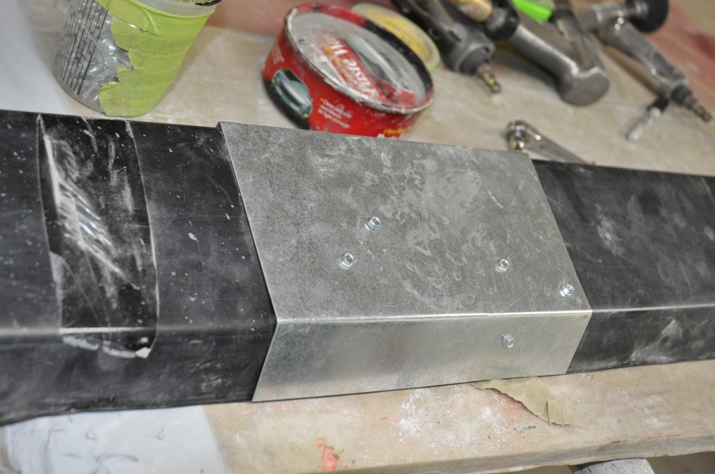

Member No.: 10,742

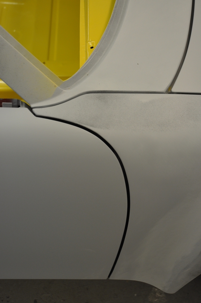

gaps looks great and nice to see all the panels on the car!! Drivers side rocker was 5/8 shorter than the passenger side and needed some help (IMG:style_emoticons/default/mad.gif) final paint, color sand and buffing should be done by months end (IMG:style_emoticons/default/biggrin.gif)
