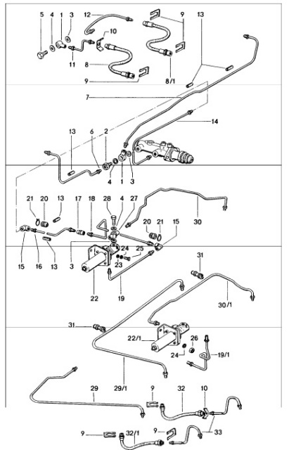

PMB has it all !!! these are Green coated steel in the original finish for all 914's through 1976. These also come in tin coated lines for a budget repair and stainless steel for those who never want to do this job again. Pre-bent for every corner of your 914 (IMG:style_emoticons/default/drooley.gif) (IMG:style_emoticons/default/aktion035.gif)

Andy has the factory green coated lines. All 914's had them. They are actually more expensive than the stainless steel lines because the material isn't as readily available. OM steel (tin coated steel) is the least expensive and Stainless is the mid-priced line.
We're still waiting on the right front line from the MC and the later front caliper lines

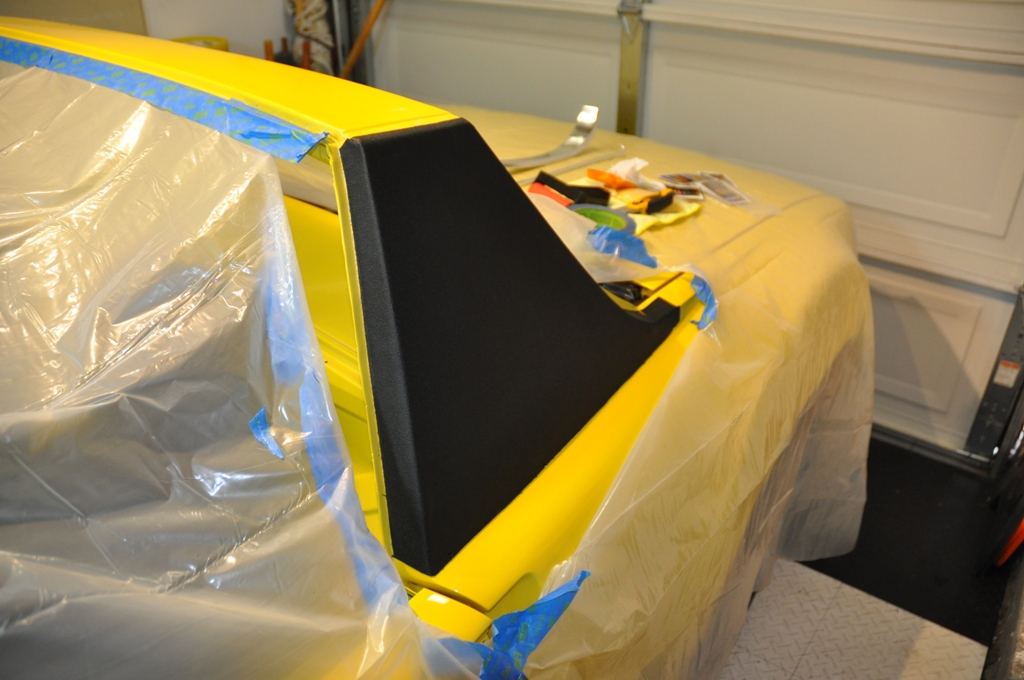

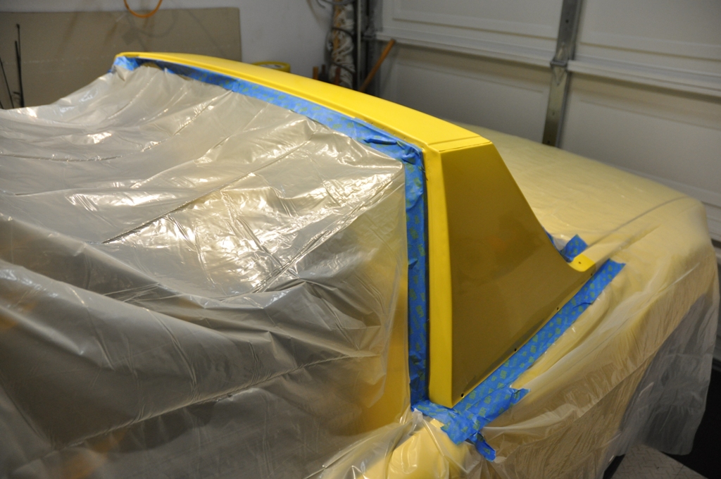

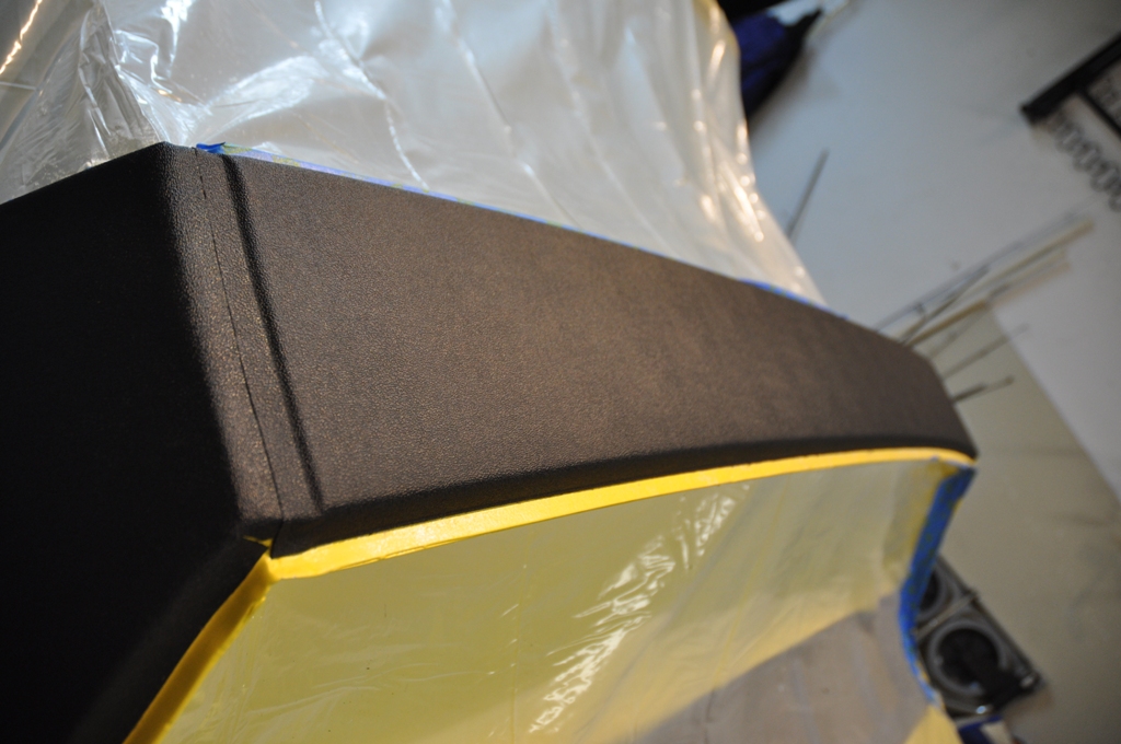

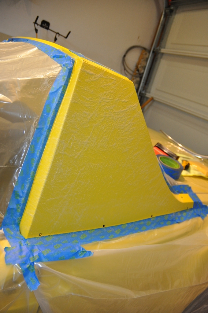

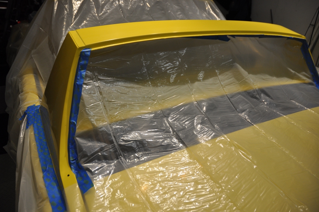

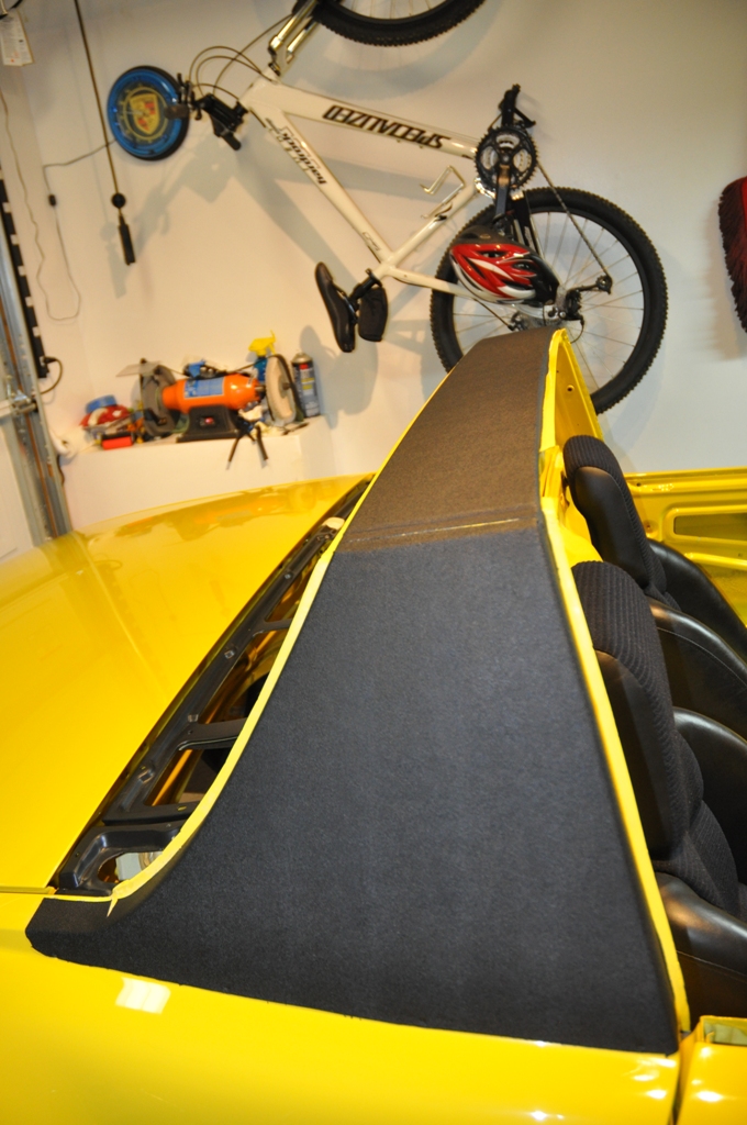

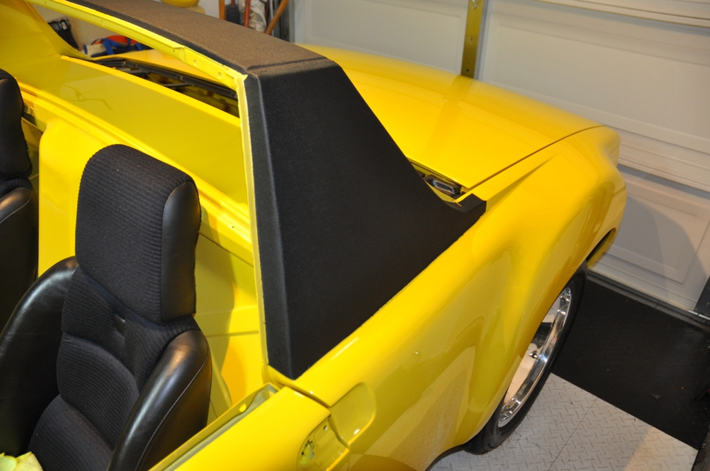

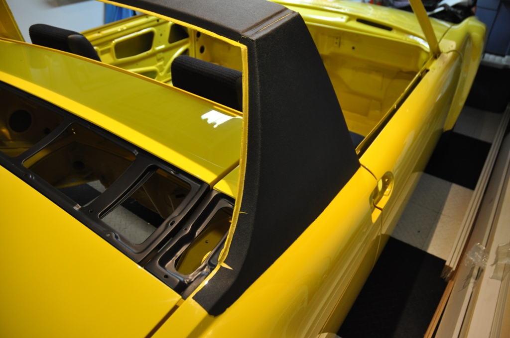

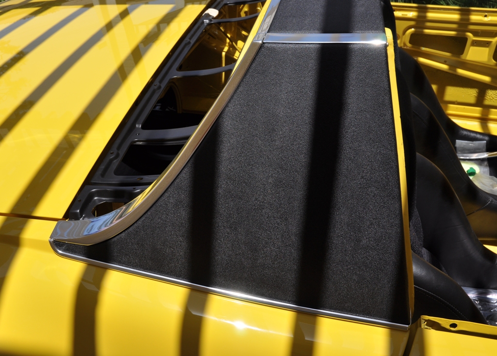

well I still need to install the trim but here are some pics of the sail vinyl install. I also had the gas tank cleaned and red coated and its in metal etching primer now.
More this weekend (IMG:style_emoticons/default/biggrin.gif)

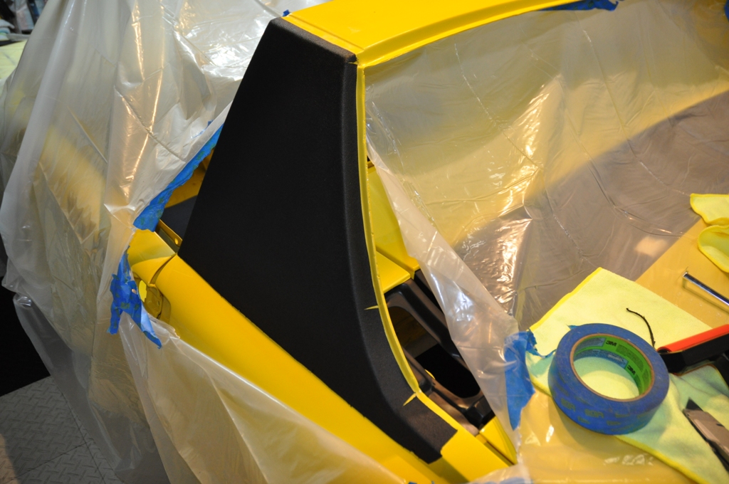

Nice to add some more black to balance out all the yellow

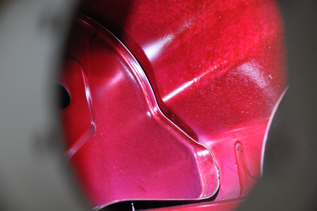

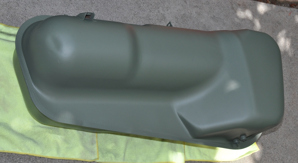

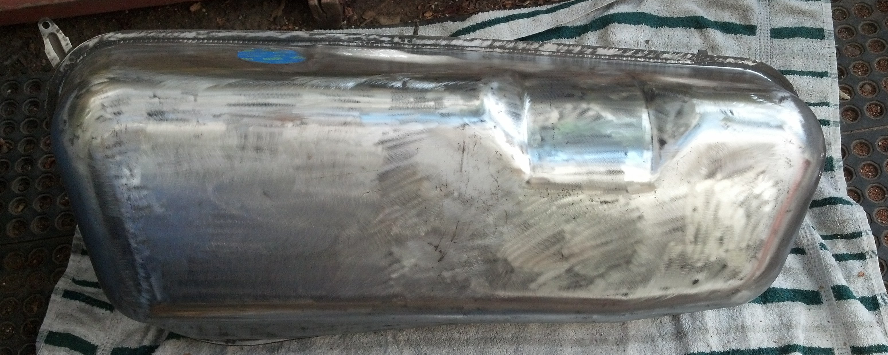

Got a picture inside the tank so you can see the Red-Kote sealant for those thinking about going this route.

Andy- Your car is looking very very nice. I am happy to see the sail panel vinyl on it. It really is a great look on these cars.

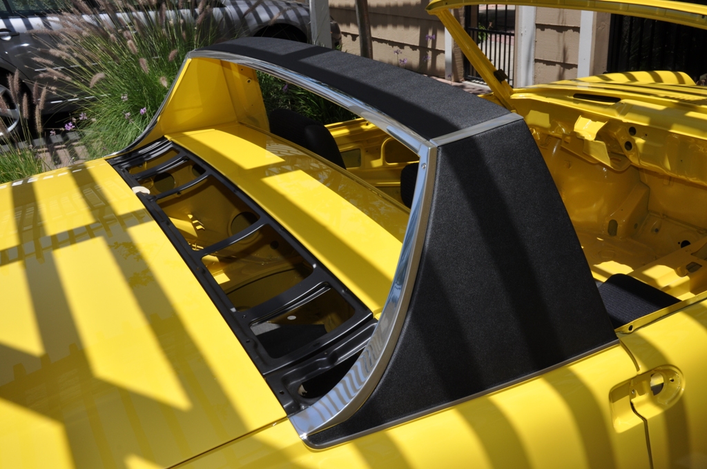

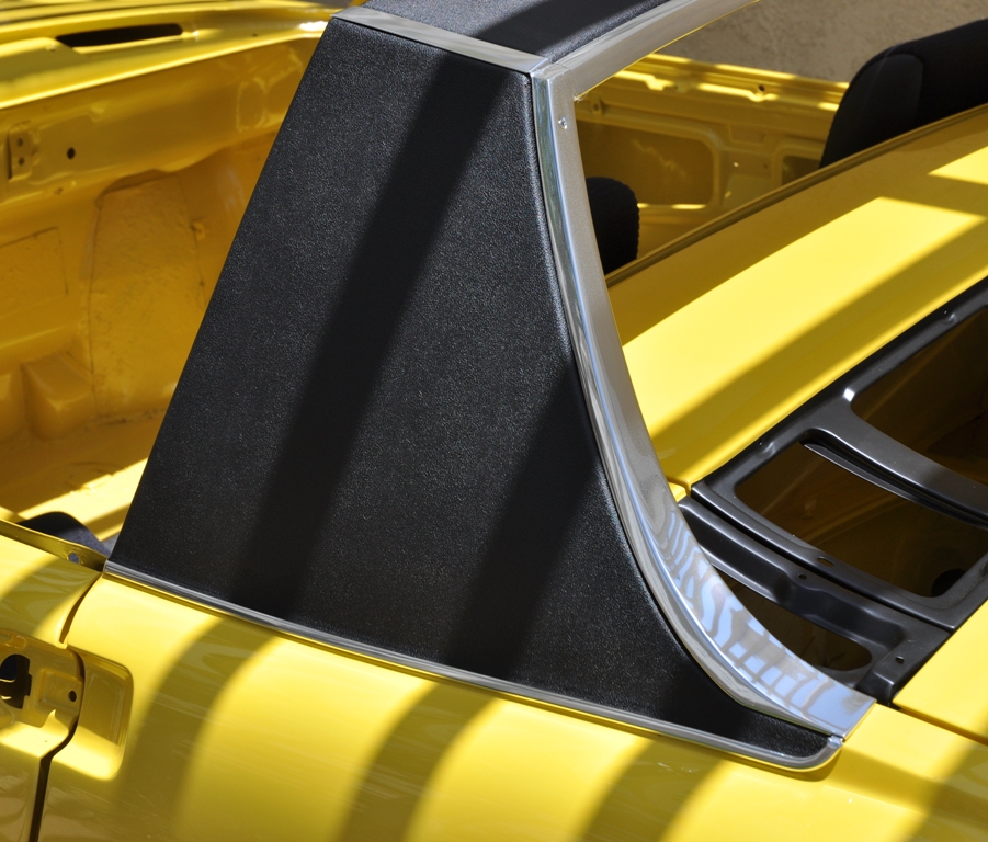

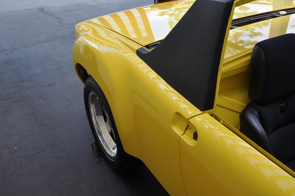

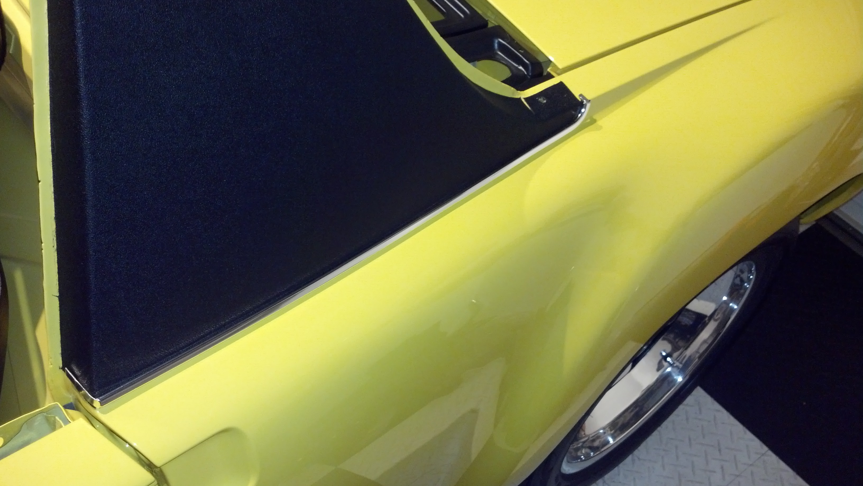

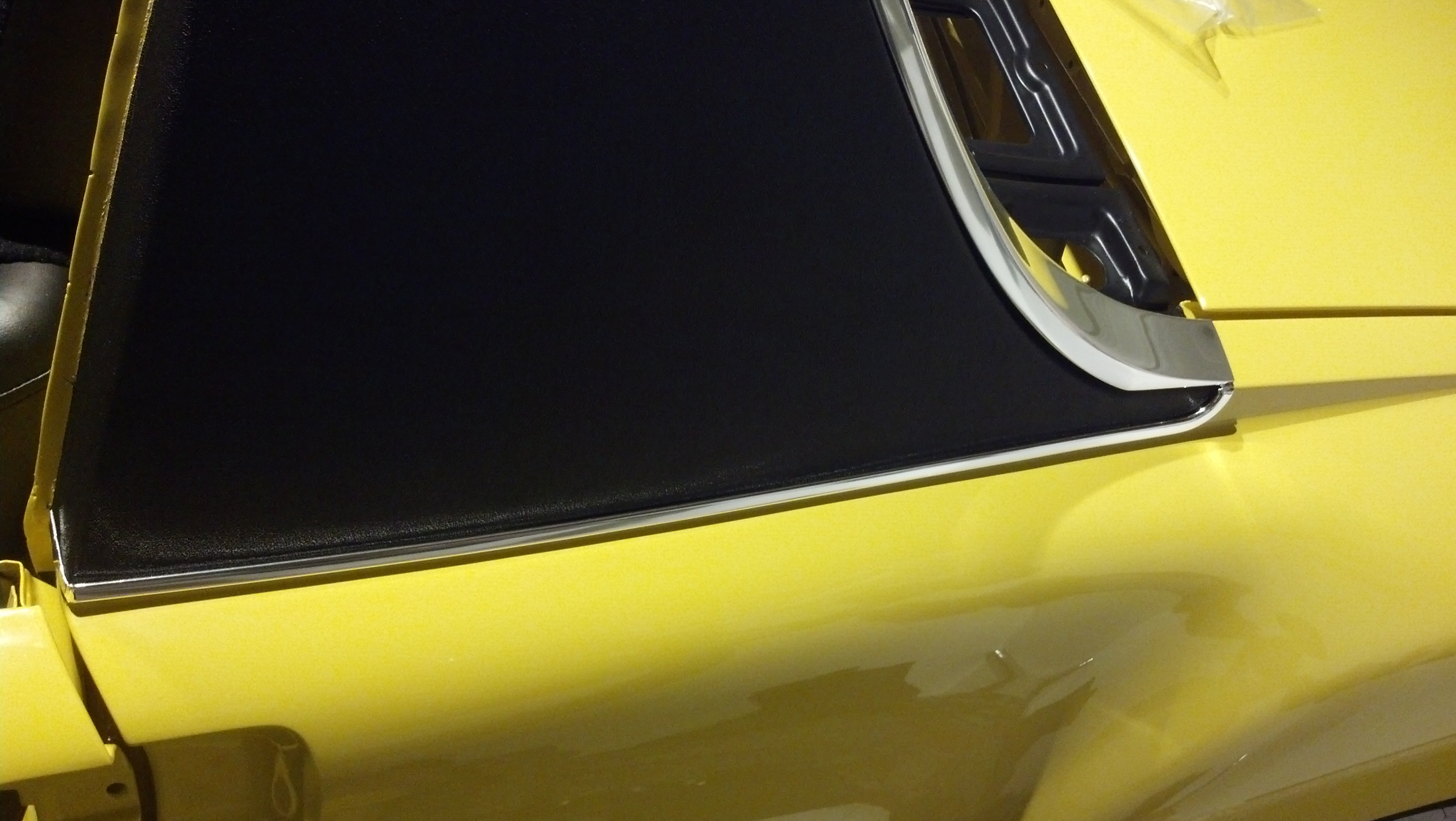

started putting on the sail trim. Tomorrow I will polish the center bar so I can get it all on. I plan on getting the dash frame installed as well.

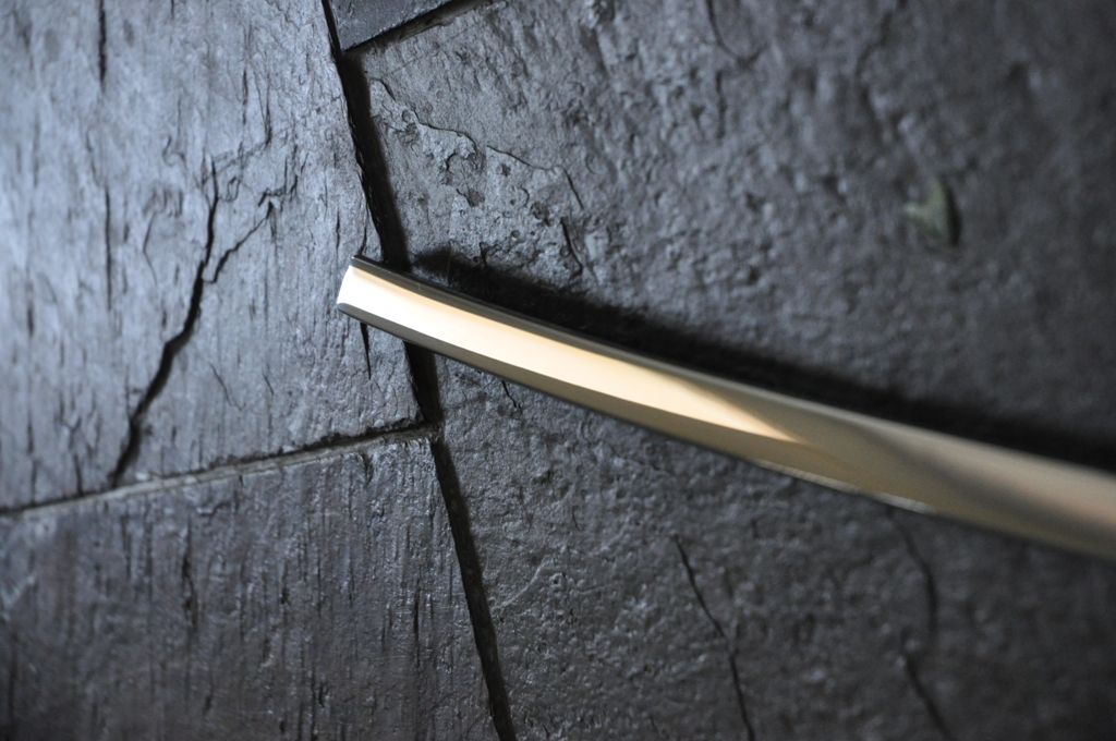

Thanks Guy's

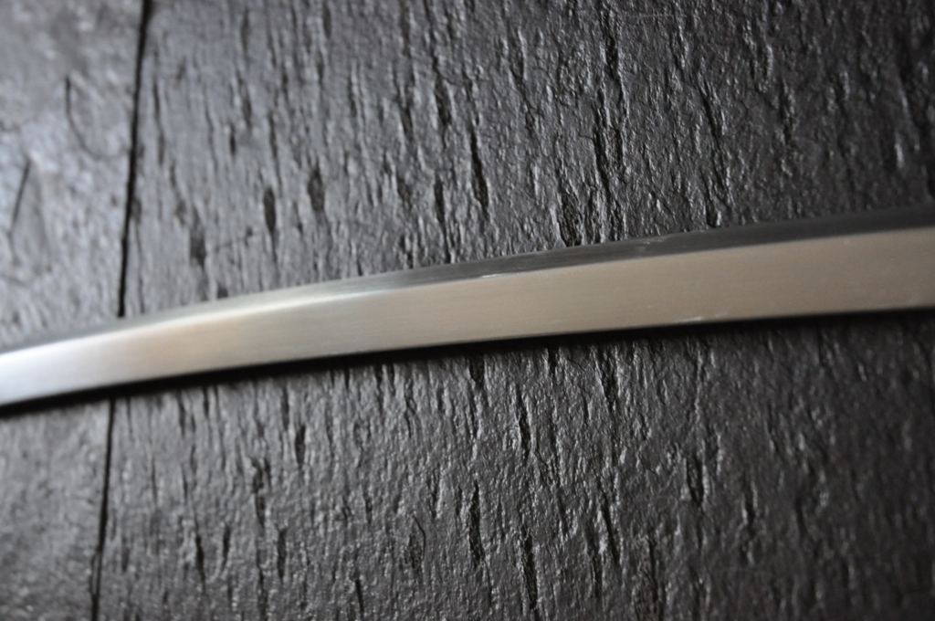

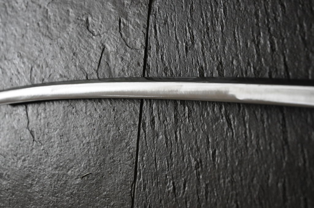

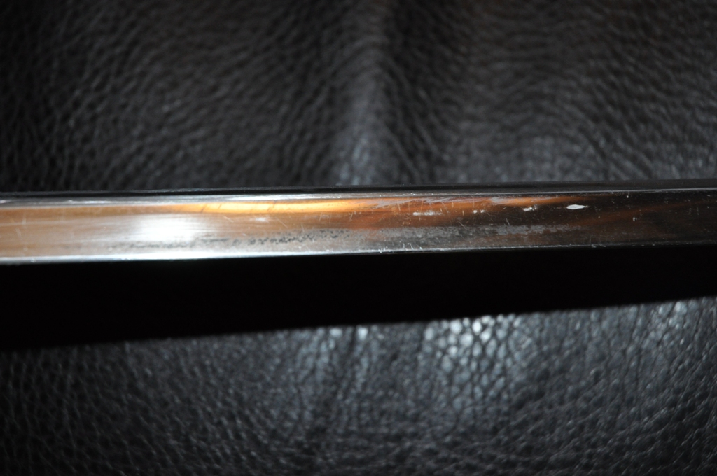

3 hours of sanding and buffing and now the battered center trim piece is done. Started with 320 to remove deep scratches and some small dings, then 500 and 800 before the compound and final buff. Now where did I put those clips (IMG:style_emoticons/default/idea.gif)

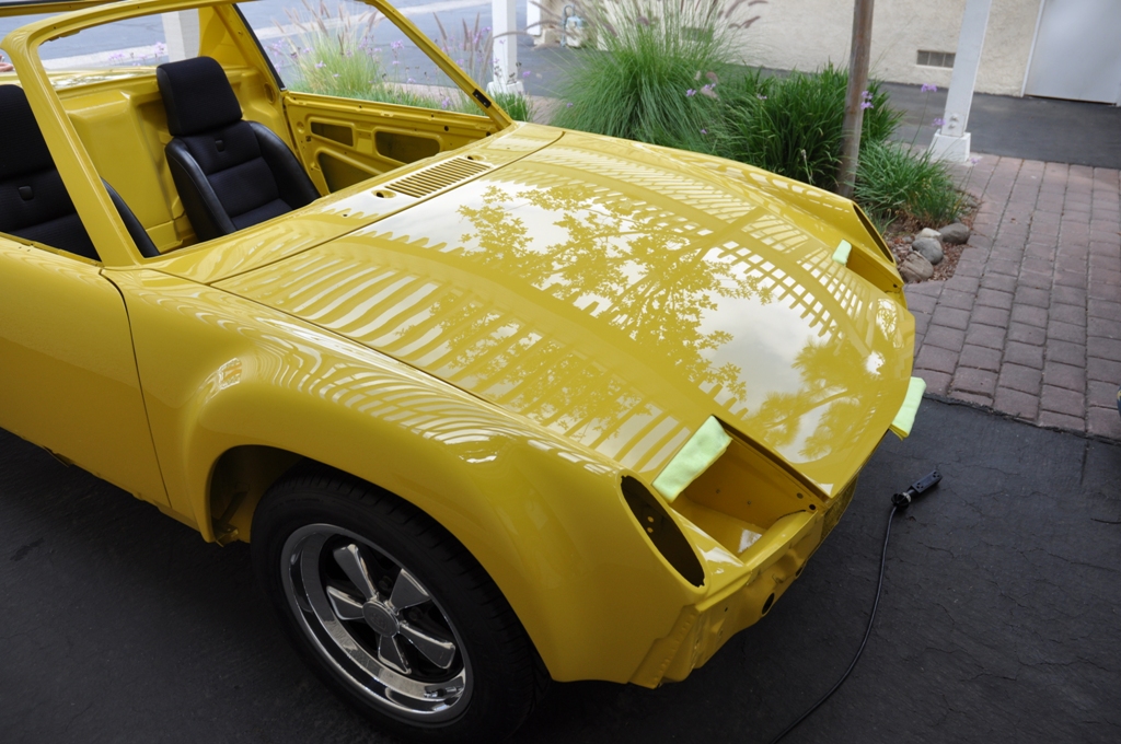

Member No.: 10,742
Still waiting for the clips but Ron and Glenn came thru for me and got a few more things for reassembly.

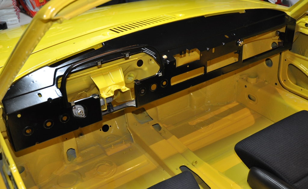

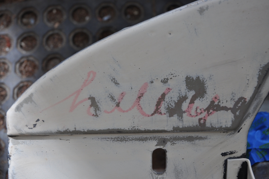

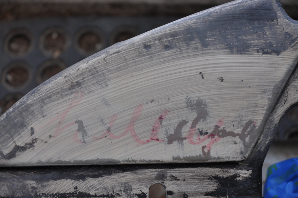

Member No.: 10,742

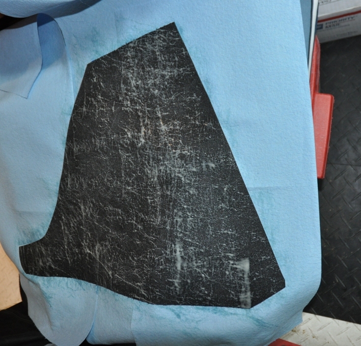

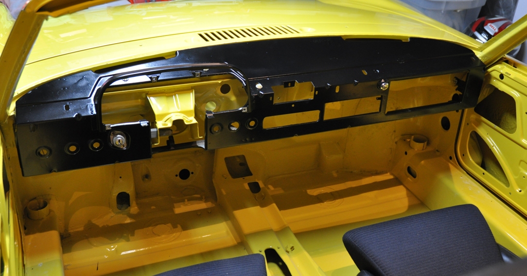

Prepping the dash frame it looks like my car was given a name. I think is says Hillary (IMG:style_emoticons/default/confused24.gif) what do you guys see. Acetone not only got all the adhesive off with ease it took off all the black paint down to the primer.
Time to start feeding in some wire (IMG:style_emoticons/default/biggrin.gif)

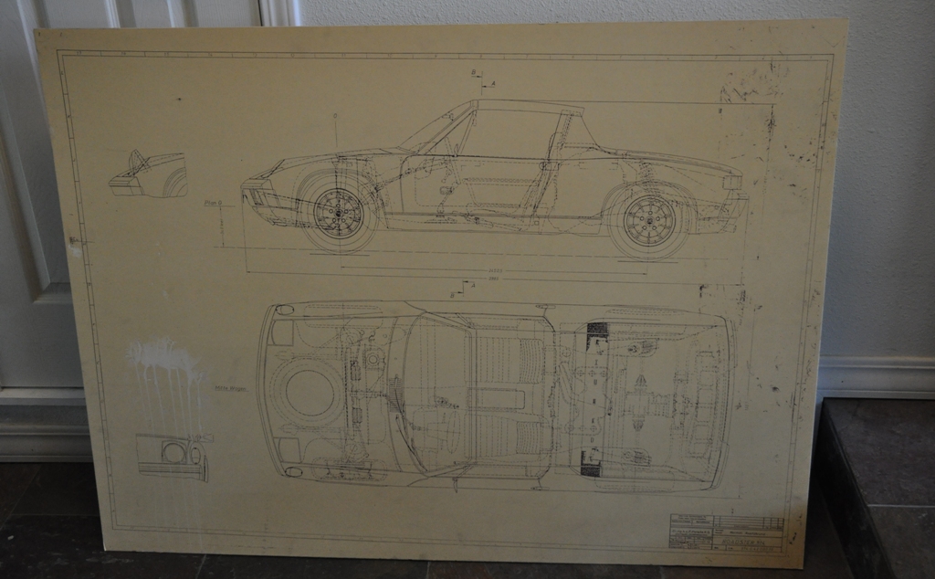

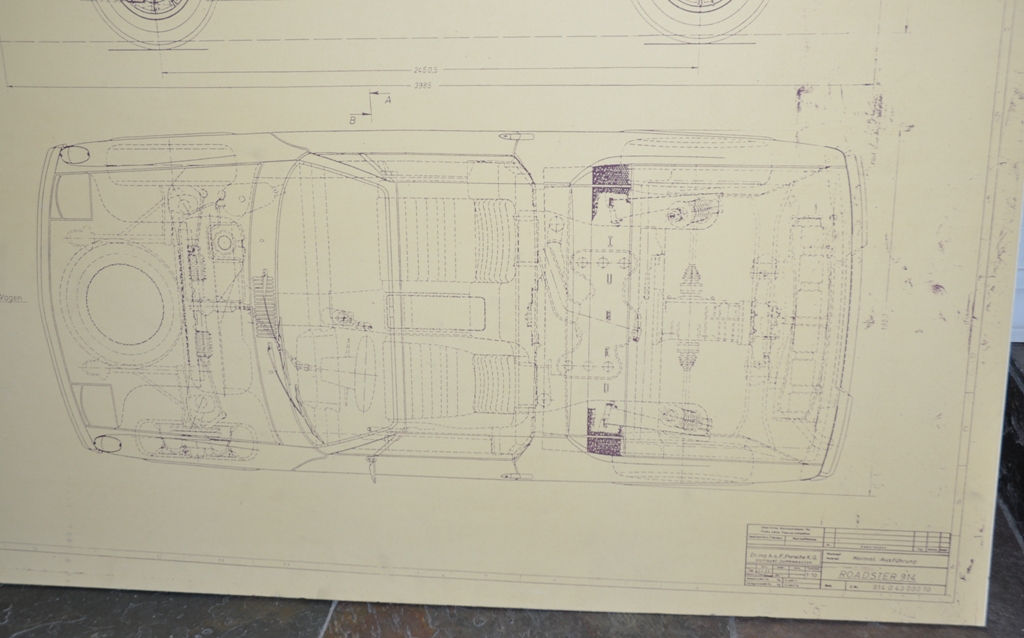

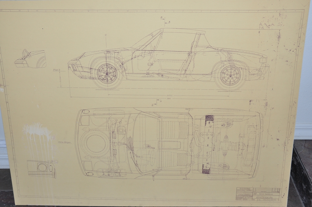

I'm really happy with my new 914-6 blueprint art I picked up this weekend (IMG:style_emoticons/default/aktion035.gif) yes its old and comes with some patina and its time to get it on the wall. I'm thinking the living room but Karen will most likely have it end up in my office (IMG:style_emoticons/default/popcorn[1].gif)
