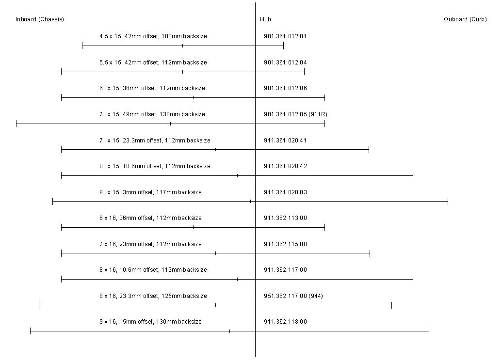

This chart help me when I was trying to decide when switching from 14" x 5.5" fuchs to 16 x 6 fuchs on a /6. There are so many factors since there are some wide 205's.

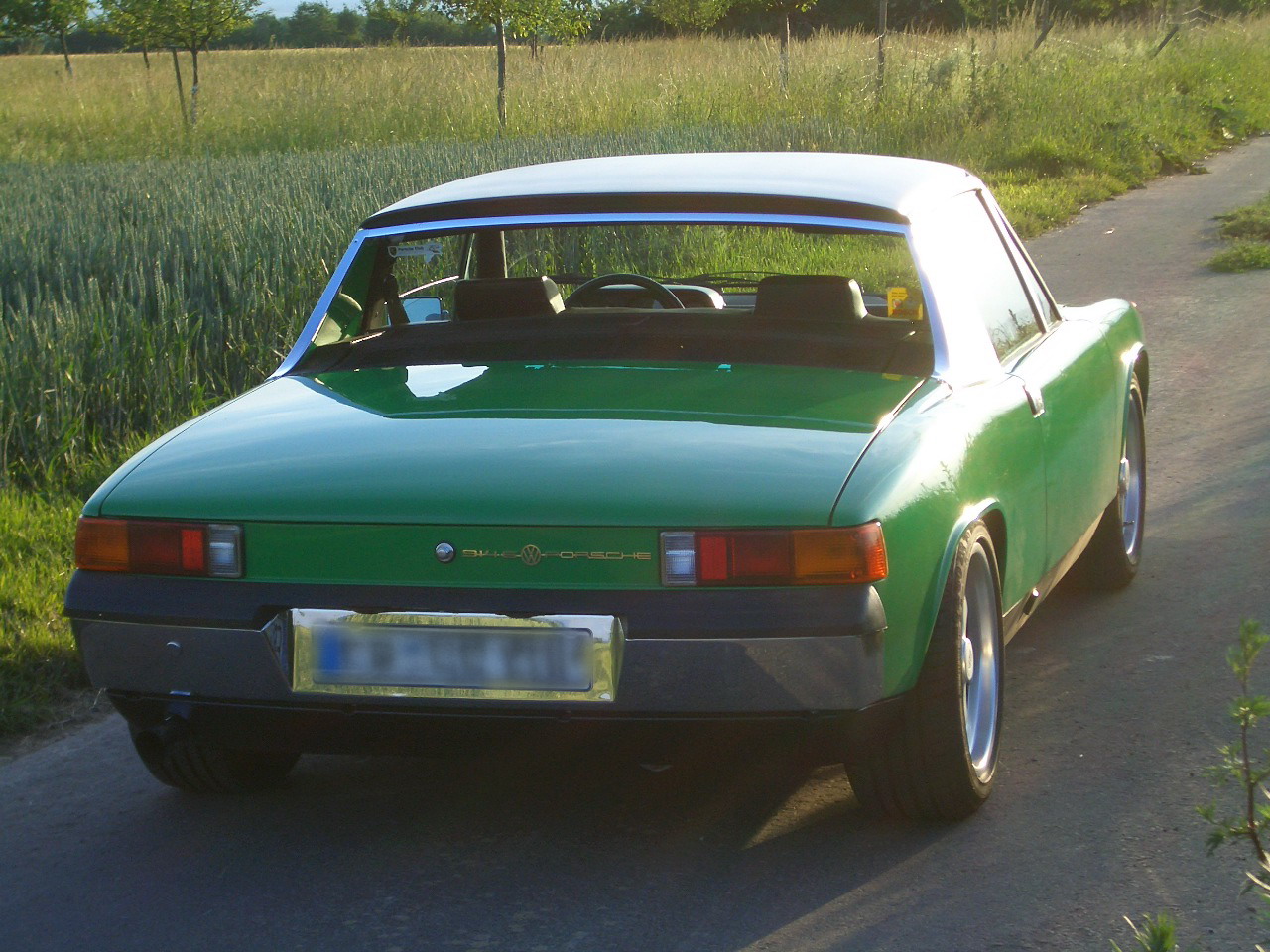

I`m driving 7"R Wheels all around and also 7 + 8 x 16 (951) from 944 Turbo. For the 7"R Rims you hva to take Spacers (on my Car 27mm). On the 7R Rims i have 185/70/15. The rear Fenders are bumbed out about 1 inch and rolled. In the Front it`s not bumped, but also with Spacers and rolled. If you don`t take Spacers, the Wheel will "scratch" the Body. On the 951 i have 195/50/16 in the Front and 205/50/16 in the rear. There is not much place at the rear Fenders between the Rubber and the Body, maybe 5mm.

Your 914 is gorgeous. Thanks for posting the images.
