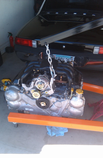

First pics of my EZ30R engine with 1000 miles total!
Now to take out the Ej20 turbo this weekend and see if the new engine can fit on the renegade engine cradle!

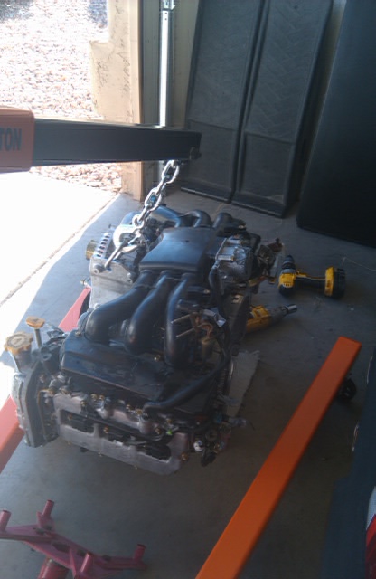

one more on stand

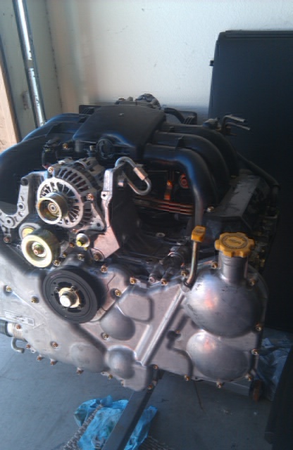

side

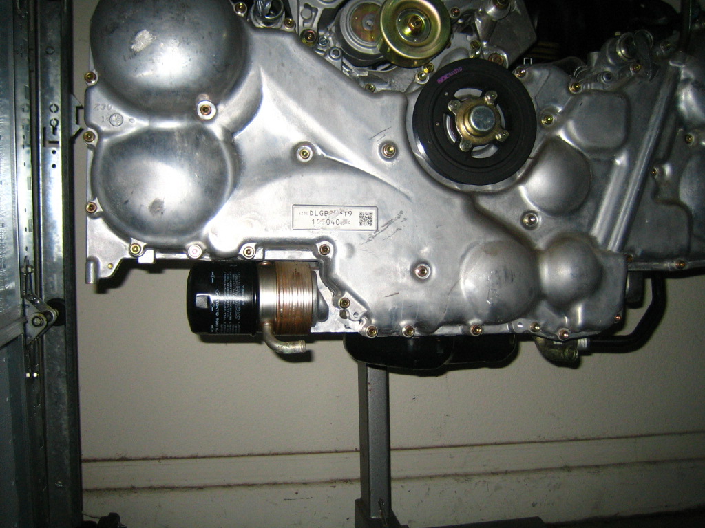

Underneath....hey also if anyone knows...Why doesnt this Engine have a fuel return line? They all dead end into the injectors equally with no return. Have to figure out how to hook this up.

My Dodge V10 has no return line either. It uses a 45psi pump to the 45psi injectors. The pump has an internal bypass to "dead head" the fuel during idle.
