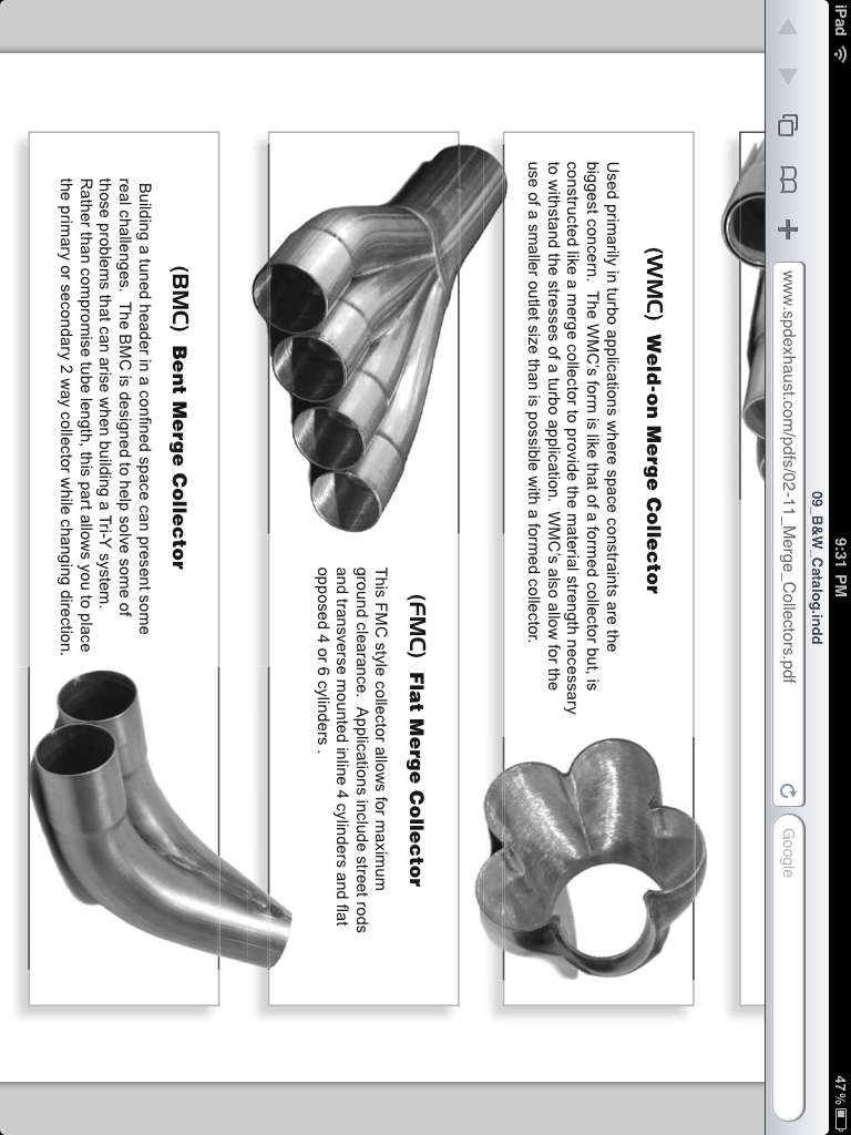

budman5201   Quick mockup of header, will redo in quality steel...   Apr 7 2010, 10:00 PM
budman5201   rear without collector yet (using this FMC one)   Apr 7 2010, 10:01 PM
SLKWrx   Sweet... Open header! :shades2: rear with...   Apr 8 2010, 11:53 AM

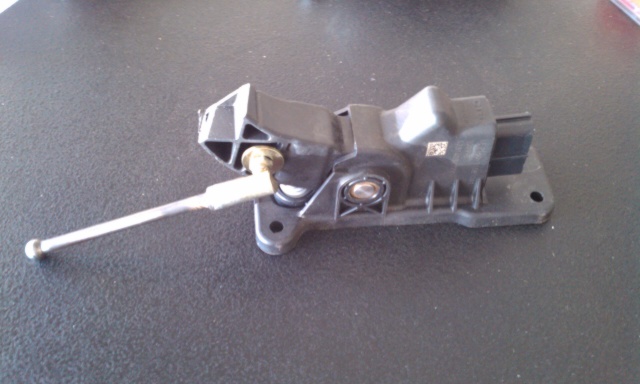

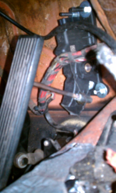

budman5201   Working on electronic throttle today. It's ama...   May 14 2010, 09:40 AM
budman5201   fuzzy pic, but drivers side of exhaust done, now p...   May 18 2010, 11:23 PM
budman5201   My electronic throttle finally arrived!! S...   May 20 2010, 05:47 PM
