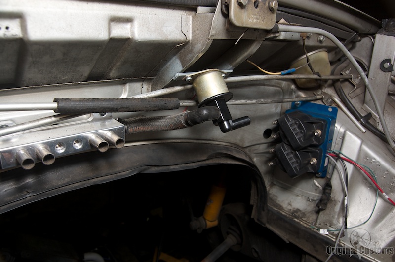

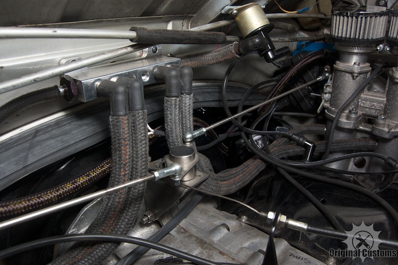

QUOTE(Racer Chris @ Apr 14 2010, 03:15 AM) *
QUOTE(zx-niner @ Apr 13 2010, 09:42 PM) *
. . I'm already tired of hard starts at 50 degrees and lousy mileage.
I have more trouble starrting the SDS injected cars in my shop during cold weather than I do my own carbed cars. (IMG:style_emoticons/default/blink.gif)
They don't have a high idle circuit for initial warmup, the cold start enrichment isn't enough by itself, and the stock type head temp sensor (thermistor) isn't accurate enough at low temps too provide the computer with good information.
Mine does... On the advice of Dave Hunt, McMark incorporated an AAR we sourced from Mark Heard. It appeared to be new old stock but proved to be a bit stiff when installed. Mark tells me (the car is still at his shop for flares) that it has loosened up and gives perfect high idle till warm...
Voila! Integrated AAR goodness... Thanks to Dave Hunt. (IMG:style_emoticons/default/biggrin.gif)

That looks pretty nice. Who built that vacuum manifold? Mark?

QUOTE(Gint @ Feb 13 2012, 05:17 PM) *
The bare bones of the vacuum manifold is commercially available from the company with the logo on the plenum. Mark assembled and plumbed everything. We put the logo backward because of the "cheese factor" (IMG:style_emoticons/default/biggrin.gif)
