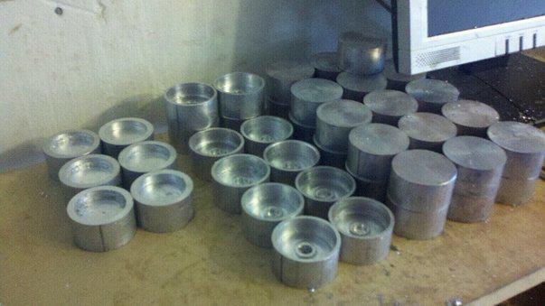

RJMII   beginnings of COOKIES!   Aug 9 2010, 12:57 PM
underthetire   Man, I just read some of your times for cutting. W...   Aug 9 2010, 01:56 PM
RJMII   Man, I just read some of your times for cutting. ...   Sep 21 2010, 07:46 PM
rick 918-S   The cookies look diffecult... :wacko:   Aug 10 2010, 07:41 AM
RJMII   I keep looking for used mini lathes that I can co...   Aug 10 2010, 08:18 AM

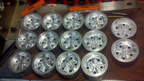

RJMII   as promised; picture of prototype FOUR! star...   Sep 21 2010, 07:41 PM

RJMII   Look, a pile of squared circles! and a lurry...   Dec 6 2010, 08:33 PM
RJMII   I ran several different sets of code on number fiv...   Dec 6 2010, 08:34 PM

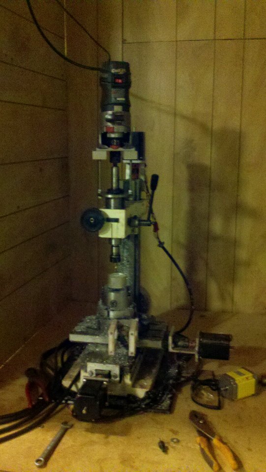

RJMII   4th axis and tailstock bolted to the mill. I shoul...   Dec 23 2010, 07:52 PM

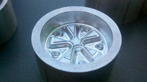

RJMII   This is the beginning of the pile of blanks that a...   Apr 21 2011, 04:57 PM

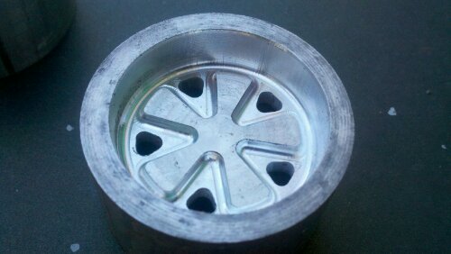

RJMII   This is the wheel that was cut out from the above ...   Apr 21 2011, 04:58 PM

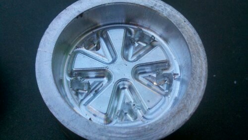

RJMII   and here is another one that had a couple of glitc...   Apr 21 2011, 04:59 PM

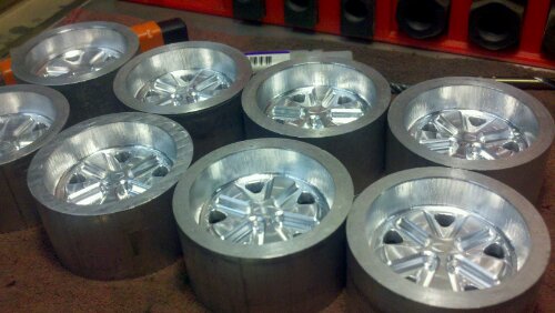

RJMII   got some more done. :) The back of the wheel is g...   May 17 2011, 01:33 PM
RJMII   Working on the different finishes using some of th...   May 17 2011, 04:31 PM
