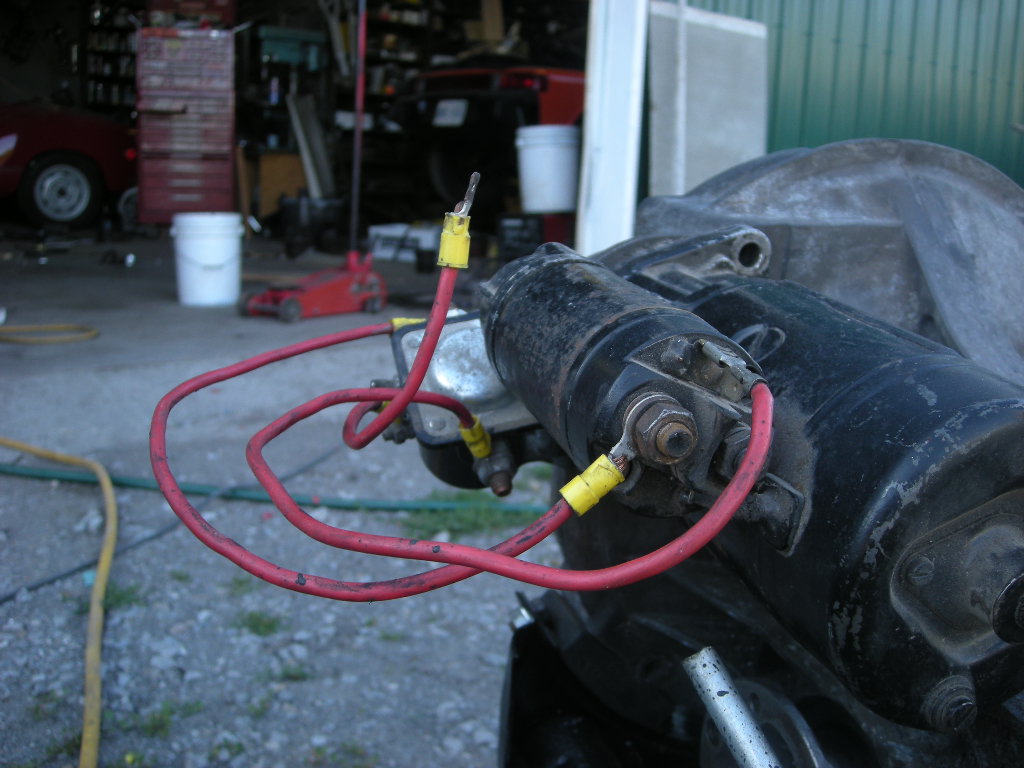

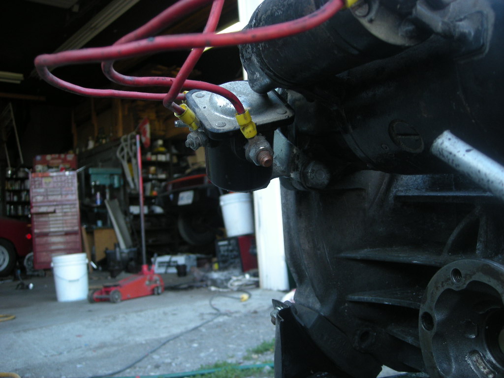

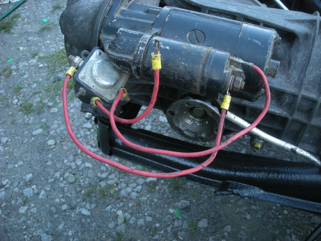

With wire, conectors and a fender mount ford solinoid under $20
The center wire is where I connect the factory wire.
Mark Henry
post Jul 20 2010, 08:33 PM
that's what I do!
Posts: 20,065
Joined: 27-December 02
From: Port Hope, Ontario
Member No.: 26
If you carefully bend the bracket and make the hole bigger you can mount it on the bottom starter bolt (stud).

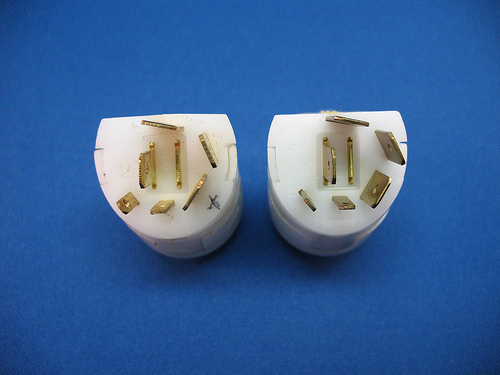

Both switches have 7 connectors and look externally alike. Once I had the switch screwed in, it seemed to fit the same, OEM and cheapie.
Here's a pic of both (OEM on the right):
(IMG:http://www.914world.com/bbs2/uploads/post-7438-1279480875.jpg)

QUOTE(Mark Henry @ Jul 20 2010, 10:26 PM) *
Thanks for the pics. I keep thinking "solenoid=doorbell" so I thought the solenoid was integral with the starter motor, the little cylindrical area next to the big cylinder on the solenoid. Like, you can't take the solenoid off the housing.
Is the solenoid the box that your wires are attached to?
And which Ford part number is that? Or are they all nearly the same?

The Ford solenoid isn't attached to the starter, it's just a switch that puts 12v direct from the battery to the VW solenoid. The Bosch starter solenoid needs a full 9V to kick in where as the ford unit only needs about 3v.
Not everyone agrees with me on this, some use the wimpy bosch horn relay, some will try to convince you to hack in a new wire. My way I have never cut a single factory wire and it always works. If it doesn't work you have bigger problems.
Surprised no one has commented on my crappy connectors....that solenoid and wires I built in the 80's and has been in service ever since.

6 connectors... 7 connectors... it was getting late (IMG:style_emoticons/default/biggrin.gif)
The two small male connectors are for the buzzer and light (6 and 7 o'clock in your photo) In my case, the OEM had a distinctly tighter fit in the column.

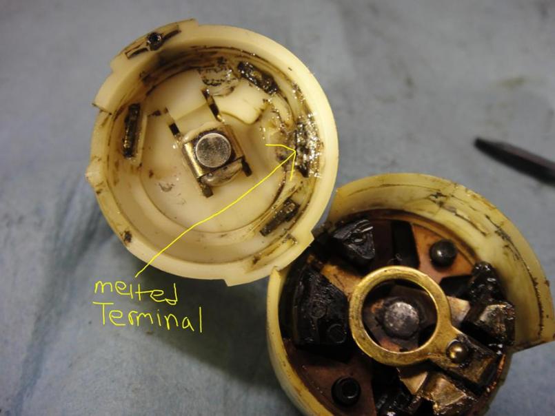

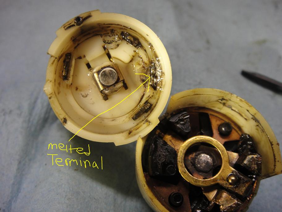

Thanks for the lead on GPR!! I just fried my ignition switch a couple of days ago and have been looking for a new one. I called GPR, and ill have the switch in 2 days. It is amazing how cheap that switch is. I figured it to be 30 or 40 bucks, nope. 4.25
Heres a pic of the inside of my fried swithch incase you have never seen what the switch guts look like. Attached Image[

You might want to figure out why that terminal fried before you plug in the new switch.

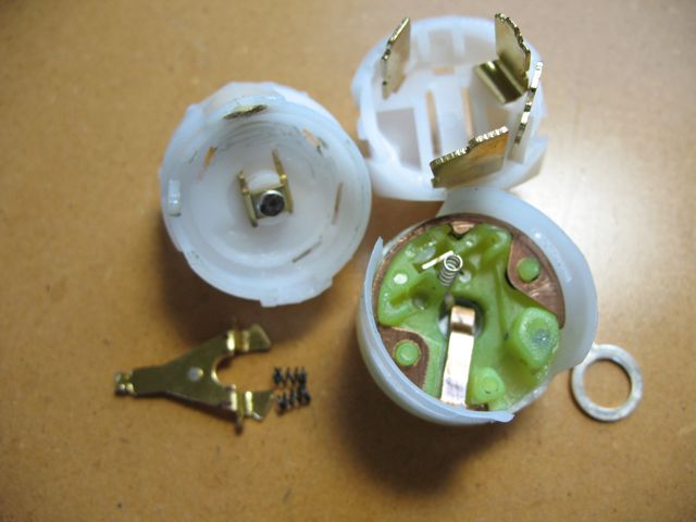

Well, here's the inside of the switch I'm discarding. Now that I took it apart and little springs and connectors jumped out, I'll definitely be discarding!
It looks awfully pristine in there...
