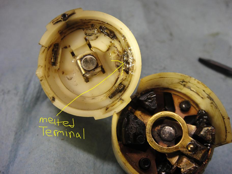

Thanks for the lead on GPR!! I just fried my ignition switch a couple of days ago and have been looking for a new one. I called GPR, and ill have the switch in 2 days. It is amazing how cheap that switch is. I figured it to be 30 or 40 bucks, nope. 4.25
Heres a pic of the inside of my fried swithch incase you have never seen what the switch guts look like. Click to view attachment[
markb
You might want to figure out why that terminal fried before you plug in the new switch.

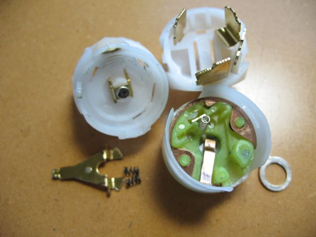

Well, here's the inside of the switch I'm discarding. Now that I took it apart and little springs and connectors jumped out, I'll definitely be discarding!
It looks awfully pristine in there...
Paul
