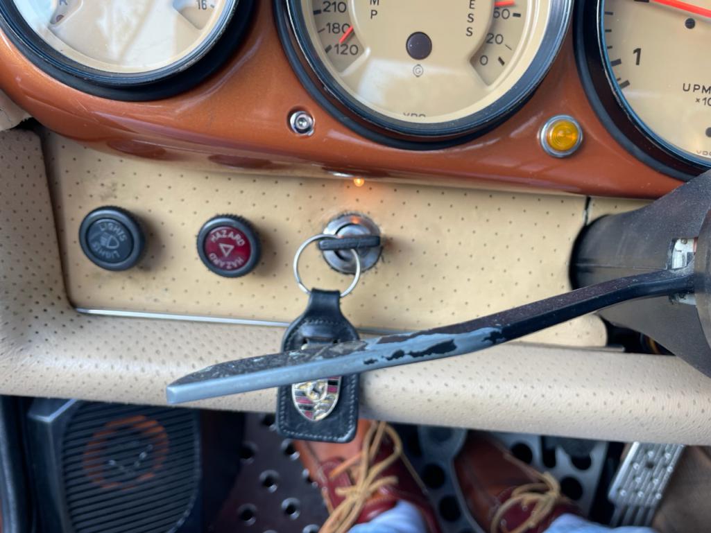

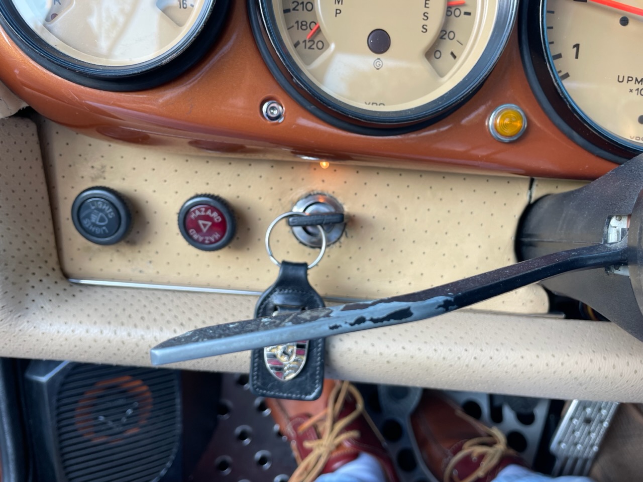

I went to a left side switch that a member here sold as a kit. Just pulled the plug off the column switch and plugged it onto the new switch.
