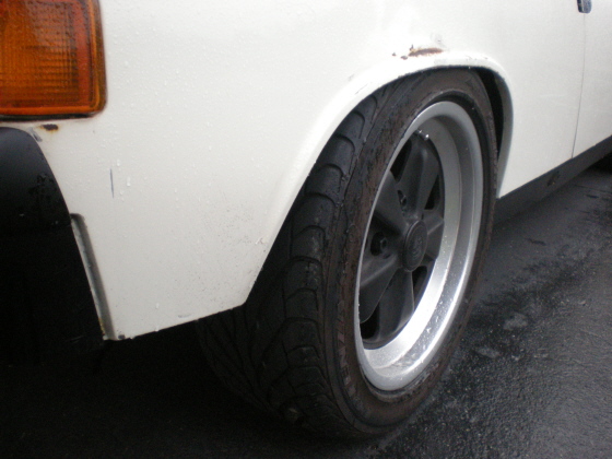

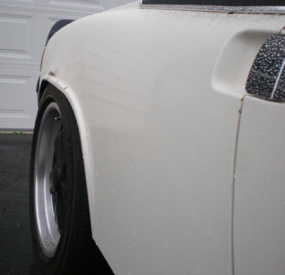

I don't know if this will help, but it might. I have 8 x 16 Fuchs, 951 series with the 23 mm offset, that I'll have on the rear of mine. Facing the mounted wheel I ran a tape from the outer edge of the wheel's three o'clock position back until it contacted the trailing arm. That distance is 10.25 inches.
From the center of your hub, measure frontward, parallel to the long axis of the car, 8.5 inches (the wheel diameter from rim edge to rim edge is about 17 inches). This was the three o'clock position on my wheel. Now intersect this point with a 10.25 inch line from the trailing arm perpendicular to the long axis of the car. This marks the outer edge of the 8 x 16.
I assume that our trailing arms are in approximately the same location. This may allow you to establish a vertical plane for visualizing how far out the 8 x 16 may extend.

951 8's 245/50' the burnt paint is from other fitments.

Thanks ...Based on pics and knowing how much wider my fenders are ...it should work. TOT
