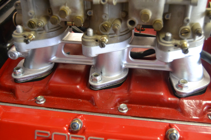

QUOTE(campbellcj @ Apr 6 2011, 11:54 PM) *
QUOTE(Bee Jay @ Apr 3 2011, 10:16 PM) *
The new lens are very transparent from the side. You could not see the bulbs from the side with the originals.
(IMG:http://www.914world.com/bbs2/uploads_offsite/i52.photobucket.com-3964-1301894163.3.jpg)
Looking good! IIRC there is a separate little reflector piece inside the stock housings that covers the bulb from the side, so you can't see it like that. Or am I confusing it with the 911 tail lamp?
Chris - you are correct. Mark

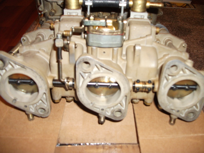

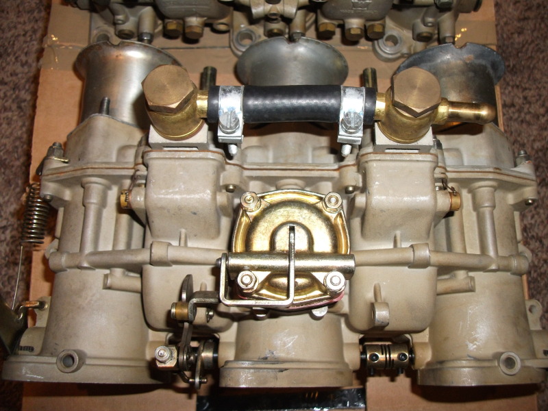

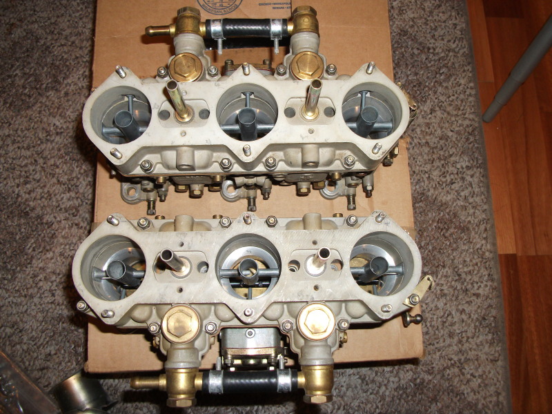

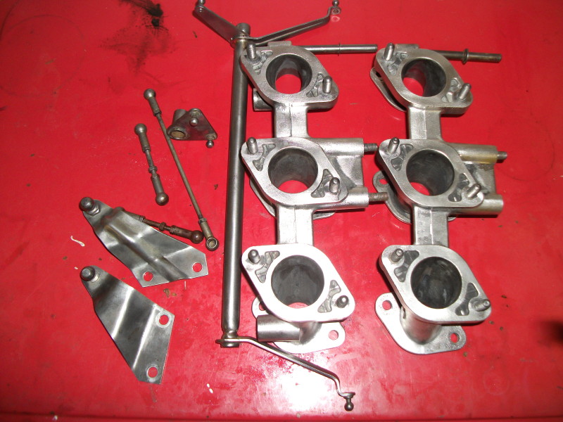

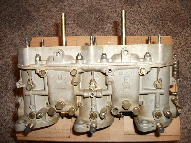

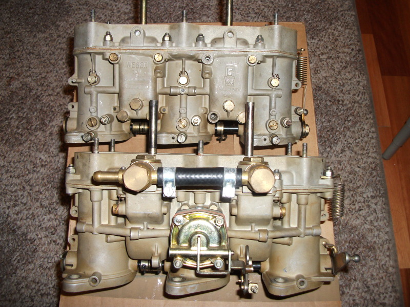

I have carbs! Woohoo! (IMG:style_emoticons/default/piratenanner.gif) (IMG:style_emoticons/default/aktion035.gif) (IMG:style_emoticons/default/cheer.gif) (IMG:style_emoticons/default/av-943.gif) (IMG:style_emoticons/default/w00t.gif) Thanks Perry. Much, much, cleaner than I expected. These things are clean. I thought I was going to have to de-gunk and clean for days. These are ready to go. Manifolds and linkage are on the way.
Bee Jay
(IMG:http://www.914world.com/bbs2/uploads_offsite/i52.photobucket.com-3964-1302320851.1.jpg)
(IMG:http://www.914world.com/bbs2/uploads_offsite/i52.photobucket.com-3964-1302320851.2.jpg)
(IMG:http://www.914world.com/bbs2/uploads_offsite/i52.photobucket.com-3964-1302320852.3.jpg)
(IMG:http://www.914world.com/bbs2/uploads_offsite/i52.photobucket.com-3964-1302320852.4.jpg)
(IMG:http://www.914world.com/bbs2/uploads_offsite/i52.photobucket.com-3964-1302320853.5.jpg)
(IMG:http://www.914world.com/bbs2/uploads_offsite/i52.photobucket.com-3964-1302320853.6.jpg)

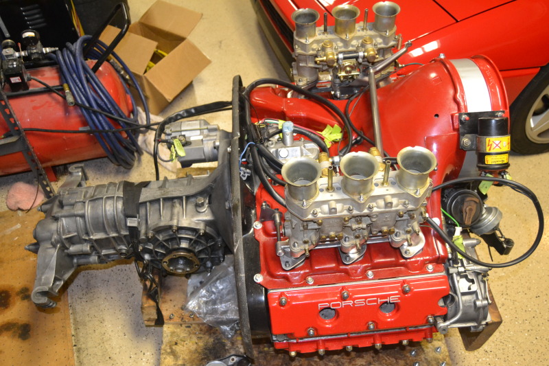

Good news. As promised the Carbs are set up perfectly for a 3.0 liter.
The carb set up Anderson recommends is:
40IDA-3C carbs
34 mm venturis 34mm
F3 emulsion tubes F3
160 main jets 155
175 air correction jets 175
60 or 65 idle jets, maybe even bigger to avoid part throttle surge 65
I'm waiting on intake manfolds to mount the carbs to the engine. In the mean time, I have a few questions.
What spark plugs should I run with a carbed 3.0 with stock cams?
Where do you get affordable (cheap) spark plug wires?
What oil filter do you run on a Velios Oil tank like I have?
I need to buy new distributor cap and rotor too.
I guess I should make this engine as complete as possible before mounting it into the car.

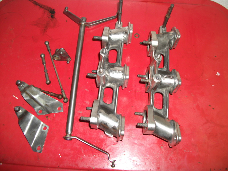

I've got intake manifolds. They didn't look like this when I got them. I let them soak overnight in the parts washer, then I attacked them with my wire brush wheel. One small problem, these are two right side manifolds. The supplier said I simply make a left side manifold by removing the shaft from one of the manifolds. How do I do that? Do the shafts just pull out? Do I have to have them pressed out?I plan to paint them silver.

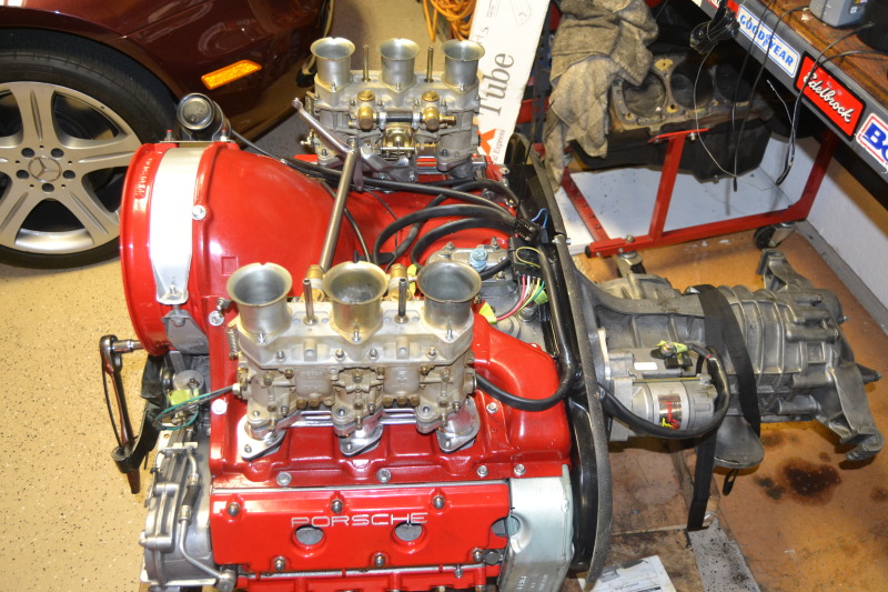

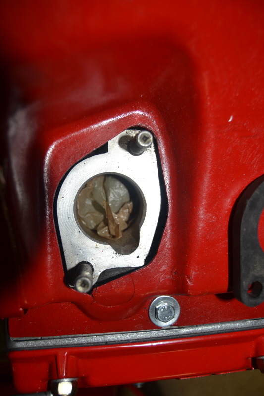

OK. I have webers and I have factory 911 carb manifolds. I assumed all I needed were PMO insulators to put the manifolds onto my 82 3.0CIS heads. But when the Cap'n called PMO to order the insulators, the PMO guy poo poo'd my plan and said that the only way to do it properly was to use the insulators with PMO manifolds or have the injector notches welded up in the heads. what do you Guy think or recommend? Is there a way to make these manifolds work?
rfuerst911sc
post Apr 24 2011, 05:24 PM
Post #127
Posts: 2,158
Joined: 4-May 06
From: Dahlonega , Georgia
Member No.: 5,980
I'm running 911 manifolds with Weber carb's on my 1978 3.0 with just insulators and gaskets with no problems.
moparrob
post Apr 24 2011, 09:05 PM
Post #128
Posts: 646
Joined: 27-April 10
From: Los Angeles
Member No.: 11,663
Why wouldn't it work? The insulator covers the injector notch and seals the manifold....

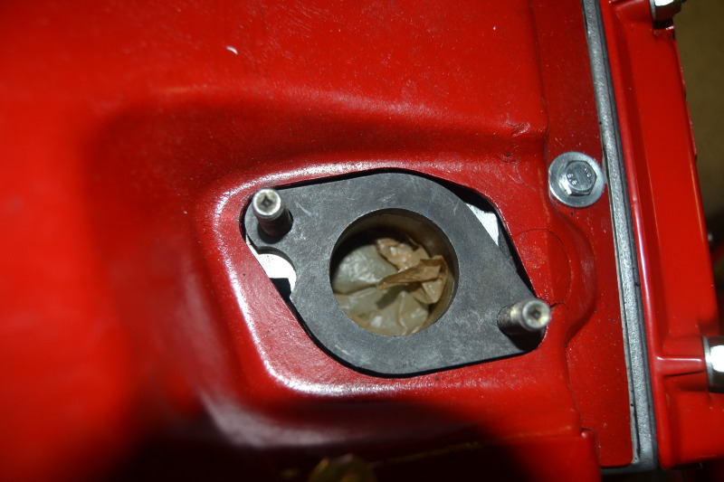

I now have 33mm PMO insulators/spacers. They do cover the fuel injection notch rather nicely and I don't see how a PMO manifold would do any different than this factory manifold. I could not resist the temptation to mock up the manifolds and carbs. I have to paint the manifolds and find the bushing that goes inside the bellcrank toward the back of the engine compartment, the bushing goes on the rod extending from the manifold. Also, the stock studs are long enough.
Bee Jay
(IMG:http://www.914world.com/bbs2/uploads_offsite/i52.photobucket.com-3964-1304657774.1.jpg)
(IMG:http://www.914world.com/bbs2/uploads_offsite/i52.photobucket.com-3964-1304657775.2.jpg)
(IMG:http://www.914world.com/bbs2/uploads_offsite/i52.photobucket.com-3964-1304657775.3.jpg)
(IMG:http://www.914world.com/bbs2/uploads_offsite/i52.photobucket.com-3964-1304657776.4.jpg)
(IMG:http://www.914world.com/bbs2/uploads_offsite/i52.photobucket.com-3964-1304657948.1.jpg)
(IMG:http://www.914world.com/bbs2/uploads_offsite/i52.photobucket.com-3964-1304657948.2.jpg)
patssle
post May 6 2011, 09:04 AM
Post #130
Posts: 981
Joined: 28-August 09
From: Houston, TX
Member No.: 10,741
I thought I had read that you're suppose to take out those studs when converting to carbs. But from your pictures, it seems unnecessary, plenty of room for locking nuts.
It seems the spacers are required? Where did you get them, direct from PMO?

I got them form Bruce, FLAT6PACnc@aol.com on Pelican, a pleasure to deal with. Yes, they are PMO.

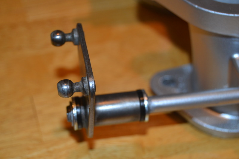

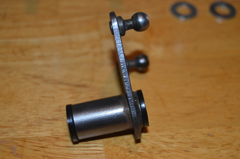

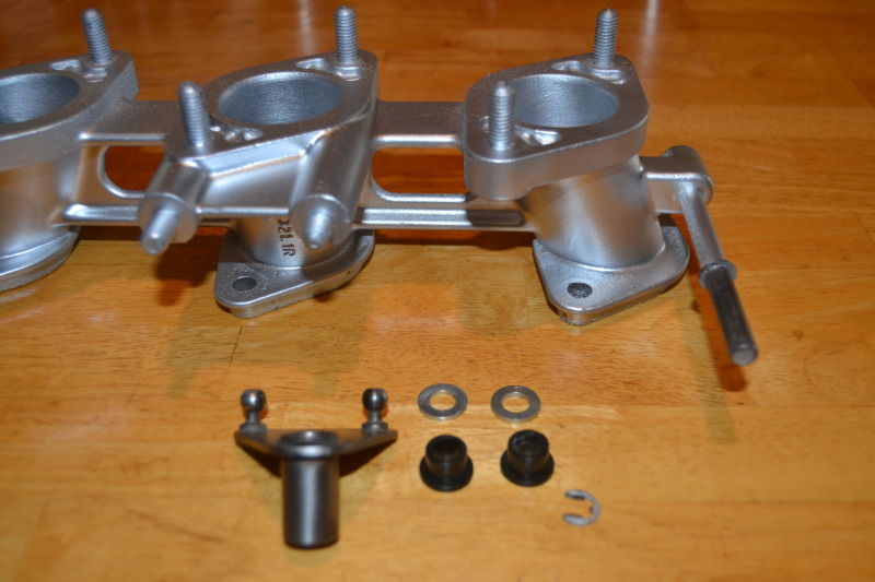

Where can I find the bushing that goes on this bellcrank. Is it a Porsche dealer item? Or can I find it in any FLAPS?

At a FLAPS? You're kidding, right? If you think they don't have 914 parts, they REALLY don't have 911 stuff. I have them. Bring the bell crank with you. I'll be here tomorrow.

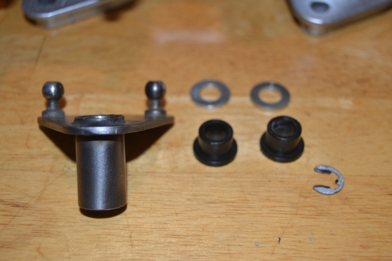

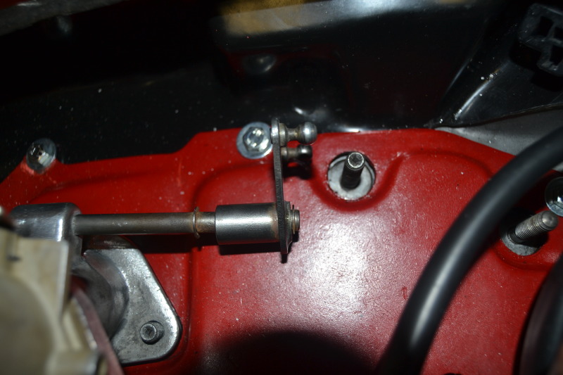

The Cap'n had the bellcrank busings. This is what they look like and how everything assembles. I figure someone else may be as clueless as me.
Bee Jay
(IMG:http://www.914world.com/bbs2/uploads_offsite/i52.photobucket.com-3964-1304838966.1.jpg)
(IMG:http://www.914world.com/bbs2/uploads_offsite/i52.photobucket.com-3964-1304838967.2.jpg)
(IMG:http://www.914world.com/bbs2/uploads_offsite/i52.photobucket.com-3964-1304838967.3.jpg)
(IMG:http://www.914world.com/bbs2/uploads_offsite/i52.photobucket.com-3964-1304838967.4.jpg)
J P Stein
post May 8 2011, 08:44 AM
Post #137
Irrelevant old fart
Posts: 8,797
From: Vancouver, WA
Member No.: 45
I agree with the PMO guy. You do not want any leakage there....ever. Tuning the Webers is tough enough without any variables built in.
....but do what you want.

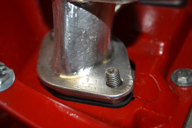

I'm already in the search for PMO manifolds mode, but I still can't see how they will seal the spacers any better than the factory manifolds. Actually I think he preferred the heads be welded up.

QUOTE(Bee Jay @ May 8 2011, 10:55 AM) *
Plastic (or phenolic) is flexible. Bolt it to a semi-compressible surface (gasket) and the plastic will bend if not supported or squeezed. The phenolic spacer will
(by itself) not compress the gasket to the same thickness as under the manifold.
This could cause a gap to open up immediately or over time. A back fire could also blow out the gasket is not squeezed between two solid surfaces. Back fires & Webers while tuning are inseparable. Either way, it will cause a vacuum leak.
Personally, I like my stuff as bullet proof as I can make it.
I think you will find the welding & milling of the heads more expensive that PMO manifolds.

OK, I think I actually understand what you are saying now. So the PMO manifolds will do a better job of covering the entire gasket and spacer and not leave any exposed like this?
(IMG:http://www.914world.com/bbs2/uploads_offsite/i52.photobucket.com-3964-1304886970.1.jpg)
