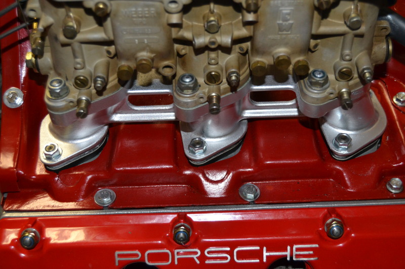

Yes, got a pic that shows the area not specifically for that but you can see the shape of the PMOs. I went thru the same quandry some years back.

Another pic for ya. The manifold base is noticeably larger.
(IMG:http://www.914world.com/bbs2/uploads_offsite/farm3.static.flickr.com-21-1304902984.1.jpg)
914R Engine bay by cjcam, on Flickr

Bee Jay,
Are those intake studs long enough? It doesn't seem like the nylon part of the Nylock nut is actually engaging the threads. Is that an illusion or do they not protrude through?

QUOTE(moparrob @ May 8 2011, 07:14 PM) *
Bee Jay,
The nylon part of the nuts are engaged, but I may remove the washers to get even more. What is the torque spec for the manifold to head nuts with phenolic spacers underneath? The picture was taken right after glueing the spacer gaskets in place. I'll retorque to the number I find out and I bet I get even more nylon.

Glue? Nope. Don't need it. Most of it isn't fuel proof, anyway. Nylocs? Naah. Use no glue, get rid of the flat washers, use spring (AKA "wavy") washers and plain nuts. Torque them to 15 ft/lbs (or 18 if you want to).
The Cap'n

QUOTE(Cap'n Krusty @ May 9 2011, 05:20 PM) *
The Cap'n

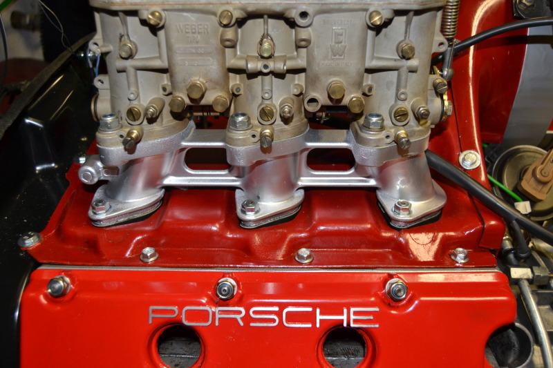

I got wavy washers and normal nuts from the Cap'n tonight and replaced the regular flat washers and nyloc nuts on the manifold. Torqued them to 15 ft/lbs. This is the result. Look OK? I am very glad that I'm doing this with the engine in my lap. I can't imagine doing this with the engine in the car.
Bee Jay

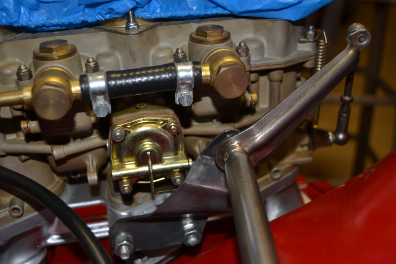

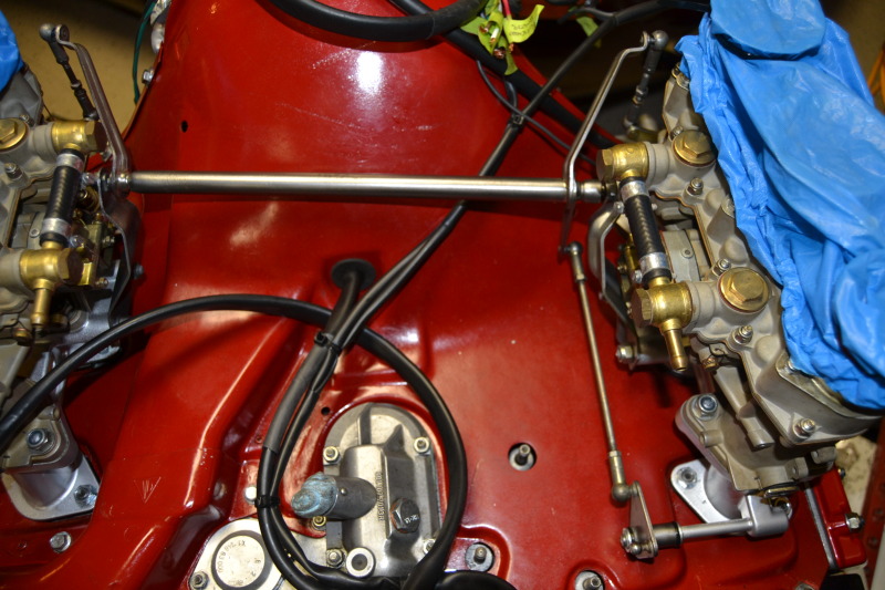

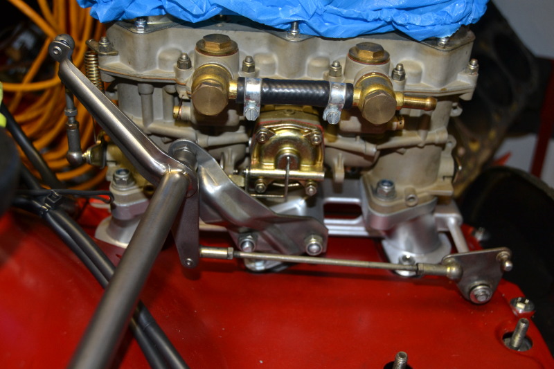

I cleaned and installed the throttle linkage. I could not find a clear set of pictures of how it was supposed to look, so here are pictures for later reference. I think the engine is ready for installation into the engine bay. Perhaps this weekend. My goal was to have the car down and running by this summer. That ain't gonna happen. Maybe I can get the engine in by June 1st.
Bee Jay

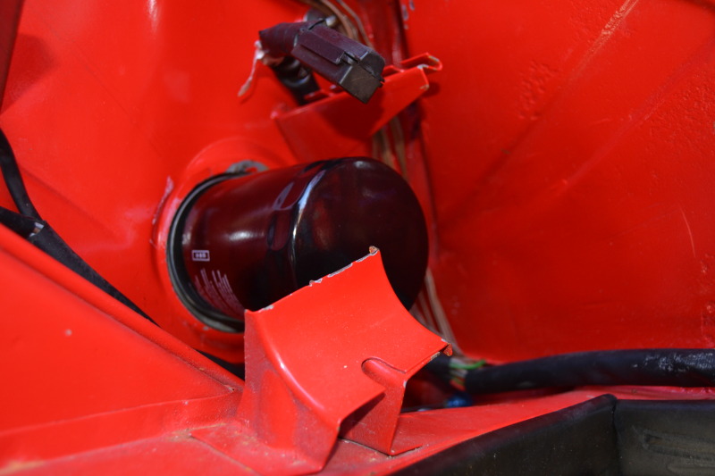

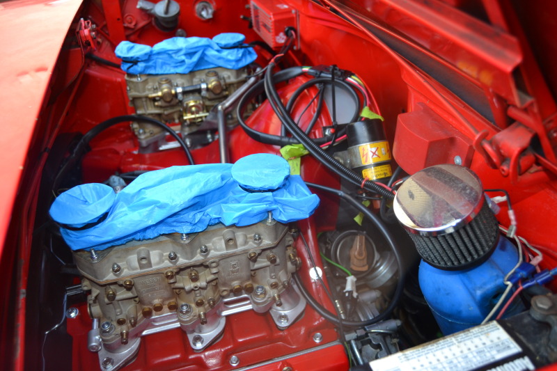

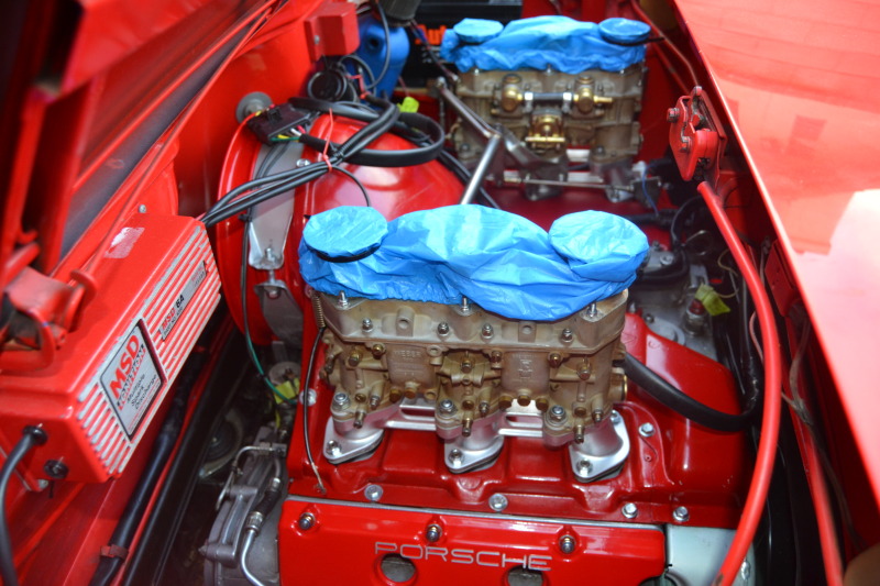

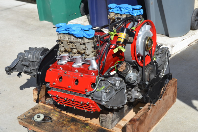

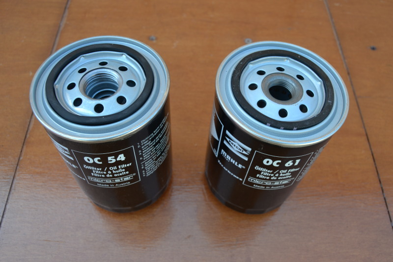

The engine is in the car! (IMG:style_emoticons/default/piratenanner.gif)
There are two 914-6 oil filters, so John let me take two home to figure it out. The Mahle OC54 Oil filter went in just fine with the heater motor brakcets there.
Now that the engine is in the car, the plumbing of oil and gas lines, electrical connections, and about a million other things can start now.

Looking good (IMG:style_emoticons/default/piratenanner.gif) Is your oil tank an OEM or aftermarket ? My DW Design tank it was suggested to use the OC61 which fits fine. Is the thread size different between the OC54 vs. OC61 ? Wait until you fire her up for the first time !! Keep us posted.

Is there engine tin on this motor? Trying to see how it fits with the rubber or if rubber is actually used on conversions. Looks great!

I followed Wayne Dempsey's advice and installed the engine with no front or side tin (fiberglass) installed. The engine went in much easier than my last attemp with tin installed, and you need the access to the front engine mounts. I'll work on getting the engine tin in place today.
Aftermarket Velious tank. I bought it off of the internet and had no clue. I assumed that all 914-6 oil filters were the same. Yes, the OC 61 would not screw on because the fitting on the filter was way too small. I think the Capt'n said the OC 54 is the "late" size.
