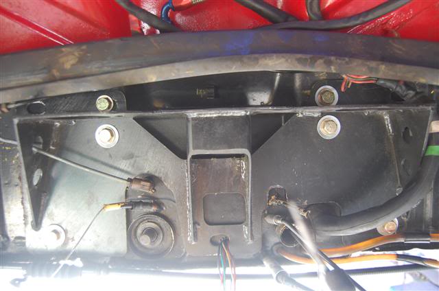

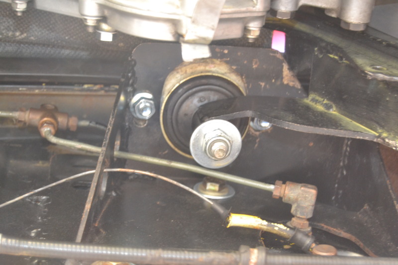

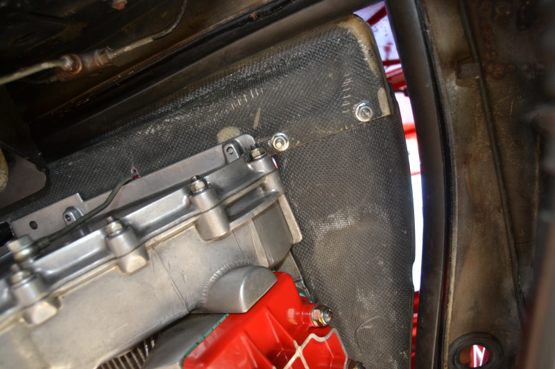

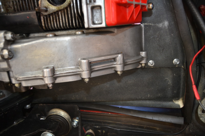

Nope, you can't install it before, you need access to the engine mounts while installing. You can just lay the front tin up on the shelf just before you lower the car or raise the engine. I should have taken pictures but I was in no happy snaps mood. It's a good thing the world didn't end yesterday as predicted because I lost my religion a couple of times. (IMG:style_emoticons/default/sad.gif)
Here is a picture of the motor mount.
Bee Jay
(IMG:http://www.914world.com/bbs2/uploads_offsite/i52.photobucket.com-3964-1306066337.1.jpg)
(IMG:http://www.914world.com/bbs2/uploads_offsite/i52.photobucket.com-3964-1306066337.2.jpg)
If you look closely at this picture, you can see the left front motor mount and how easily you can access it with the engine tin not installed. This picture is from Friday, when I didn't even have the front engine tin sitting on the front engine bay shelf.
(IMG:http://www.914world.com/bbs2/uploads_offsite/i52.photobucket.com-3964-1306066512.1.jpg)

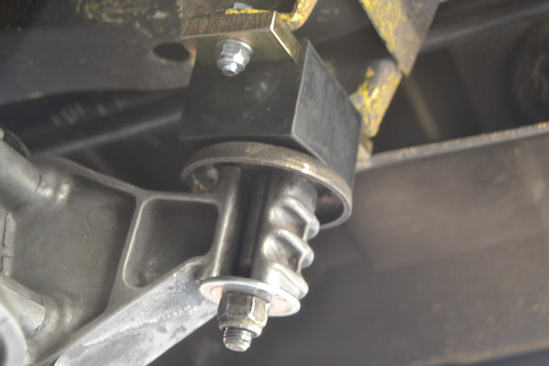

Here is a picture of the tranny mount. If you tilt the engine too much, the bolt will slip right out of the front, which would be obvious to the average dumbass, but I excell in that category.
(IMG:http://www.914world.com/bbs2/uploads_offsite/i52.photobucket.com-3964-1306066804.1.jpg)

Doood , you missing that big cup type washer that goes on top of the trans ear , it helps to prevent slippage off of boltus.
Looking great , keep at it .

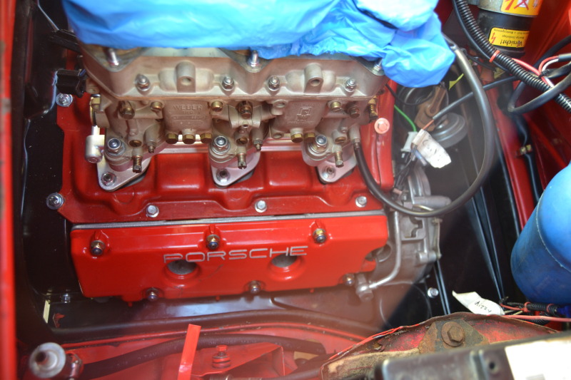

THE ENGINE TIN IS IN! I know exactly what you are saying, "Big Whoop". (IMG:style_emoticons/default/WTF.gif)
Well Perry said it best, to install the front and side tin with the engine installed requires an ambidextrious, powerful, little person. It's about all I got accomplished today other than work on the motor and trans mounts. I think if you can do it, install the engine with the tin installed. Remove the trailing arm bolts if you have to. JMHO.
