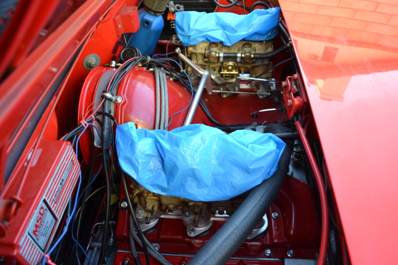

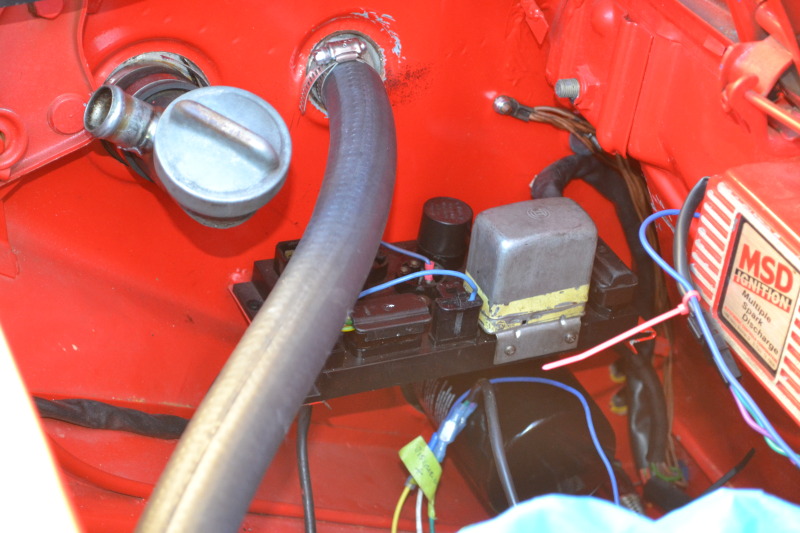

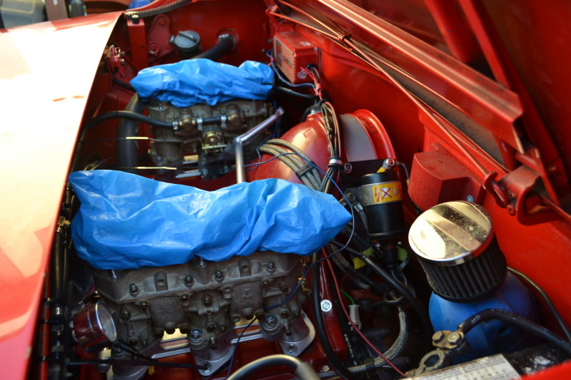

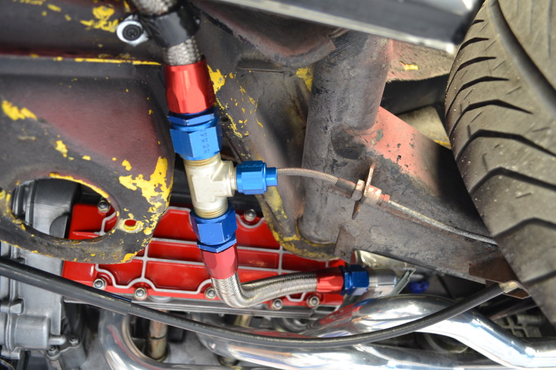

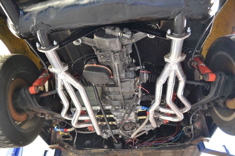

It was a very nice 4th of July weekend. The weather was great, I had three days off, and Sylvia was out of town. So I spent most of the weekend wrenching, not solely on the Porsche, but mostly.
I filled the tranny with 2.5 quarts of synthetic gear oil. I adel clamped the oil lines to make sure they never wandered close to the header pipes. I installed a new fuel filter and ran hose to a pressure gauge and to the Webbers. I turned the key on and the fuel pump is working perfectly. I ran a 1" vent hose from the oil tank to the outlet on top of the engine. I turned the key on and checked out all of the electricals and the gauges. I have to find the oil pressure wire in the dash, but in the mean time I can use the wire I used for the four. I installed the distributor after removing the vacuum can to improve acess in the engine compartment. I used safety wire to lock down the vacuum advance plate. The spark plug wires are installed and plugged into the dizzy.
I think I'mn getting close. I need to find a pair of air cleaners and I haven't been to sucessful at shopping for those and I need a 911 tach. I need to fill the Velois tank with oil. How much does it hold? Anyone. I have to buy six spark plugs. What works good in a carbed 3.0 SC engine. Maybe instead of a 911 tach, I can get one of these:
http://www.technoversions.com/TachMatchHome.html
(IMG:style_emoticons/default/santa_smiley.gif) (IMG:style_emoticons/default/santa_smiley.gif)
It's weird. Instead of getting excited, I'm really worried. I decided, with some good advice, not to rebuild this engine. Just stick it in and see if it runs. What if it doesn't? What if it does and rattles and smokes like Joe Camel. What if the pressure fed tensioners don't tension. Is this MSD wired right? I'm a nervous wreck. Maybe it wall start and everything will be fine.
I guess If I don't find air cleaners or a tach soon, I could crank it up without. Maybe this weekend. Drinks are on me if it starts. If all goes well, I can drive it up to Rennsport reunion in October.

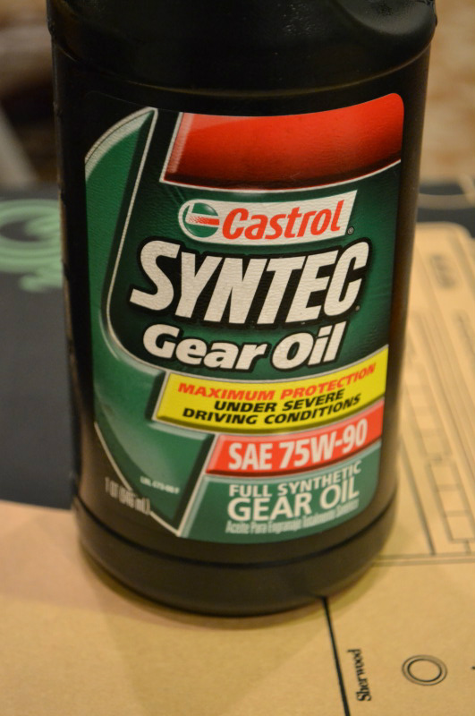

"Conventional wisdom" in this case consists of believing too much of what you read in "enthusiast" magazines and forums like this one, without considering the qualifications and agenda of the person making the statement. Regular gear oil is cheaper than "SWEPCO 201" or synthetics, and works just fine in our gearboxes, providing you use GL5 ONLY. I've never heard of properly used synthetic gear oils "chewing up" the insides of gearboxes, and I've been rebuilding Porsche trannies since 1971. If they meed the specs, they'll do the job, albeit at a price far higher than conventional gear oils.
I read Bee Jay's answer to this question, and I caution him to look at the Castrol container. If it doesn't say GL5, it's the WRONG gear oil. No GL4-GL5, no one-size-fits-all, no MoSO2 additives, just "GL5".
I agree with the Cap'n. It's been mentioned elsewhere, and I have noticed, that "conventional GL-5 gear oil" doesn't leak past tranny seals whereas synthetic oils do. Don't waste your money.
Here's Syntec http://www.castrol.com/castrol/sectiongene...ntentId=7036193
Here's regular Hypoy C http://www.castrol.com/castrol/sectiongene...ntentId=7036192
Both are listed as GL-5 for 75W-90

Hey, that's the stuff I put in!!!!. I guess I'm alright. Geez, this Porsche tranny is more picky than my Ferrari tranny. Put the wrong stuff in there and you've got real problems.
Thanks guys for not letting me mess up.

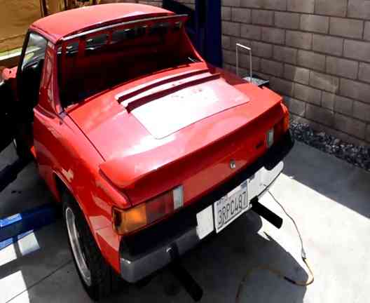

Bee Jay
post Jul 11 2011, 08:39 AM
Post #218
Posts: 204
Joined: 22-April 05
From: Lompoc, Ca.
Member No.: 3,964
QUOTE(RiqueMar @ Jul 11 2011, 07:25 AM) *
QUOTE(AZ914 @ Jul 11 2011, 07:03 AM) *
Awesome BeeJay! BTW, thanks for this thread and all the detail and pictures... it is really helping me with my conversion.
We need another smiley that says, "THIS THREAD IS WORTHLESS WITHOUT VIDEO!"
(IMG:style_emoticons/default/aktion035.gif) (IMG:style_emoticons/default/beerchug.gif)
Here is the video, I hope. Nothing special. Engine idleing.
(IMG:http://www.914world.com/bbs2/uploads_offsite/i52.photobucket.com-3964-1310395170.1.jpg)
