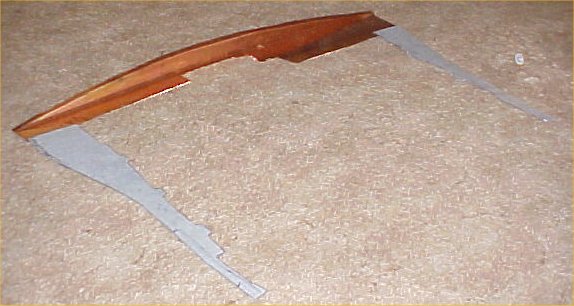

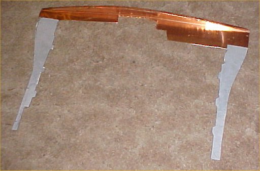

Here's the start of my engine tin, ala Root.
I had a piece of tin off a stove that protected it before install and piece of copper that already had the bend in it. (IMG:style_emoticons/default/smash.gif)
I'll drill the holes and paint it tommorrow with high temp BBQ paint ( FBF ) (IMG:style_emoticons/default/wink.gif)

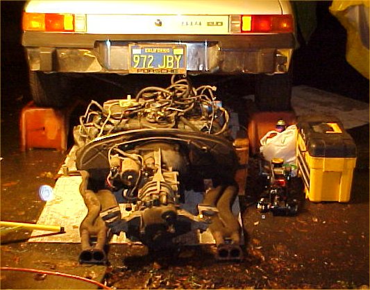

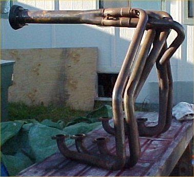

Took of the big Baja header off and all the test hoses and wires today. Motor looks a lot smaller to me.

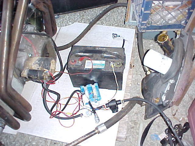

KT, are you running the engine on the ground?
I am thinking about doing that but would like to hear of any issues you had first.
Cheers
Trekkor
post Dec 18 2004, 09:23 PM
Post #209
I do things...
Posts: 7,809
Joined: 2-December 03
From: Napa, Ca
Member No.: 1,413

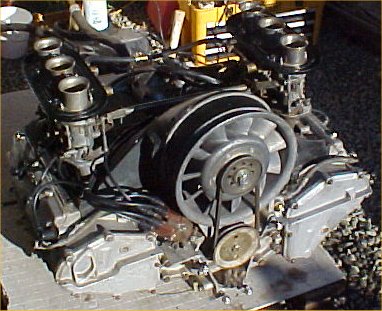

Why, yes. I do run the engine right there on the ground. (IMG:style_emoticons/default/wink.gif)
You need some simple test items.
Test exhaust ( see above ), trans bell housing, starter, oil tank and lines, test starting wire harness, fuel tank, fuel pump, and a battery.
In the picture, the blue junction box has a start switch and a coil/fuel pump power switch.
The engine will run smooth on the bench without dancing all over the place. I revved mine well over 6000 rpms with NO problems.
I'm all done testing, so it's all off now. (IMG:style_emoticons/default/wink.gif)

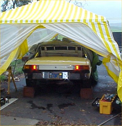

Here's what the nieghbor's get to see.
Kinda circus theme...

Here's the business end (IMG:http://www.914world.com/bbs2/html/emoticons/wink.gif)
Since our last visit more parts are off:
Muffler, muffler hanger, fuel lines, clutch cable, speedo cable, throttle cable, pass side injector harness, C.V. joints, shifter rod, battery cable and some more wires.

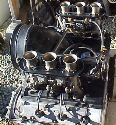

I'll miss that powerplant...Taught me a lot.
Thanks little FOUR.
KT

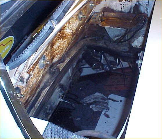

This week I hope to do the battery tray repair and cut the holes for the oil tank and install it. Plumb for cooler.
I have a little rust repair to do as well.
