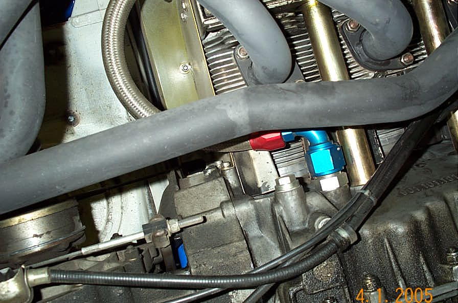

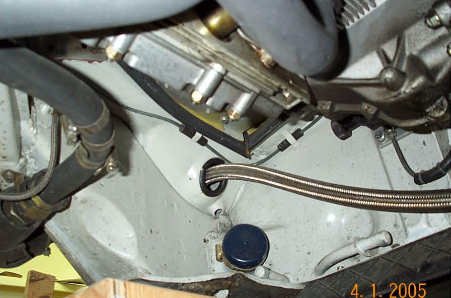

Same line from underside
J P Stein
post Jan 4 2005, 11:53 AM
Post #262
Irrelevant old fart
Posts: 8,797
From: Vancouver, WA
Member No.: 45
Scavenge line routing from case.....goes aft, then fwd......there's too much "stuff" in the way to just go fwd initally....for me, at least.

That is great! This helps me get a better grasp on what is happening down there.
I'll follow up with my set-up shortly.
KT

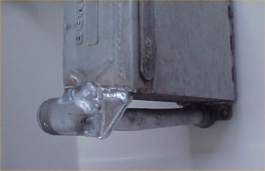

Cooler mod is done.

Hmmmmm, you sure that's gonna clear the swing arm?

'gain. Still have to put it on the motor.
The motor and trans combo is assembled and staged right behind the car.
Tonight, there may be a party. (IMG:http://www.914world.com/bbs2/html/emoticons/cool_shades.gif)
KT

Mike, I'm good... (IMG:http://www.914world.com/bbs2/html/emoticons/wink.gif)
Brant and JP's pics a page back showed me the way.
Got fresh -16, -12 lines, various fittings and firesleeve for the sections near the headers. (IMG:http://www.914world.com/bbs2/html/emoticons/boldblue.gif)

Details on the mod..Did you go it or have a local welder do it? WHhat type of fitting did you use? Looks like a 90deg AN-16 x ?

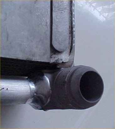

Local welder-$100. (IMG:http://www.914world.com/bbs2/html/emoticons/welder.gif)
He blasted off the anodized coating off the -16 AN 90 and slipped it over the supply tube. He had to bore out the inside diameter of the 90, slightly, to fit it.
He welded on a support gusset as well. I'm happy. (IMG:http://www.914world.com/bbs2/html/emoticons/biggrin.gif)
KT
( Motor should be installed by 9:00pm... (IMG:http://www.914world.com/bbs2/html/emoticons/dry.gif) )
