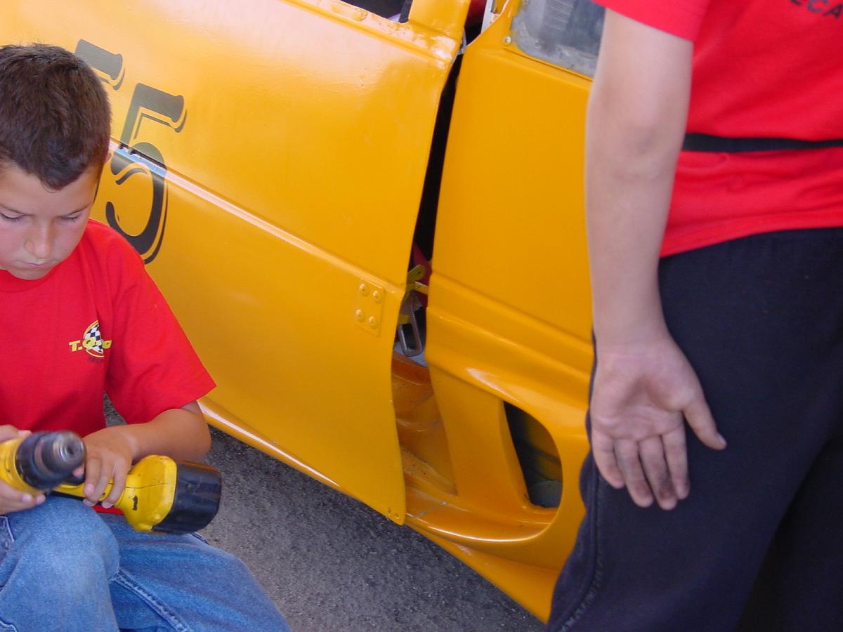

You could do something like this which was on a race car that I saw in a race in Mexicali MX back in 2003. Note the young mechanic is getting the cordless drill ready to put in several sheet metal screws to hold the door tightly shut!
Attached thumbnail(s) |

You could do something like this which was on a race car that I saw in a race in Mexicali MX back in 2003. Note the young mechanic is getting the cordless drill ready to put in several sheet metal screws to hold the door tightly shut! is that a fense striker 7 latch??? (IMG:style_emoticons/default/biggrin.gif) |
