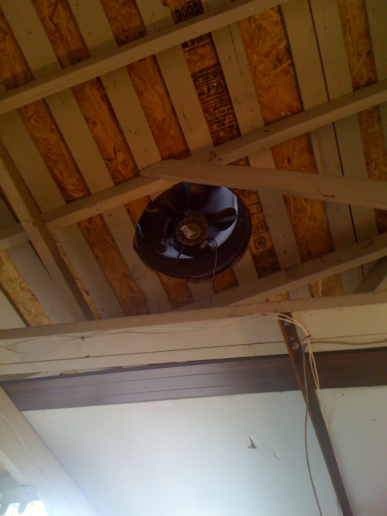

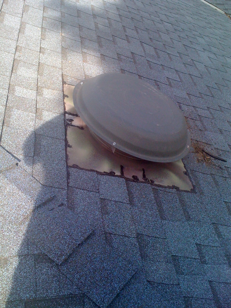

Saturday morning I installed a 2500CFM fan in the garage! Picked it up for $100 from a body shop that decided to stop priming in their main shop. (original price was $260).
Up and running in a hour!

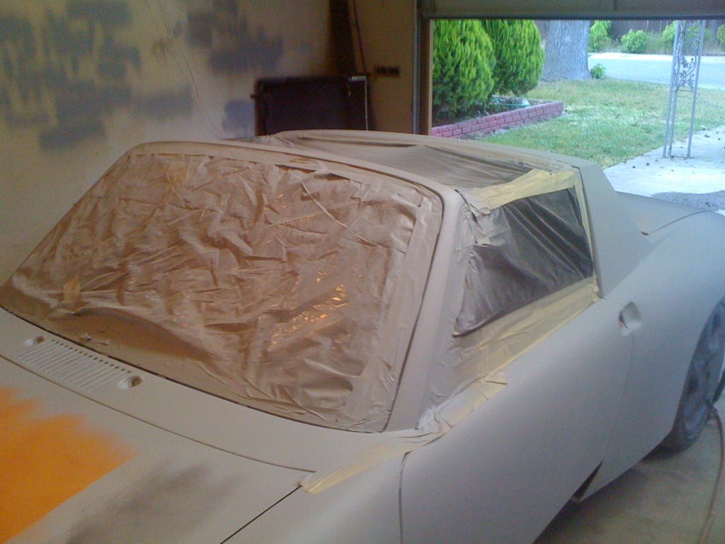

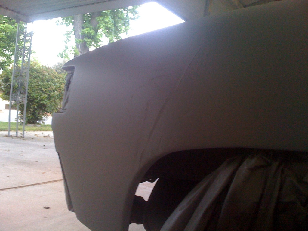

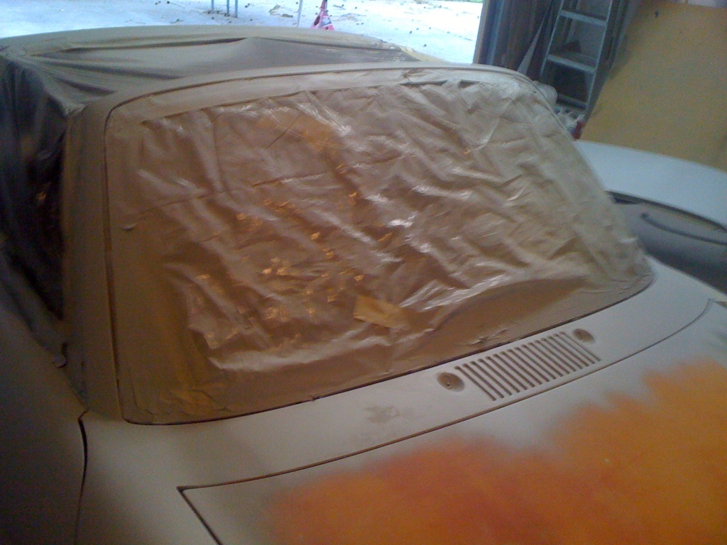

Spent a bunch of time sanding the cowl area (read 4+ hours.. Apparently no one bothers to sand those vent holes and the wiper holes)
(IMG:http://www.914world.com/bbs2/uploads_offsite/i1210.photobucket.com-172-1303750062.3.jpg)
Sanded and primed the rear as well
(IMG:http://www.914world.com/bbs2/uploads_offsite/i1210.photobucket.com-172-1303750062.4.jpg)

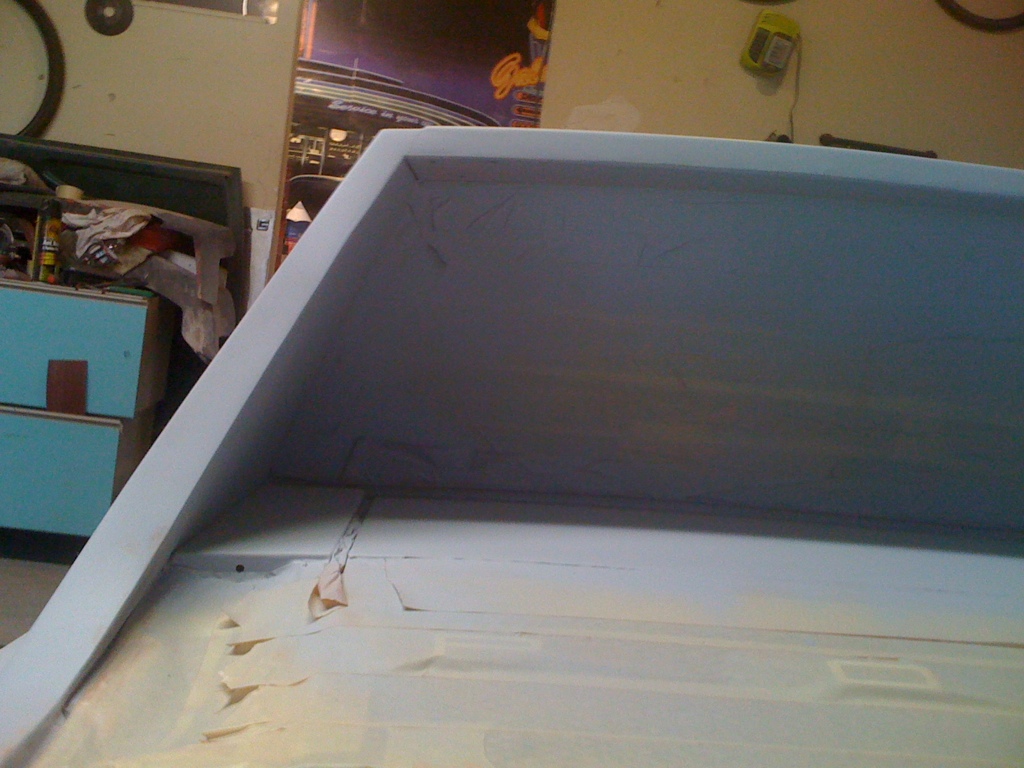

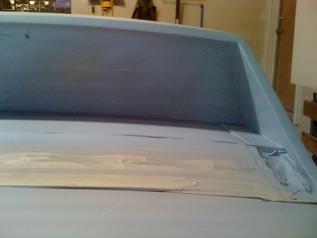

All went well till I went for a second layer of primer on the targa bar..
(IMG:http://www.914world.com/bbs2/uploads_offsite/i1210.photobucket.com-172-1303750066.9.jpg)
I was PISSED OFF... This was supposed to be the last final layer of primer on this side.. Damn.
I sanded this all down last night and its ready for a second coat of primer fill on a couple area's. So i'll get the fender and those area's in primer tonight hopefully.

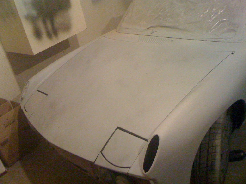

I sprayed the area's that I needed to finish, so the whole car, minus the front trunk is in final primer. I have some touch up pitting in the targa bar that i'll fix over the next week, and i'll get the front trunk done this weekend.
Once the paint comes in then I think i'll start by test spraying the targa top.

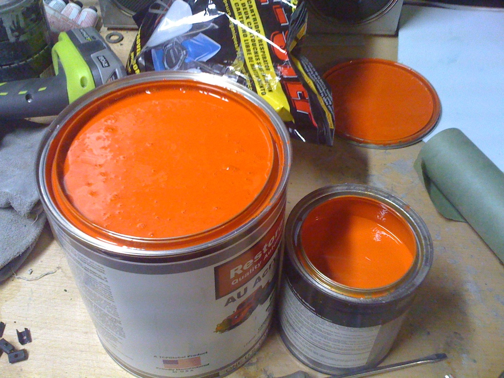

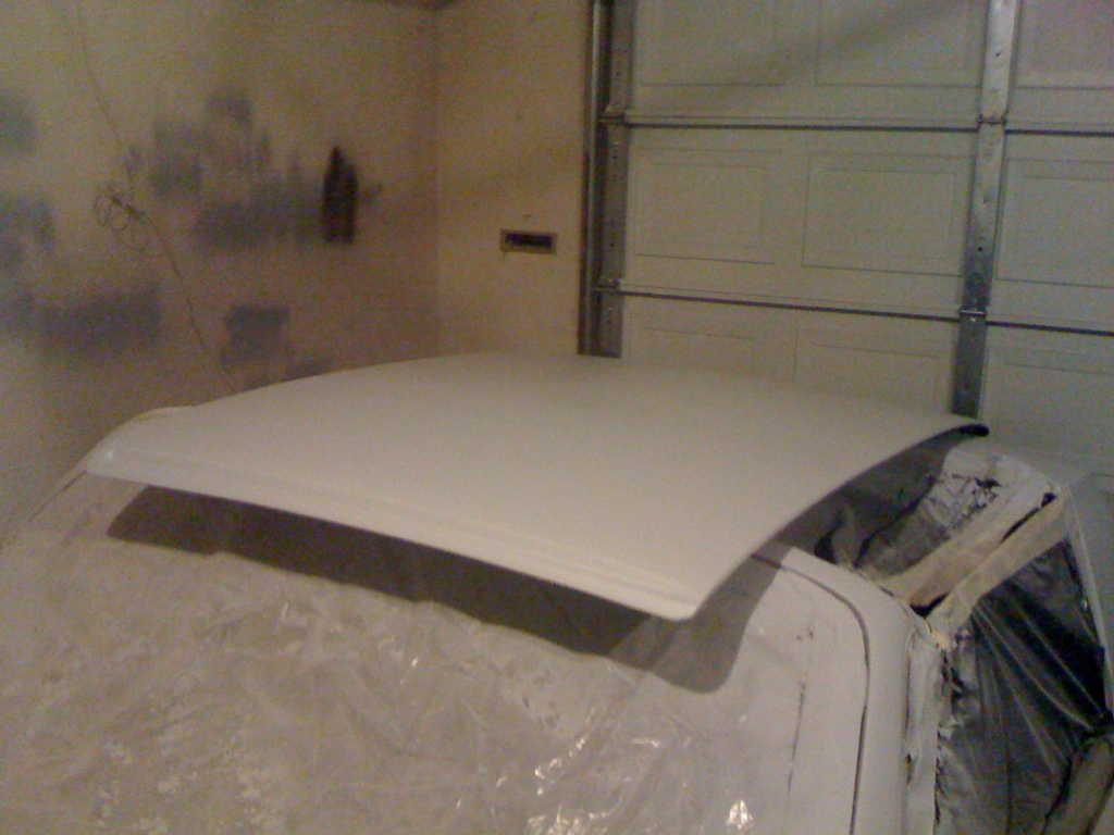

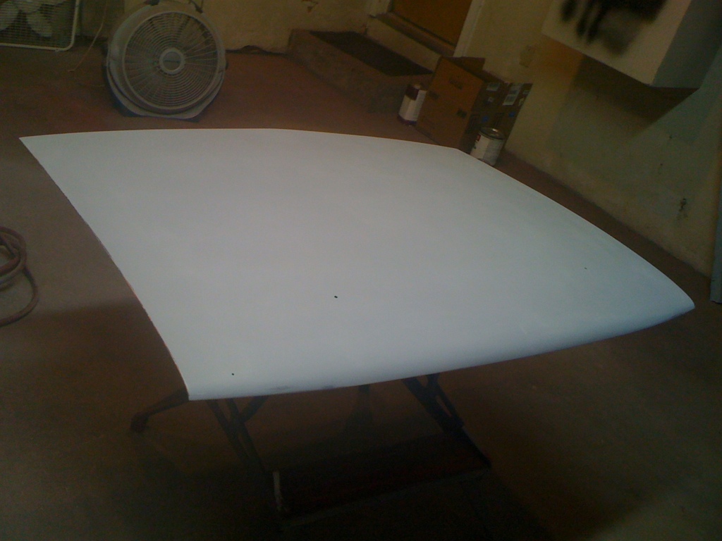

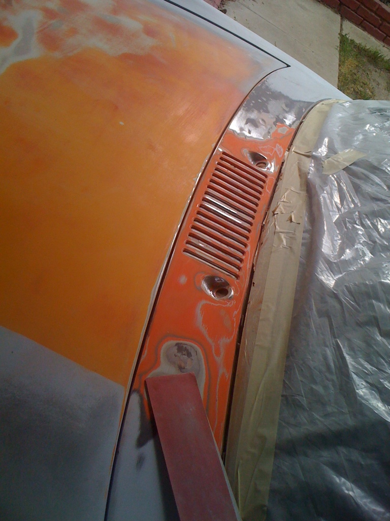

OK so last weekend was a test on my part for painting and setting up the garage for painting. I learned that I need to either do a LOT more prep in the garage to prevent any dirt from getting in the paint and I also need to work on painting vertically as I had more runs than I was comfortable with. I also need to work on gun setup as I think I had to much paint spraying out of the gun, which contributed to the runs.
Today I sanded the targa top in 180 and layed 3 layers of primer on it. I am going to sand it down to 400 and practice spraying vertically on it this weekend.
(IMG:http://www.914world.com/bbs2/uploads_offsite/i1210.photobucket.com-172-1304404009.1.jpg)

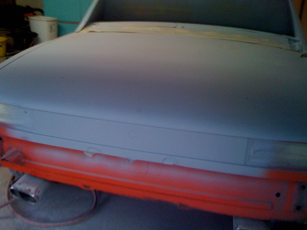

I sanded and sprayed the hood down, but its obvious to me it needs quite a bit of bodywork to be straight. This may take some time. Guide coat went on after.
(IMG:http://www.914world.com/bbs2/uploads_offsite/i1210.photobucket.com-172-1304404010.2.jpg)
(IMG:http://www.914world.com/bbs2/uploads_offsite/i1210.photobucket.com-172-1304404010.3.jpg)
I opened up my paint that I bought and compared it to the factory phoenix red. Almost an exact match, I stared at it for quite a while before I realized that the Hugger Orange was just a TAD more red. Which I am really happy with as I wanted it to be a tad more red!!! I also realized that I have a LOT of paint to spray this tiny car... The crown vic that I sprayed last weekend took 1/3 a gallon on 3 heavy coats. I am probably going to spray 7-10 coats on this car and still only use 1/3 of a gallon!! And this car should be a breeze compared to the big crown vic.

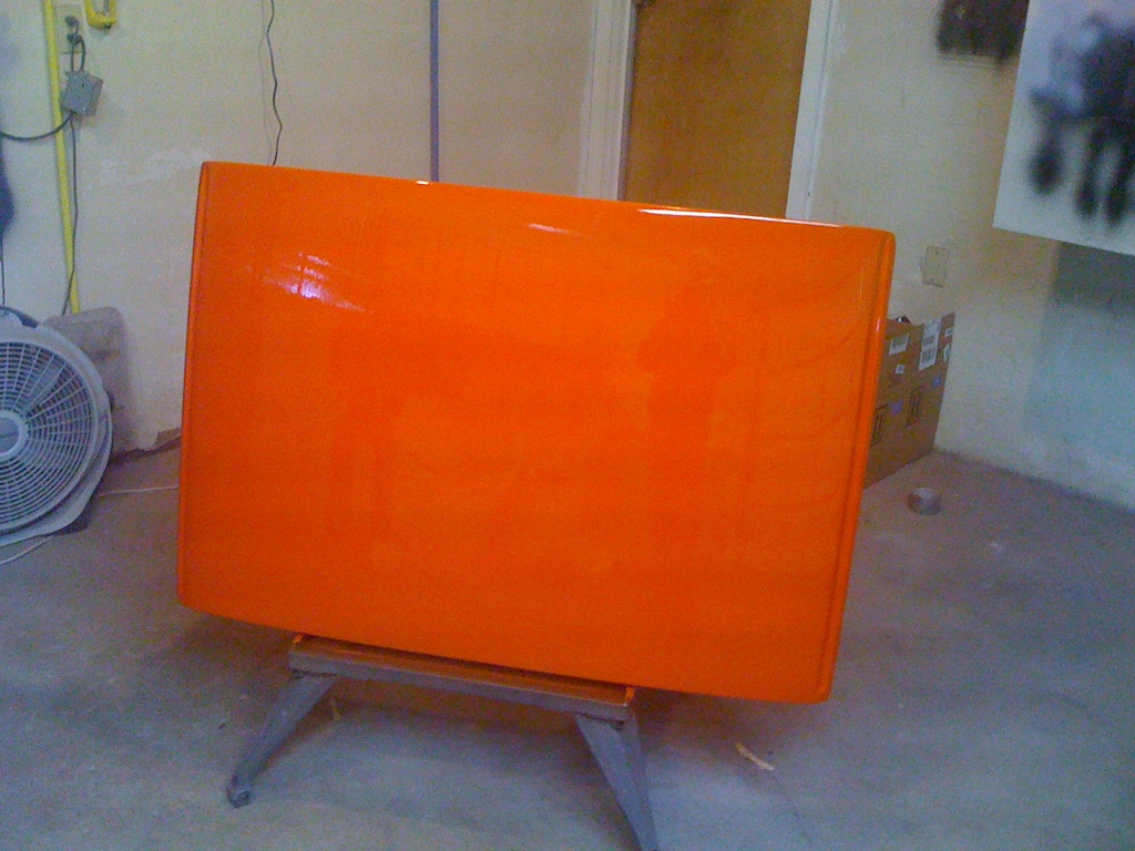

Hey look.

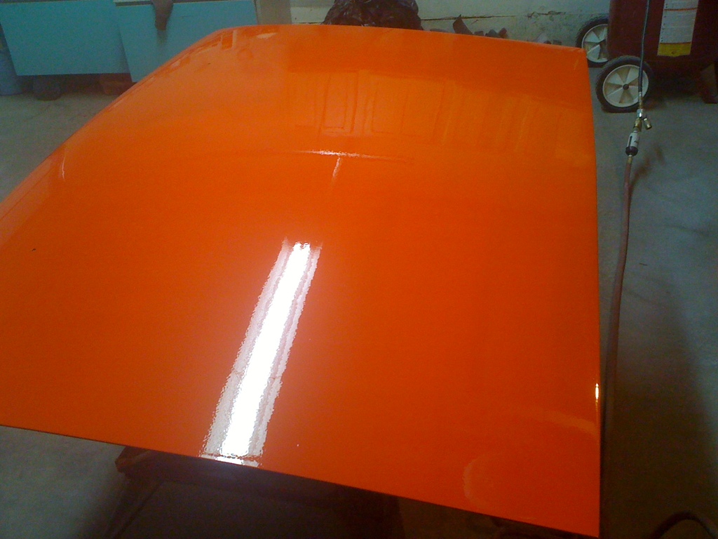

I sprayed some orange!

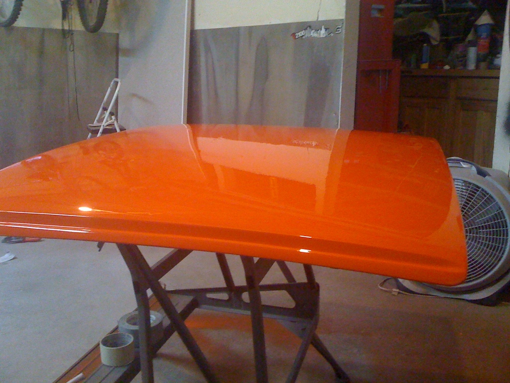

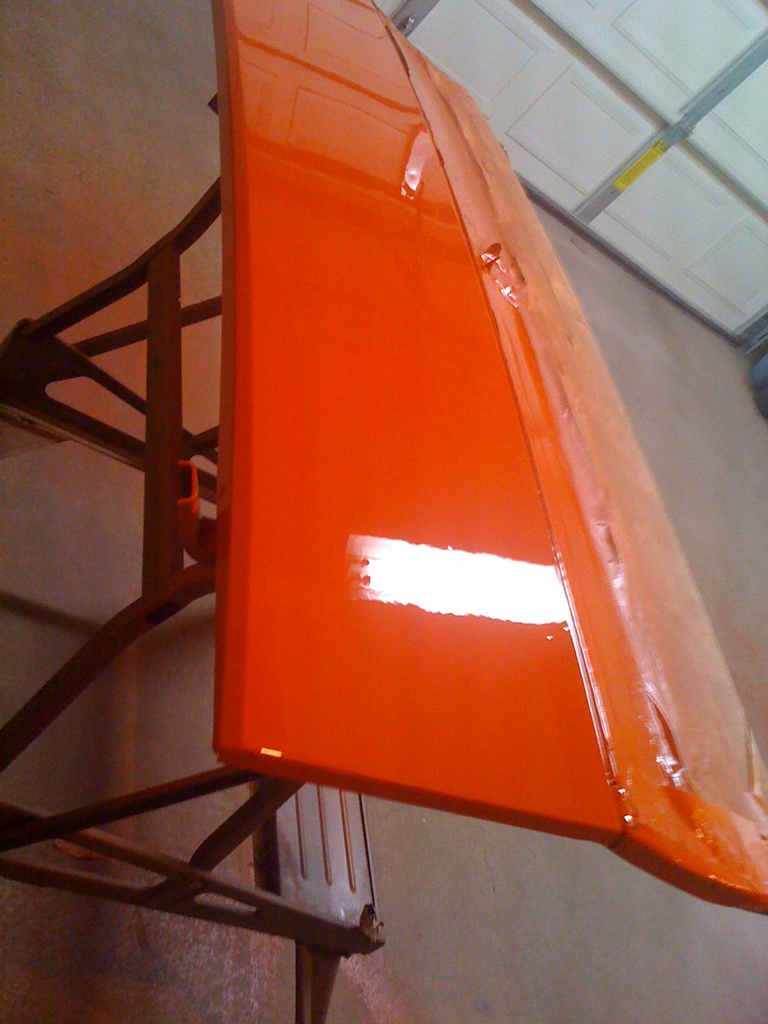

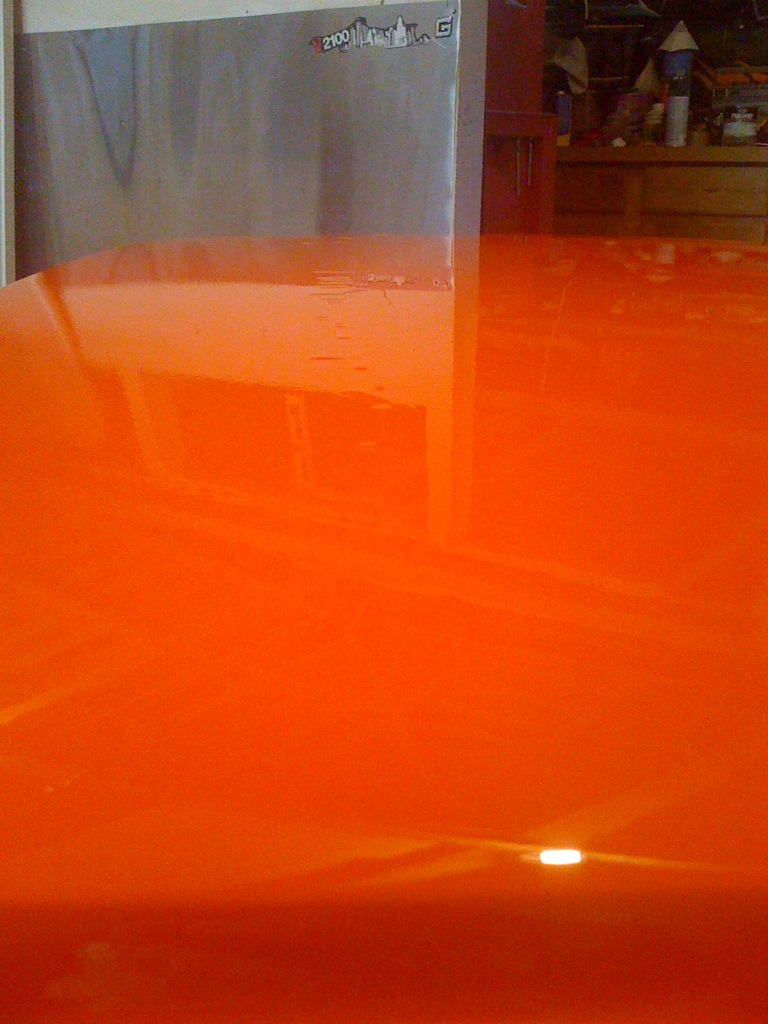

Just as a preface, this was a test run. I had a lot more runs when I sprayed the crown vic last weekend than I wanted. So I went and practiced on the targa top this evening.
I went and sanded the top down to 320 and went ahead and sprayed it after degreasing it.
I spoke with my paint shop next door to my work and he said that he reduces the single stage only 10% even if it calls for 25% on the sheet. I went ahead and reduced it to about 17.5 as I wanted to actually get some practice laying the coats a little thinner so I could improve my technique. I sprayed the top almost completely vertical. First coat went on with no problem and no runs. Second coat I couldnt see very well and obviously overlapped more than I should have and caused runs. I believe I went to slow in the spraying of the paint as well.
Anyways Here are some pics of this gorgeous color! I am really liking this paint from TCPGlobal. Its a bit thin, but it really has a nice shine for 110 bucks a gallon (with reducers and hardners).
(IMG:http://www.914world.com/bbs2/uploads_offsite/i1210.photobucket.com-172-1304574564.1.jpg)
One coat
(IMG:http://www.914world.com/bbs2/uploads_offsite/i1210.photobucket.com-172-1304574564.2.jpg)
Two coats
(IMG:http://www.914world.com/bbs2/uploads_offsite/i1210.photobucket.com-172-1304574632.1.jpg)
(IMG:http://www.914world.com/bbs2/uploads_offsite/i1210.photobucket.com-172-1304574564.4.jpg)

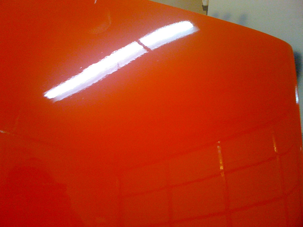

Shot of the runs
I will be sanding this down (I will practice wet sanding and buffing, then i'll sand it down to 400) and respraying it for more practice.
I did not prep the garage at all and so there is a bit of dust, but even worse there are a TON of bugs in the paint.... I did NOT have this issue with the Crown Vic. Granted it is night and I sprayed the crown vic around noon. The bugs came in about an hour after spraying, It didnt help that I let the paint dry horizontally...

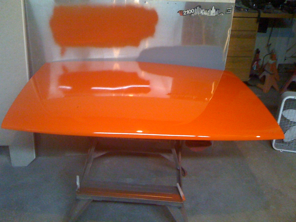

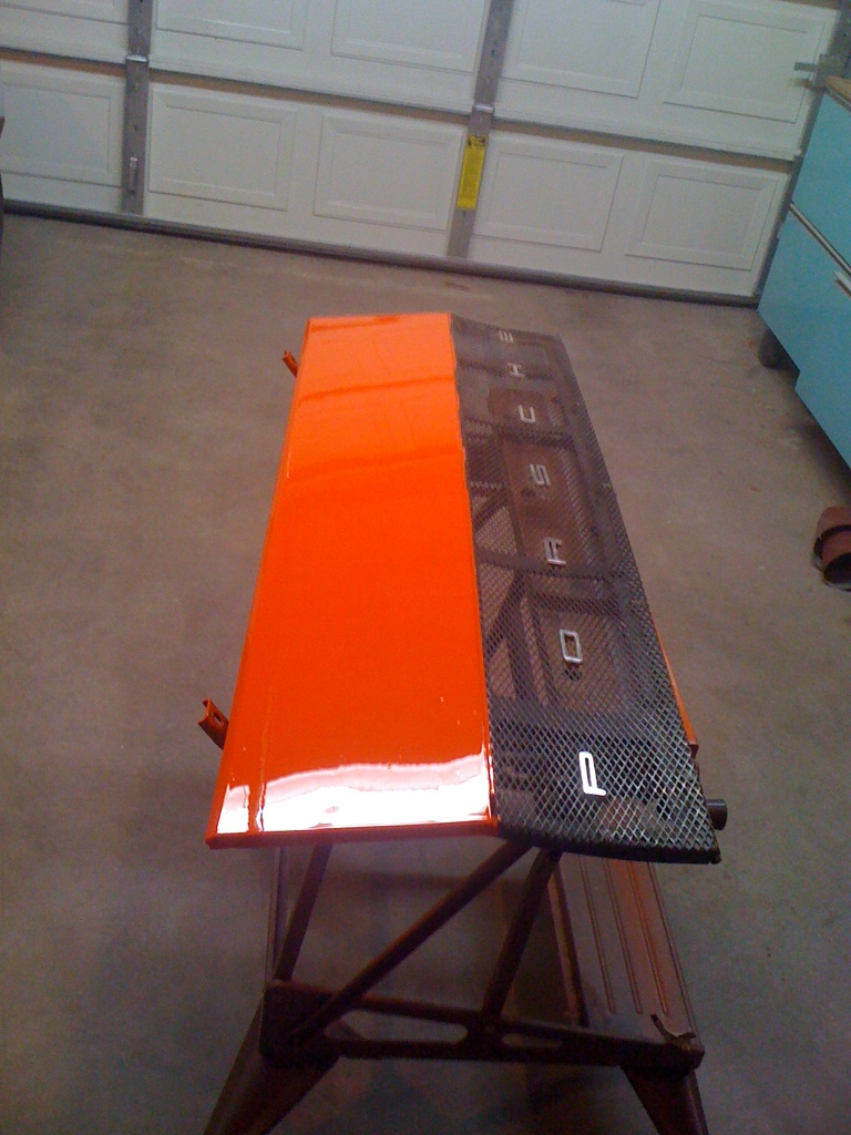

So.. I liked it so much on Wed that I decided to do it again! (IMG:style_emoticons/default/smile.gif)
I tried to do the setup that was told to me by my paint guy.
I sanded down to 220. I then primered it with primer sealer (This was epoxy primer/hardner.. And I reduced it with urethane reducer.. Again I bought the wrong primer...) On a fast reducer. Then 10 mins later I hit it with the first coat. I also only reduced the paint down 10% with medium reducer. I hated it, It was so thick and unworkable. Spray pattern was a lot worse this way as well. I think it layed out very dry. So on the next coats I added more reducer and the last coat I added even more reducer.
Here is another thing I noticed. With the light grey primer, I had full coverage in 2 coats. With the grey epoxy primer underneath, I didnt even get full coverage after 4 coats.
One thing I did notice is that most of the scratches were hidden. I think I thinned the epoxy primer to much so I didnt have the hide that I really could have had, but regardless. It was certainly a learning curve.
Less bugs this time as well, I shut the back door this time (IMG:style_emoticons/default/smile.gif)
