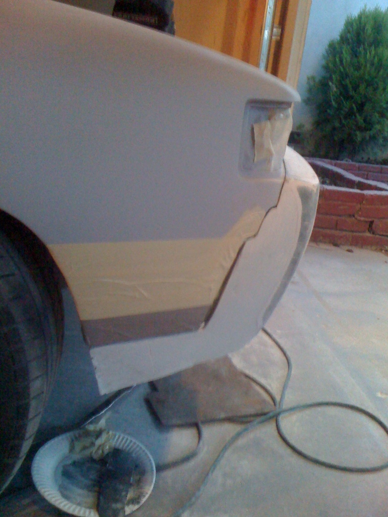

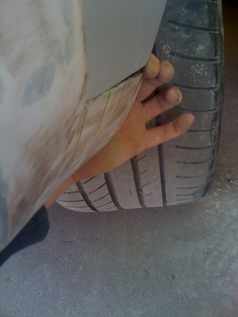

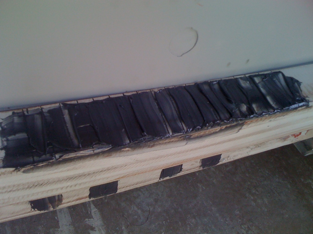

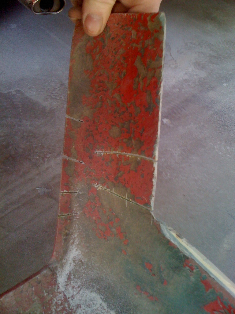

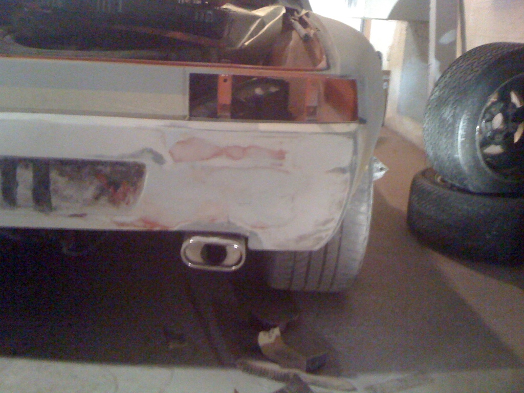

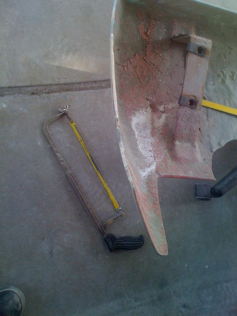

Dad came over and helped me quite a bit yesterday.
We were able to make the majority of the changes to the rear bumper. Cut slots in the top in order to curve the bumper more properly, cut relief slots in the license plate area as well. Spent about 2 hrs trimming the side to match the body somewhat, Still need to add some material (maybe...). I also need to mess with the piece below the flare to match the lines. I think i'll do that some today.
(IMG:http://www.914world.com/bbs2/uploads_offsite/i1210.photobucket.com-172-1304867537.1.jpg)
(IMG:http://www.914world.com/bbs2/uploads_offsite/i1210.photobucket.com-172-1304867537.2.jpg)
(IMG:http://www.914world.com/bbs2/uploads_offsite/i1210.photobucket.com-172-1304867537.3.jpg)
(IMG:http://www.914world.com/bbs2/uploads_offsite/i1210.photobucket.com-172-1304867538.4.jpg)

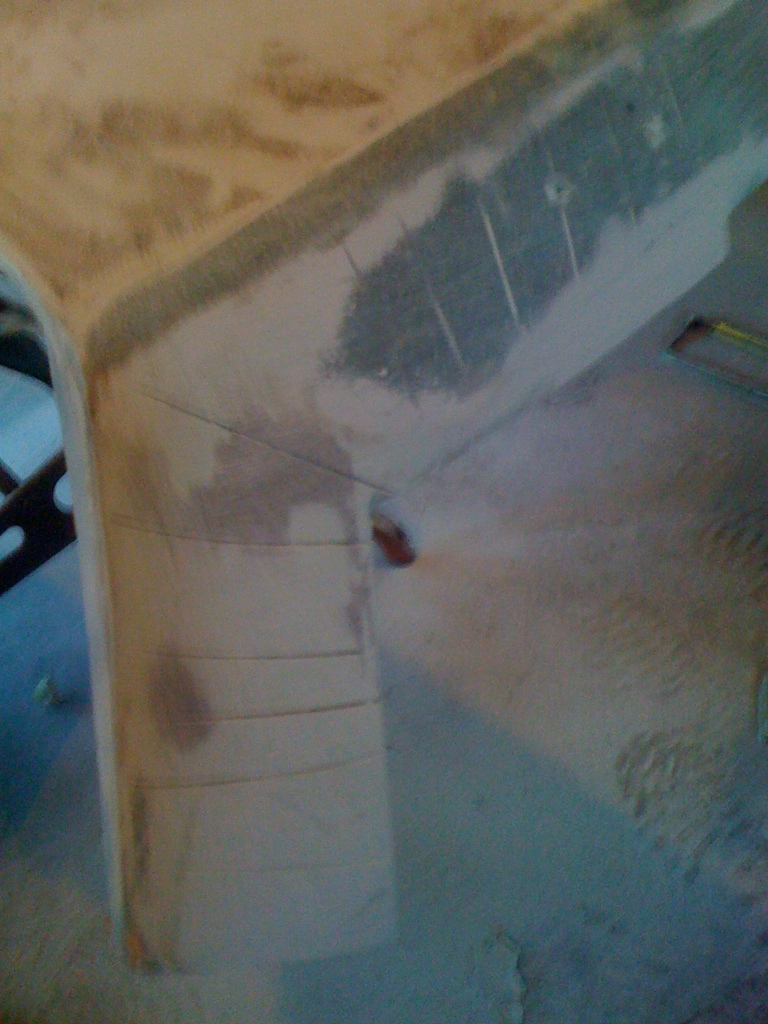

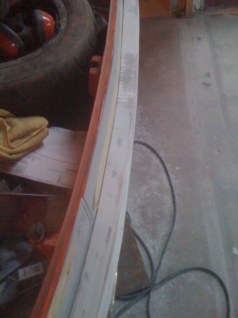

Sanded down the front bumper past 2 layers of paint and started getting it ready for filler.
(IMG:http://www.914world.com/bbs2/uploads_offsite/i1210.photobucket.com-172-1304867538.5.jpg)

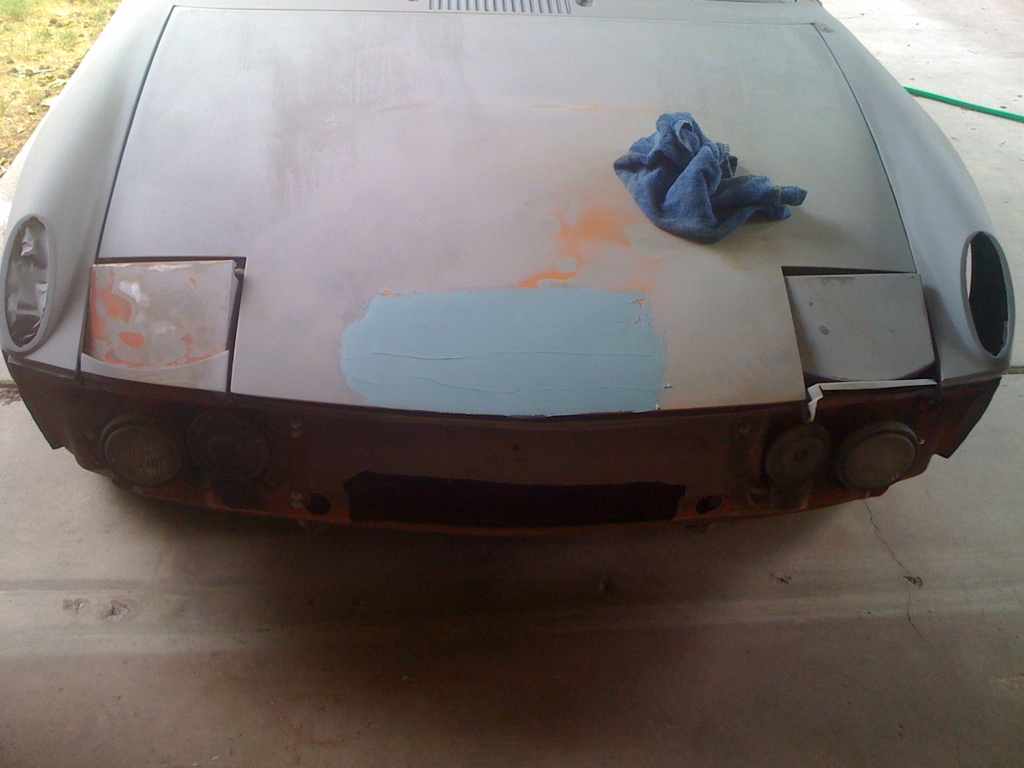

Sanded the front trunk down and noticed that the area where the crest is was dented pretty bad. Hammered it up, and layed 1/4" of bondo and sanded it down, probably max 1/8" now. Layed some of the epoxy primer down. You can see now why I had such a hard time going over the epoxy with paint, it is SO much darker than the polyester primer.
(IMG:http://www.914world.com/bbs2/uploads_offsite/i1210.photobucket.com-172-1304867538.6.jpg)
(IMG:http://www.914world.com/bbs2/uploads_offsite/i1210.photobucket.com-172-1304867539.7.jpg)

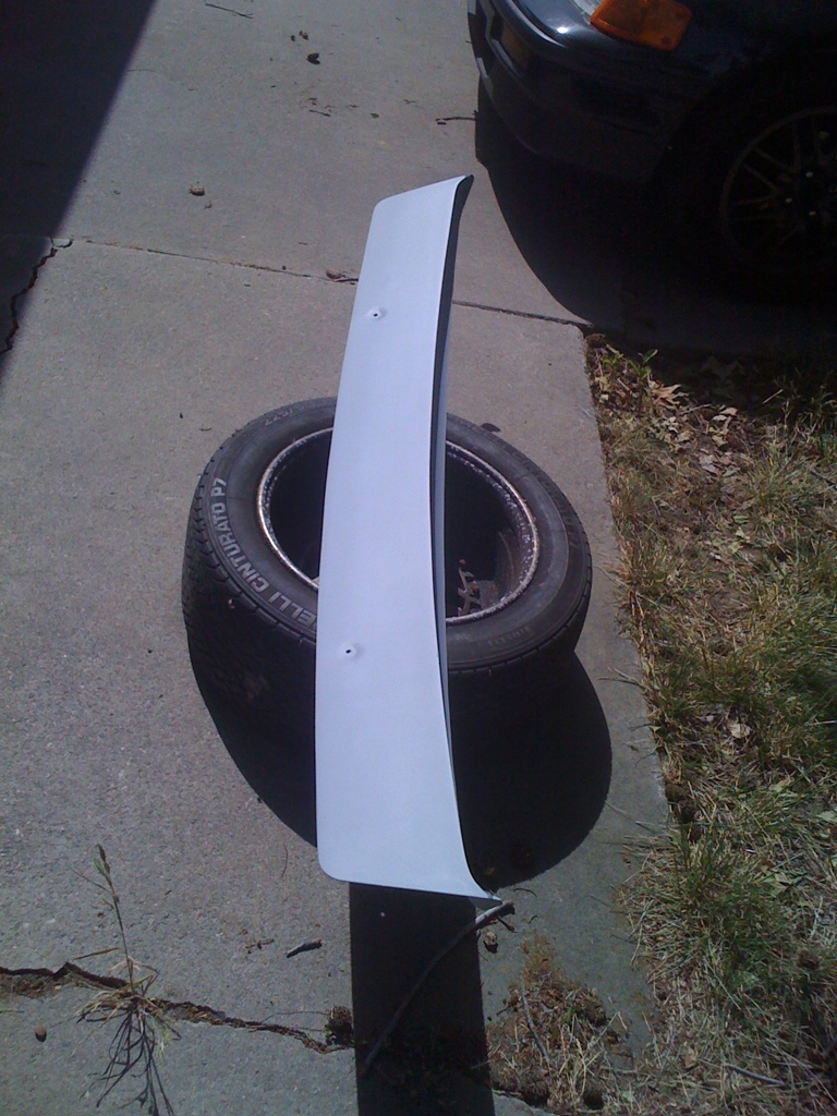

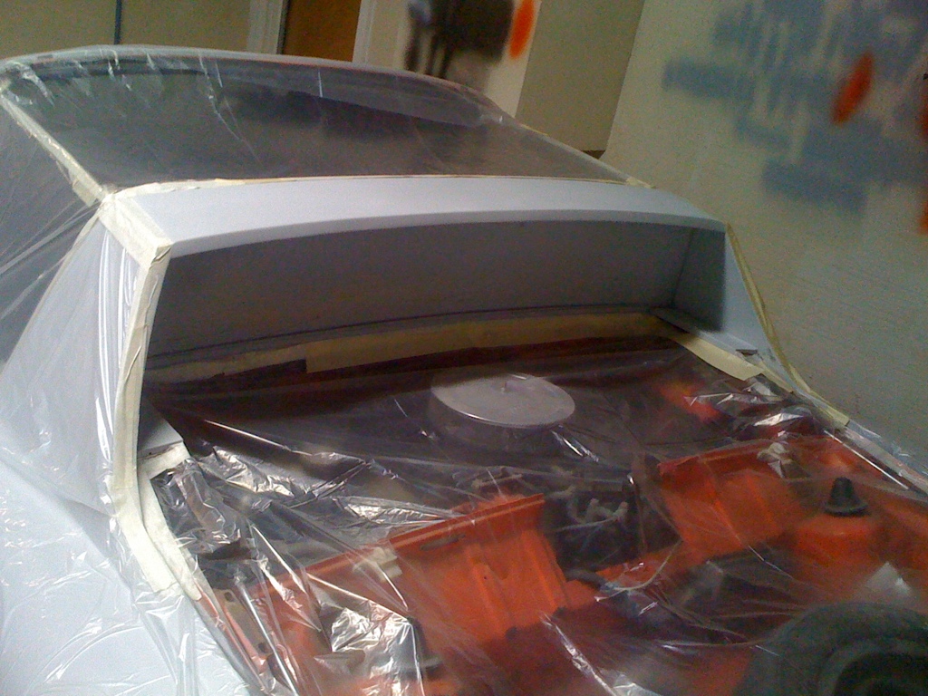

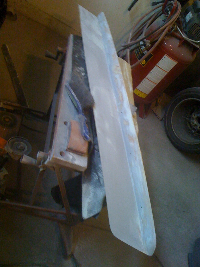

Also primered the front of the rear spoiler.
(IMG:http://www.914world.com/bbs2/uploads_offsite/i1210.photobucket.com-172-1304867539.8.jpg)
The front trunk and spoiler will be guide sanded down then primed over with grey primer, then sanded and painted.
I have set a DD for paint on the body for NEXT SUNDAY.
I have a lot to do in that time, but If its not then, its next month.. And I cant wait that long.

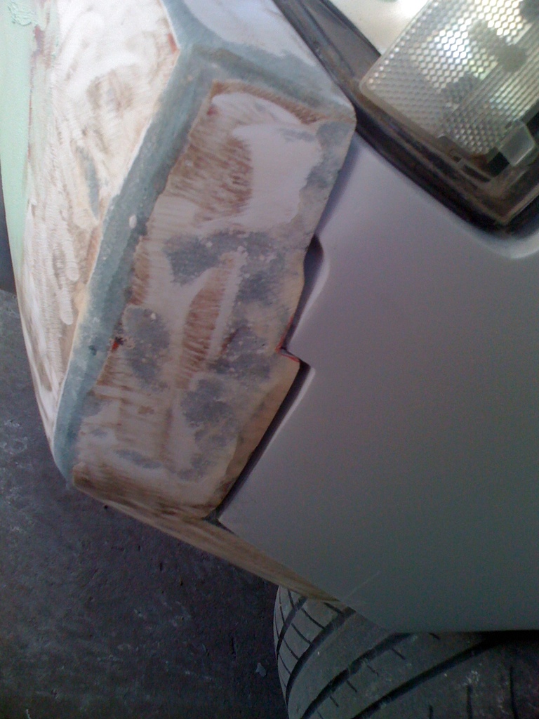

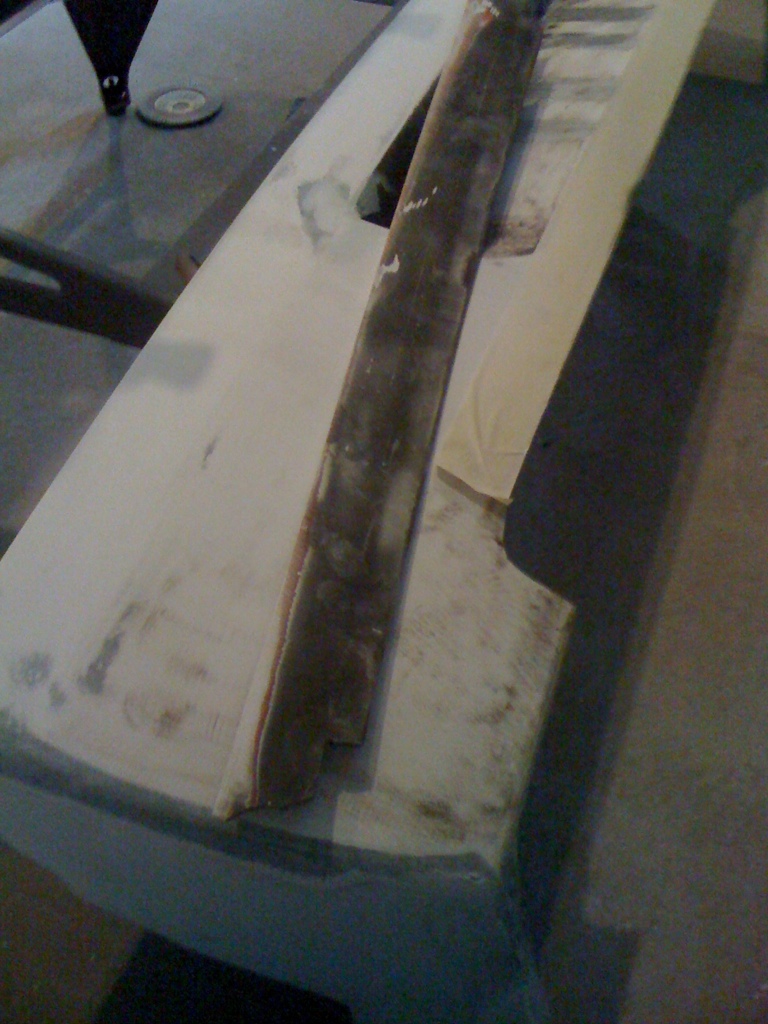

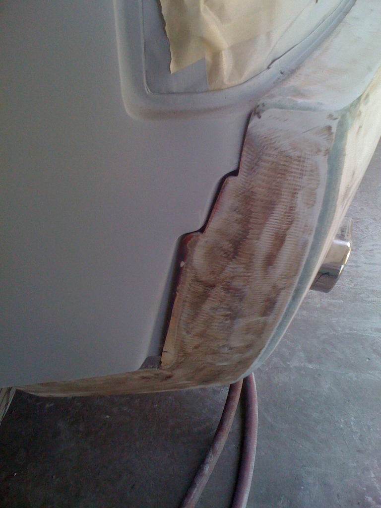

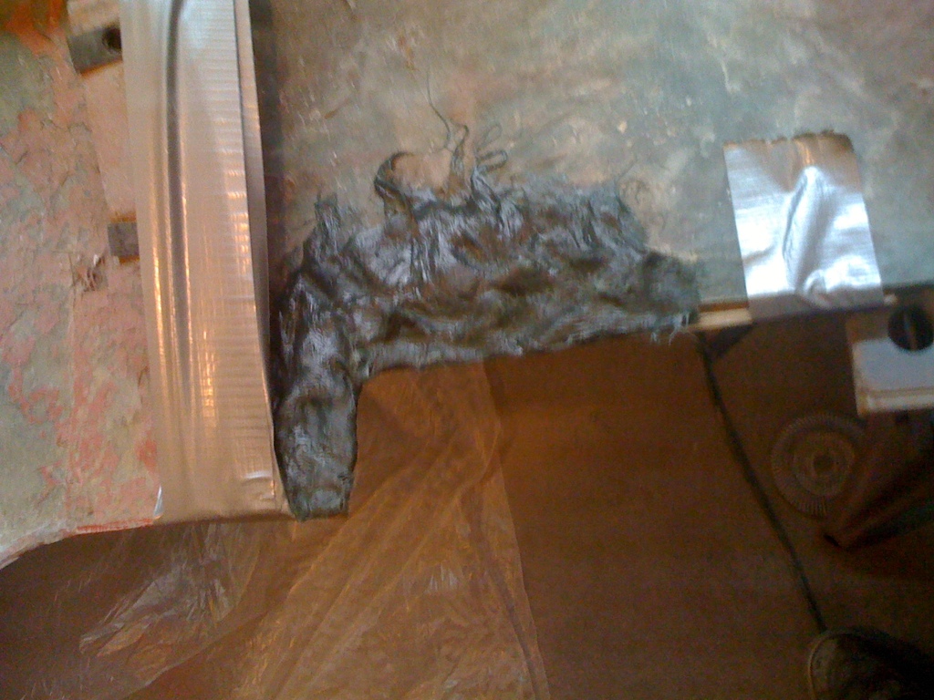

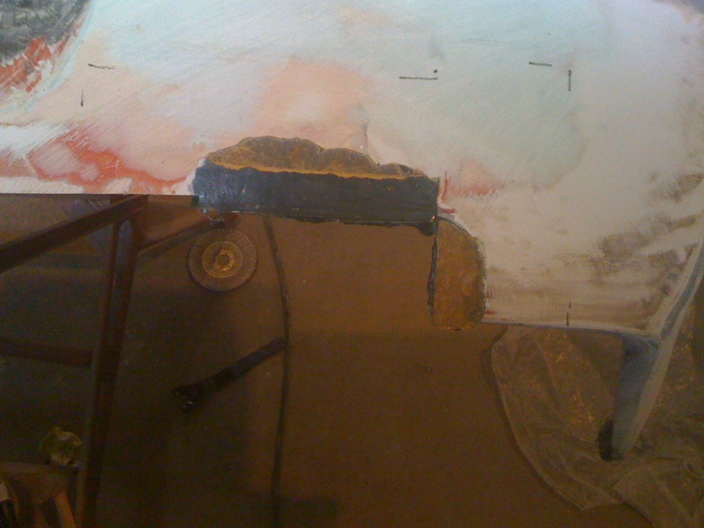

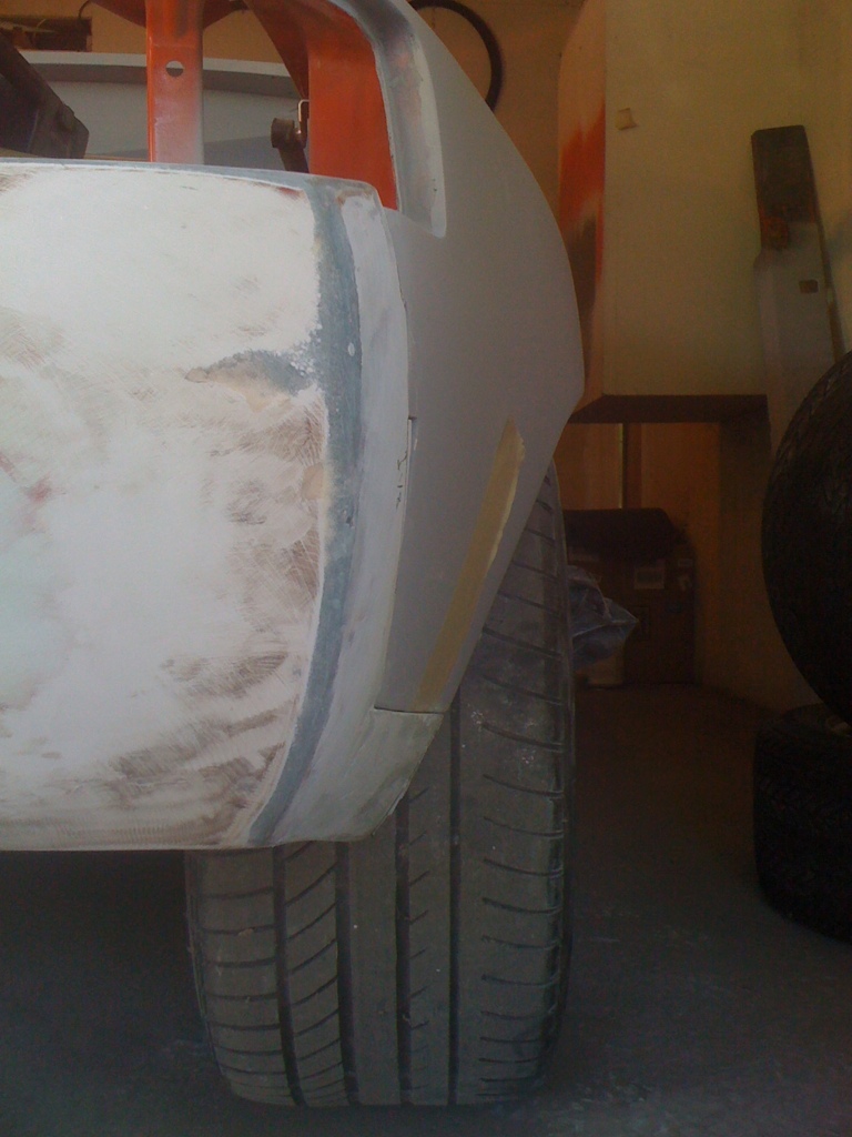

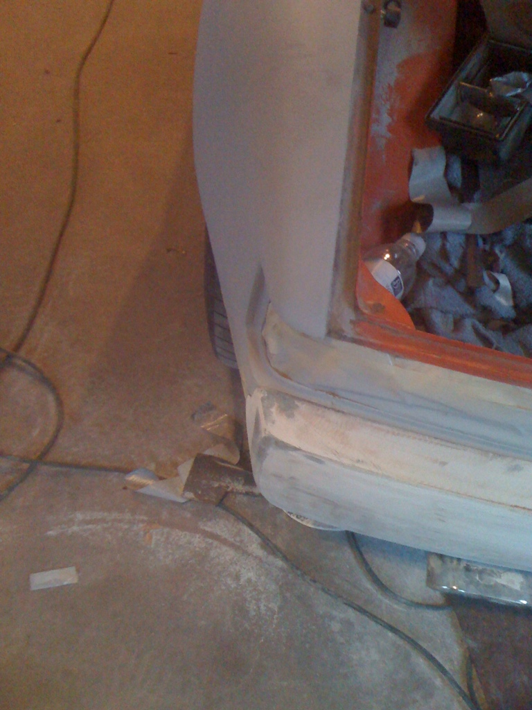

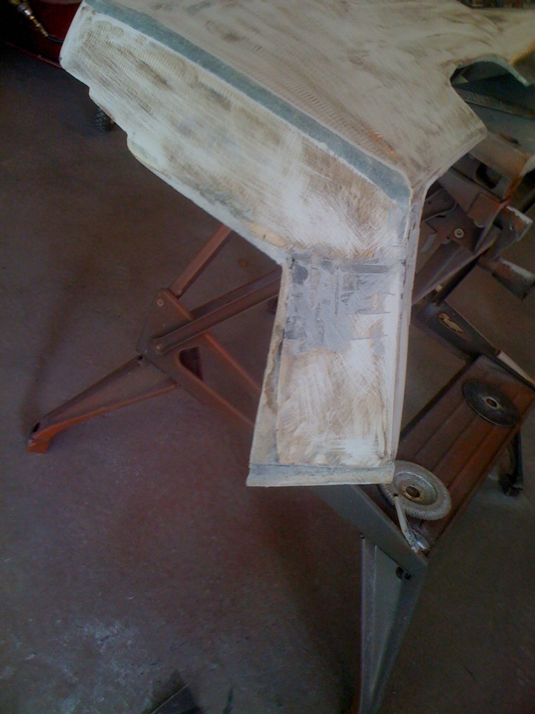

10 hrs on the bumper today.. Still not done. but it looks goooooooood
Pictures tell the story.
(IMG:http://www.914world.com/bbs2/uploads_offsite/i1210.photobucket.com-172-1304922916.1.jpg)
(IMG:http://www.914world.com/bbs2/uploads_offsite/i1210.photobucket.com-172-1304922917.2.jpg)
(IMG:http://www.914world.com/bbs2/uploads_offsite/i1210.photobucket.com-172-1304922918.3.jpg)
(IMG:http://www.914world.com/bbs2/uploads_offsite/i1210.photobucket.com-172-1304922918.4.jpg)
(IMG:http://www.914world.com/bbs2/uploads_offsite/i1210.photobucket.com-172-1304922919.5.jpg)
(IMG:http://www.914world.com/bbs2/uploads_offsite/i1210.photobucket.com-172-1304922919.6.jpg)
(IMG:http://www.914world.com/bbs2/uploads_offsite/i1210.photobucket.com-172-1304922920.7.jpg)

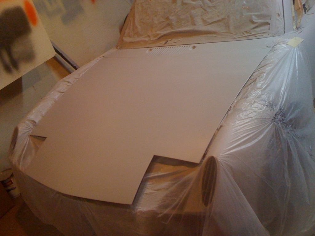

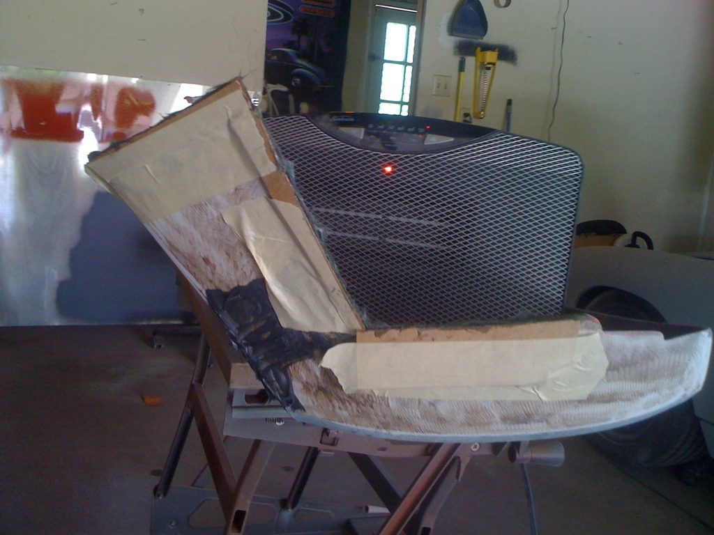

Used cardboard taped to te bumper to make my outline for what I need to add to the bumper. Used kitty hair on top of raw fiberglass
(IMG:http://www.914world.com/bbs2/uploads_offsite/i1210.photobucket.com-172-1304922920.8.jpg)
Let it dry, sand, multiple layers, ect.
(IMG:http://www.914world.com/bbs2/uploads_offsite/i1210.photobucket.com-172-1304922921.9.jpg)

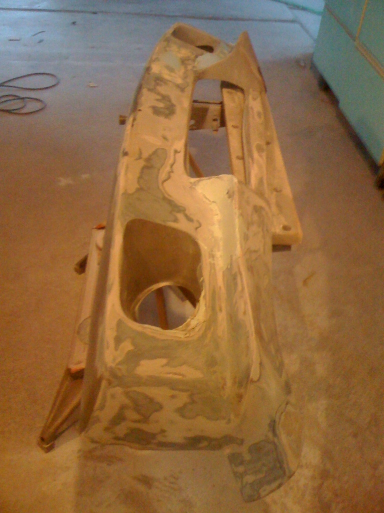

Result from that. Then added multiple layers of bondo to get it just shaped right, used a hacksaw blade to determine where I needed to sand down to get it lined with the body. This is what took all thetime.
(IMG:http://www.914world.com/bbs2/uploads_offsite/i1210.photobucket.com-172-1304922921.10.jpg)
(IMG:http://www.914world.com/bbs2/uploads_offsite/i1210.photobucket.com-172-1304922922.11.jpg)
(IMG:http://www.914world.com/bbs2/uploads_offsite/i1210.photobucket.com-172-1304922923.12.jpg)
As you can see a lot of the sanding was in te raw fiberglass (Still not done.. ) to try and get the lines better a bit.
(IMG:http://www.914world.com/bbs2/uploads_offsite/i1210.photobucket.com-172-1304922923.13.jpg)

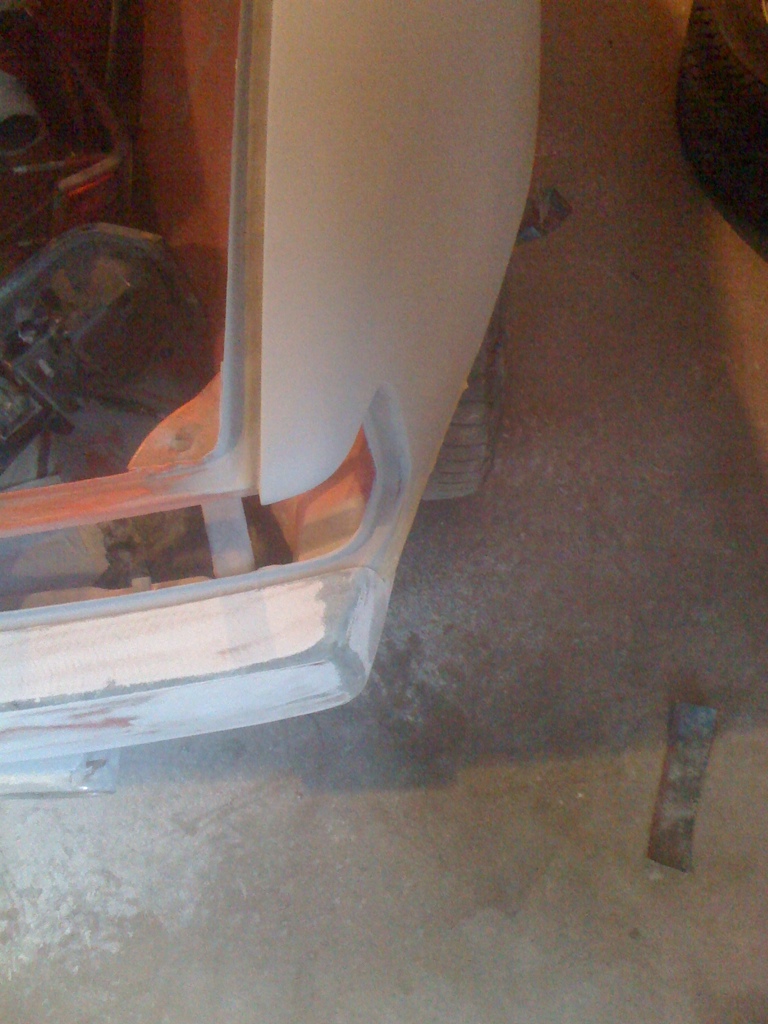

Trimmed this to fit, looks good up top.
(IMG:http://www.914world.com/bbs2/uploads_offsite/i1210.photobucket.com-172-1304922924.14.jpg)
(IMG:http://www.914world.com/bbs2/uploads_offsite/i1210.photobucket.com-172-1304922924.15.jpg)
(IMG:http://www.914world.com/bbs2/uploads_offsite/i1210.photobucket.com-172-1304922925.16.jpg)
(IMG:http://www.914world.com/bbs2/uploads_offsite/i1210.photobucket.com-172-1304923113.1.jpg)
Where it sits now. Looks so damn good.
Got some work done on the front bumper as well.
(IMG:http://www.914world.com/bbs2/uploads_offsite/i1210.photobucket.com-172-1304922925.17.jpg)
Not pictured. Sanded down the front trunk and primed it in 2 layers of light grey primer. Its nice and straight and ready for final sanding and paint.
I have a lot to do to prep for Sunday.. And I dont even have friday or saturday to work...

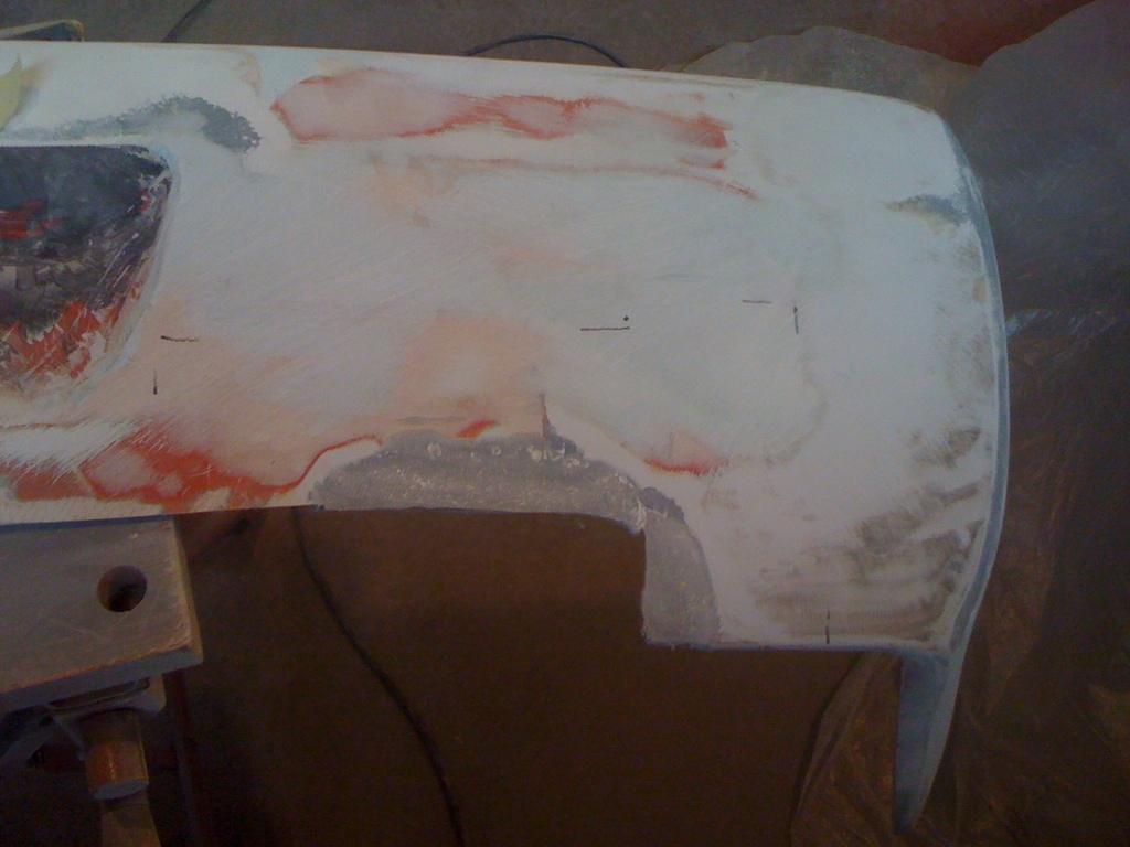

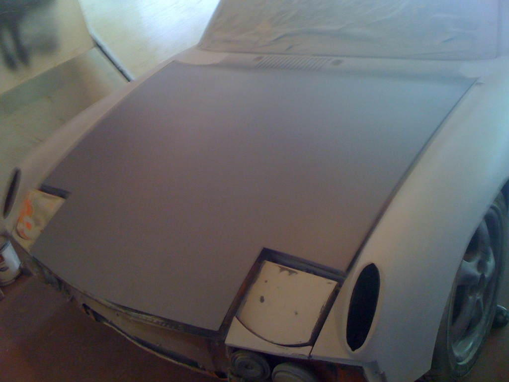

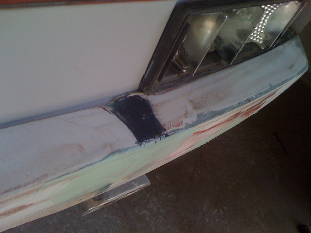

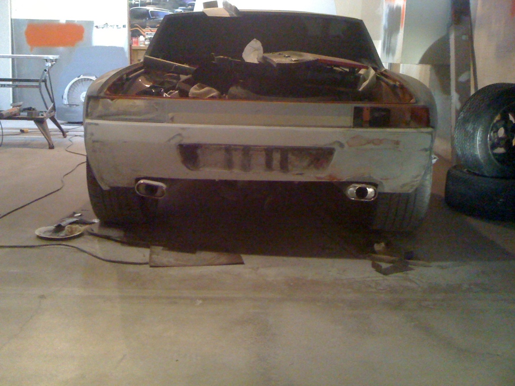

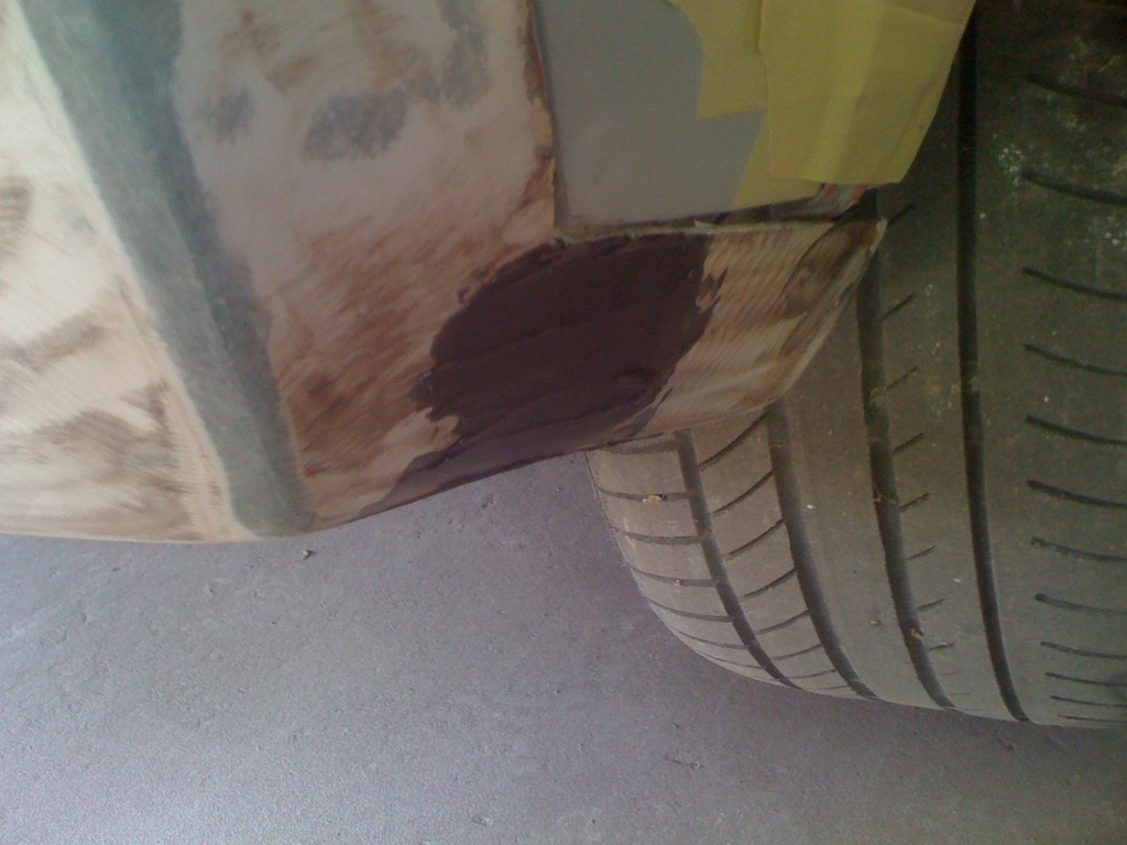

And I got 3 hours in tonight.
Heres a pic from last night. Hood.
(IMG:http://www.914world.com/bbs2/uploads_offsite/i1210.photobucket.com-172-1305008048.1.jpg)
Focused on the bumper.
(IMG:http://www.914world.com/bbs2/uploads_offsite/i1210.photobucket.com-172-1305008049.2.jpg)

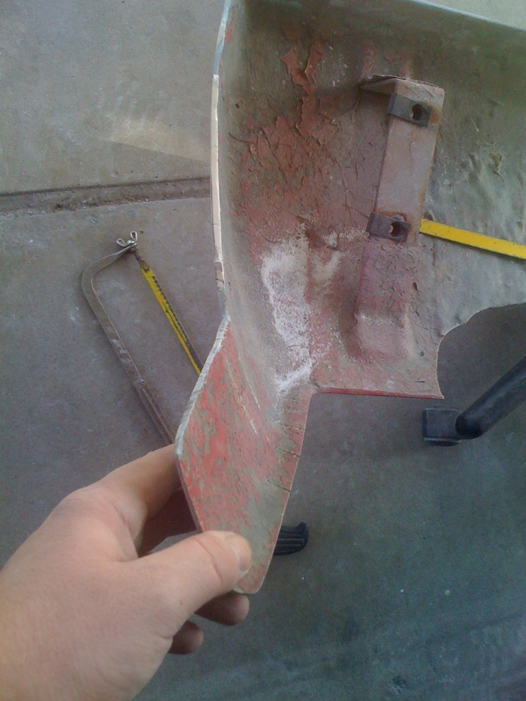

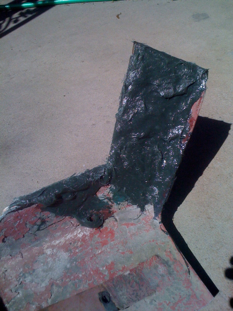

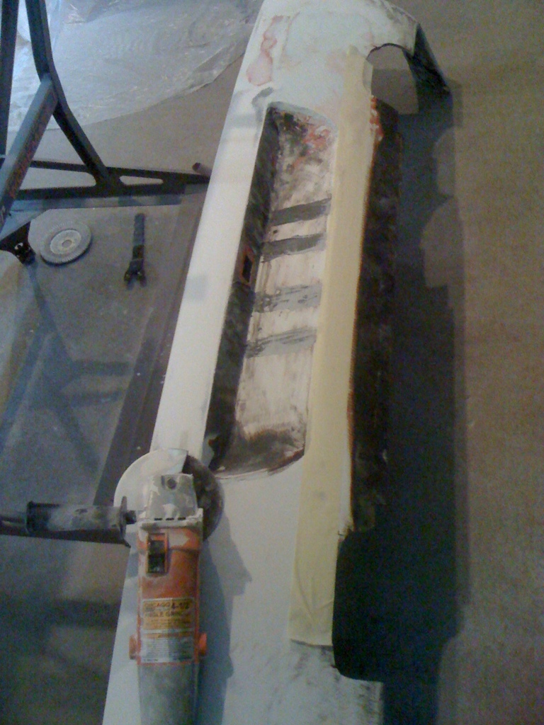

You can barely see the black area that im cutting off. Cutting this off for 1: design and 2. airflow. Thats a serious amount of lift on the rear end at over 100mph... I have plans for an underbody tray, I might do it someday..
(IMG:http://www.914world.com/bbs2/uploads_offsite/i1210.photobucket.com-172-1305008049.3.jpg)
The piece cut off.
(IMG:http://www.914world.com/bbs2/uploads_offsite/i1210.photobucket.com-172-1305008049.4.jpg)
(IMG:http://www.914world.com/bbs2/uploads_offsite/i1210.photobucket.com-172-1305008050.5.jpg)
(IMG:http://www.914world.com/bbs2/uploads_offsite/i1210.photobucket.com-172-1305008050.6.jpg)
Good old kitty hair. Works really well for these kind of things (I HATE working with fiberglass and resin...). Ground flat with bumper with grinder..
(IMG:http://www.914world.com/bbs2/uploads_offsite/i1210.photobucket.com-172-1305008050.7.jpg)
(IMG:http://www.914world.com/bbs2/uploads_offsite/i1210.photobucket.com-172-1305008050.8.jpg)
(IMG:http://www.914world.com/bbs2/uploads_offsite/i1210.photobucket.com-172-1305008051.9.jpg)

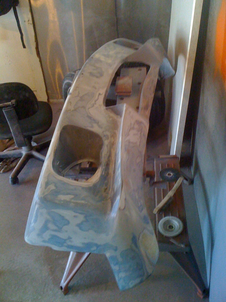

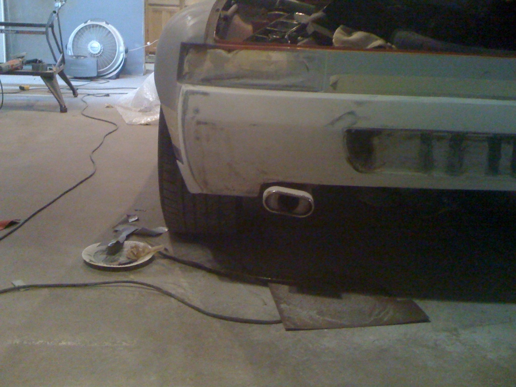

A bit of trimming done. Still a little more to do. Ignore the exhaust tips, they will get straightened later.
(IMG:http://www.914world.com/bbs2/uploads_offsite/i1210.photobucket.com-172-1305008051.10.jpg)

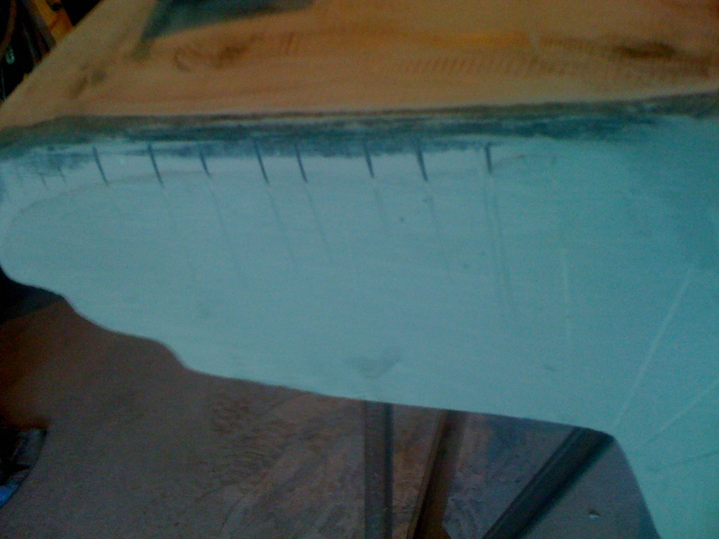

Filled pinholes and a couple of chips in the fiberglass. Sanded down (arg, I hate sanding..)
Thats all for tonight.. This stuff just takes to much time. Bumpers will not be sprayed with the body but I am OK with that. I can spray them any time.
Looking for 3 hours tomorrow... Tomorrow im going to start on sanding the body down to the 400 grit I need to paint over. Same on Wed. Thursday I start cleaning the garage for painting on Sunday as I dont have any time to work on anything on Friday and Saturday.

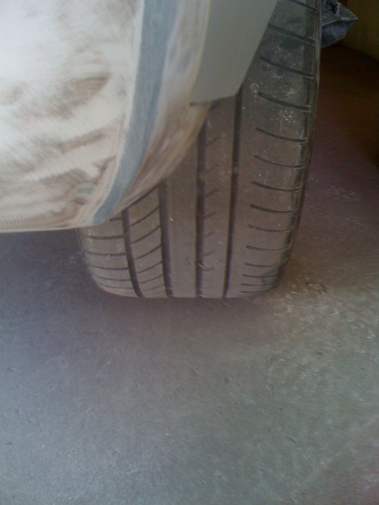

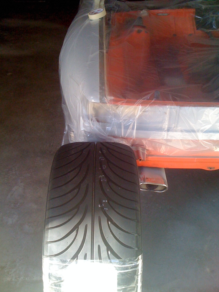

Ordered some tires for the rear. 285 35 18's. (Fronts have 1k miles on them, but are 5 years old, rears are goooooone)
Received the seals from 914rubber.com
Sanded down the drivers side last night as well. It hit me that I have to paint under the targa bar prior to painting the rest of the car.. Soooo Im going to try and enlist some help tonight to get the car sanded quick enough to paint under the targa bar tonight..
Ahhh, I havent spent this kind of money in a while... Glad I have some 914 parts to sell to fund it!

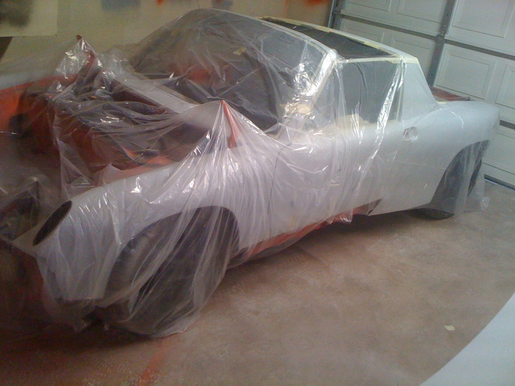

Its either now or after paint on the rest of the car and I figure I'd rather do it now than later as it can sit for 3 days drying then I can properly mask over the paint..
Oh and I found out that dollar tree has 10'x12' (Thin..) painters plastic tarps. They worked well painting the hood, I'll pick up 5 or so for these little spot jobs. Probably use 3 to cover the car for this...

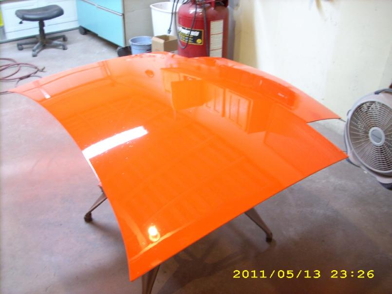

So apparently Tire Rack delivers within 24 hours of placing an order...
Pictures at 11. (IMG:style_emoticons/default/tongue.gif)

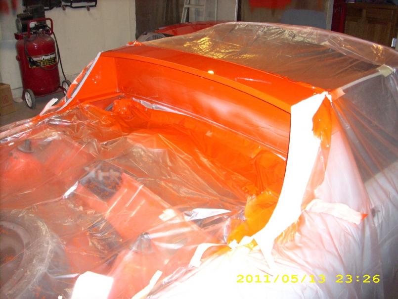

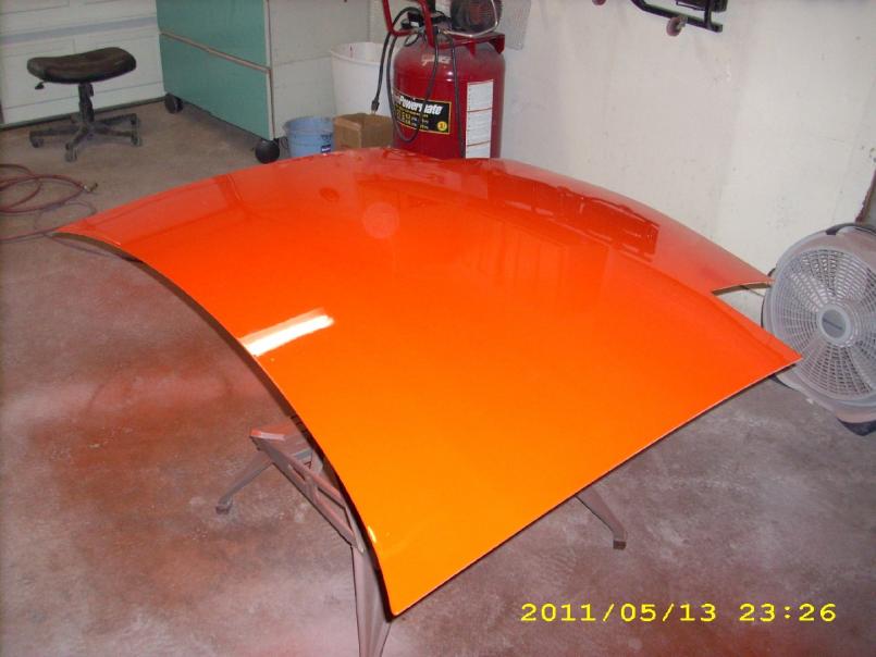

(IMG:http://www.914world.com/bbs2/uploads_offsite/i1210.photobucket.com-172-1305414591.1.jpg)
(IMG:http://www.914world.com/bbs2/uploads_offsite/i1210.photobucket.com-172-1305414592.2.jpg)
(IMG:http://www.914world.com/bbs2/uploads_offsite/i1210.photobucket.com-172-1305414593.3.jpg)
