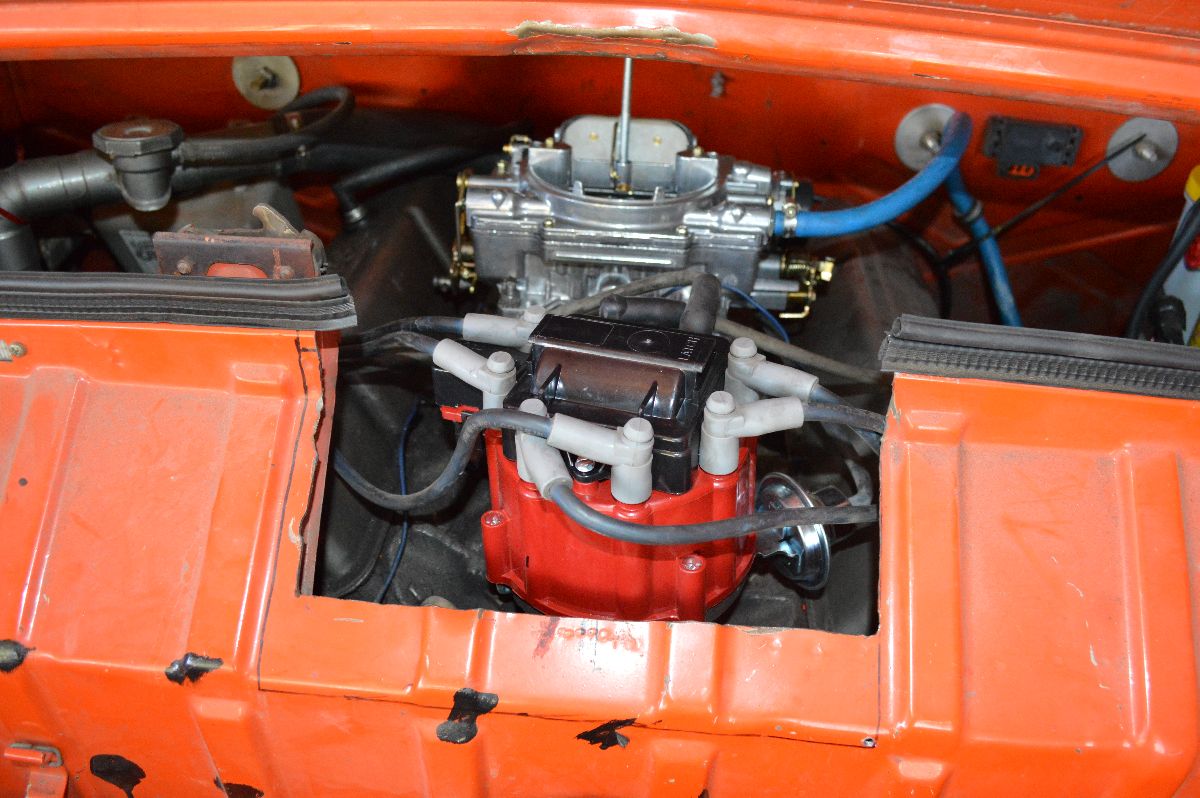

So over the past couple weeks I've done a couple of little things.
1.Replaced the starter with a new High torque one from ebay, Side note, the spacer is required..
2. Replaced all the HEI bits in the distributor with a Proform Tune up kit
3. Replaced the Holley 600 with a factory rebuilt Edelbrock performer 600 model 9906
4. Replaced fuel pump and fuel filters

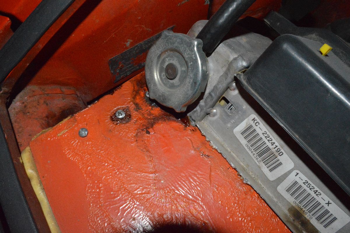

1.Fix leak in radiator (Top fill is leaking. should be an easy welded fix).

At this point out of the box the edelbrock carb has much more torque than the old holley and probably way more power. I havent given it more than 75% as the throttle linkage needs a hair more work and I was just "babying it" around the neighborhood. Couple dounuts, burnouts, drifts later I concluded that it very much likes to spin the rear tires without a seconds thought.

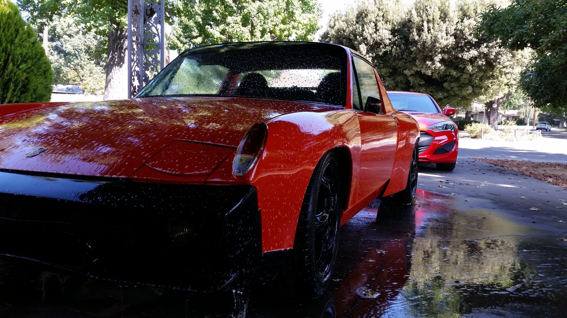

Been letting the 914 sit in the garage. I'll be picking it up this winter to do some more work on it.
I washed it yesterday for the first time this year I think. (IMG:style_emoticons/default/sad.gif)
Took it around the block but was stopped short when I noticed the front end was clunking. The front wheel has slop it in so I checked the bearing and retightened it but it was fine. So My thoughts are either steering rack or maybe torsion bar(Bar feels sloppy).
So we'll pick this up later.

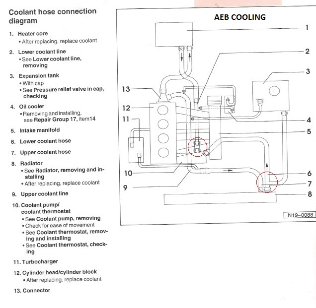

I was questioned about radiator hose routing for constant air purging and I think now would be a great time to explain that in a diagram.
This does a really good job of explaining the system and whats what. It would be easy to remove either the turbo or the heater core from this system.
In my new setup with the 1.8T engine I will be utilizing this almost 100% and modifying it to fit the mid engine layout. This means I will probably pull the heater line from the hot side vs going off the block to prevent from running multiple lines under/through the car.
Mike Bellis
post Apr 15 2015, 02:11 PM
Post #315
Resident Electrician
Posts: 8,348
Joined: 22-June 09
From: Midlothian TX
Member No.: 10,496
I have removed #4 and run a sandwich plate to a mocal thermostat on the way to my setrab oil cooler. I still have everything else in some fashion.

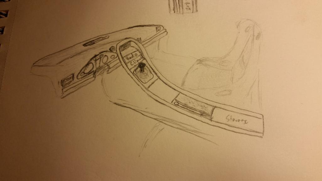

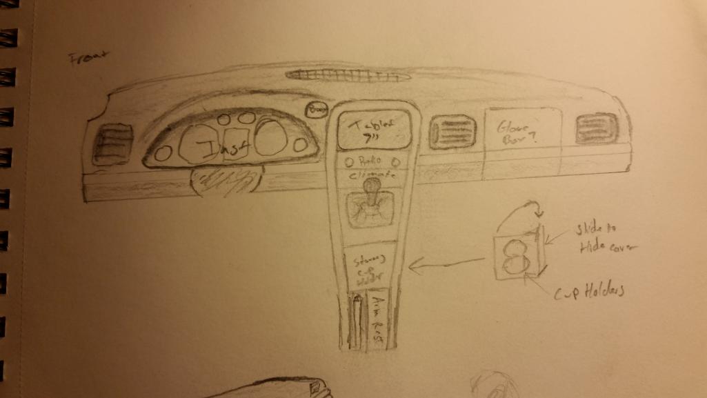

Working on some sketches for the concept dash/interior durring my commute (IMG:style_emoticons/default/smile.gif)

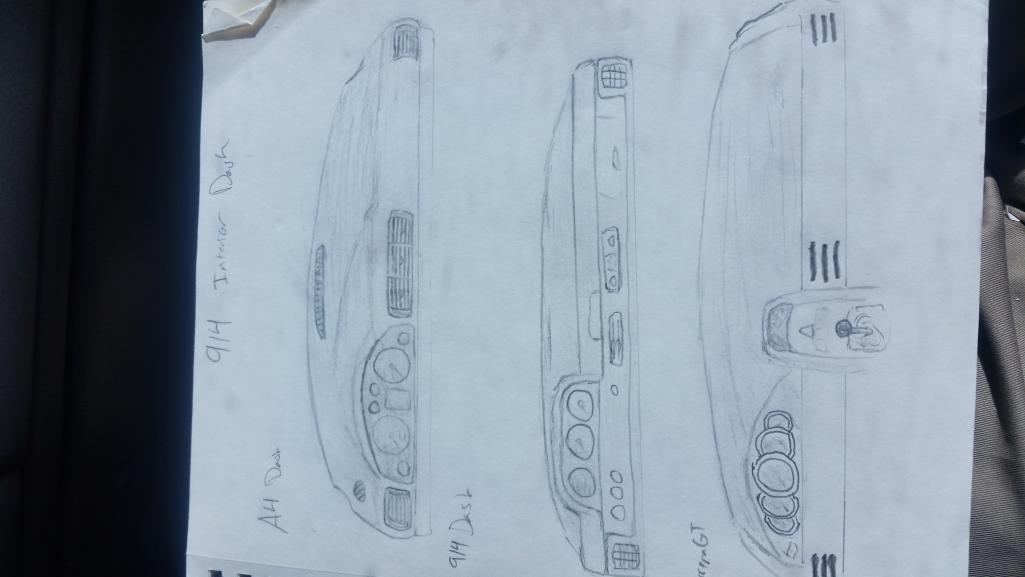

Finished up my dash /interior concept.
Gotta figure out if I want to remake the door panels as well, but most likely (IMG:style_emoticons/default/smile.gif)

Pt 2

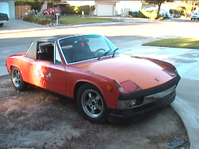

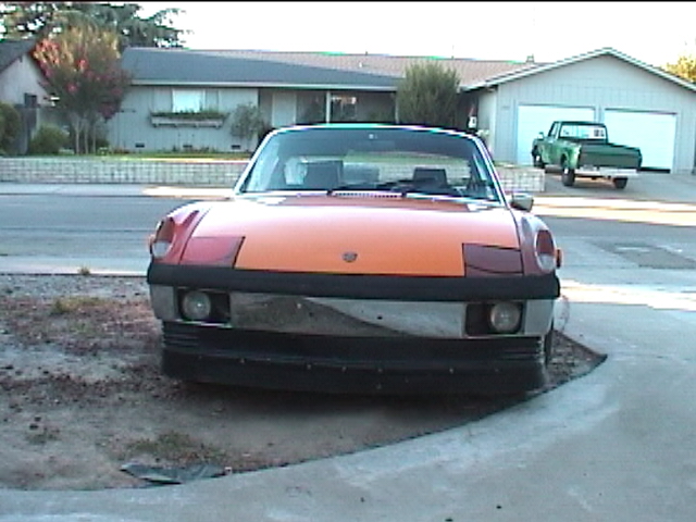

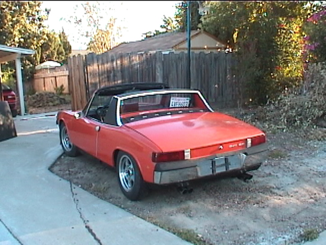

Found some old pics of the car (IMG:style_emoticons/default/smile.gif) This was from my first day getting it home and cleaning it
