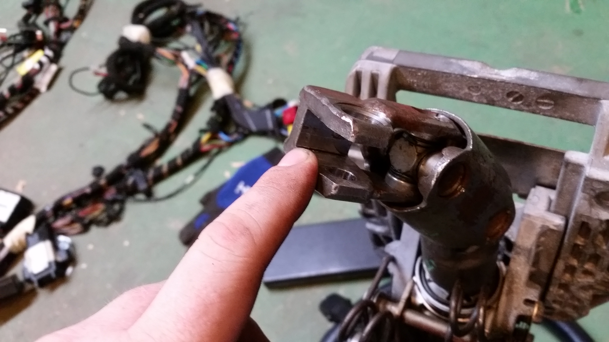

Interior is stripped, and I finally threw some galvanized paint on my longitudinal reinforcements since they were bare.
Next big thing to figure out on the interior is the steering column. It looks like I need to cut the dash up to mount the column. Then I need to find some way of adapting the column to the 914 shaft.
In the mean time I have been acquiring quite the parts collection.
Steering column and wheel

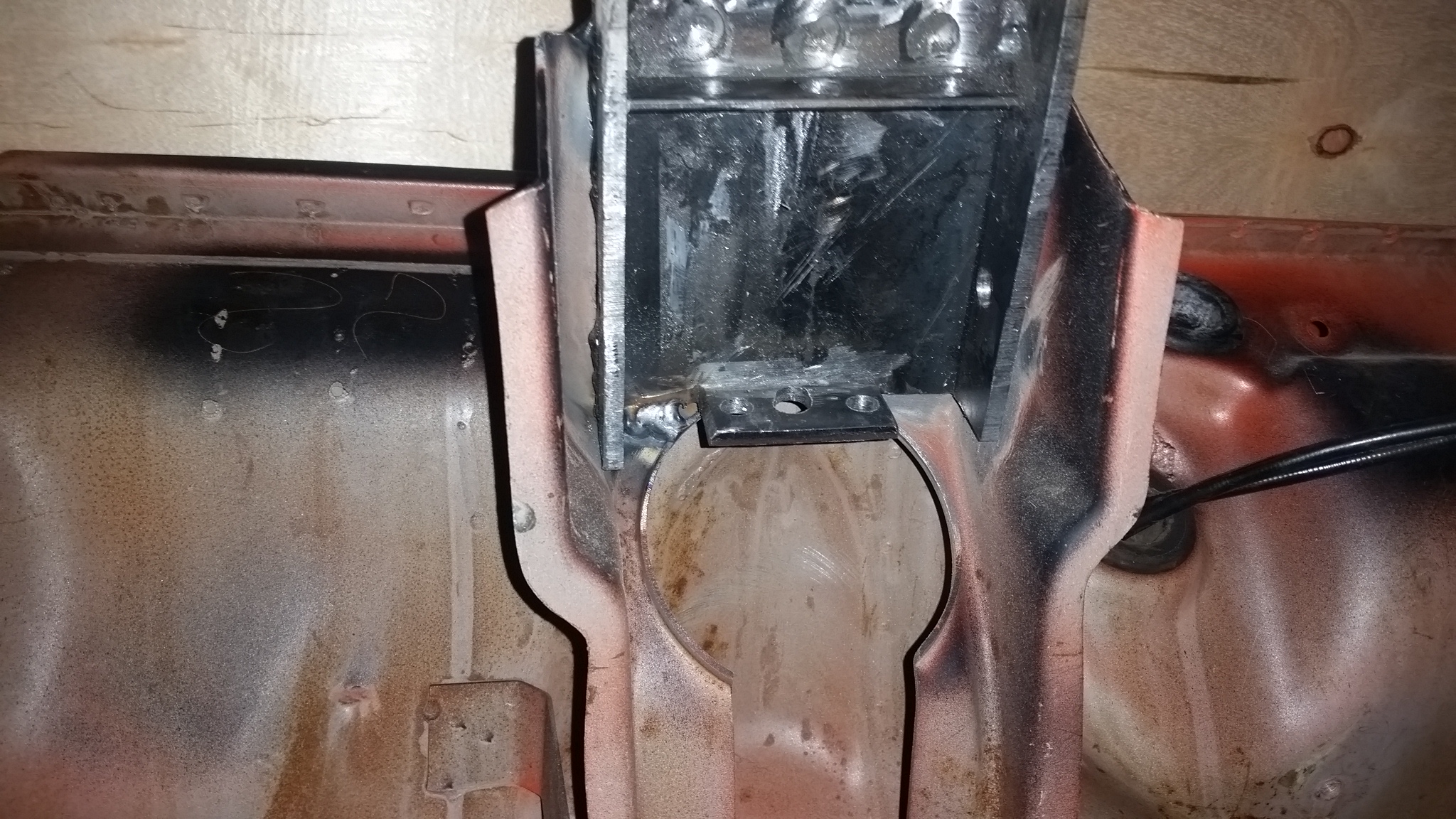

Steering column is mounted and moved back.
Unlike Mike my steering column was not surrounded with steel it was surrounded with aluminum (IMG:style_emoticons/default/dry.gif). So I first had to build a steel enclosure for that and then mount that to the 914 body. I decided to weld it and bolt the Audi column to it. (Secured with 8 1/4x20 bolts and an extremely tight fitting enclosure, Hammer required)
