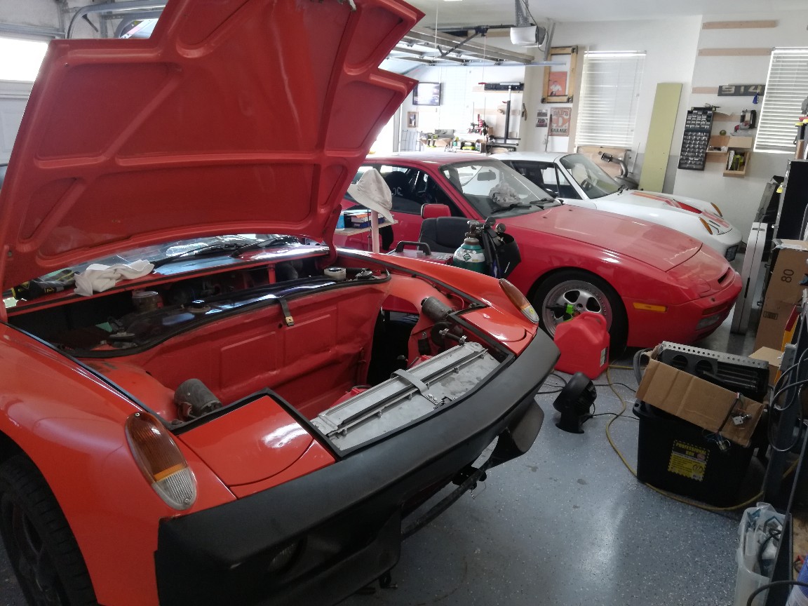

Ok some progress.

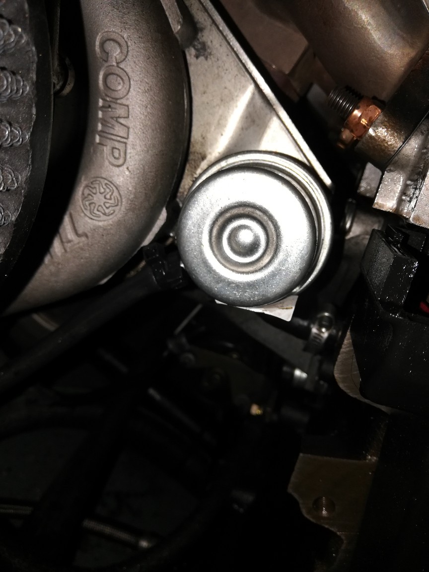

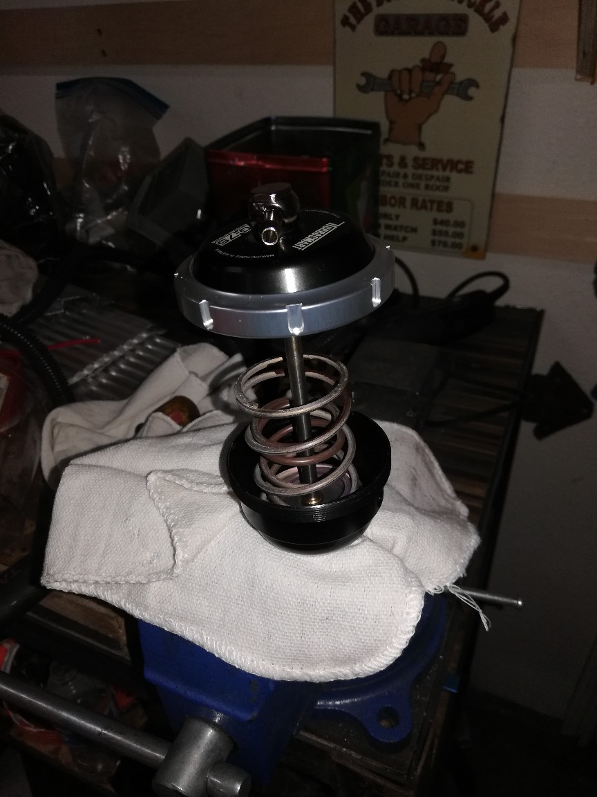

Wastegate came in. I took out a spring so it's 7psi now. It's a bit bigger so fitting it will be difficult. We'll have to work on that after WCR. Too bad, I was hoping to pump it up to 400whp when my dad came down so we could have some nice roll racing.
Another note. My tuner said he's going to tune another ECU of mine, I bought a tuner cable for dirt and I'll be able to tune like he does. He's a nice guy and has shown me a bunch. He'll be down tomorrow to set me up. We'll work on it a bit and do some remote tuning and editing. I told him I want an E85 file and I'll just get set up with whatever files I want and I can swap them whenever at a gas station or swap ecu's if something happens. Anyways I'm pretty excited about that (IMG:style_emoticons/default/smile.gif)
I removed the brake master and got the lines really flat. I removed the slave and left the line open to the vacuum. It still didn't pull anything so I suspect there was just to much air with me fiddling with it. I decided to cycle the master a bit and finally was getting somewhere. I kept cycling it and it seemed to just pull fluid from the reservor and push it out the line. I did this till the line seemed clear. Then connected the slave and installed it.
Side note I extended the rod for the slave a bit more than I had previously. Which required me to weld on an extension instead of just using some tiny nuts in the end caps. Added another 1/4". This means that I should have more total travel with my pressure plate. If it's too much and I get slipping I'll cut it down a hair.
Back to bleeding. Im going to do some more hand bleeding and then I'll be getting a friend, installing the master and trying it some more.
I can't get any more out of the pedal unless I redesign it and then it would only be an extra 1/8* of travel. So I don't think that's enough to worry about.
If this doesn't work then it's a new clutch/pressure plate. I have a couple available.

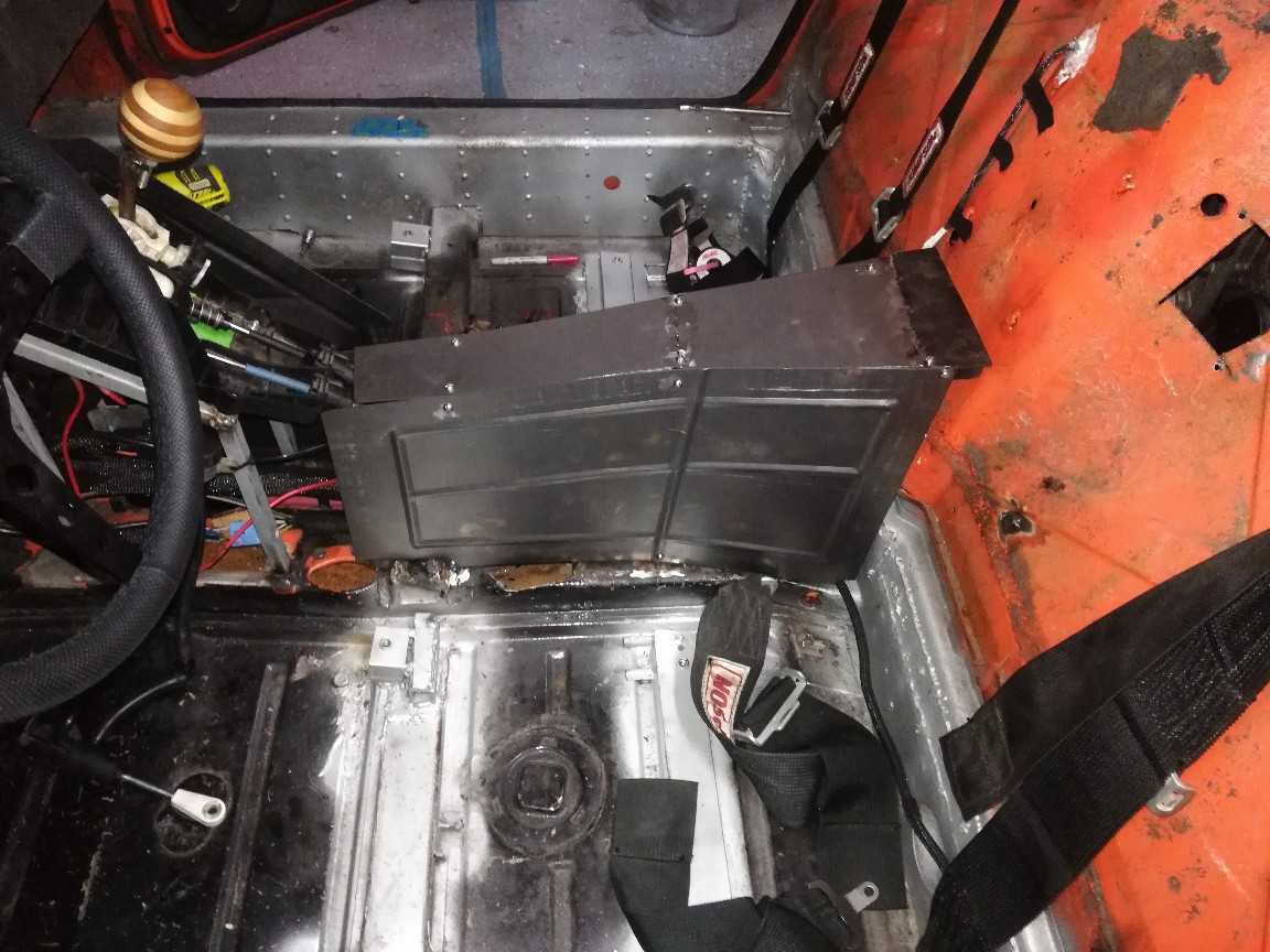

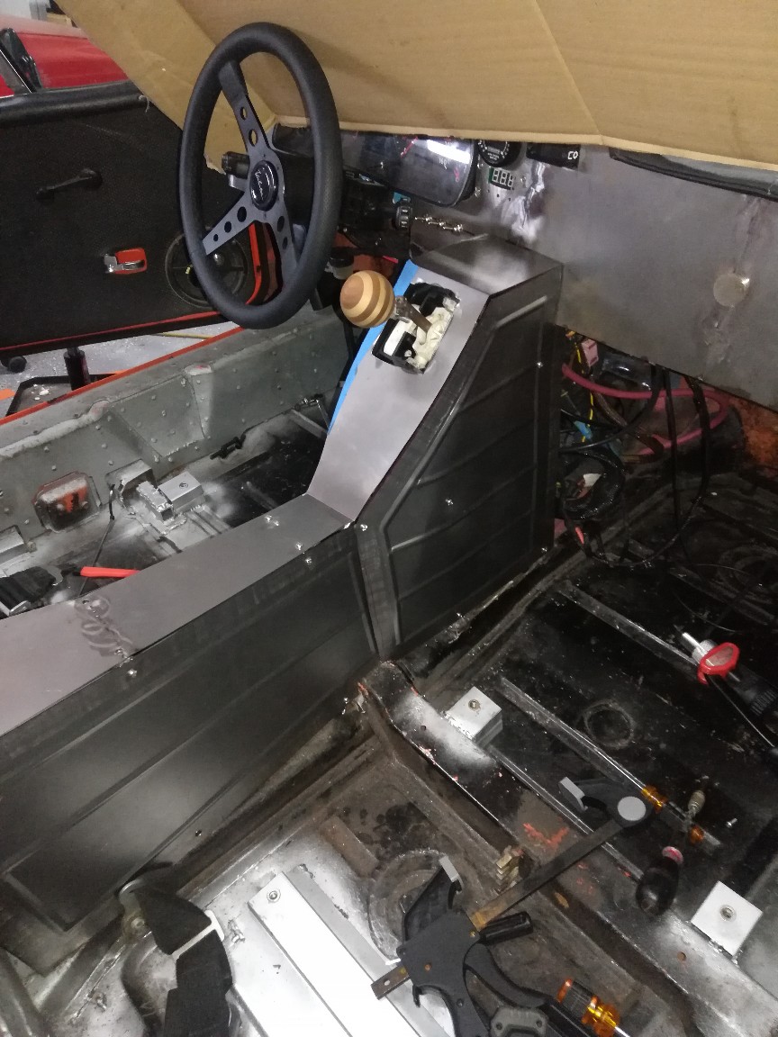

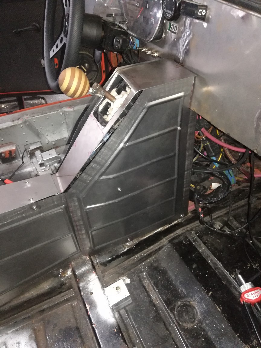

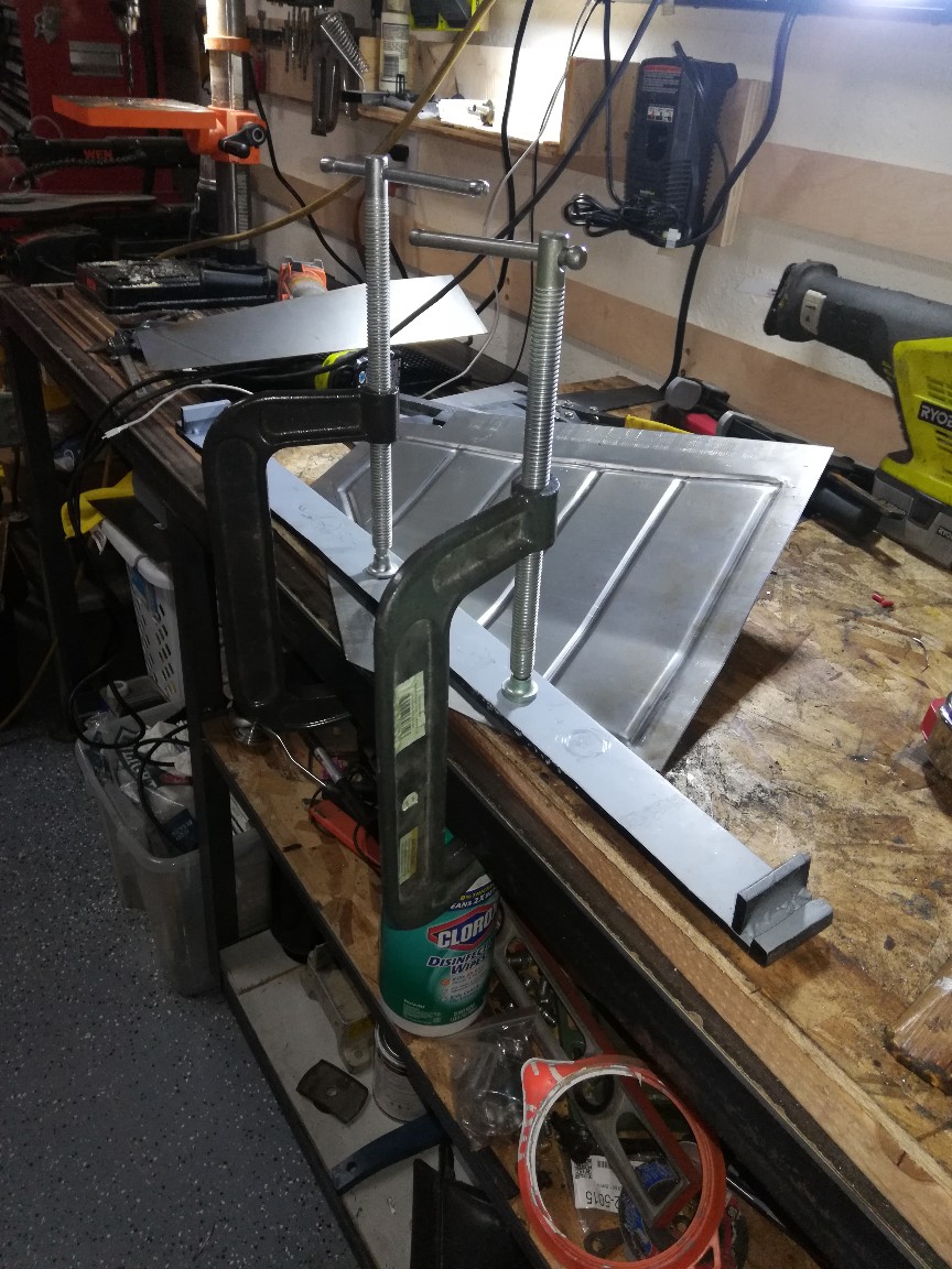

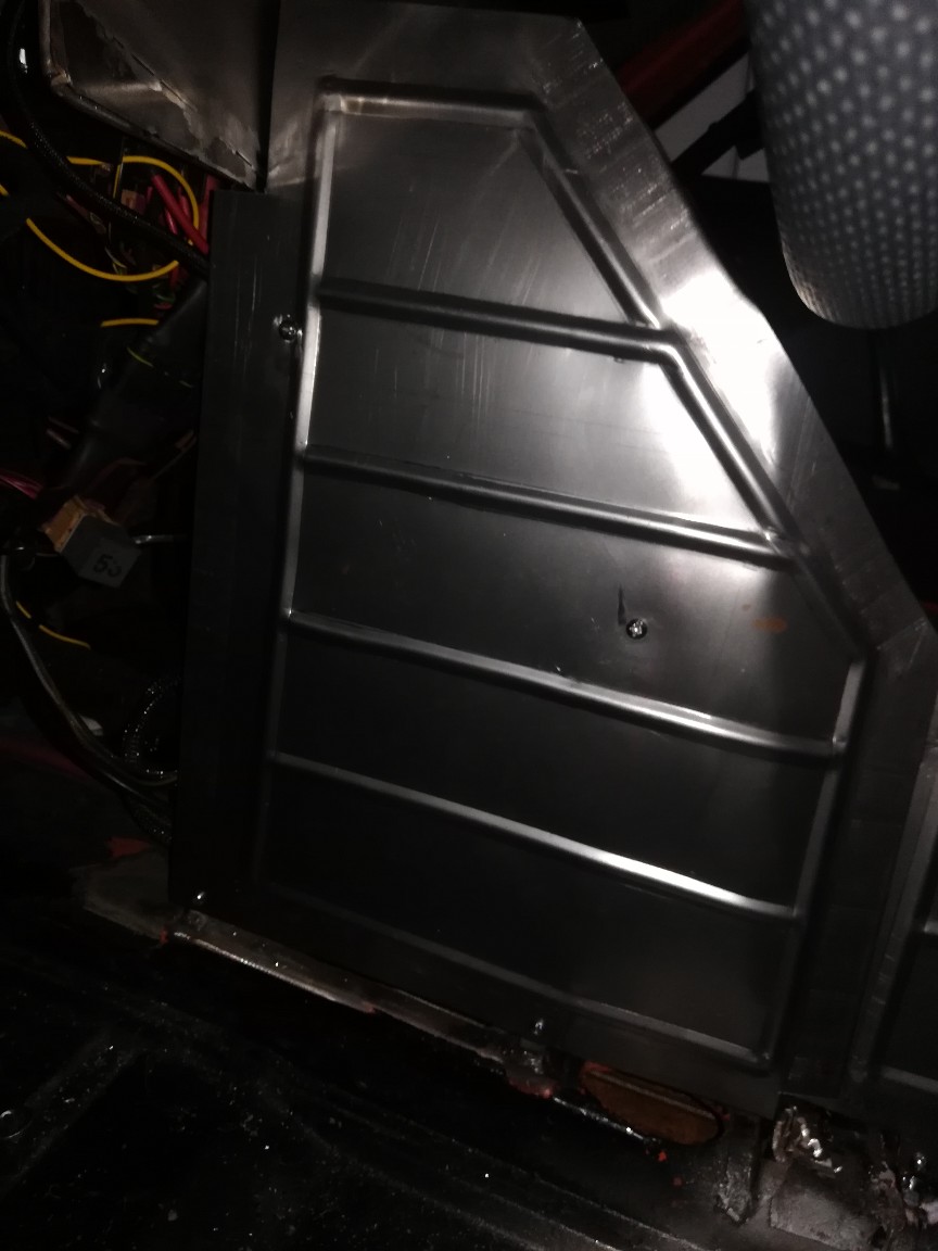

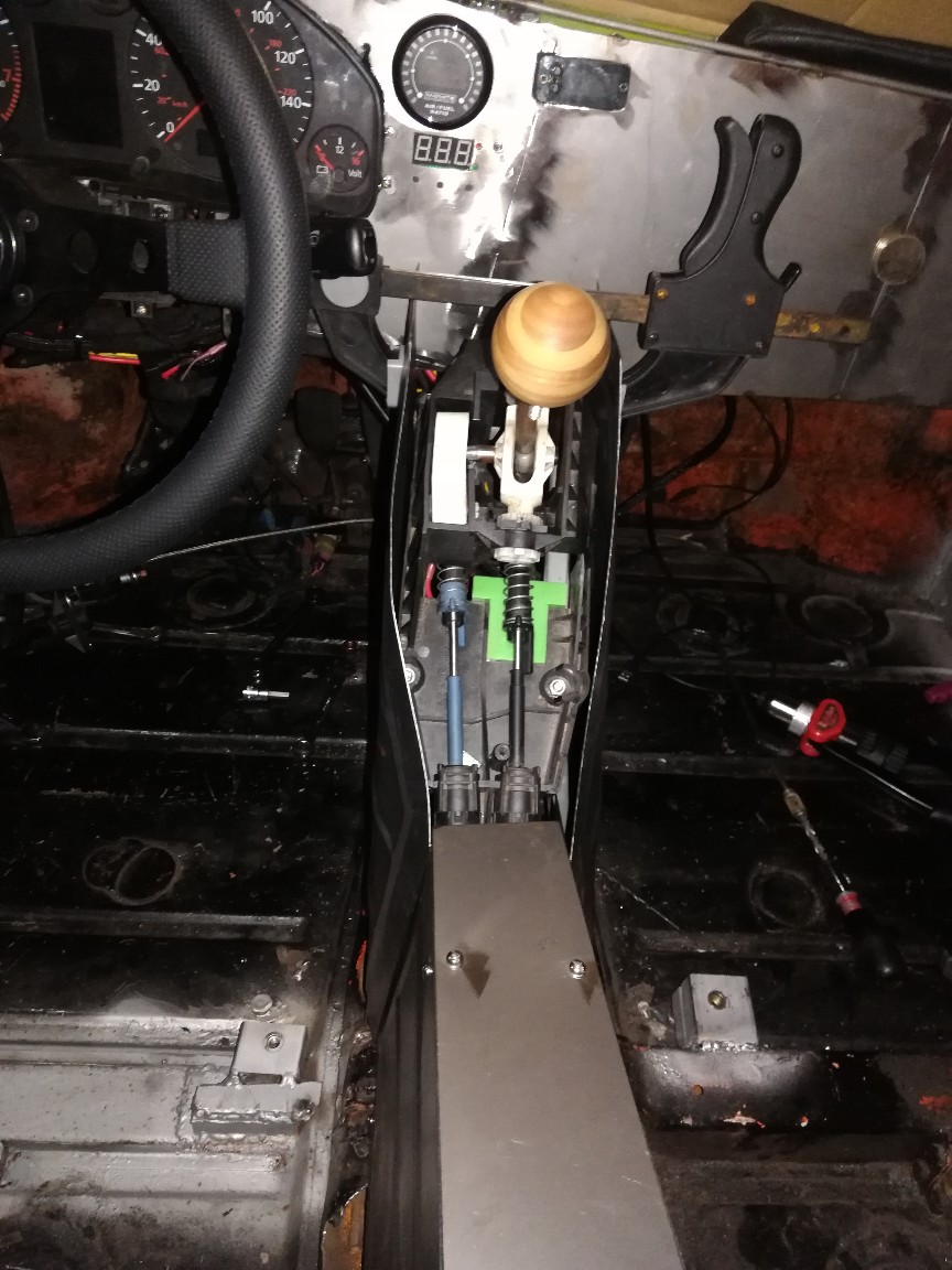

More progress on the center console... My friend to help me bleed the clutch and my tuner we're a no show. Probably do family things tomorrow and Monday but we'll see. I really need to get the clutch dialed in by Tuesday or know if I need a replacement.

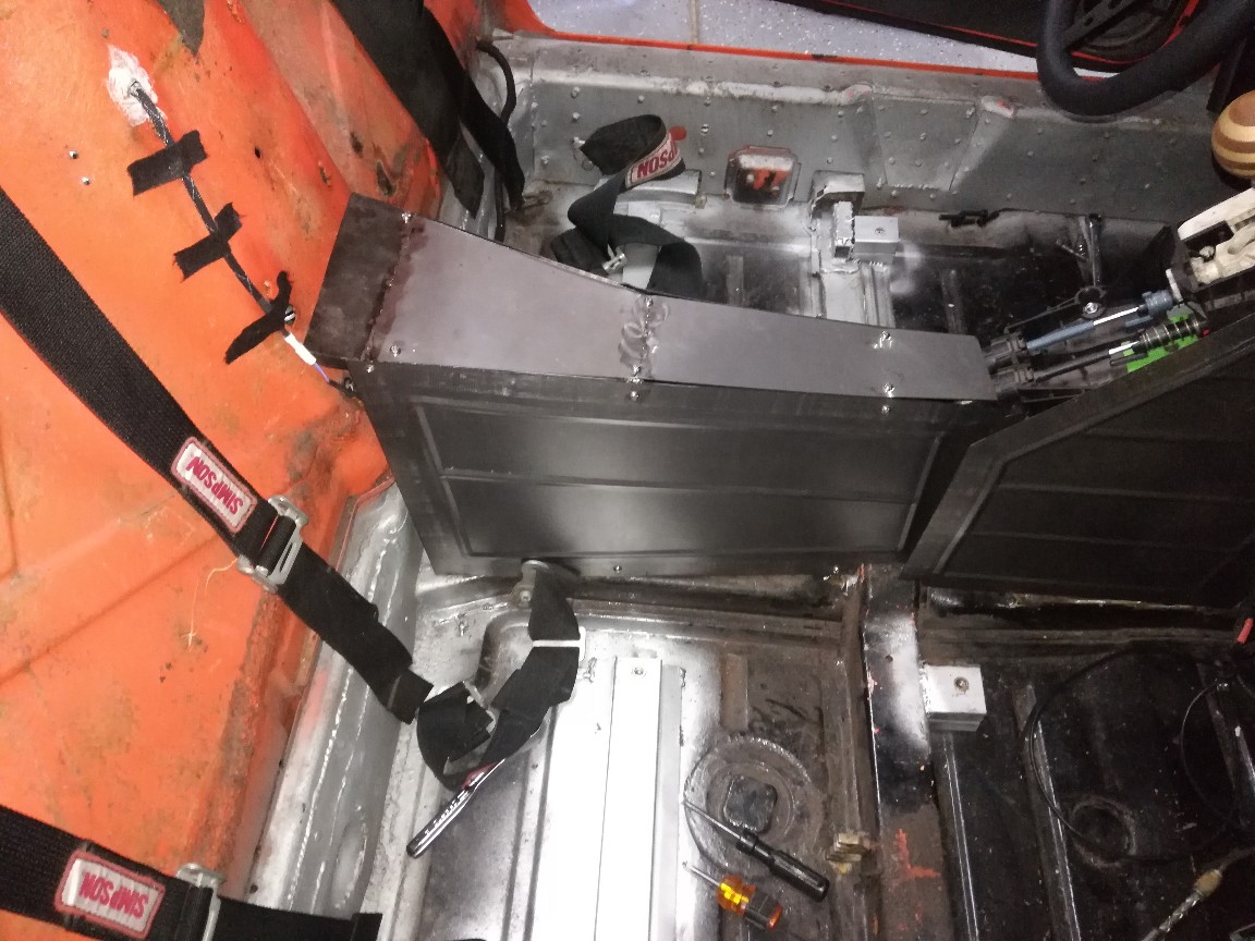

Finished the mounting of the center console base then trimmed the sides to fit.
Then I worked on the top portion and got it squared away and fitting decent.
This was most of my day. Not a lot but the rear section is done as far as the sheet metal is concerned. I will probably drive it to WCR this way.
Frony/middle section with the shifter is difficult due to the curve in the top/base. After a couple tries I got the piece bent that I have and it looks good. I did the lower easy mounts but need to work on the upper mounts. Then I'll need the other side from Chris as well as to do the top portion.
Excited on the progress (IMG:style_emoticons/default/smile.gif)

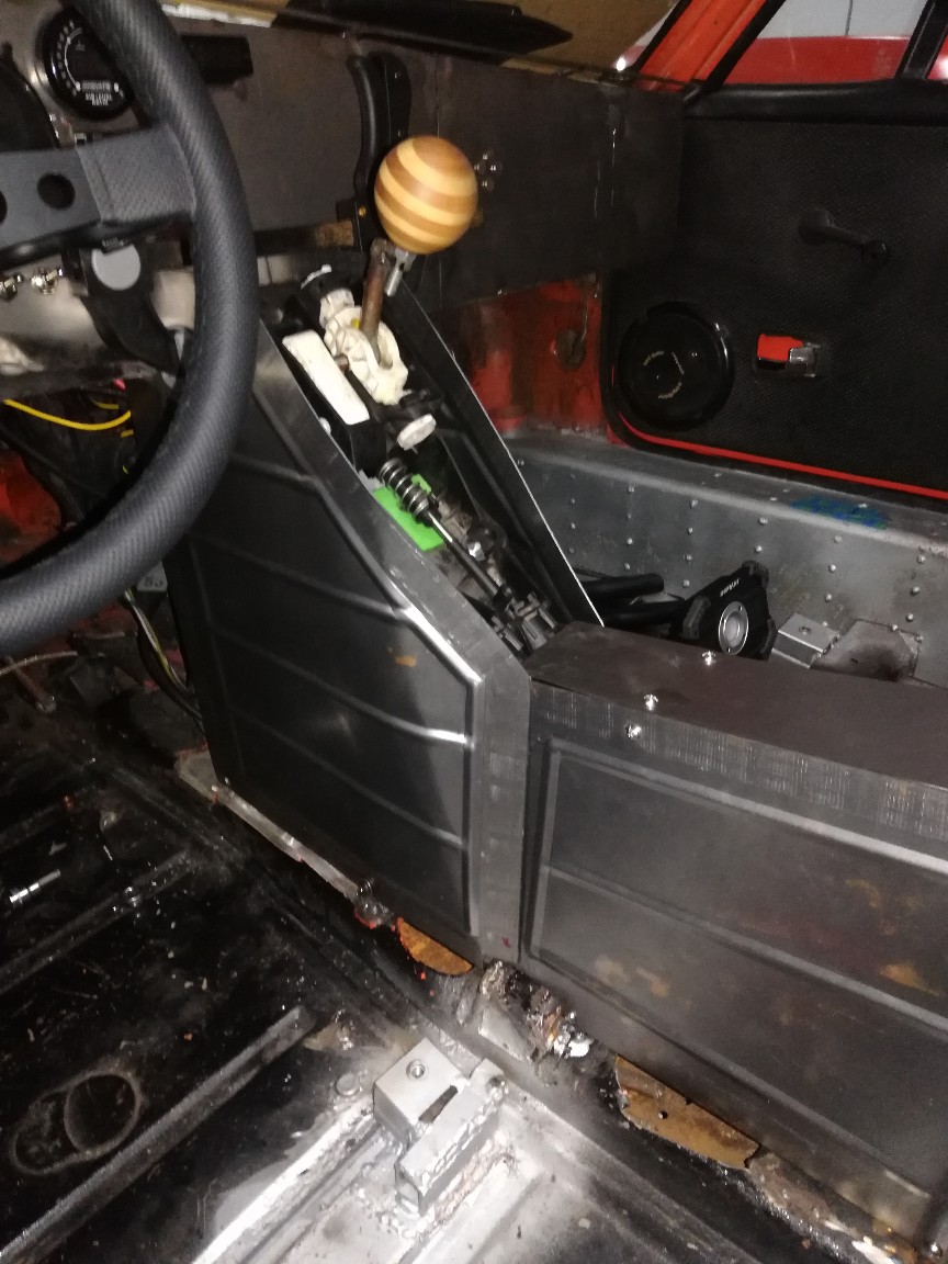

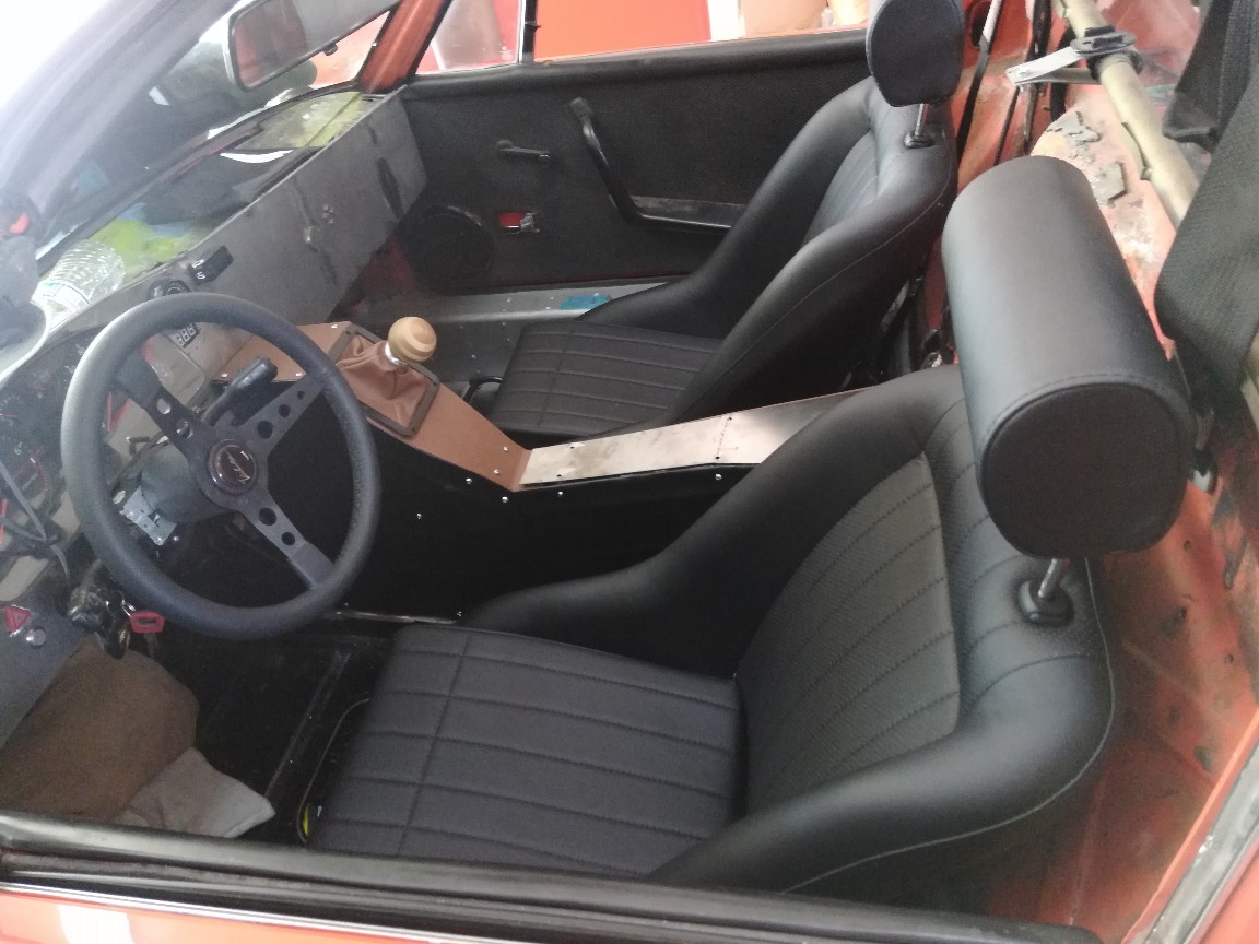

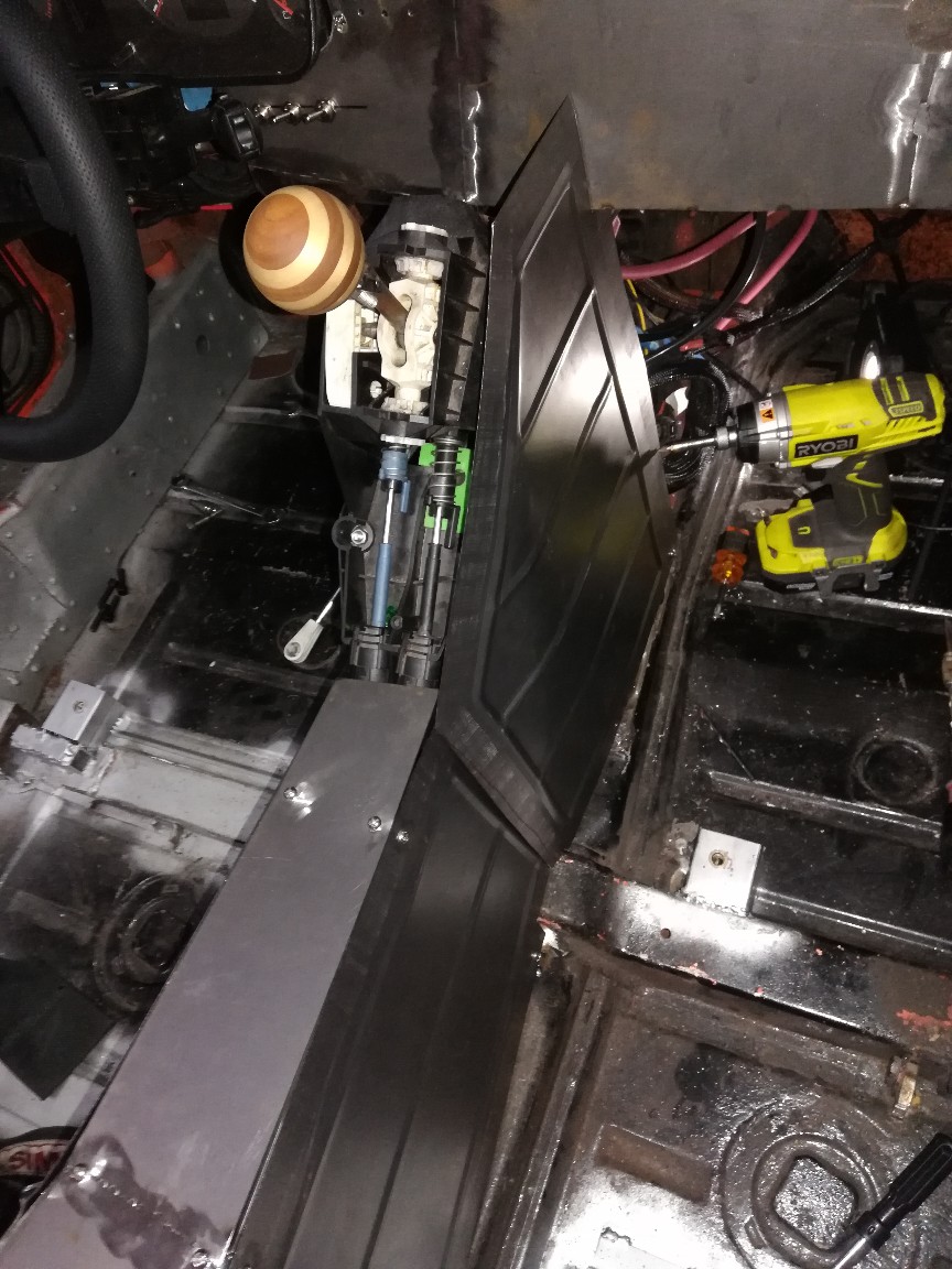

Got home and couldn't resist myself I wanted to see where we were with fitment of the panel.

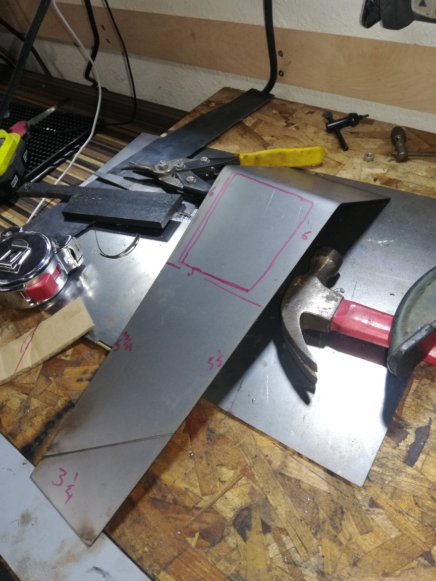

I knew this one would take some more work... We'll like the other one I needed to bend it and since I don't have nice press brakes I make do (IMG:style_emoticons/default/smile.gif)
Couple go around to get this one right. But happy with it. I need to work on mounting it and the other side. But I pulled them together loosly and checked out the top.
Some measurements and I'll need to make a new piece for the top I think. I'll cut out the shifter hole and see what I think. I also need to figure out how to mount this one. Outside the box thinking might be necessary.

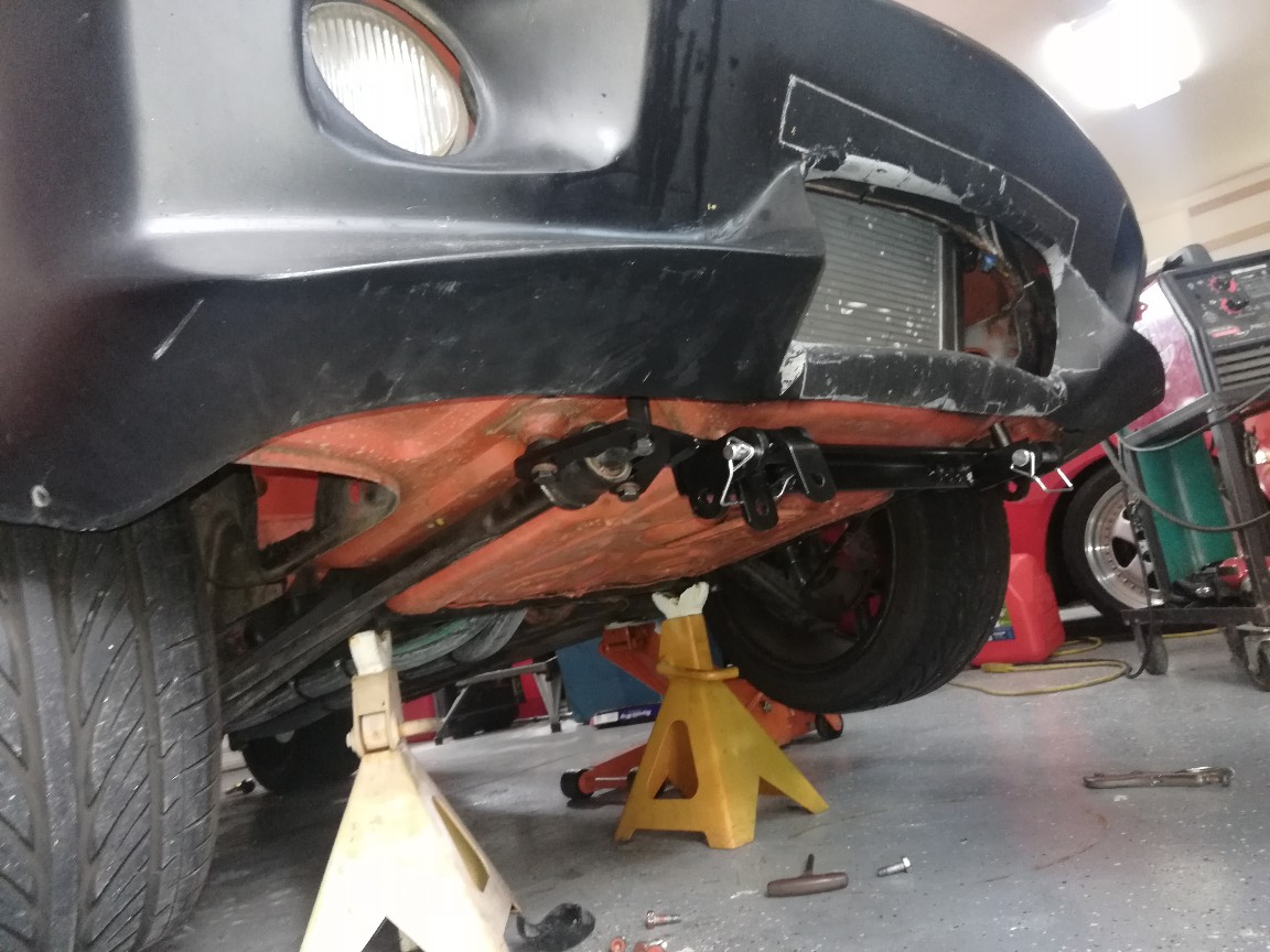

Received my tow bar from @914werks. Nice looking product! Very heavy duty.
Not designed for a 916 bumper so I'll just trim my bumper to fit as its probably going to be changed at some point.
Mounting of the actual pieces. Some shims needed to be made to fit it right. But 4 bolts holding each piece firm.

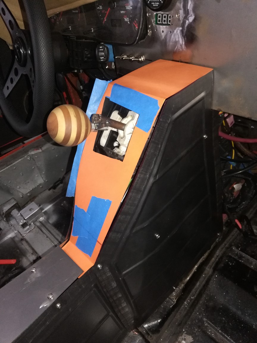

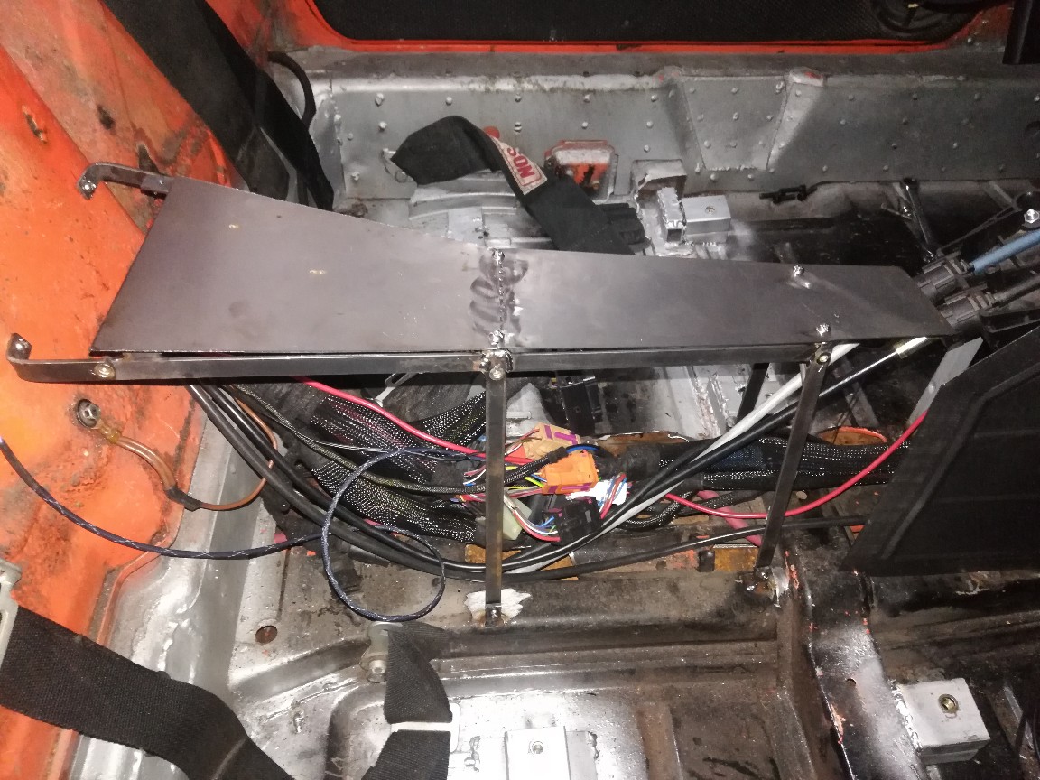

Construction paper to the rescue for the new shifter plate.
And new shifter plate in place, not mounted.
I've determined im going to build a removable upper cage to hold the plate in place, Should be pretty simple to build, probably a couple hours.

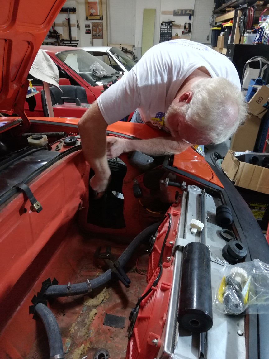

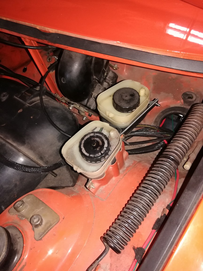

Dad and I redid the clutch reservoir and used a spare of his mounted next to the brake. This gave us an easier bleed and we could pressurize it with his system. Not that it helped. It was still a very difficult bleed.
We're going to try bleeding it again. Still difficult to get into first. But it does shift.

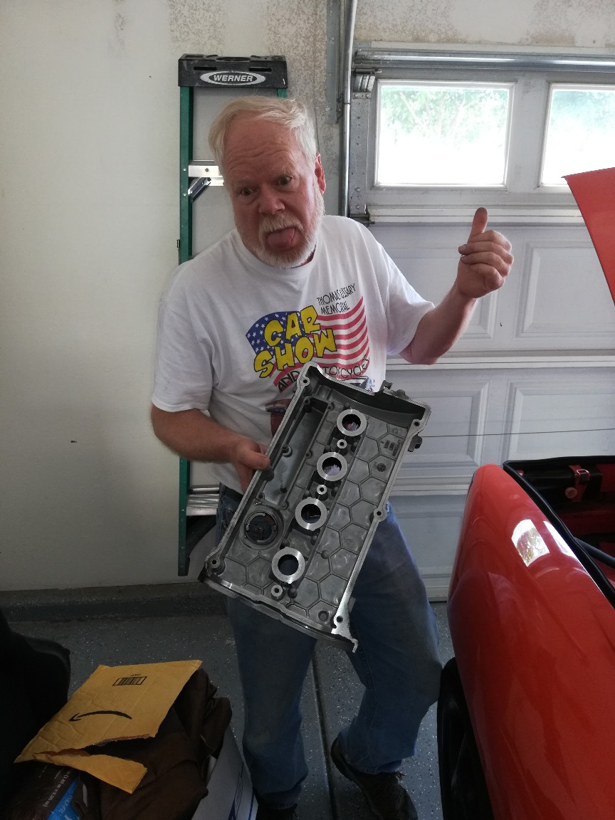

Changed the valve cover gasket. Hopefully this fixes the leak.

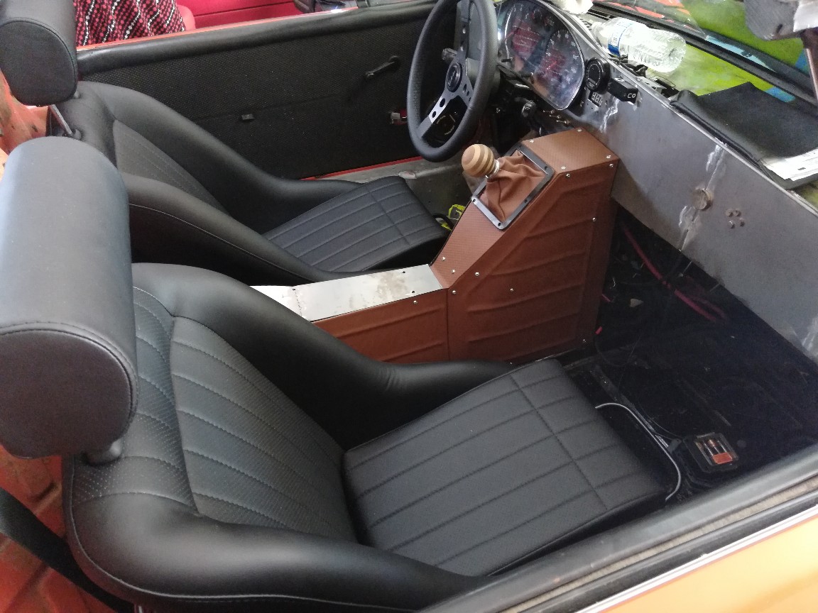

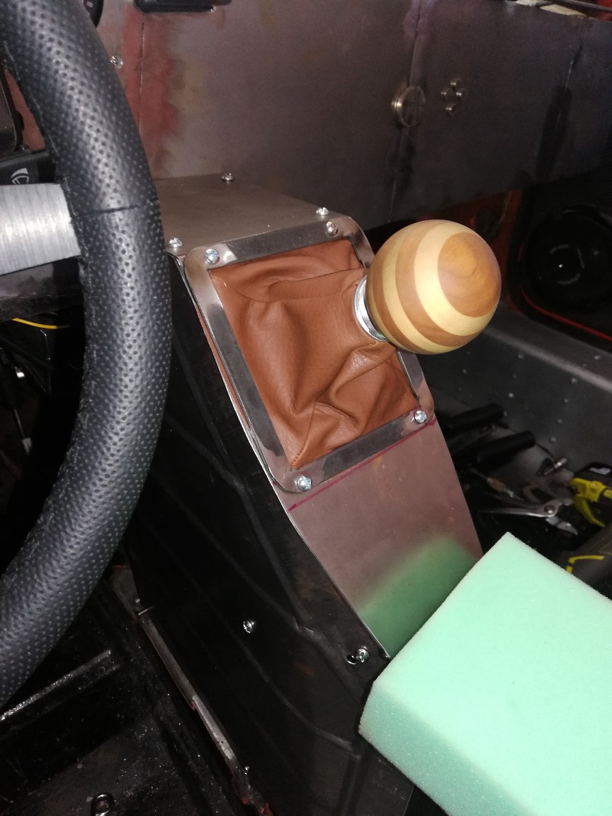

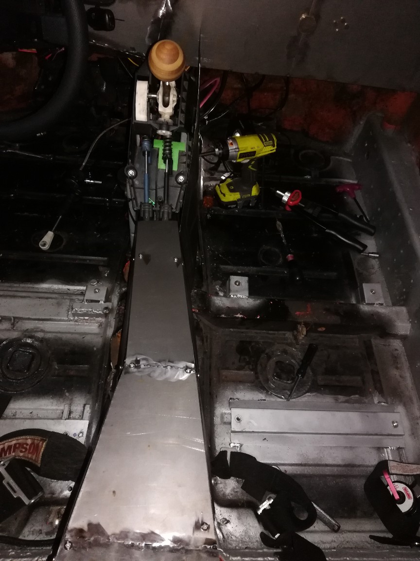

Spent a lot of time on the center console. You can see the shifter solution I made. Really happy with it.
And the big question is black or brown
I'm leaning towards brown. But not sure. I'll powder coat the screws whatever color I need them. Shifter trim will stay black for contrast and the foam arm rest needs to be done still.

On the console, it's totally a personal taste thing but the brown will likely make the beading detail more noticeable, which I happen to like!

I like the idea of the contrast with the brown. If you cover the console in black it might get kind of lost in all the black. It's nice piece and the brown will look nice. Love the seats BTW. (IMG:style_emoticons/default/beerchug.gif)

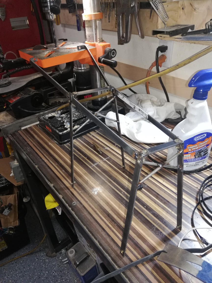

Yesterday my dad worked and prepped the fabric for the dash, removed the dash, and put carpet on the car. Today we put the vinyl on the dash with the basketweve pattern. There is a seam in the middle but I'll figure something for that.
We also worked and tested the tow system. Lots of work to make it better needed. Not the happiest with how clunky flat towing is and we're working on streamlining it.
We also added a trans cooler to the Honda so it shouldn't have any issues pulling up the hill.
Pics.
10 internet points if you can figure out what the metal pieces are for.

Dash pad replication? (IMG:style_emoticons/default/idea.gif)
Andyrew
post Jun 5 2019, 01:47 PM
Post #843
Spooling.... Please wait
Posts: 13,380
Joined: 20-January 03
From: Riverbank, Ca
Member No.: 172
Lower dash pad (IMG:style_emoticons/default/smile.gif)
