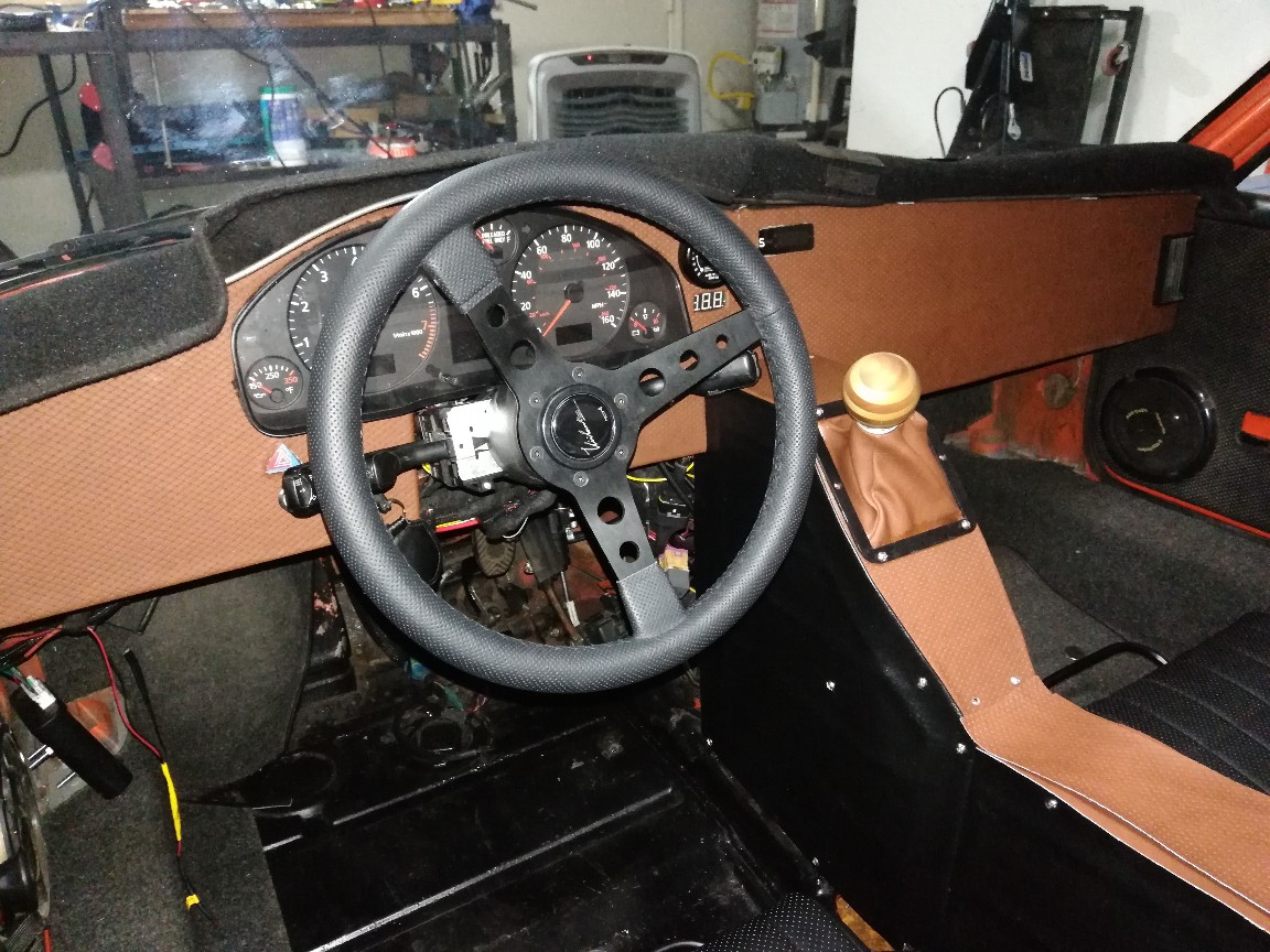

Dad and I redid the clutch reservoir and used a spare of his mounted next to the brake. This gave us an easier bleed and we could pressurize it with his system. Not that it helped. It was still a very difficult bleed.
We're going to try bleeding it again. Still difficult to get into first. But it does shift.
Changed front shocks to Koni Yellows
Changed the valve cover gasket. Hopefully this fixes the leak.
Spent a lot of time on the center console. You can see the shifter solution I made. Really happy with it.
And the big question is black or brown
I'm leaning towards brown. But not sure. I'll powder coat the screws whatever color I need them. Shifter trim will stay black for contrast and the foam arm rest needs to be done still.
Also my tuner came by and set me up with the ability to change my tune myself. (IMG:style_emoticons/default/piratenanner.gif)
My wife and I went for a quick drive. She liked it, but the clutch still needs work. LSD is working well though, put down good power in first!

Andrew - Looking good! Also good to hear you're making progress on the drive-ability items.
On the console, it's totally a personal taste thing but the brown will likely make the beading detail more noticeable, which I happen to like!
Hi to your dad for me.

I like the idea of the contrast with the brown. If you cover the console in black it might get kind of lost in all the black. It's nice piece and the brown will look nice. Love the seats BTW. (IMG:style_emoticons/default/beerchug.gif)

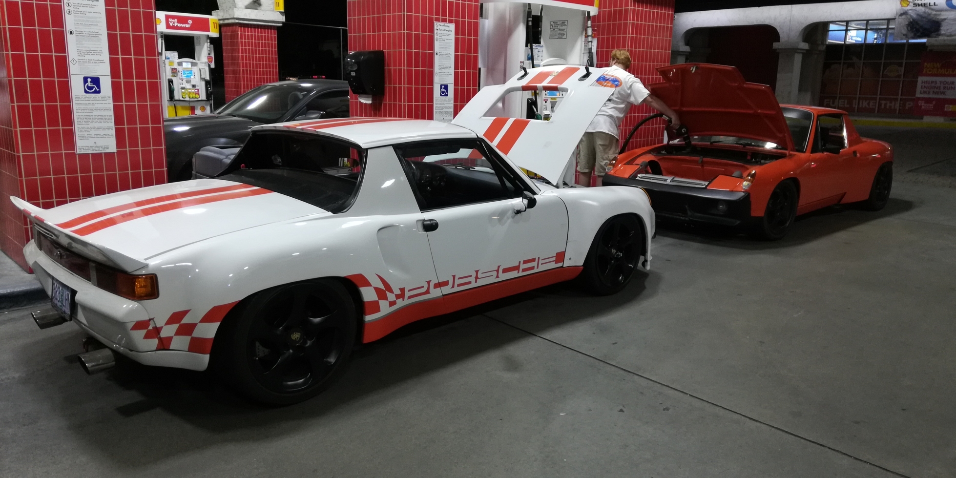

WCR 2019 Came and went.
Nothing major happened except dads car almost falling off the trailer. Honda pulled the 914 incredibly well. I got 29mpg going to the event and got 24mpg back with a bit of city driving, both times up and over the grapevine. It might be slightly elevated, but I confirmed the 24mpg number on the way back when I filled up, didnt have a chance to confirm the 29mpg.
I had a great time driving around a couple of guys, some decent compliments on the car, especially the sound. It was really great getting together with everyone. So many familiar faces I was surprised I knew half or better!
The 914's hot start issue is better, It takes on average 3 times to start the car, sometimes when its warm it'll start right up, sometimes when cold it'll start right up. I think we can tune it out now. Clutch is MEH at best when warm. Odd bit is when the car is very cold or a cold morning it shifts really well. I have some ideas on it. Probably will redo the master cylinder with a universal master cyl maybe oversized to give me some extra throw and I'll adjust a clutch stop accordingly. Another possibility is its simply air in the lines still. I'll try bleeding it some more and see what we get.
Dad and I had a great time driving together and spending some good time together, It was a fantastic early fathers day!
