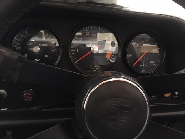

Apparently, using the 4 cylinder tach in in your DME 3.2 conversion is death to the ECU eventually. Thanks to, I believe Mepstein for researching this and reporting on his chat with Steve Wong on the subject. After reading that a month or so back, I've been afraid to drive the car for fear of taking out the ECU! Who would of thought it wasn't as simple as dividing by 3 and multiplying times 2? (IMG:style_emoticons/default/evilgrin.gif)
I've had the Carrera tach in a box having had it refurbished by North Hollywood Speedometer. I did a search and found the proper PIN numbers posted by Joe O'Brien a few years back. I confirmed the info was correct with McMark and Mark added the wire colors to the PIN number connections.
So now, I have a properly functioning 6 cylinder tach!
Tach signal / black/purple / pin 2
12 volt power / red/white / pin 5
Ground / brown / pin 6
Here she is!
Yes, I know. No silver button on the speedometer. The Carrera speedometer is also in a box. It needs that shiny 915 transmission to work so, it's coming soon!

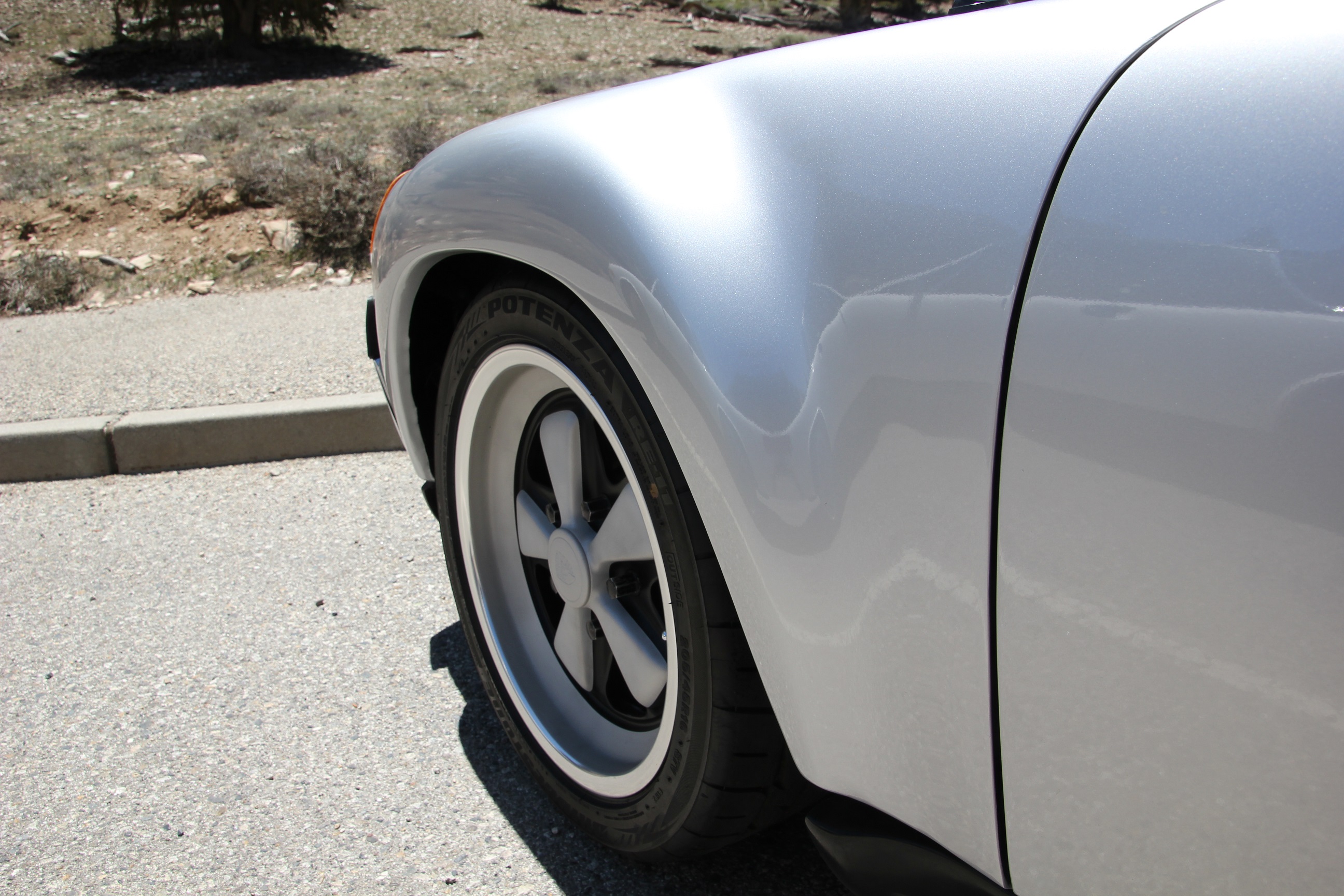

Since this is 'the story of my 914' I thought I'd put some of the really great pictures taken by a few of my fellow WCR 2017 pals...

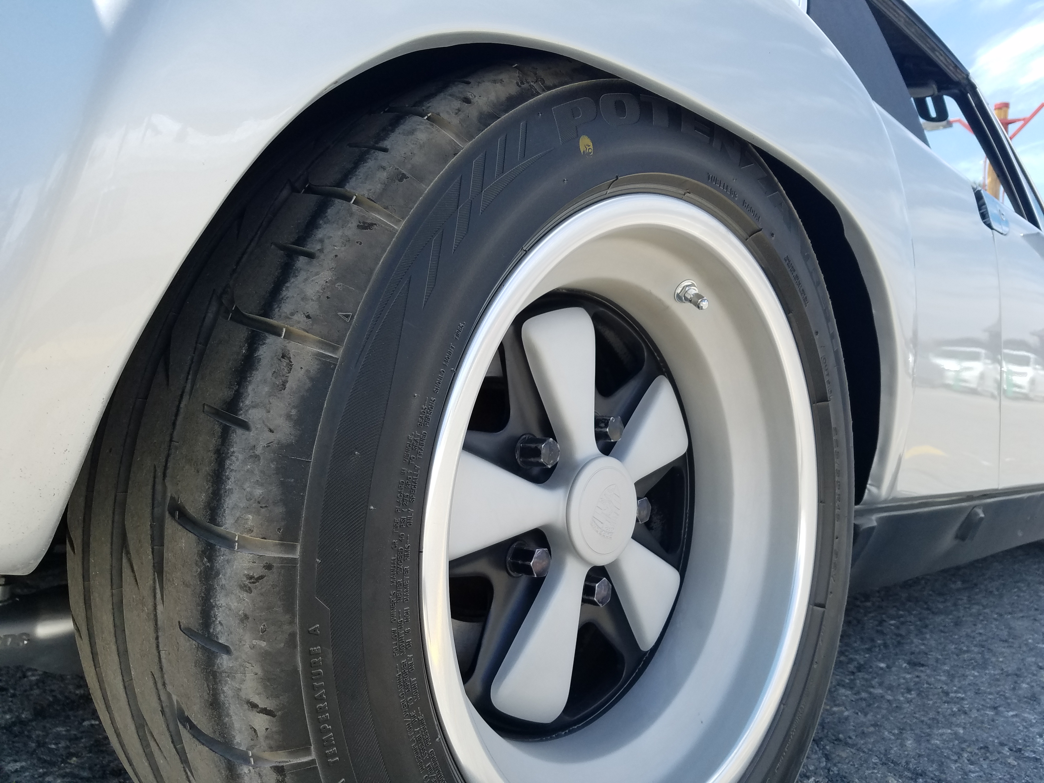

And another!

Those are actually some of the coolest photos of your car that I have seen.

Those are some nice pix Rob!

Beautiful car and pictures. Can't wait to get my car painted.

Thanks Harvey. Everyone who sees it loves the wheels so you're a big part of that! (IMG:style_emoticons/default/biggrin.gif)
