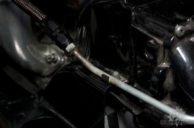

So life has kept us busy lately... New Victoracers have had me out autocrossing every event I can find and McMark has been SWAMPED at his shop. But some progress is being made. Actually, we are so close it is just a matter of having the two of us in the same place at the same time really...
McMark built me a custom fuel line to feed the driver side injectors. I always hated that fuel line running across the engine thing and apparently McMark did too. I think he reads my mind sometimes because I didn't specifically ask for this.
Check out these custom lines... (IMG:style_emoticons/default/biggrin.gif)

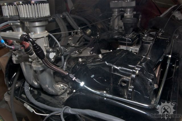

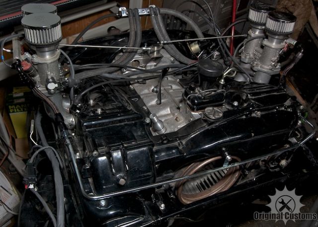

Time for an update. Mark has pretty much everything mocked up and nearly ready to fire on the stand with the SDS EFI. Here are a few pictures Mark has posted both on his site and on Facebook. Notice at the back of the engine toward the flywheel, you have the vacuum plenum with lines coming from each runner of the intake. This may or may not work. We have had much debate over the MAP sensor and I honestly don't know what kind of vacuum to expect. Also notice McMark's attention to detail. He bent up fuel line to run fuel across to the driver side ITB's but he didn't stop there. He then sent the lines out to have them zinc plated. Very cool! The custom harness is all connected in the third picture.
This engine will go in the car within the next two weeks. Are you guys ready? (IMG:style_emoticons/default/evilgrin.gif)

Is that Grey Shrink tube? (IMG:style_emoticons/default/idea.gif) or just the way it looks in the photo?

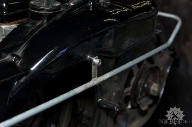

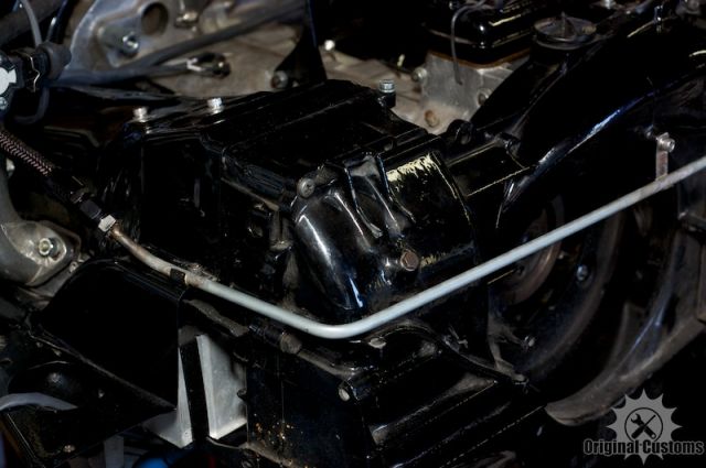

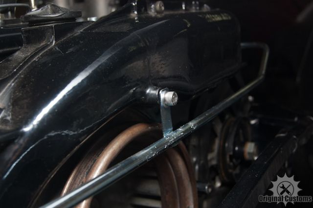

Any thought to what happens to the fuel line if the fan belt breaks? It'd suck to have a high-pressure fuel leak from that.
--DD

When was the last time you heard of a fan belt breaking? That line is steel, it's gonna take more than a fan belt to crack it open.

I like the fuel rails you have. Do they accept the newer injectors without the hose?
Who makes them and where can I buy them?

Fuel rails are custom built by McMark at Original Customs. He can make them for you... As to your other questions, he will have to answer. I don't know. (IMG:style_emoticons/default/biggrin.gif)

I think it is grey Rick. harness is custom built by Mark so he would have to tell you the source... (IMG:style_emoticons/default/smile.gif)
Haven't heard of one in a long while. Still, low-probability high-consequence... But if you're confident that a flailing fan belt won't break the line, then I'll believe you. (IMG:style_emoticons/default/smile.gif)
Thrown belts are more likely, but they don't flail around in my experience.
--DD
I broke one back in '94. Can happen.

BTW where did you and Mark hide the fuel filter?

I have one of those Fram canister filters just the the passenger side of where the fuel lines exit the tunnel in the engine room. That and the stock one up front. Fuel can't be too clean you know... (IMG:style_emoticons/default/biggrin.gif)
