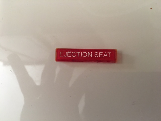

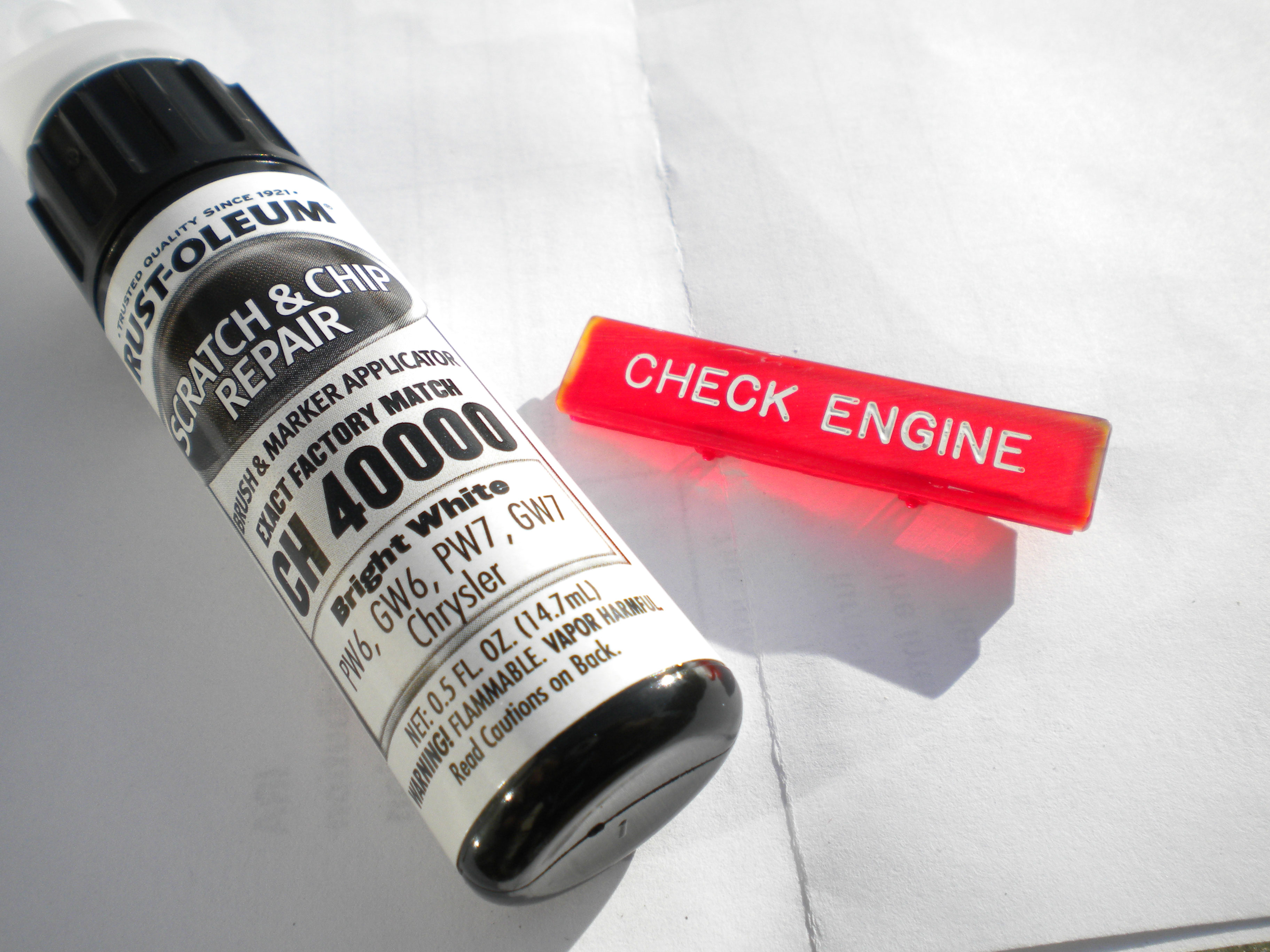

Those of you who’ve been following this thread know some of the history behind this next little mod. When I built the Raby kit motor the programmable EFI had the option to add a Check Engine light. McMark came up with the idea to take the Fasten Seat Belt lens and mod it to say Check Engine. It was a cool little detail.
But now, with the ‘89 Carrera motor attached to its DME injection, there isn’t a CEL option.
What to do?
I saw three options. First, leave it alone. Second, remove it and re-do the dash basket weave. Third, change what the light says... (IMG:style_emoticons/default/happy11.gif)
Here’s the first modification if you guys don’t recall, and remember, it’s totally functional.
ConeDodger
post Jan 19 2018, 05:28 PM
Post #1204
Apex killer!
Posts: 24,246
Joined: 31-December 04
From: Tahoe Area
Member No.: 3,380
Those of you who know me personally know that I’m not a really serious guy unless the situation is life or death, and since I’m retired, I’m not dealing with that much anymore.
I want to thank McMark again for the original idea, and Garold Shaffer for supplying the new lens.
I still need to put another coat of paint on this after the first coat completely drys and contracts, and plastic polish the red to make it shine again.
I will somehow make the light functional to freak out the innocent! (IMG:style_emoticons/default/evilgrin.gif)

And polished...

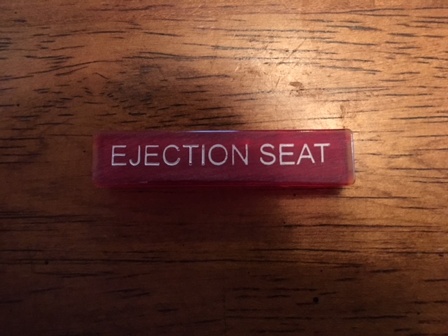

(IMG:style_emoticons/default/av-943.gif) Nice touch! How did you get the lettering on there? I want one.

QUOTE(Krieger @ Jan 21 2018, 09:22 PM) *
Andy,
I gently sanded the 75 - 76 FASTEN SEAT BELT lens from the dash until the lettering disappears. Then, I took the blank lens to a trophy shop and had them engrave the EJECTION SEAT lettering. Finally, I painted the face of the lens. When it dries, I gently sand on Emory cloth again. One more coat of paint, one more sanding. Finally plastic polish.

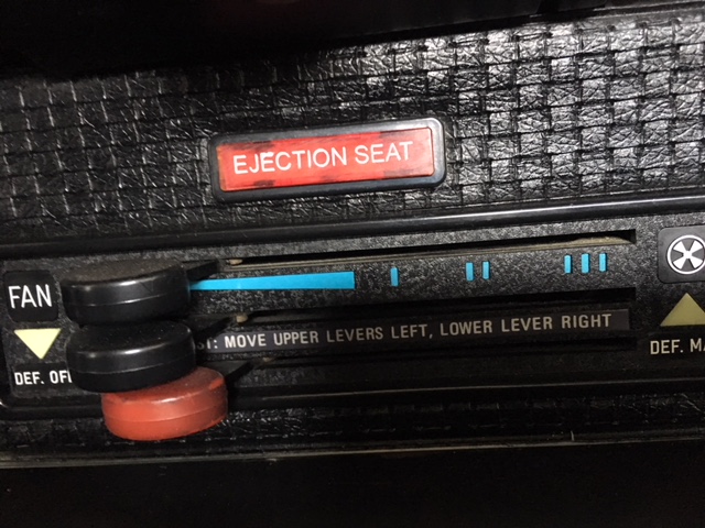

And installed! Now to get a shaker solenoid! (IMG:style_emoticons/default/evilgrin.gif)

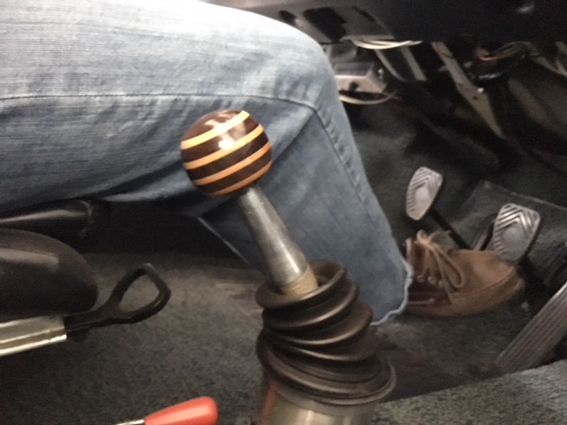

Oh, and while I was at the warehouse, I snapped a picture of one of Zach's 917 shifter knobs... Mine! (IMG:style_emoticons/default/biggrin.gif)
