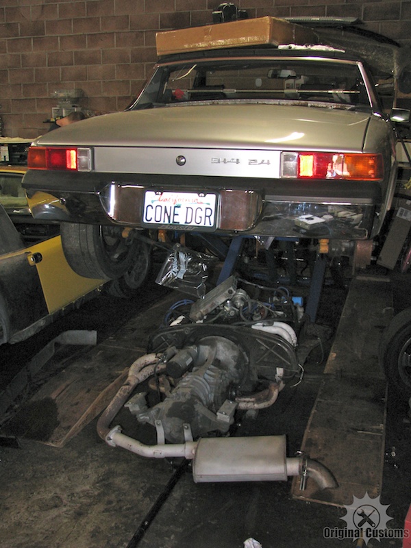

Well let the fun begin! Dwight Mitchell Motor out (Jim, get a car ready (IMG:style_emoticons/default/smile.gif) ) Now for the new motor...
Oh hell! It was upright on my camera screen. I will fix this later. Gotta go to work. Fixed!

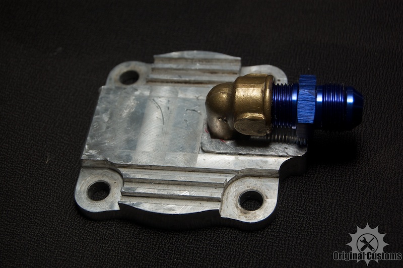

This is pretty cool! We decided the best place to put the ECU and the controller for the O2 sensor was under the passenger seat. Kind of ala 911 Carrera with the DME relay under the drivers seat. We did this for a couple reasons. 1: the SDS ECU is a hideous gold anodized finish. It's just wrong and it reminds me of why we need to attack Canada some day... Better yet, we will send them decorators. (IMG:style_emoticons/default/poke.gif) 2: the ECU needs a cool dry place to live. At least in my 914, under the passenger seat is a nice cool dry place... 3: Did I mention it is ugly? (IMG:style_emoticons/default/barf.gif)
So Mark decides that it would be best to have a weather proof plug on the firewall that the engine room harness plugs in to. This allows me to unplug the motor and drop it without disconnecting all of the EFI. Pretty neat Original Custom idea huh?
Damn! another sideways pic! Where is that admin fairy? (IMG:style_emoticons/default/cheer.gif)

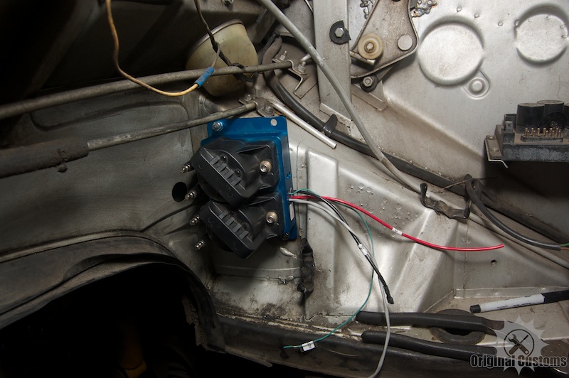

Since this engine will be crank fired, we will be using a coil pack to distribute spark. Mark decided that the best place for this would be just aft of the relay board in the engine room. I might try and talk him into fabricating something to brace that free corner of the coil pack though... (IMG:style_emoticons/default/biggrin.gif) I will probably get another demeaning look but hey! (IMG:style_emoticons/default/smile.gif)

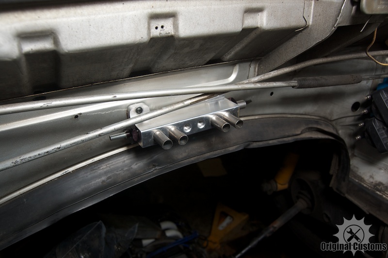

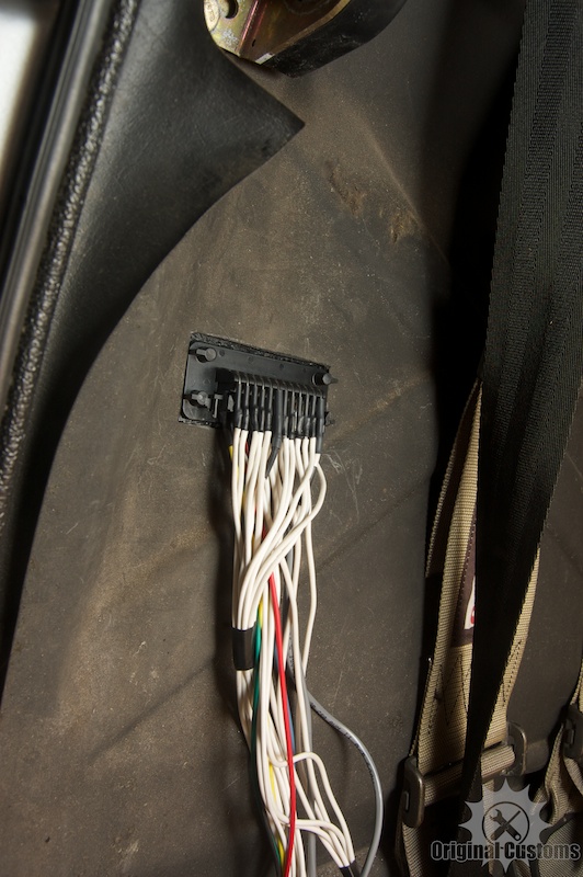

Getting closer... (IMG:style_emoticons/default/first.gif)

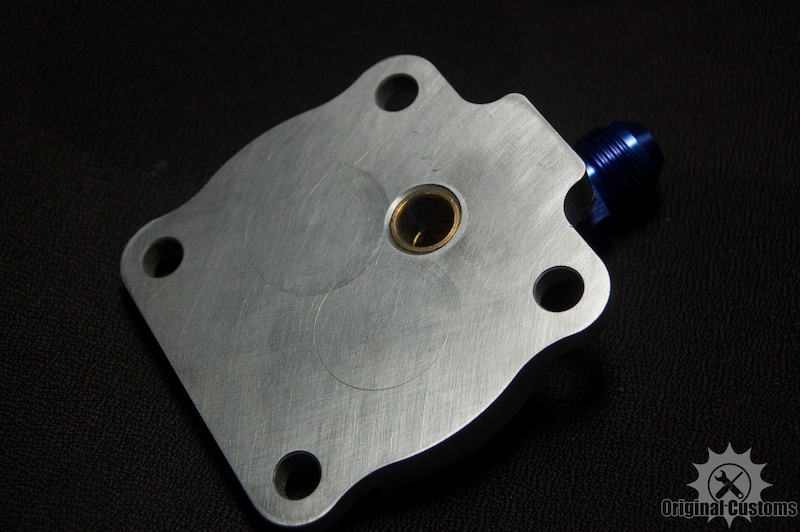

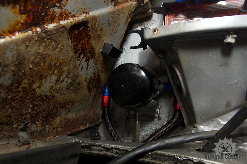

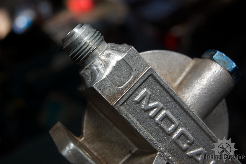

We are using AN lines from the engine up to the remote oil filter. We're going with AN-6 lines (just kidding Jake!). Actually it's AN-8. I couldn't find the AN-8 fittings to mate up with Rob's Mocal filter console, so I just bought some weld on fittings and pulled out the ol' TIG welder. Done!
The next issue was that the full flow oil pump cover outlet port is too close to the engine mount brackets. I've tried all sorts of things to get it to work, but always had problems getting the fittings tight. I decided to stop trying to make a poor layout work and modified the cover as you can see. This effectively moves the fitting out another 1/2" and then everything clears fine. There's plenty of room behind the fan housing, I could have gone another 1/2" easily, but this works.
The vacuum signal is running through a pretty unique setup (AFAIK). Rob and I wanted to use a stock AAR to provide a nice warm up, fast idle. So we are running this common plenum for the vacuum. The front four ports go to each intake runner, below the throttle plate. The smaller port on the left goes to the MAP sensor, and the tube on the right goes to the AAR. This lets the plenum serve double duty by combining the vacuum signal for the MAP and giving even distribution of the AAR airflow. It seemed to work just dandy on the stand, and we'll see how it work during tuning. The ITBs have smaller vacuum ports available if we decide that this setup isn't working and need to switch things up.
And finally, a shot of the oil filter mount, with oil lines attached, and you can see the wiring harness poking through just above the filter. It's going to be a little tight in there, but there should be just enough room. At the next filter change we'll swap to a longer 914/6 filter so that it will be easier to grab onto for filter changes.
Tomorrow, a couple more mods in the engine bay, and if everything goes well, we'll get the 2432 lifted into place. (IMG:style_emoticons/default/boldblue.gif)

Oh, and I hate the red/blue fittings. But it's all I can get locally, and we don't have time to mail order everything. (IMG:style_emoticons/default/dry.gif)
