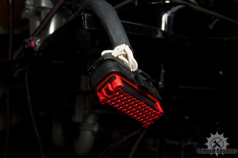

The weatherproof connection that makes it all work...

Member No.: 419
Picture thief. (IMG:style_emoticons/default/ph34r.gif)

QUOTE(McMark @ Nov 2 2011, 02:57 PM) *
Shut up Mark. I'll pull your ponytail! (IMG:style_emoticons/default/av-943.gif) This page needed a picture to give it more... um, color.

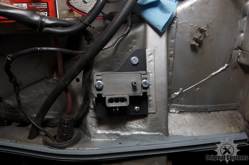

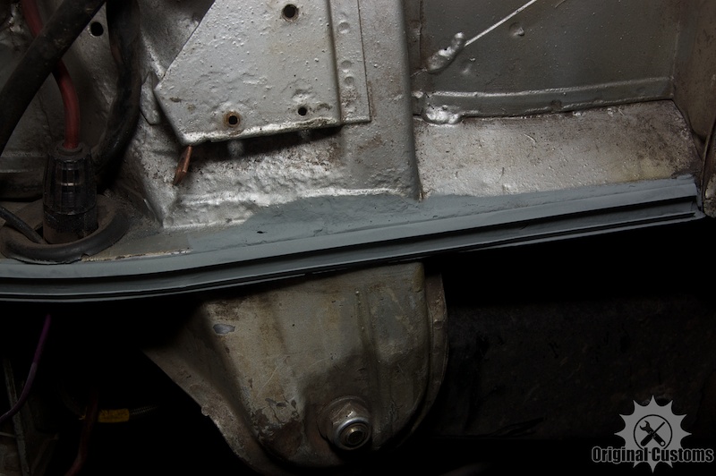

Okay enough BS. (IMG:style_emoticons/default/happy11.gif)
Started by removing the rusted out seal channel and welding in a new one from Restoration-Design. (IMG:style_emoticons/default/smilie_pokal.gif)
Attached ImageAttached Image

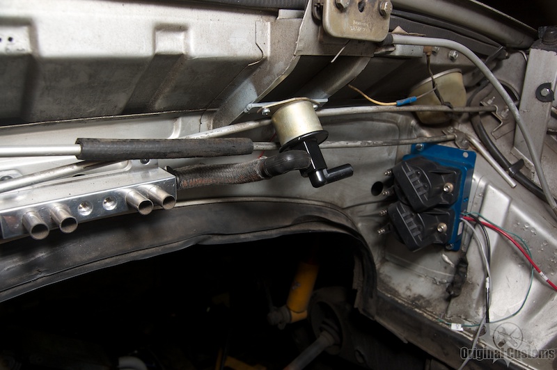

Fabricated a MAP sensor mount.
Fabricated an AAR mount.
Engine goes in tomorrow! (IMG:style_emoticons/default/sawzall-smiley.gif)

Member No.: 124
QUOTE(McMark @ Nov 2 2011, 10:20 PM) *
Gonna make a stand for the top of that unsupported coil pack ? (IMG:style_emoticons/default/poke.gif)
