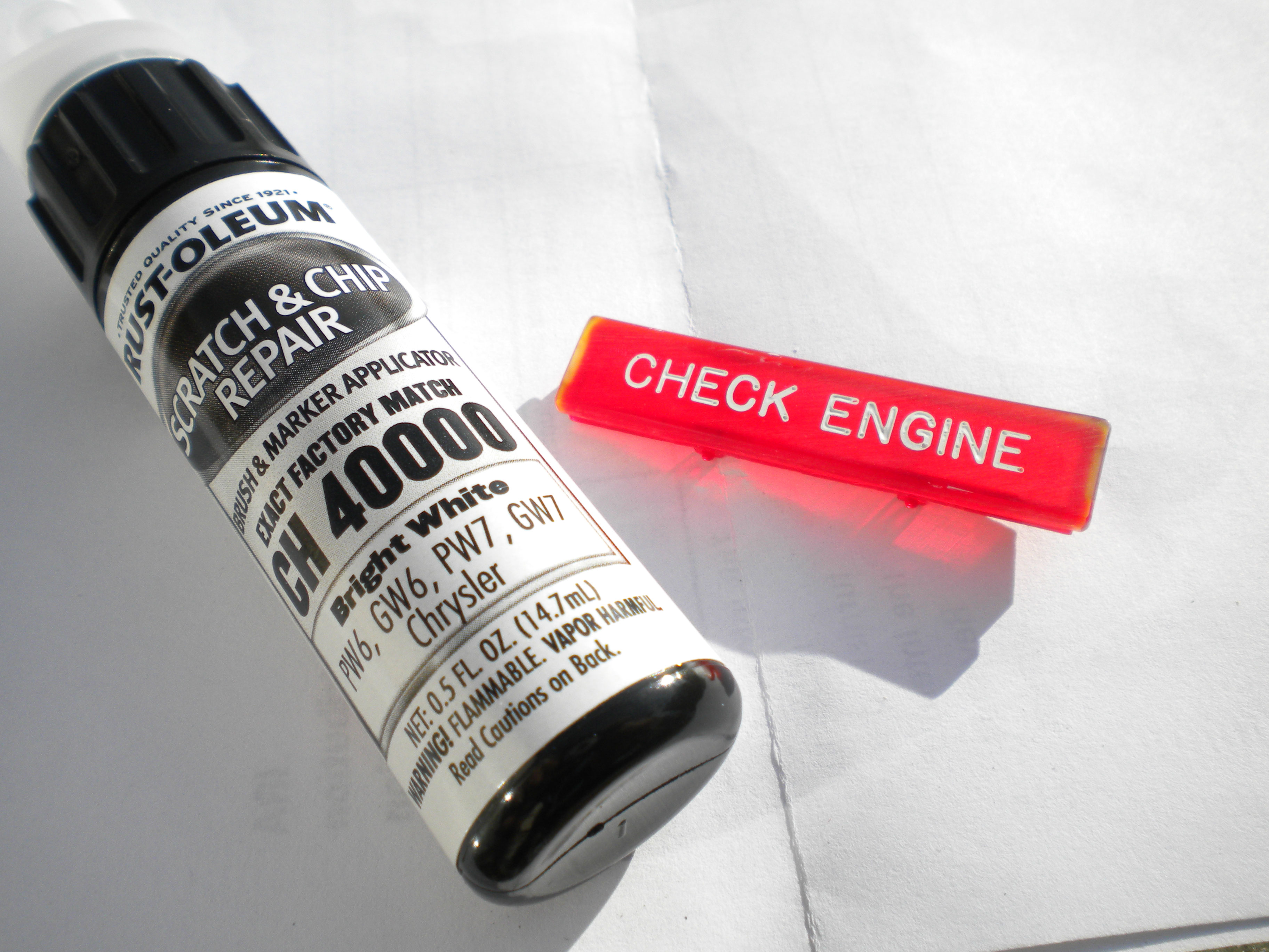

One of the things I love about the Original Customs concept is the seamless integration of the classic with some of the more modern things newer cars have. In this case, our 914's are the classic and programmable fuel injection is the newer thing... Mark makes things that are new, look like they might have belonged back when the cars were made.
The latest Original Customs integration involves the "Check Engine" light feature of the SDS ECU. Mark's idea was to take the lens from the "Fasten Seatbelt" light found in the dashboard of the '75 and '76 914's and make it into a "Check Engine" light. Good idea right? But, how to execute this?
The lens itself comes out by simply gripping it with your fingernails and pulling. We then took 600 grit Wet/Dry paper and with the paper wet, we gently rubbed off the "Fasten Seatbelt" lettering. This paper is fine enough that it actually gave the lens a matte finish that was very acceptable for our finished product. Next, we had to get the "Check Engine" lettering onto the lens. A couple of ideas were floated including making a tiny vinyl "Check Engine" and putting it in place or having it engraved. We liked the latter idea and I went in search of an engraving shop that could do the deed. One trip to a jeweler and I had a good lead. I brought the lens down to the shop and they were more than a little excited to be involved with this little project. You see, I live in Reno now and this is the home of Hot August Nights. They get a lot of car projects at the shops about town. It only took two days before the shop called and said "it worked, come and get it." It was beautiful but we aren't done yet! A trip to AutoZone for some white touch-up paint and then home to fill the engraved letters with white paint. Finally, another pass over the 600 grit Wet/Dry and we have our "Check Engine" light lens. Now, all Mark has to do is wire the SDS ECU to the back of the old "Fasten Seatbelt" fixture in the dash and you have another fantastic Original Customs integration of the old with the new...
Pretty cool if you ask me! (IMG:style_emoticons/default/aktion035.gif)

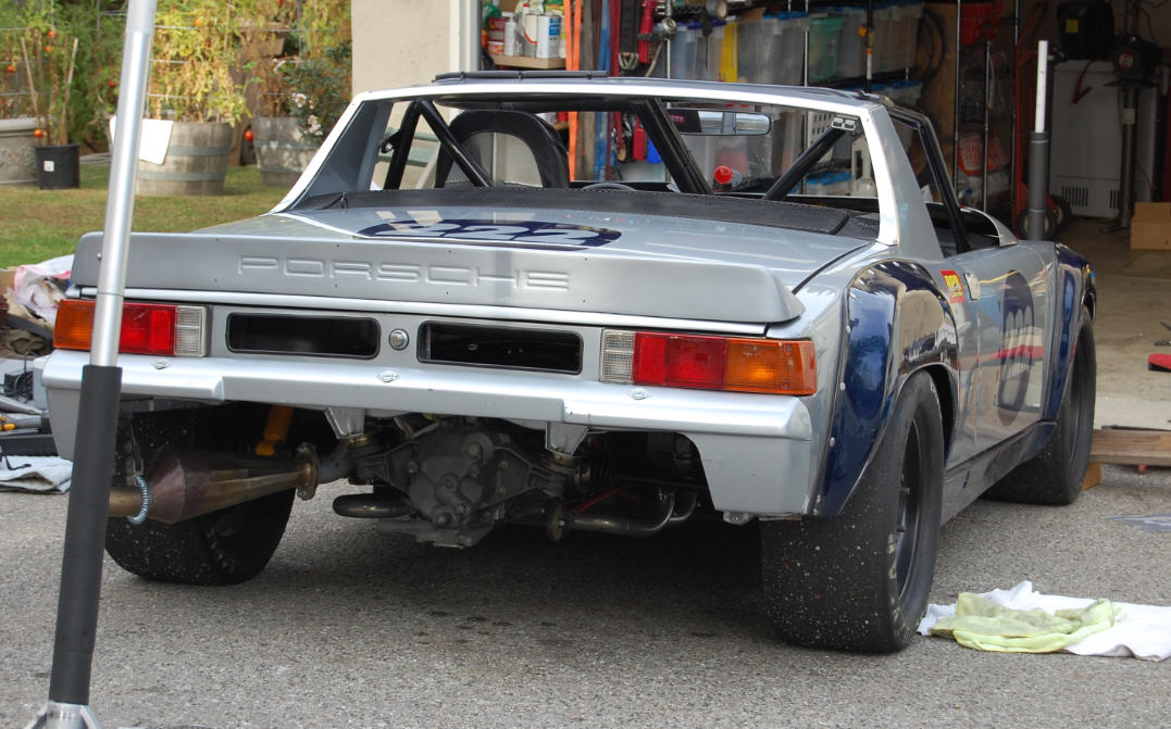

QUOTE(ConeDodger @ Nov 10 2011, 05:05 PM) *
Mark has a lot of cool ideas. I love walking around his shop and picking things up and going 'what's this?' and having him go 'oh, that's fiberglass engine tin.' SAY WHAT!!! (IMG:style_emoticons/default/drooley.gif) I trolled eBay for months to get 2 liter engine tin and this dude just makes it!
Bottom line, ask Mark first. That's what I do now...
EVen some old ideas:
McMark
post Nov 10 2011, 10:22 PM
Post #277
914 Freak!
Posts: 20,180
Joined: 13-March 03
From: Grand Rapids, MI
Member No.: 419
I still LOVE that rear end. (IMG:style_emoticons/default/drooley.gif)

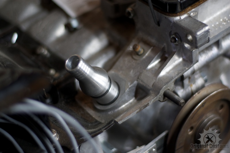

QUOTE(ConeDodger @ Apr 3 2011, 08:31 PM) *
This is an idea I had which I ran by McMark. He didn't shake his head and say something demeaning so I contacted Jeff Hines (sixnotfour) who quite quickly ran me up two of them with different sizes on the hose bib... This of course, takes the place of the distributor since this engine will be crank fired. Both the head vents have been plugged and we will be venting the case through here and returning any oil through the the old PCV hole in the oil console...
I cannot caution enough, do not build an engine without properly venting the case. You could blow out seals and have leaks that will be legendary! (IMG:style_emoticons/default/blink.gif)

McMark
post Nov 11 2011, 06:52 PM
Post #280
914 Freak!
Posts: 20,180
Joined: 13-March 03
Member No.: 419
We've got a spare one that's a smaller ID. Pm me and I'll get you the details.
