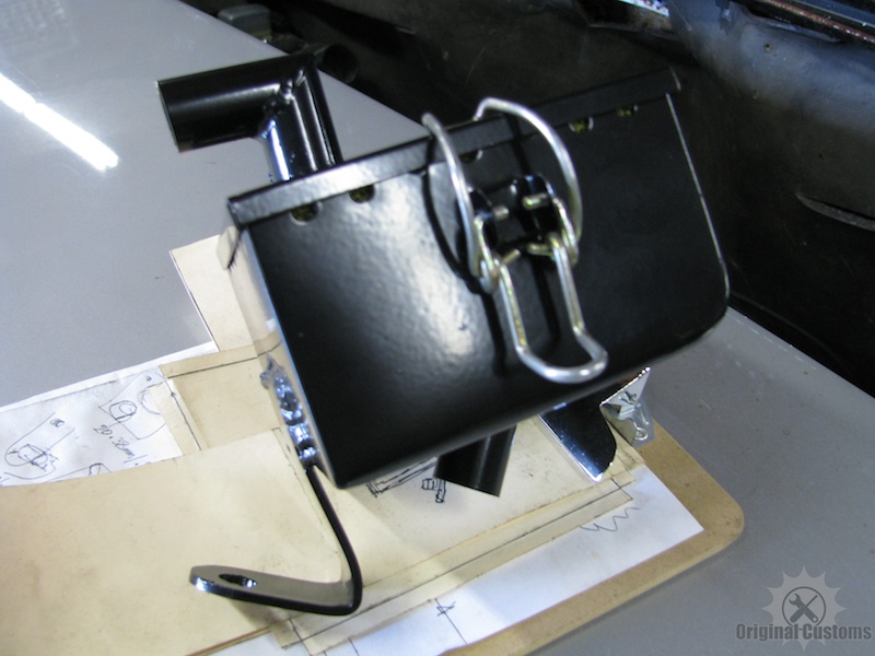

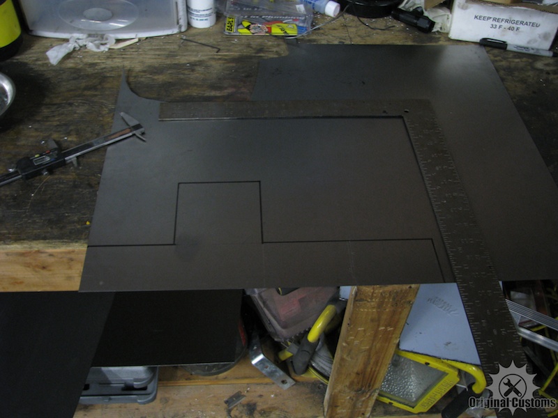

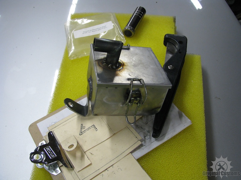

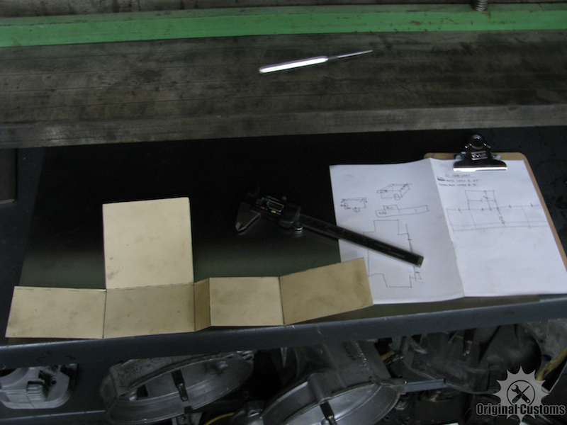

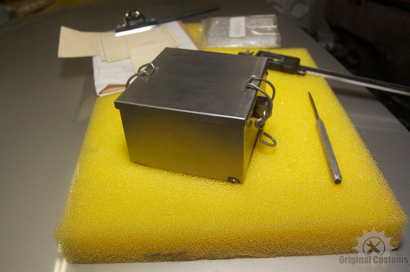

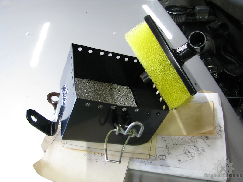

In case you guys were thinking this project has been sitting doing nothing this winter, think again!
Mark has been busy doing that OC Thang!
You may recall we replaced the distributor with a breather bung made by Jeff Hines (sixnotfour). I had used a breather made by Chris Foley at Tangerine Racing but I wanted something a bit more OC... Mark put his big brain to work and the following series of pictures is the evolution of an Original Customs Breather Box. Contact McMark if you want something like this made up...
The drawing:

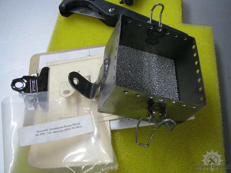

Mark has a metal brake so he can do this kind of thing...

The rest is all welding, brazing, and powdercoating...

He used aluminum "duocel" in the bottom and foam at the top with holes all around so the crankcase pressure can vent...
