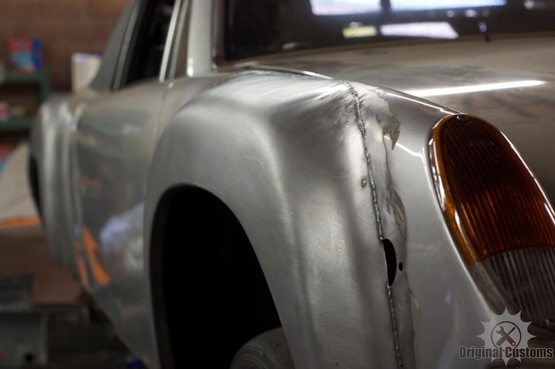

Mark answered with a simple 'Well you're one step closer today'... Both right side fender flares are now on. Beautiful work Mark.

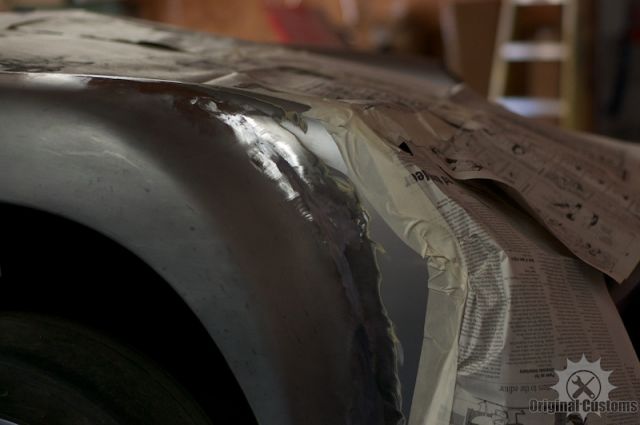

Mark's been at it again... This time in the left rear. I suspect he will be done by Sunday... I can't wait to see it in person!

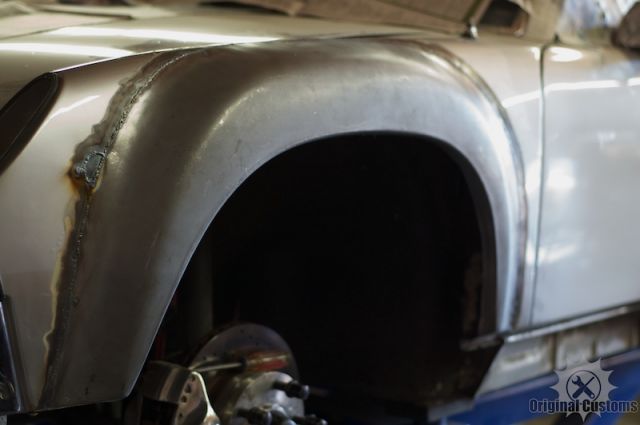

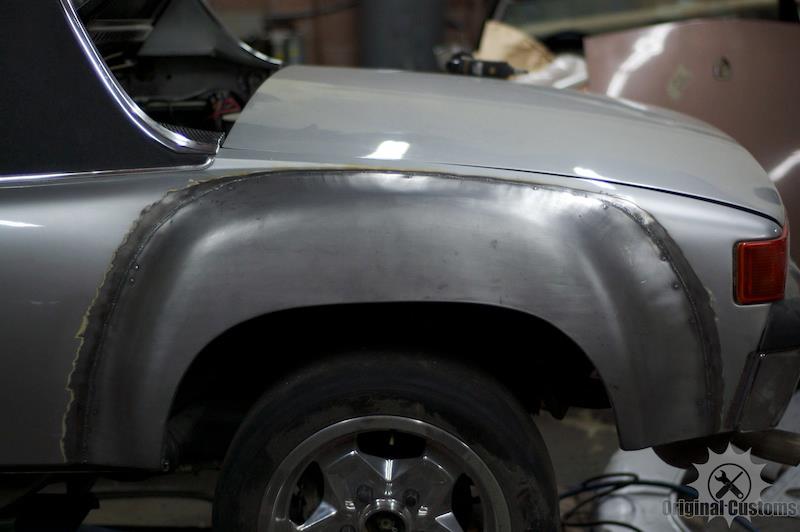

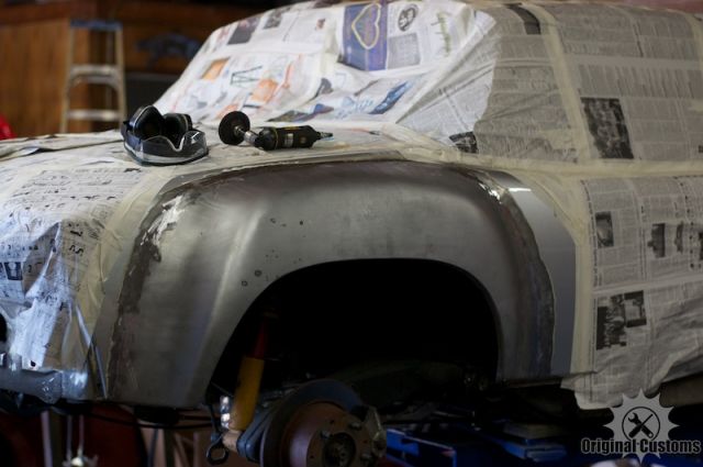

So while I was off working this weekend McMark was off having fun... Finishing my flares! This is so cool! Check these out. (IMG:style_emoticons/default/biggrin.gif)
ConeDodger
post Apr 15 2012, 10:33 PM
Post #390
Apex killer!
Posts: 24,247
Joined: 31-December 04
From: Tahoe Area
Member No.: 3,380
Then he ground off the welds (IMG:style_emoticons/default/evilgrin.gif)
ConeDodger
post Apr 15 2012, 10:34 PM
Post #391
Apex killer!
Posts: 24,247
From: Tahoe Area
Member No.: 3,380
And deleted the side marker light holes. (IMG:style_emoticons/default/aktion035.gif)

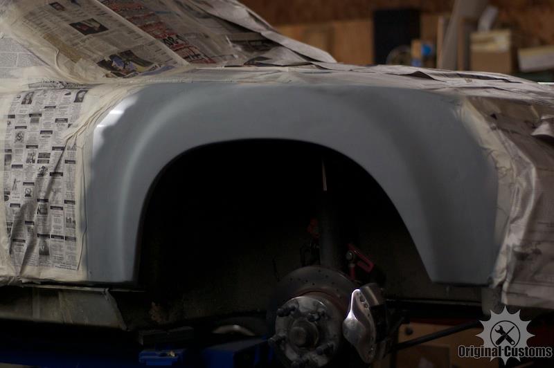

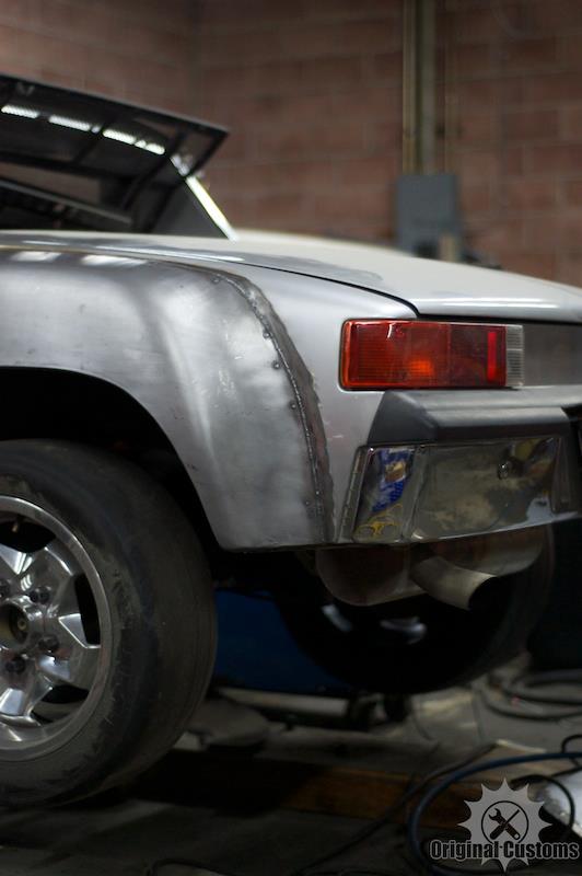

Looks like Mark had the OC in high gear today! Completed flares, all ground off, primered with fender wells undercoated... GT goodness! (IMG:style_emoticons/default/aktion035.gif)

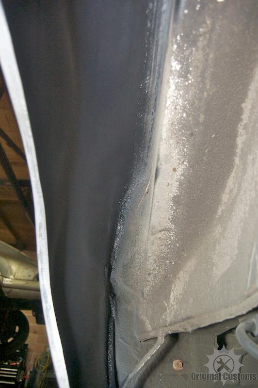

An upskirt shot for you perverts out there! (IMG:style_emoticons/default/evilgrin.gif)

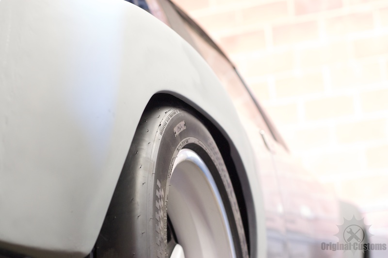

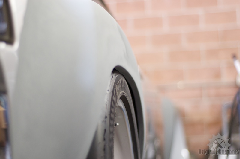

The Original Customs boys are at it again today. Yesterday, they discovered that the custom built 8.5" wheels built by Weidman's Wheels in Oroville California were just a little bit wide for the reproduction steel GT flares we are installing on my car. Fortunately, the OC has a German GT that was imported sitting in the shop for rust repair. I had forgotten about Andy's car. It is a brown GT that has the original Porsche factory flares which Mark is uninstalling and reinstalling to get rid of the rust worms that have invaded the car. Talk about knowing 914 flare installation forward and backward! (IMG:style_emoticons/default/biggrin.gif) Anyway, what Mark discovered when he compared the two flares is that the factory flare has about half the lip as the reproduction. So, a little bit of a trim with the body saw and some grinding to clean up the cut, then a bit of primer and we have clearance. This should be good since as the car sits down into its spring it gains negative camber. What this means is that the top of the tire moves inward... Check out the before and after pics!
