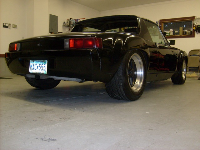

Just saw the spy photos from the OC! The car is on the ground, finished for now!

Rob,
What size and make tires on the rear? They fit the rims perfect.

I may be able to space the front wheels out a bit. Maybe not. They do have to turn and not contact the fender flare... (IMG:style_emoticons/default/blink.gif)

Rears are 225-60-16, IIRC. I might have the aspect ratio wrong.
The front could probably use a 1/2" spacer. I have two 5mm spacers at the shop we can play with on Sat. If you want.

Pretty sure they are 50 or 55 aspect ratio. I definitely want to move the track out a bit if we can. Not so much that I contact inner fenders or outer fenders...

I have 1" spacers in the front.

QUOTE(rick 918-S @ Apr 19 2012, 05:27 PM) *
It looks like it could use about an inch doesn't it?

That's what I thought too... Until I put spacers on and drove it. It looked great! But... It changes the scrub radius quite a bit. The car did not handle as well and was much harder to steer. Make sure you drive it hard after you try the spacers. You will feel a dirrerence.

BTW, I think I have a pair of 3/4" spacers if you want to try them. Good ones, not the crappy type.
